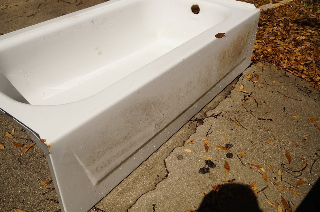

Okay to remove the tub, if it's a steel unit like mine was, it's actually pretty easy. Just remove the drain, and stopper valve. Then check along the the lip for any nails or fasteners holding it in. You'll need to remove the wallboard along the back and non-drain ends to be able to have room to lift it out. Starting at the end opposite the drain just lift up tilting that end up while also pulling it away from the drain, if you do it right, you should be able to tilt and lift it so that it's standing straight up, then just cart away with a handtruck.
So I should go buy a lottery ticket. I stopped by the local Habitat for Humanity Re-Home store to see if they had any used tubs there from other demo jobs. Well after looking over the small selection I didn't see anything that would work, all were left draining and I needed a right draining unit. Then I happened to spot a tub under a couple other fiberglass units, it was white, and had the correct drain location. So I pulled it out from under the other units and started measuring. 15 inches tall; check. 30 inches wide; check. 60 inches long; check. Cool just the size I needed. It was dirty but looked salvageable. The price, a cool 50 bucks, today was apparently 50% off bathroom fixtures. Huzzah!
So here she is all unloaded and ready for a good cleaning.
Here's the worst damage. Thankfully this will be covered up with the wallboard and tiles once I am done.
I'll need to cleanup this calk with a scraper blade.
All cleaned up and set into place.
Lets check the drain and overflow.
Hot damn will you look at that, I'd rather be lucky than good as my dad always said.
Lets check the overflow. Needs a little adjustment up, but that's easy, just a quick tap and it's right on the money.
Before adjustment.
After.

so, nothing really holds the tub in place after the wall boards are removed? no structure under the tub to build for support? Would have guessed otherwise. Good to know for upcoming demo at my new place!
t25torx
t25torx Dork
2/23/16 8:08 a.m.
In reply to TGMF:
so there's a piece of foam directly under the tub, and in my case there were a couple 2x4's on the back wall supporting the lip of the tub, but that's it. The tub has it's own metal supports to the front.

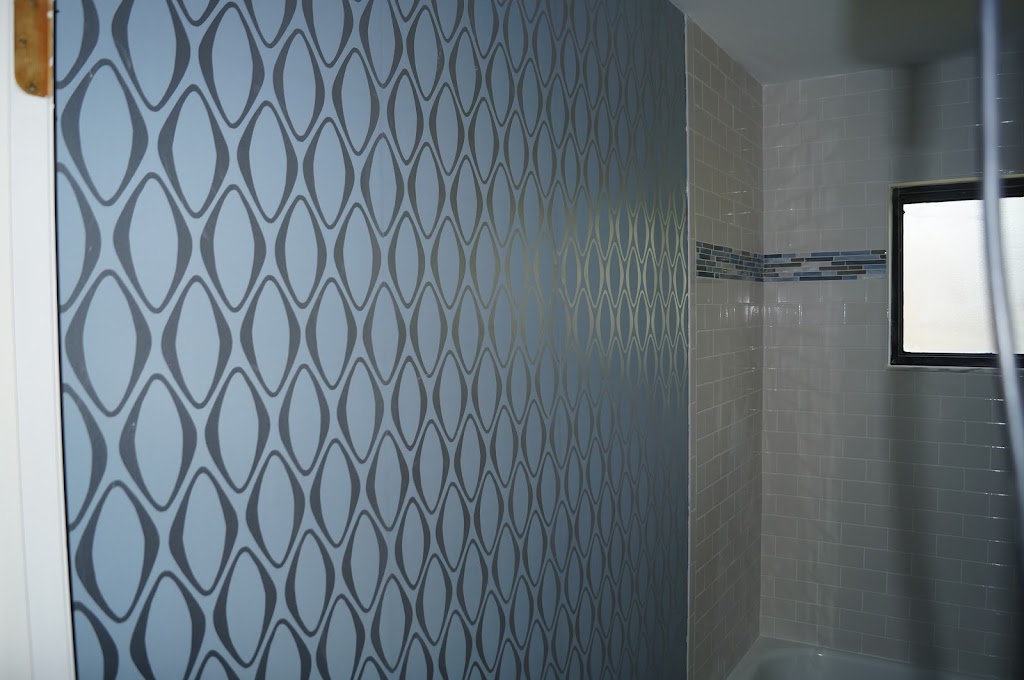

Got the wallpaper up, I think I hate wallpapering more than tiling. It looks good in pictures but I can see the edge where the rows are lined up, I think i'm just too much of a perfectionist. Also got the floor down so I can't do anything in there for 24 hours. I need to notch the new door for the hinges and the linen closet door also tomorrow while I wait. Maybe knock this popcorn ceiling off the small hallway outside the bathroom.
Wallpaper is blue with a silver pattern, getting the pattern to line up was a bish.
