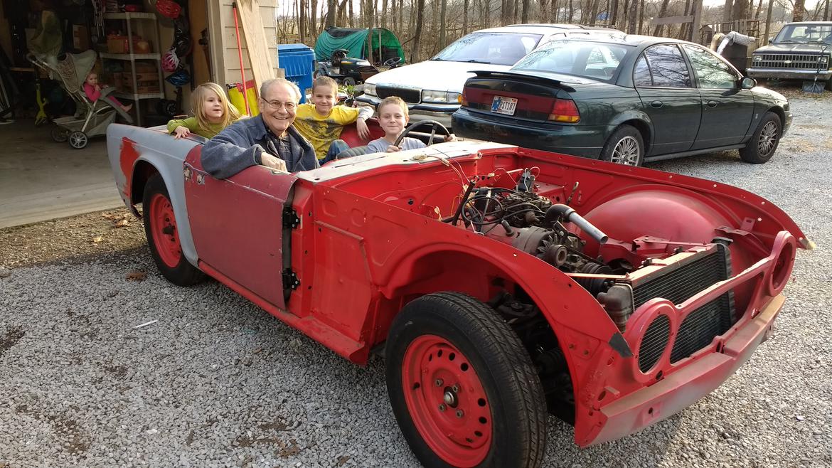

My Dad bought a TR4 brand new off the showroom floor in 1965.  He talked fondly of the car as I was growing up, so I guess that was an influence on me.  He's pictured below with some of the Indy-kids, making Vroom, Vroom sounds:
And here's my turn to make the go fast noises:
Note:  I do have the hood and both front fenders.  They're just being stored up in the garage attic at the moment.
