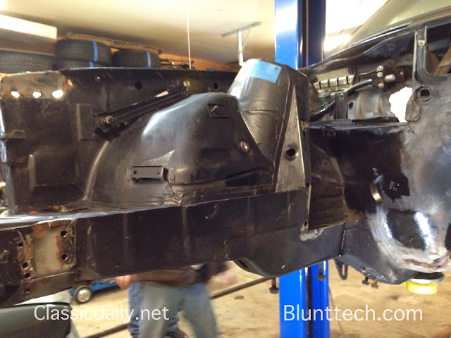

We are making the core support removable to make getting the engine in an out a lot easier.
