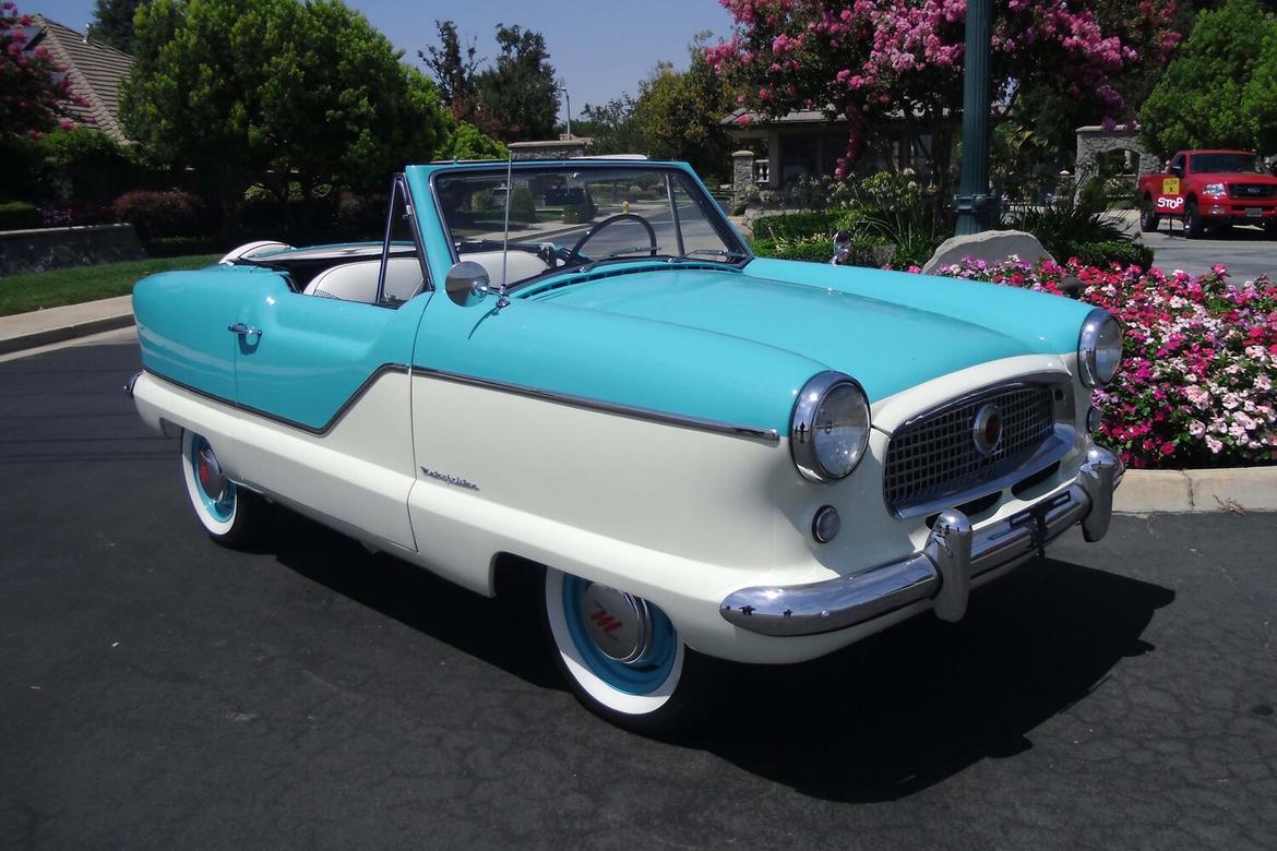

Oh for sure this needs to be powertrain swapped into a smaller and much cooler platform.
A few suggestions for your consideration:
