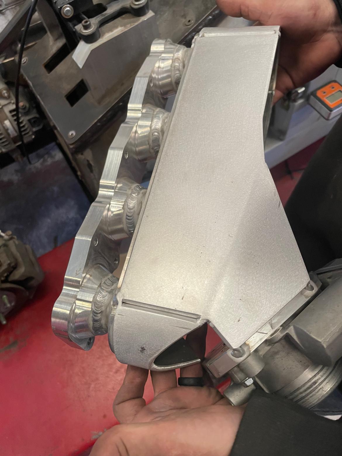

2/2/23 6:16 p.m.
We made a little progress on the intake plenum. Pretty challenging design, with a very limited volumetric envelope to work within.  That said, I'm really pleased with how it's working out.
Teh E36 M3
Teh E36 M3 UltraDork
2/2/23 6:37 p.m.
Wow dude. Wow.

2/8/23 5:21 p.m.
We got the rest of the intake manifold pieces cut out and tacked in place. A little more last-minute fit-up checks and tweaks before firing up the TIG and getting it all closed up.

2/22/23 12:36 p.m.
We finally got the intake manifold welded up tight. Now onto all the tubing/piping to connect up turbo-to-intercooler-to-intake, as well as coolant line routing. Spending the rest of today looking thru catalogs for tubing, fittings, and 45- and 90-degree elbows...
Shavarsh
Shavarsh HalfDork
2/22/23 2:28 p.m.
That intake is beatiful!
