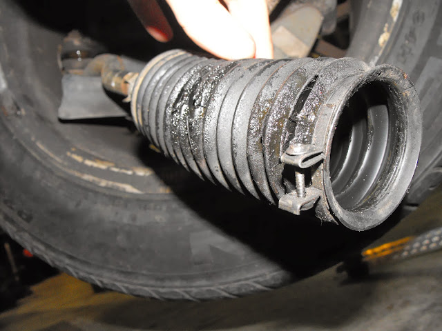

Couldn't get any new claw washers from any of the Lexus/Toyota dealers or local parts stores, so I had to pull out the old ones and hammer them back into shape.
I noticed some tears in the bellow - crap, over looked that before I ordered all the parts. So, I duct taped it up. Should hold until I can get a replacement on there and do another alignment.

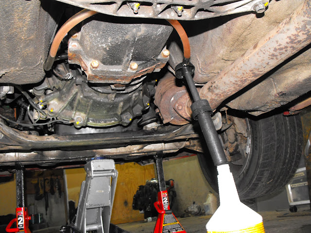

Before driving it any distance, I still needed to fill the transmission and before doing that I wanted to replace the output shaft seal.
Dropped the exhaust again and unbolted the front driveshaft and mount.
Pulled out the driveshaft to expose the seal. Pried out the seal and tapped in a new one.
It's very difficult to get the shifter off this transmission with it in the car, so I couldn't fill it from above and needed to get out the trusty oil pump.
Pumped 3 quarts of Redline MT-90 into the trans, then everything went back together.

Here's the first tie rod end. Tried banging it out with a sledge first.
No luck. Didn't have a ball joint separator, so tried a pulley puller next. Broke an arm off that.
Got out the next larger puller and the propane torch. Tightened up the puller, heated the joint, then smashed it with the sledge - finally success!
It still managed to bend one of the bolts on the puller though.
After fighting the hardware for a few hours, I finally was able to remove everything from the driver's side. Also got everything out of the passenger's side except the lower A-arm. Turned out one of the eccentric bolts was seized in the bushing sleeve. Nothing to do but drop the subframe - crap...
