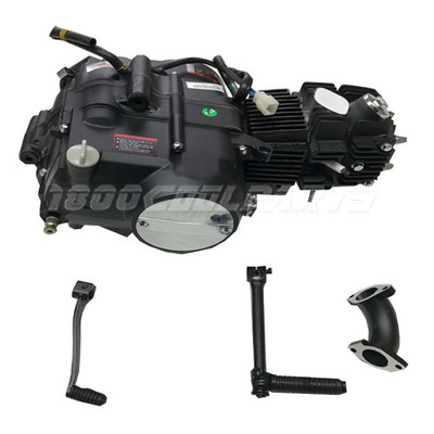

Looks good and I think the 6.5hp are on sale this month for an even $100 so if you know that's what you want id go ahead and pick up the motor and save $20.
Or just go with the 125cc dirt bike motor and have some gears and a clutch!
