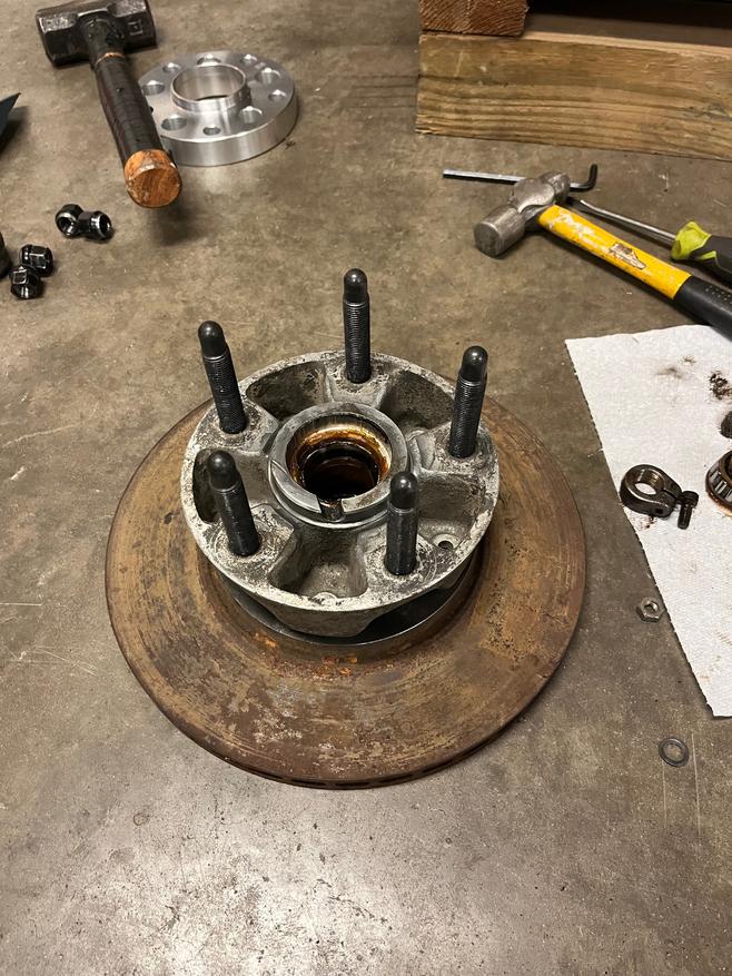

My 1" wheel spacers and extended studs arrived, and it felt this would be a nice break from fabrication. I started with the rear driver side. The ball joint tool made quick work of removing the old shorter studs.
I knew I could install the studs with some spare lug nuts but splurged on a $15 Lisle tool. Totally worth every penny. It made things go so fast. 10 out of 10 totally recommend.
I also did plenty of wire wheeling of surfaces while everything was exposed. I plan to pull all of the hub for new bearings and e-brake modification. Then I'll do a coat of paint and some rust inhibitor where needed.
The studs are all Rennline 72mm. They weren't cheap but I couldn't find anything within the price range that would work. Luckily Pelican had a kit with lug nuts that were cheaper than what I could find anywhere else.
Anyway enough gabbing, here's the spacer on now.
On to the front. I wasn't able to use the ball joint tool but a quick rap from a sledge knocked them out while the hub was still attached to the car. I was thinking this would be more difficult of an assembly process but once I figured out how it all came apart it went super fast.
Once again the stud installer tool made it go so fast.
That was the start of my Saturday morning. The rest of the day was eaten up more important fleet work and general life stuff.
Sunday I started the day with the passenger side install. I knew it would go fast since the driver side took maybe 15 minutes per hub. The rear was a little more difficult since it was the only caliper left installed on the car. Once that was out of the way I blazed through the rest and put the car back on it's wheels for a nice reveal.
Oh, almost forgot I installed some cheapo signal lenses. I need the car to look more finished for motivation and it's funny something so simple can do that. Anyway, the lenses and spacers look SPLENDID.
