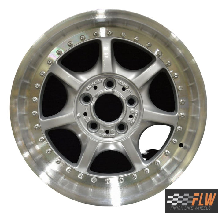

I had the two piece wheels on my car.
I think my favorites though were these that came on the later year sport cars.
