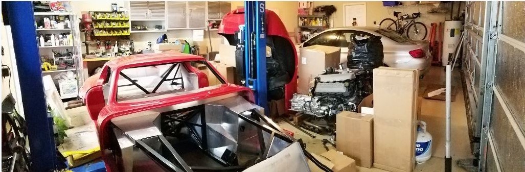

Well Santa's helpers are out early.... Got the call that we pushed up one day....
Once again, great support from Stewart, very friendly and helpful. I was actually stuck in traffic so he was waiting on me!
Quickly unloaded 5:30pm ... well there is like 10 million boxes... so quick is relative.... did the inventory and laid out the boxes in what I think will be the order to attack them in....course got done with that... and heck... might as well open the box I was gonna do in the morning.....so Box 15 is done!

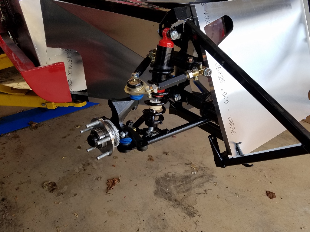

And it looks like we have some 818 design here with Both R and S mounts on the same frame.
Lower A-Arms all greased up and set loose in there until we get ride height set and then torque......
I will get the nose off in the morning and finish up the front suspension... the aluminum that I normally remove almost right away will remain for this build so I can set the engine and take a look at turbo placement.

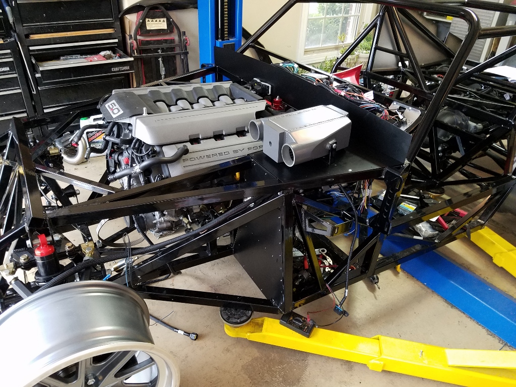

Wiring is about 80% done... I am going to get it running with all the stock switches first then wire up the cyclic stick... Engine went in today for the FINAL time... while I was at it I went ahead and recycled the 2015 clutch tubing..fit nice. All I had to do is re-bend one line and it all worked out... I can go ahead and put brake fluid and clutch fluid in tomorrow. The Coyote Harness is 100% laid into the Ron Francis Harness... will work the seat heaters tomorrow as well as start working the custom driveshaft I need built. Looks pretty cool.

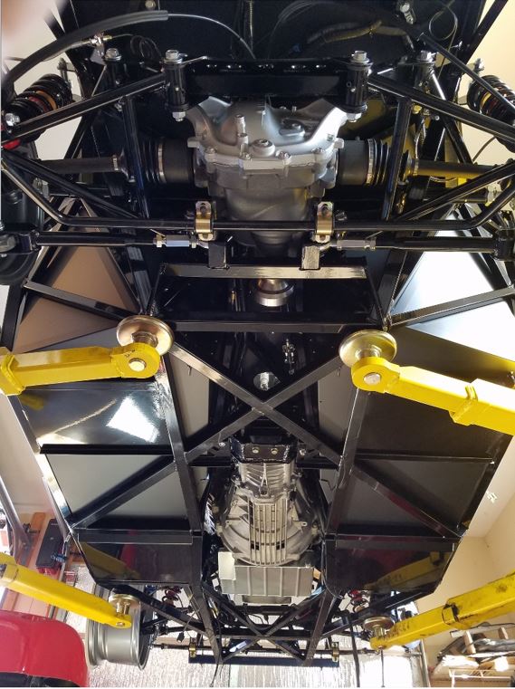

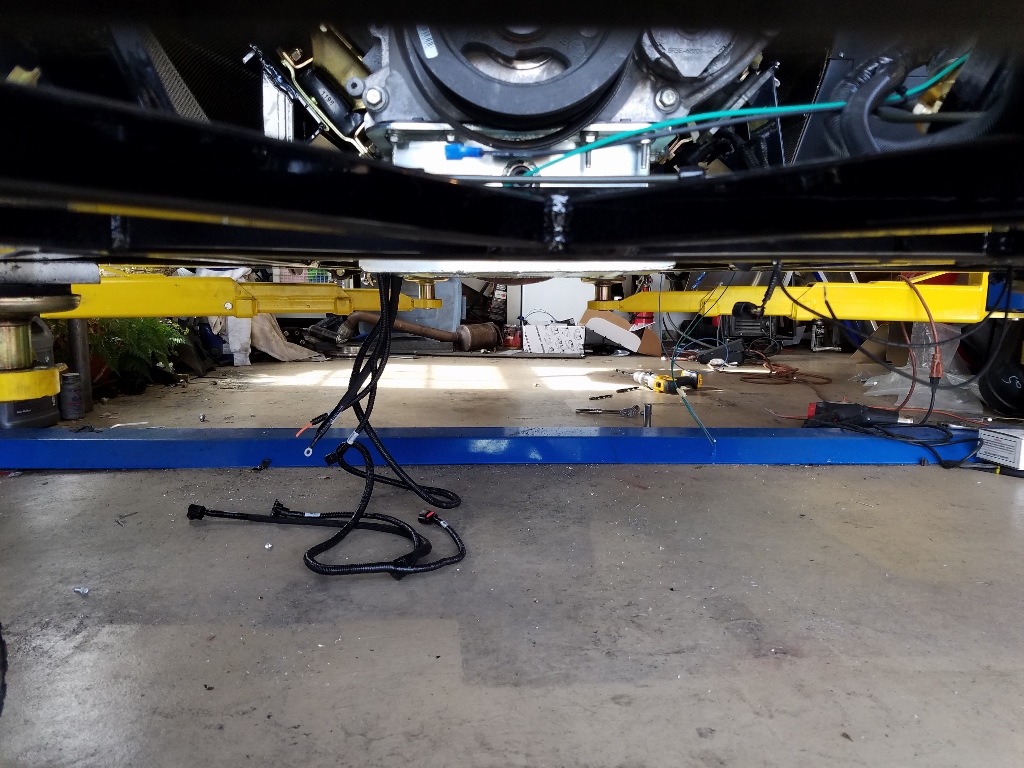

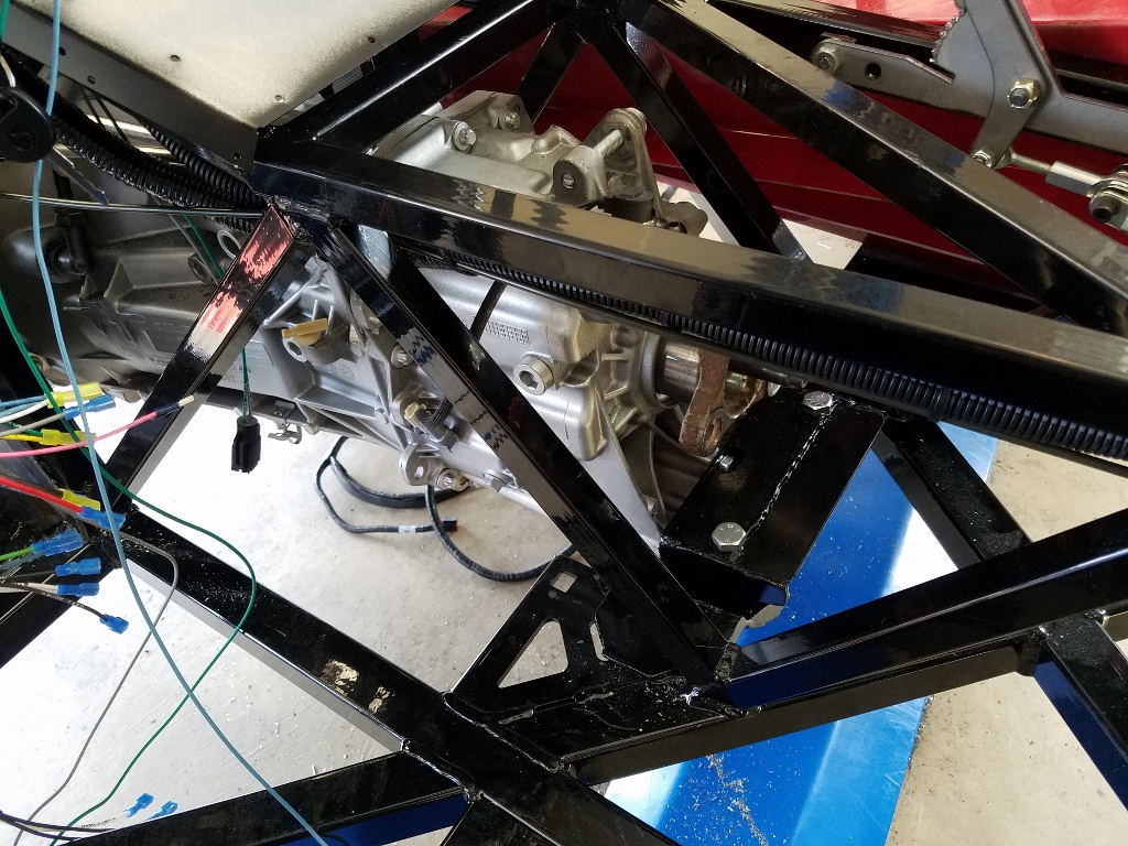

I had a couple people ask me about the MT82 tranny and how far it hangs below... so here are some more shots..
From the front... oil pan JUST below the frame:
Custom Made MT 82 tranny mount

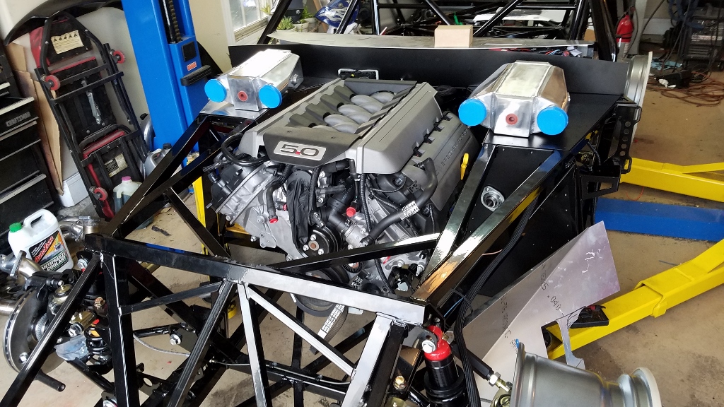

getting ready to mount the intercoolers!

Didn't get as much done today... had a few visitors and some friends came over.... so got the intercooler mounts made... one intercooler color matched to the car color... looks pretty good... had planned on measuring up the driveshaft, but that is a next weekend thing I suppose. anyway....

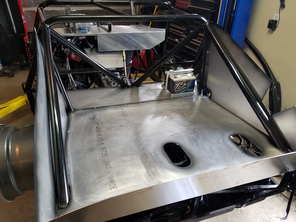

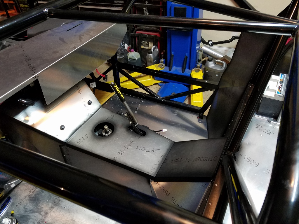

Another few steps closer today.... work has let up some.... so spent the FULL day at it.... Seat heaters installed, some more wiring, installed the shifter for the final time, installed a good chunk of the aluminum.. the back is completely done, cockpit floors are in, battery installed and cables run...man I guess I got a lot done now that I am typing it all out... only 3 pictures but the under car shot looks great with the powdered panels....too bad it won't be seen.... anyway... closer to first start!
