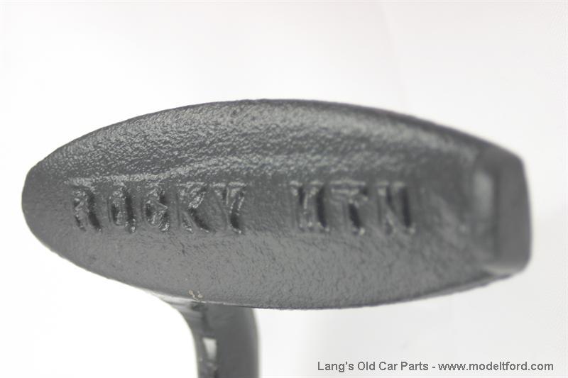

Rocky Mountain Brakes were a common aftermarket upgrade for Model Ts. You might want to take a look at some photos of them and maybe you can fabricate something similar. They used external shoes around a rear drum.

Over at the model T camp they speak highly of the Rocky Mountain Brake upgrade. The thought never occurred to me to see what that was all about. Anyway, looks like an impressive bit of kit. Probably cost ten dollars and fiddy cent when new

I think your right, After driving this car around today, a go kart brake with a foot peddle would probably be fine. The parking brake seems to work great for now but it's awkward and non intuitive. Anyway, I think I read somewhere that the parking brakes are not recommended to stop the car..I'm not sure why. On the other hand the Rocky Mountain type brakes look like they will stop a freight train and may be way too much stopping power. If the car were to be made street legal then the big brakes would of course be necessary.

The Rocky Mountain Brakes were considered mandatory if you added a Ruxstell two speed rear to your T ("Four Speeds for Fords"). If you ever got caught in Ruxstell neutral, the stock T driveshaft brake wouldn't do a thing.
