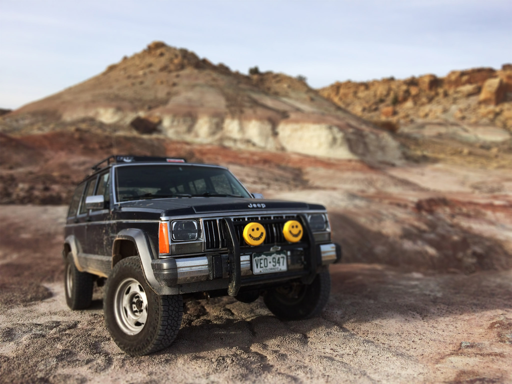

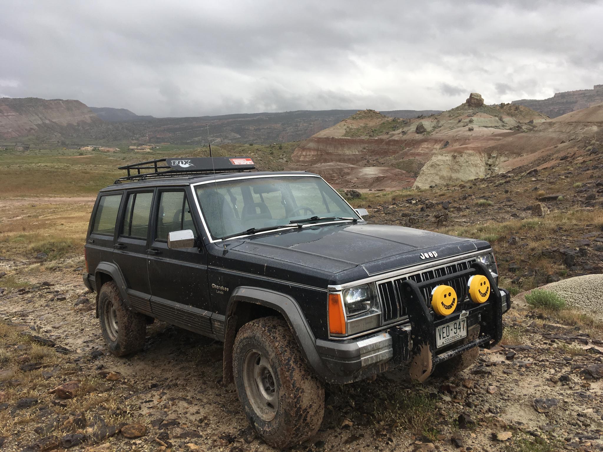

Anyhow, speaking of offroad, I took the Jeep for a walk today.
Seriously, if we're going to Moab, I need to get my skills back up. It's been a while since I spent any real time wheeling, and this is the first time I've done it with 1) horsepower and 2) a slushbox. I decided to drive out on to a plateau I'd eyed once before, now that the XJ has slippy diffs. They may not have been completely necessary, although there was one loose climb that certainly benefited. More importantly, I prefer to have more truck than obstacle when I'm dinking around without a safety net.
No worries. A little bit of loose clay/bentonite, a rock step and a bit of flexing. Like it was born to do it. And the turning circle helped a bunch.
Also, note the new stickers on the wind deflector. One of them is temporary.
Obligatory hero shot.
