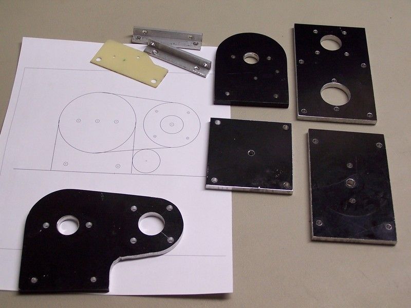

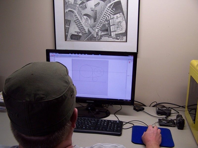

After much thought and a few sketches the scavenger hunt began. The parts needed for Cambot were sourced from McMaster Carr, Ebay and Amazon.

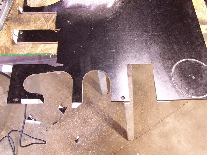

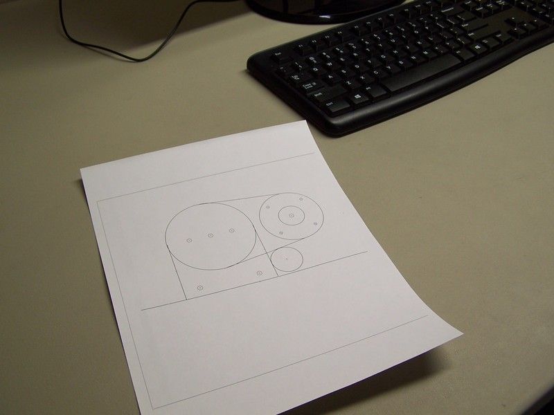

A few evenings were spent drawing up the components that needed to be fabricated. I used a free software package that wasn't really meant for drawing parts but it can be tricked into doing what I want.
Once drawn, the parts can be printed out on a 1:1 scale. ... ummm yeah, printed on paper. I ain't got a 3D printer....yet.

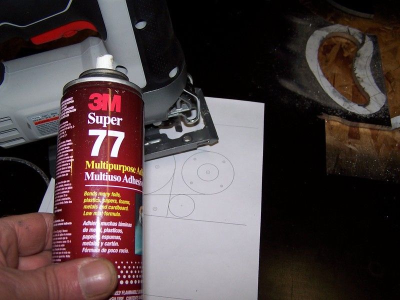

The 1:1 paper drawing is glued to a slab of aluminum and then cut out with a saber saw. This is not exactly high tech but it works great.
It was a bit tricky, but I managed to cut out all the components needed in only a few hours.

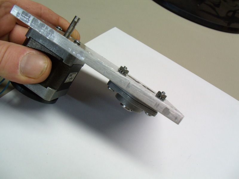

Once all the parts were fabricated it was time to start assembly.

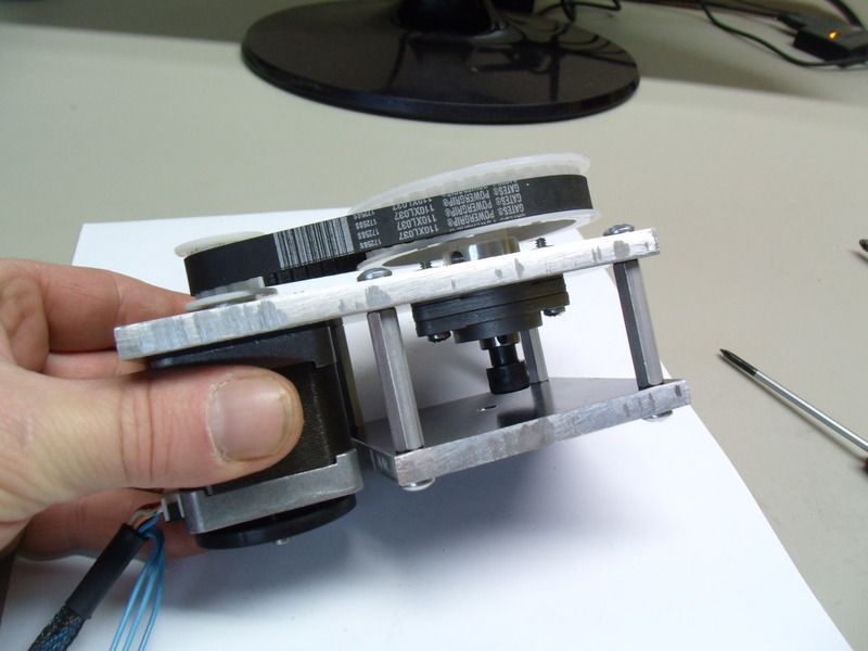

First up is the pan section. This part of Cambot will allow the camera to swing left to right. A stepper motor and a set of turret bearings are mounted to one of the fabricated aluminum panels. The aluminum is .25 thick and is overkill but it was all I had in stock. Version 2.0 will likely be made from fiberglass.
Another chunk of aluminum is attached to the pan section with 8-32 standoffs. This smaller section is the base of Cambot and has a standard 1/4-20 threaded camera mount.

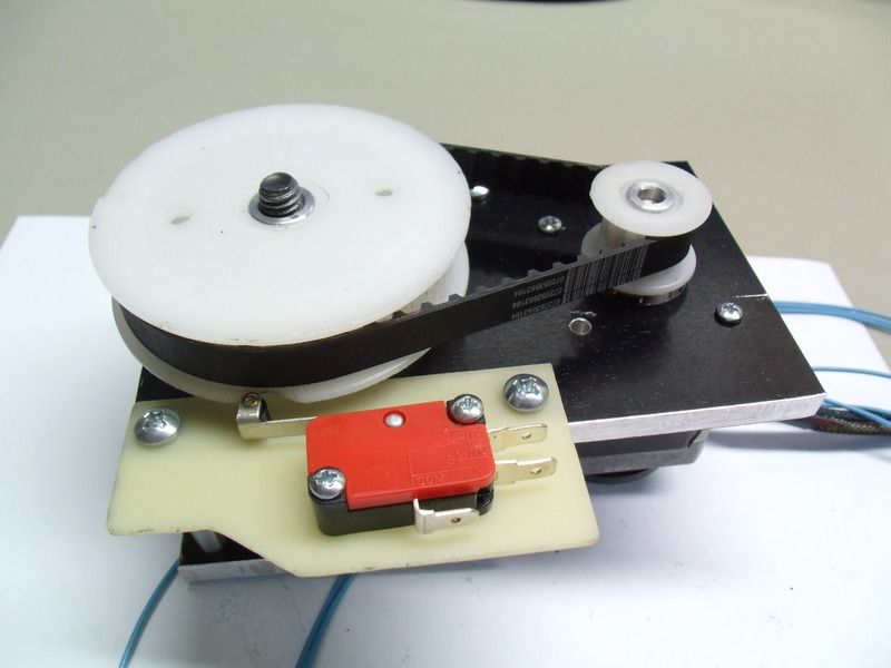

A limit switch is attached to the pan section. This switch will be monitored by the software and is used to calibrate the extreme left position of the camera pan. Once the switch it tripped, the micro computer knows exactly where the camera is pointing. The software can now keep track of the steps commands that are sent to the stepper motor. The magic of digital electronics

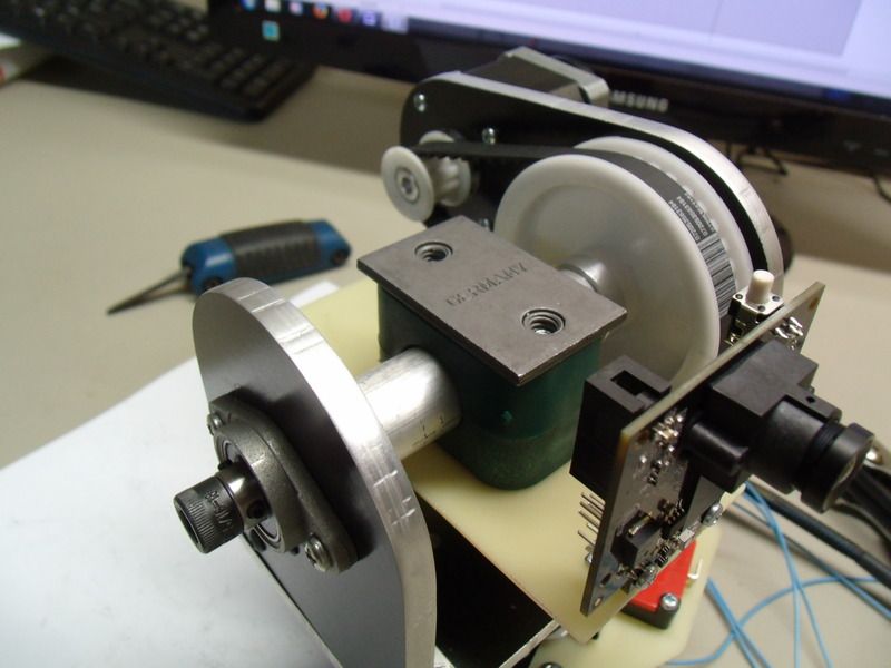

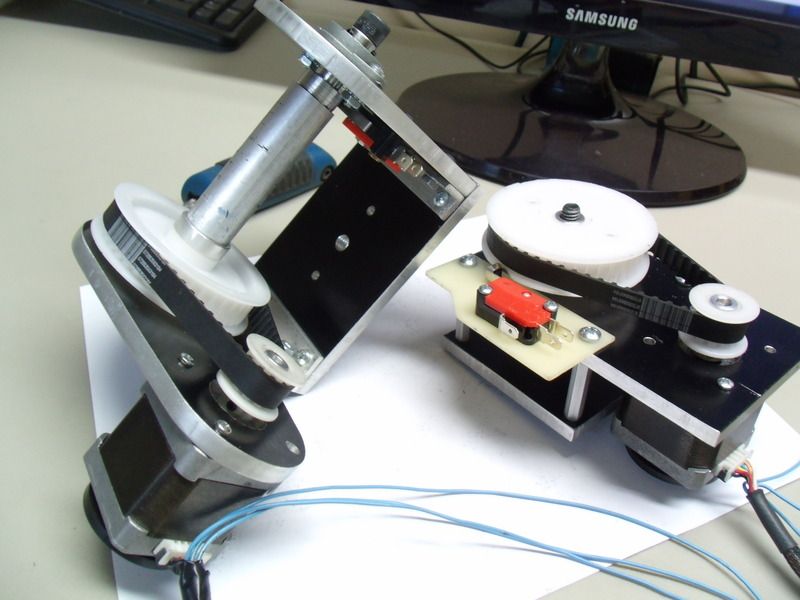

With the pan section more or less complete, its time to assemble the tilt section. The tilt section was designed to be easily modified to accept different cameras for different rolls. The little Pixy camera at the beginning of this thread is a specialty camera and isn't used for video, instead it is a color tracking camera that can sort out the position of objects and send a serial message to a micro computer. The micro computer uses this information and will calculate the X-Y position for the pan and tilt. Its a fascinating chunk of technology.
Anyway, the Pixy cam is use to track an object, another camera will be used to record the object in high definition. Its actually a bit more complicated then I wish to explain and eventually a few hurdles need to be jumped to make this work in the real world.
Back to assembly....

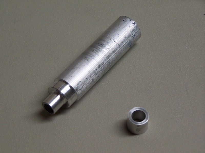

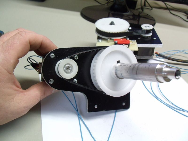

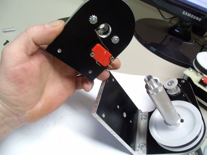

The tilt section build starts off with assembling the left motor plate. A stepper motor, bearing and toothed cog are fastened together with 6-32 screws. The aluminum shaft protruding from the assembly is part of the universal mounting system.

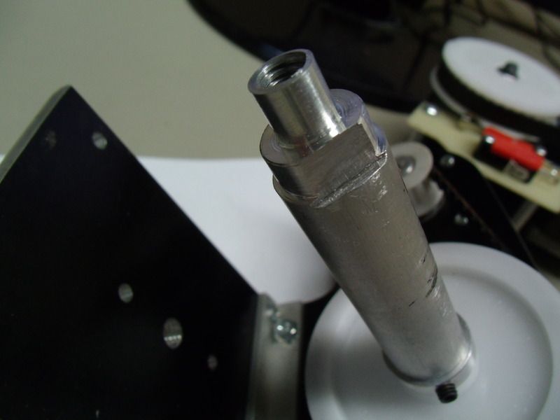

here is a close up shot of the aluminum shaft and a spacer. These parts were made on a lathe using some scrap.
The left motor plate was mounted to a base plate before the right support plate is introduced into the mechanical orgy.
Note.. the right support plate has a limit switch to telegraph the position of extreme downward tilt.
Here is a close up shot of a notch filed into the aluminum shaft. This notch acts like a cam and is what triggers the limit switch.
The finished tilt section ready to be mated to the pan section.
Here is a close up shot of how the Pixy camera is attached to the tilt shaft. The green plastic thingy is a split clamp and is the heart of the universal mounting system. All modification can be made to the cheap plastic clamp and saves a bunch of time and money for different experiments.

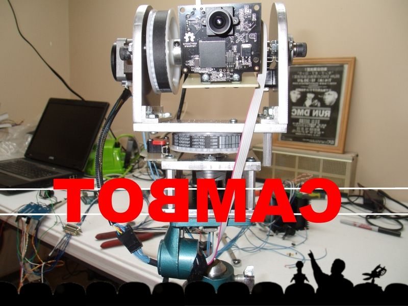

Cambot assembled and mounted to a vintage tripod. Somewhat of an interesting photo.
Picture of Cambot being photographed while simultaneously appearing on the Internet in its own build thread. Just because its possible, doesn't mean it should be done..... but I did anyway.
