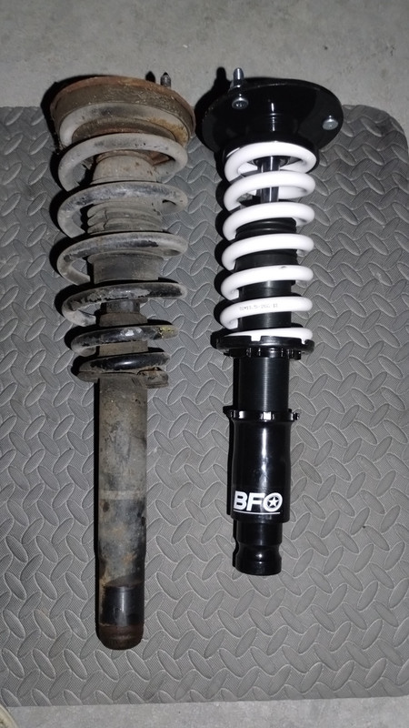

Work work work work work

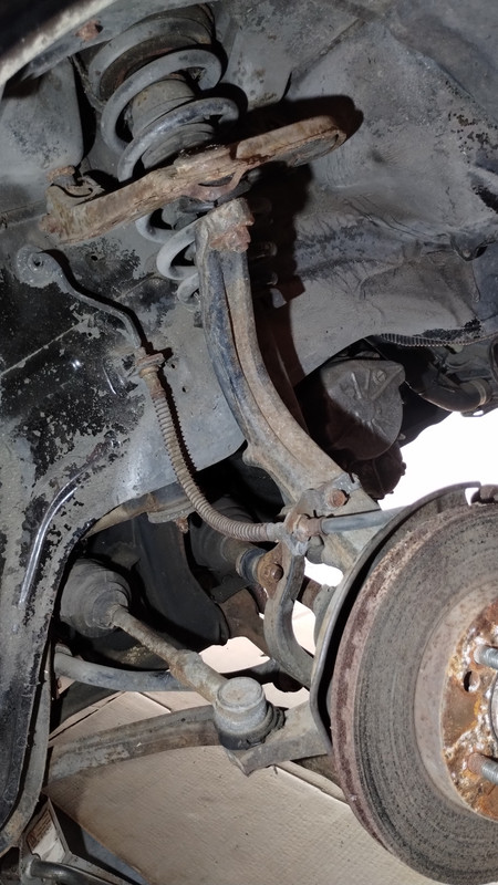

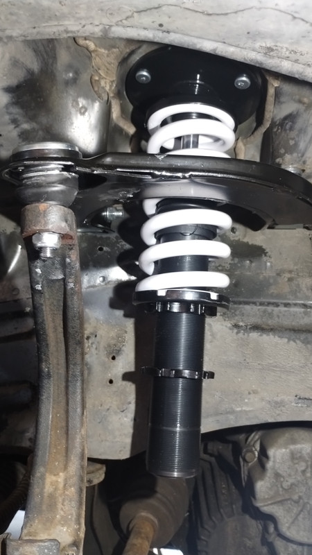

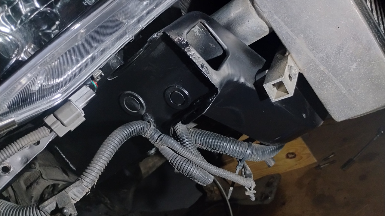

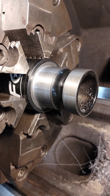

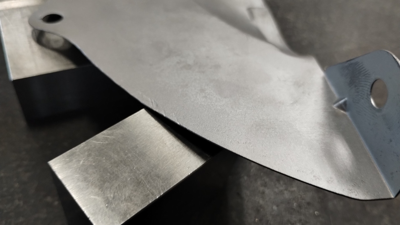

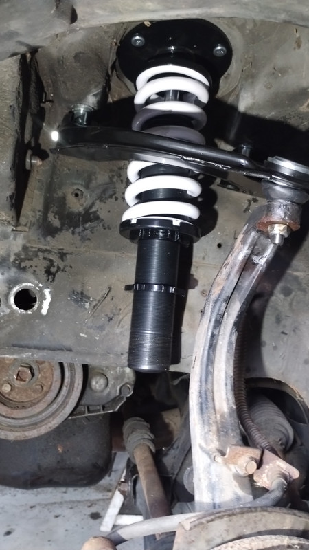

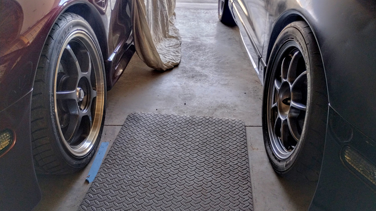

Bottom cops of the coils are too large. Gonna chuck em in the lathe tomorrow and fix that up quick, then the front will be down and fitted!
HaveBlue83
HaveBlue83 Reader

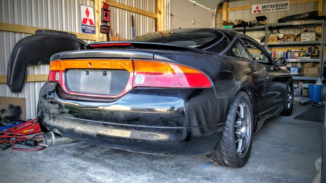

7/2/24 8:14 p.m.

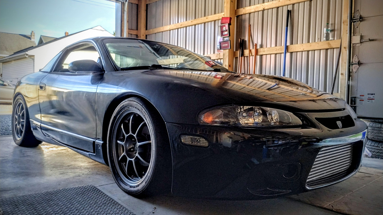

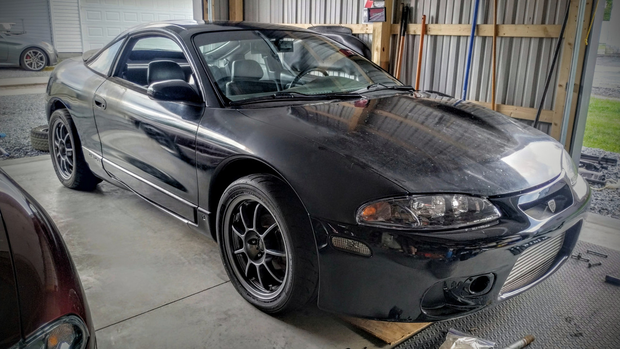

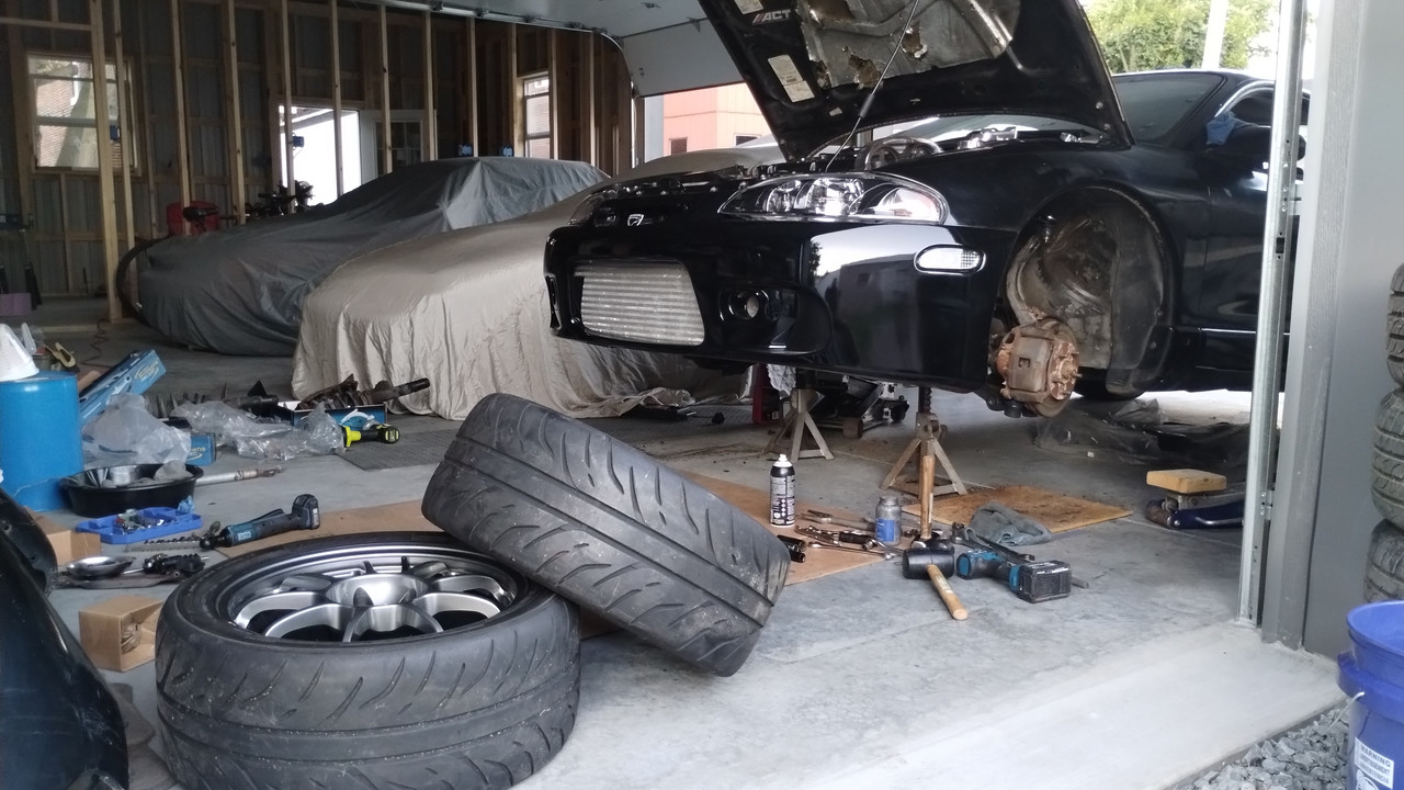

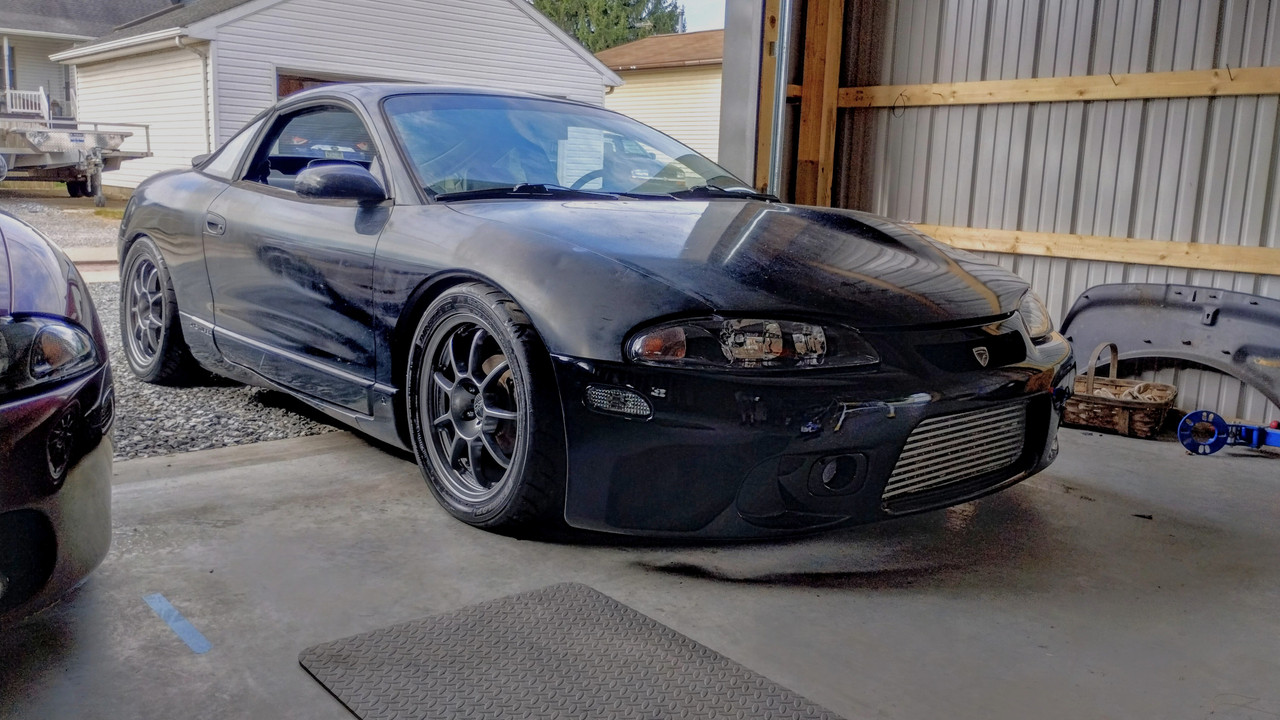

And now.....the fitment
[url=https://postimg.cc/7bXjPXCm]
golfduke
golfduke Dork
7/3/24 7:45 a.m.
oh damn, that looks so good.  That was always a big head-scratcher for me-  Mitsubishi/DSM put out some wickedly awesome cars in the 90s/00's, but never seemed to figure out how to get rid of MASSIVE wheel gaps from factory.  I remember seeing my first 3000gt, and remarking at how unreasonably high the ride height was.
That looks freaking amazing though.

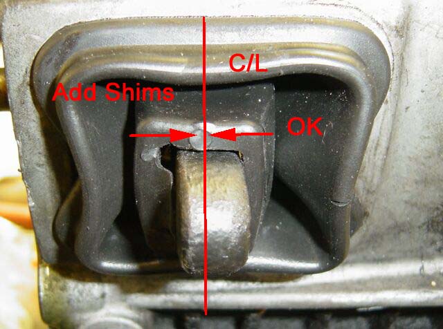

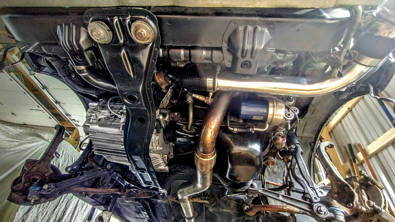

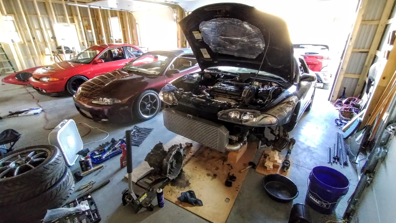

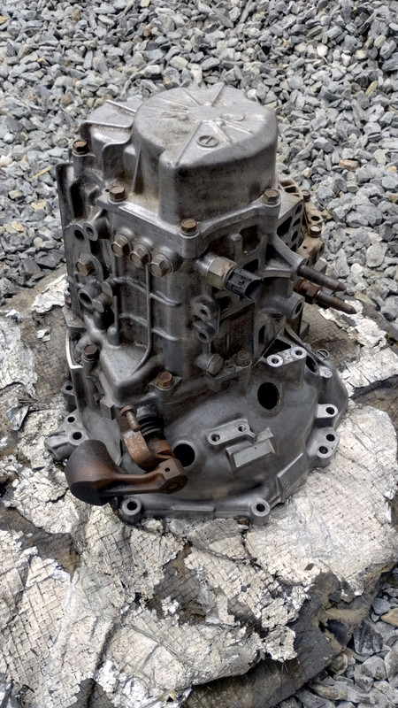

Bled the slave cylinder. Took awhile had disengagement issues. Slave and master are moving the clutch fork, but the clutch fork is not sitting in the right location. Master is adjusted all the way out. So that means one thing: You have to shim the pivot ball to move the lever over. Just a big washer basically.
Sooooooooooooooooooooooooo.........I have to drop the trans to add the washer.
Soooooooooooo this car will not be on the road until it's NOT 92° OUTSIDE. I'm not dropping a trans in this heat.
I'll keep futzing with the susp and E36 M3 but I'm going to have to do a bunch of not fun things and drop the trans out.

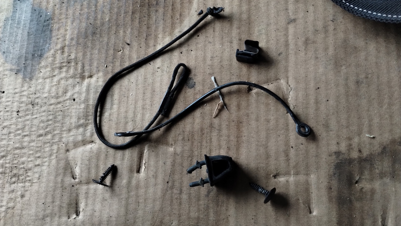

Welp, I got a box fan and it kept me cool enough to.....yeah

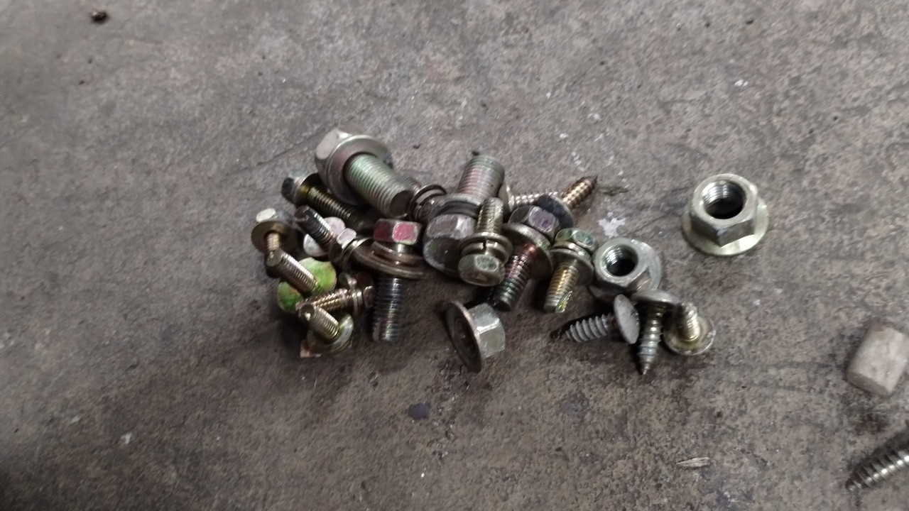

I found some much E36 M3 wrong, I can't believe this was on the road. Like missing bolts and E36 M3

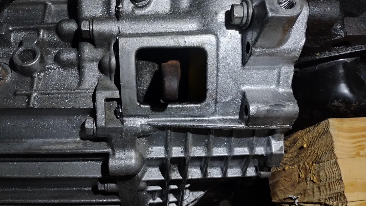

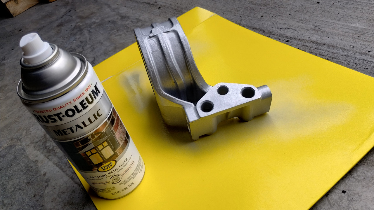

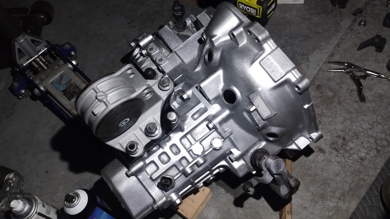

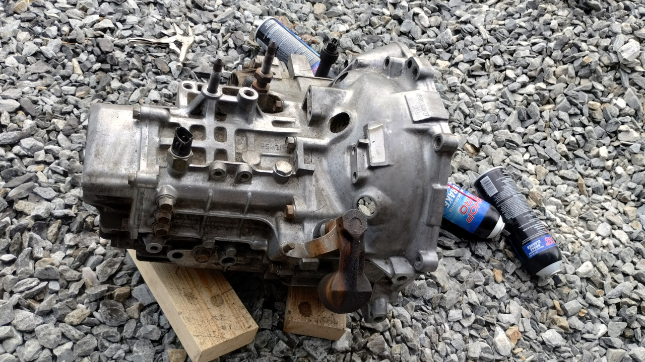

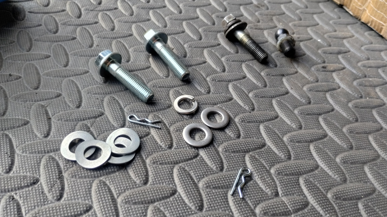

Got some hardware, spacers, shims, and cleaned up the case. I have to finish cleaning, get some redline mt-90, and get this shimmed and back up in!
ETA: junkyard run for small parts....grabbed gas door items, and some nice clean 3g eclipse floor mats, which fit nicely. I also got some mt-90!

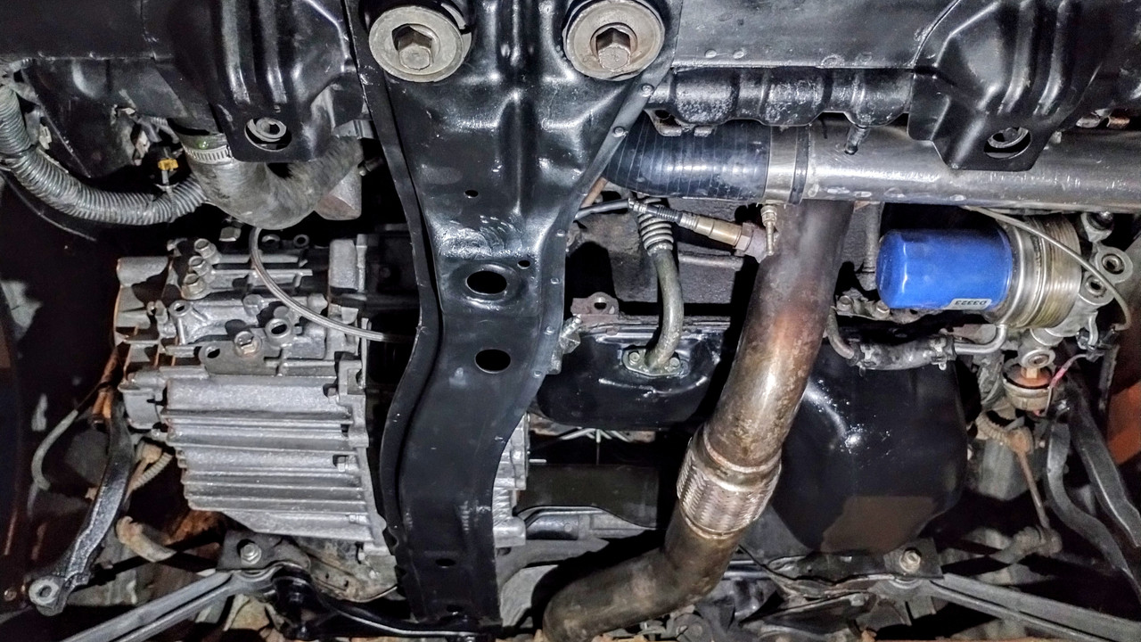

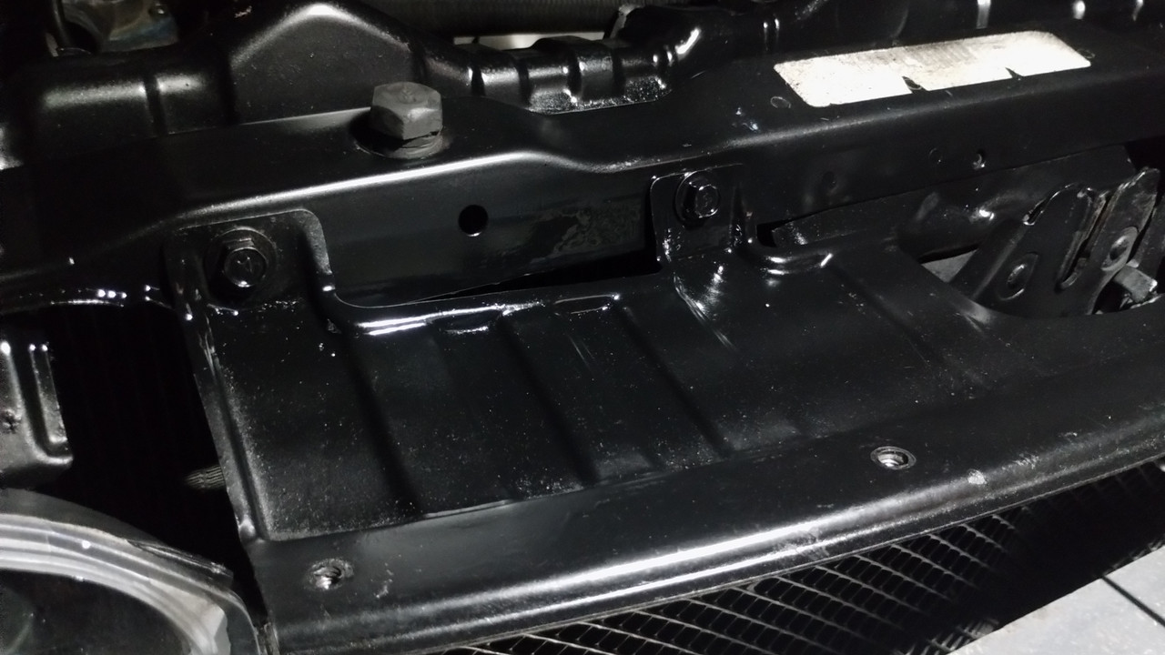

Trans was painted, motor mount restored and upgraded. Painted the bolts that were cleaned up so they don't rust, and did some more frame rail area clean up and fresh paint

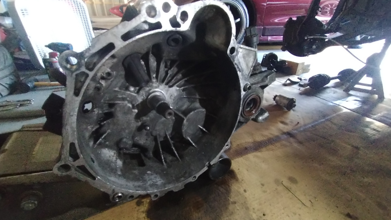

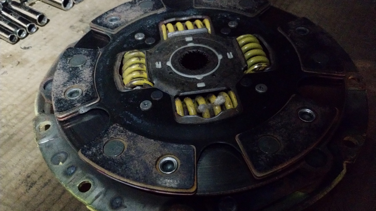

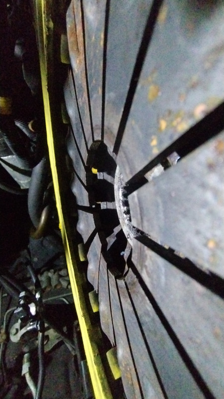

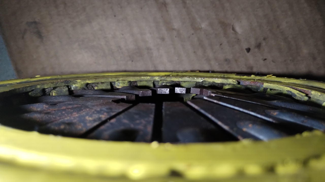

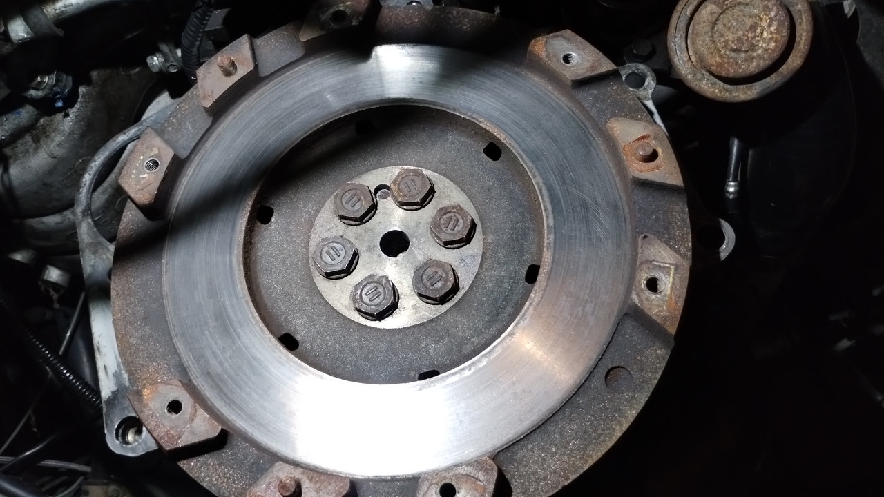

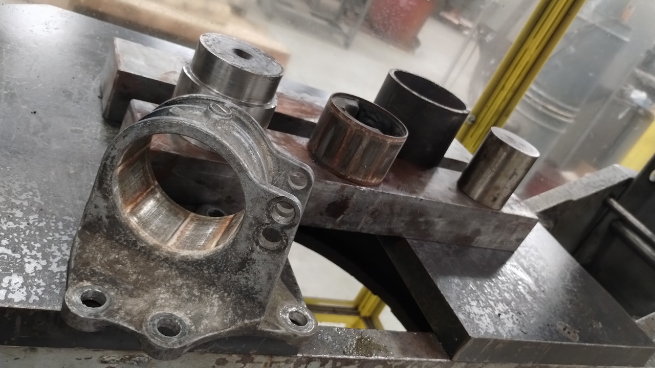

Final trans reinstall issues, seeing other issues as well. Taking time to unfvck this car as I keep hitting issues that need fixed. Pressure plate looks weird. Fingers are not evenly tensioned and they are flat.
I ordered a new.......$385......pressure plate. Grrrr. As u can tell, the clutch is almost new. I actually put this in back in 2019 or so.

Proper new PP is here and u can see the difference
So it's 3am...and it's in 😂 😂 😂
I ended up having to remove the shims. The new PP is properly sprung and will work. The fork is aligned and it's all in. I'll finish up the rest this week and maybe this weekend get a pic of it out of the garage and driving.
I have to do brakes and some rear suspension stuff and new tires. Getting down to it.

What kind of paint did you use on the trans? It looks amazing
HaveBlue83
HaveBlue83 Reader
7/17/24 12:52 p.m.
In reply to maschinenbau :
Rust-Oleum 7271 silver metallic. I REALLY like this color. Looks like a new trans.

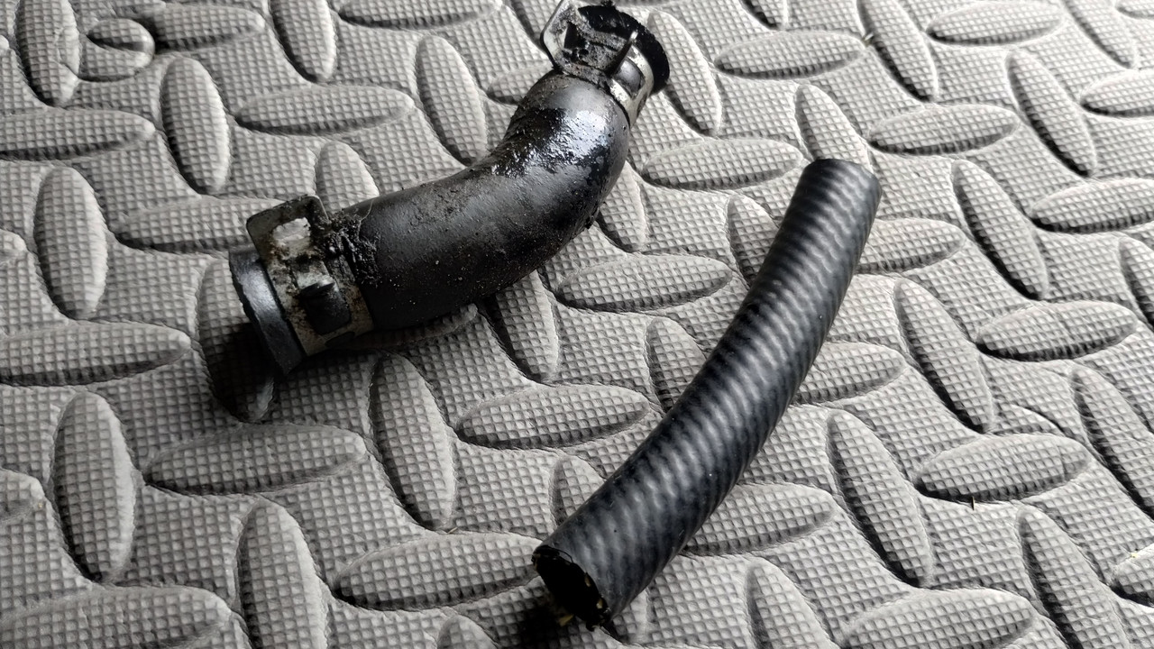

Awaiting rad hoses and caliper paint.

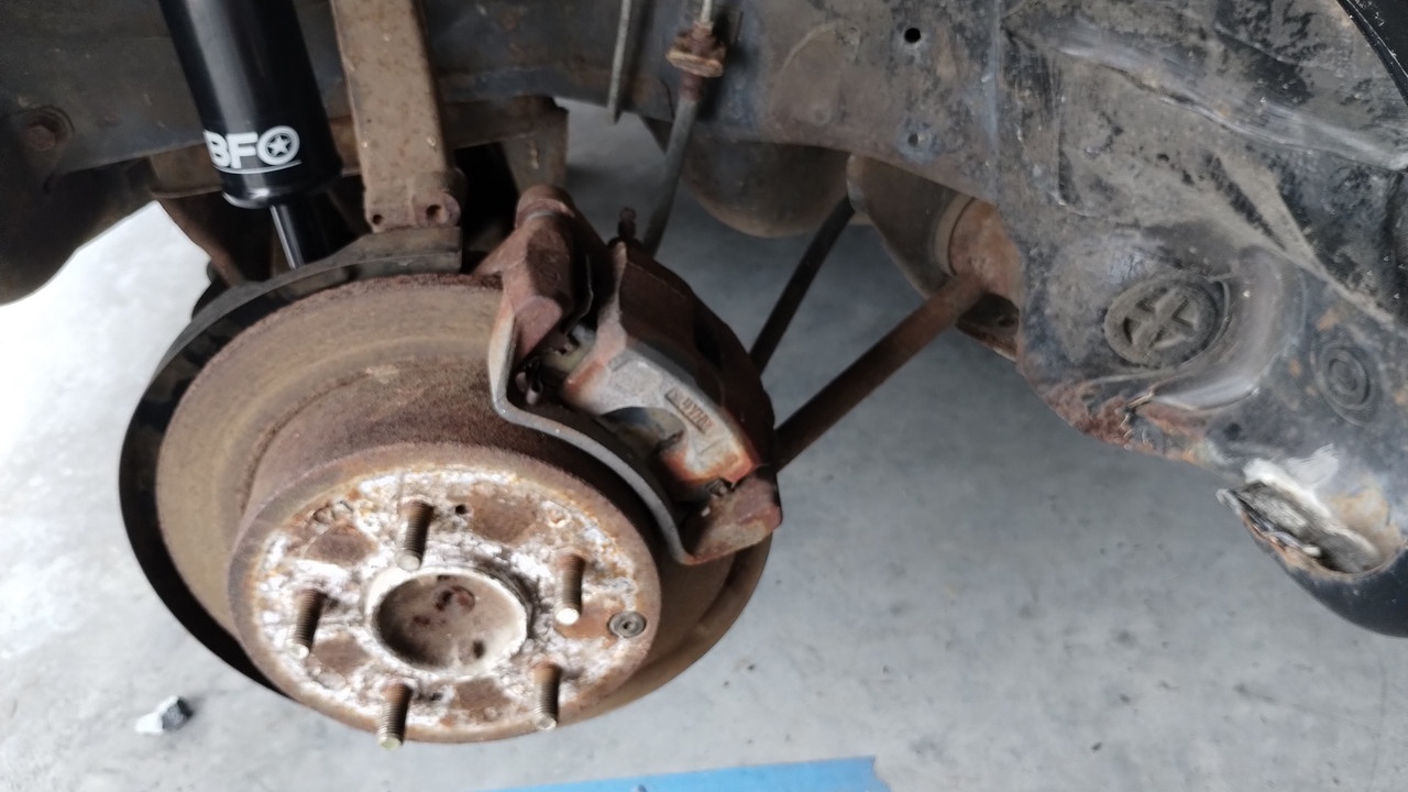

7/23/24 9:53 p.m.

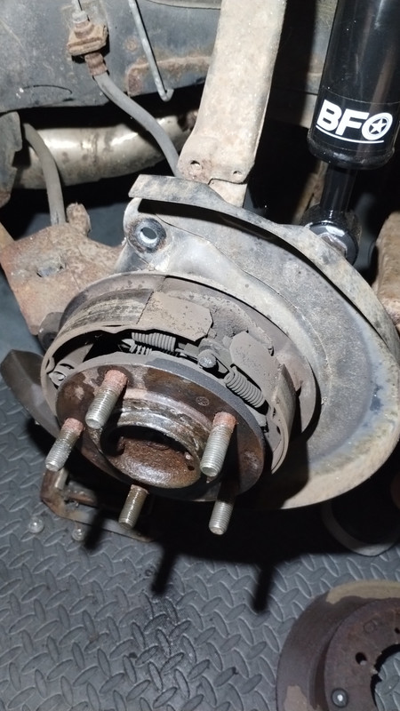

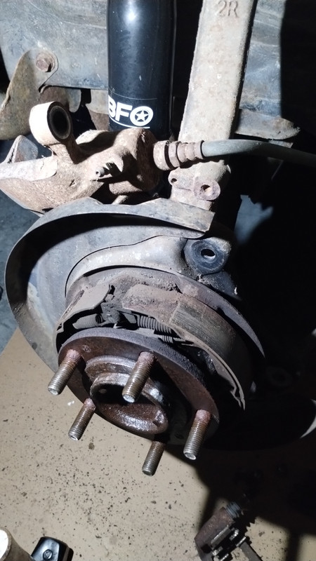

Might just buy new rear calipers and brake lines too......these look like I should just do that.
Was prepping for caliper paint that just came in but now I'm like....imma hit the $120 easy button for new. Here's the back end pre clean up, rotors are now off:
