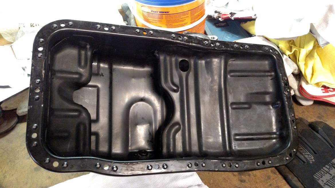

Next up was the oiling situation...the internets seem to suggest the B series engine is pretty decent about keeping the oil around the pickup with DOT racing tires but a little extra precaution should not hurt either so picked up the Password JDM oil pan baffle kit and put that in.  Pretty basic kit that seems to replicate what the Mugen pan does for the baffles.
Pulled the pan and was pleasantly surprised how clean the pan was, for the most part.  Not a lot of sludge in there and could not see any metallic flakes so was pretty happy with that.  Test fit the parts and sanded the paint off of the pan surfaces for welding and welded it in.  Was a little worried about burning through the thin gage material of the pan but this went pretty well.  Did end up burning a couple corners off the side baffle gussets but I don't think this will hurt anything.
Reinstalled the pan and buttoned the exhaust back up and filled it with oil.
