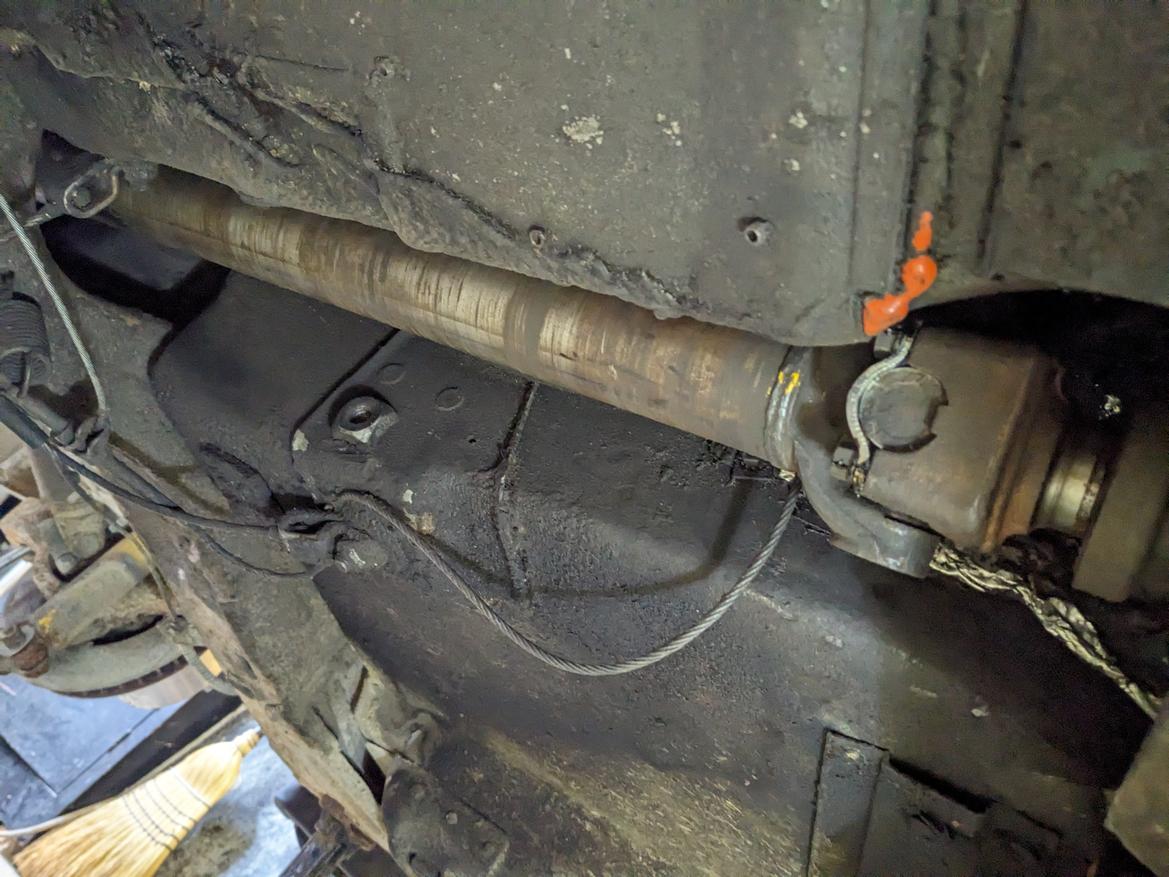

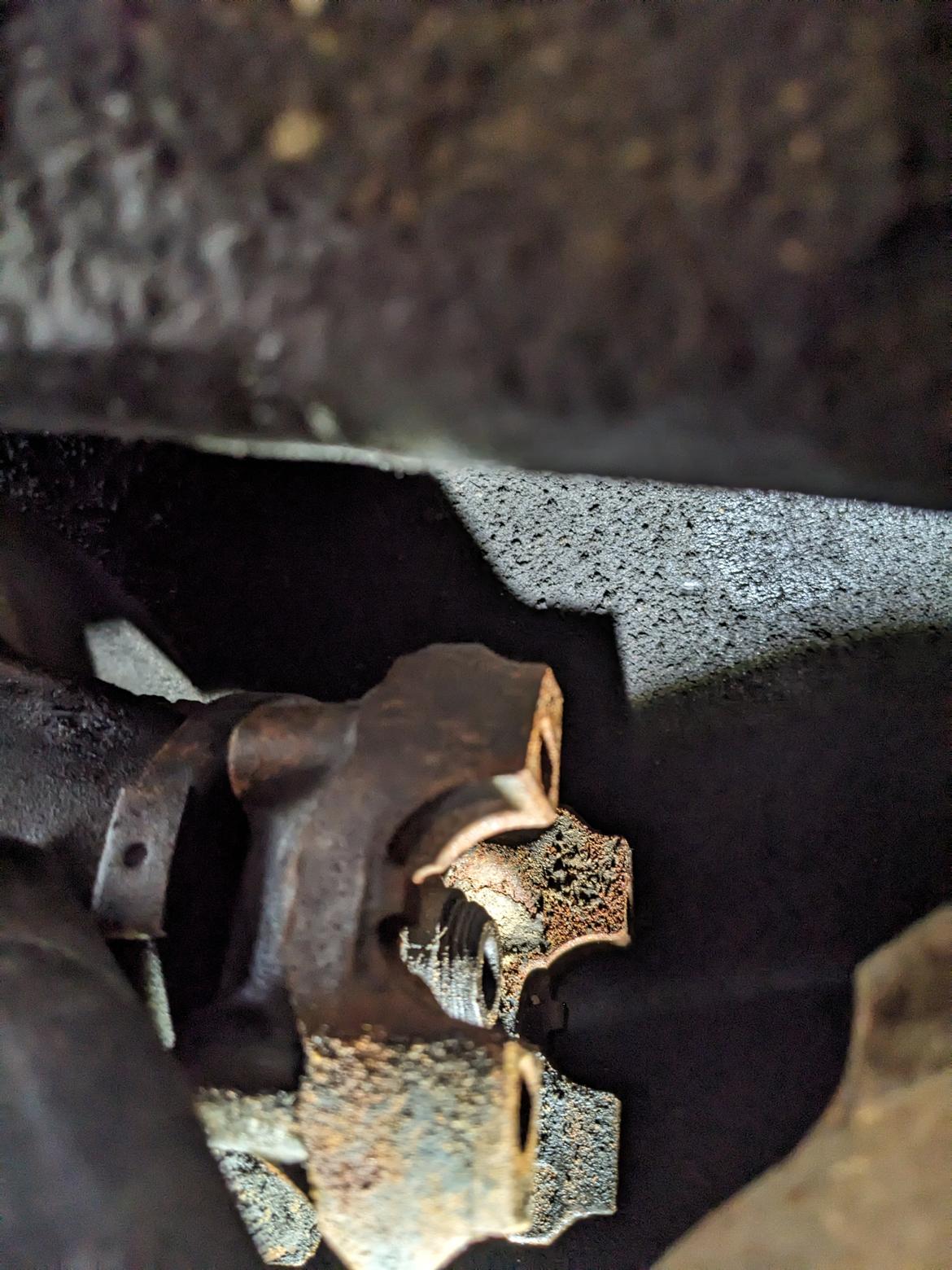

Started the white board check list.  Vacuumed the interior. Those mice/chipmunks have been busy. No more!
Now I need to determine what caps or straps I need for the u-joints on the driveshaft and the output shaft on the trans (4L60e). Apparently those have gone missing. Don't recall what style they were. Are they interchangeable?
This is the diff end.
This is the output shaft.

I did pick up a Dorman strap kit, but not home to try them.

Today was garage day. My wife is taking pity on my because I have to chaperon the Prom tonight.
Got all the u-joint straps. Wrestled with the driveshaft for the better part of 4 hours to get it installed. But hey, what's 4 hours when it's been sitting for 6 years or so? I needed to disconnect the rear diff front mount as well as the batwing support to pull the diff back about a half inch so I could slip the driveshaft into the output shaft of the transmission. This was not fun and I will feel it tomorrow for sure. It's tough being 56 and inflexible!
Previously I cleaned out the interior. I think the carpets need replacing.
I actually crossed something off the list! But added more than I crossed off. Womp womp...
It was not a fun job under the car on my back. But it's done. Next moment of freedom will be done in the engine bay or dropping the fuel tank.
