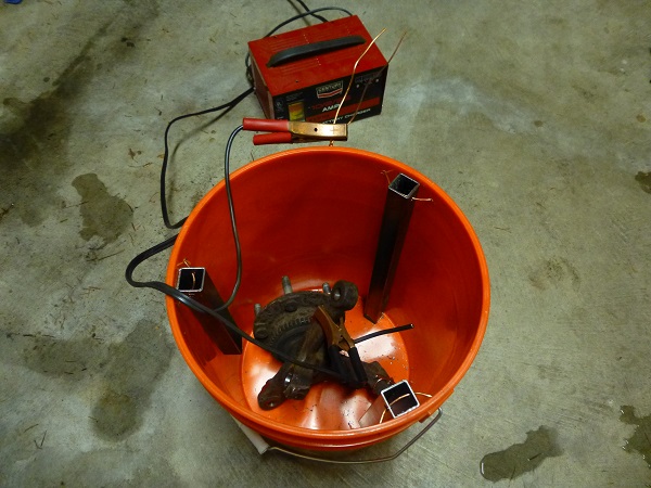

So here the setup for my little ‘science fair experiment’ that I ran over the weekend.
There is an array of three pieces of scrap mild steel^ that act as the anode, being sacrificed to the car gods. Well, I hope they were scrap. But it’s been a long time, so I’m not totally positive. Then again, if they weren’t scrap before, they certainly are now.
The part being de-rusted acts as the cathode, and the battery charger supplies the necessary electrical current. The bucket is then filled with an electrolyte solution^^ typically made from 1 tbsp washing soda or baking soda per gallon of water. Apparently you can also convert baking soda into washing soda by baking it…Which begs the question of whether that means you can also convert washing soda into baking soda by washing it? Anyways, after adding 4 gallons of the electrolyte mixture to the 5 gallon bucket, I was ready to go. Almost immediately after plugging in the battery charger, set at 12V/10A, it started to work. There was a ‘fizzing’ of hydrogen^ and oxygen being released, and while rust particles began to invade the solution.

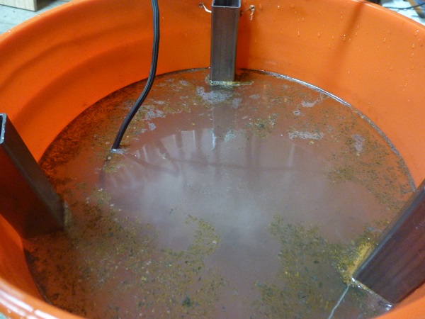

After a while, the water began to look much less inviting.

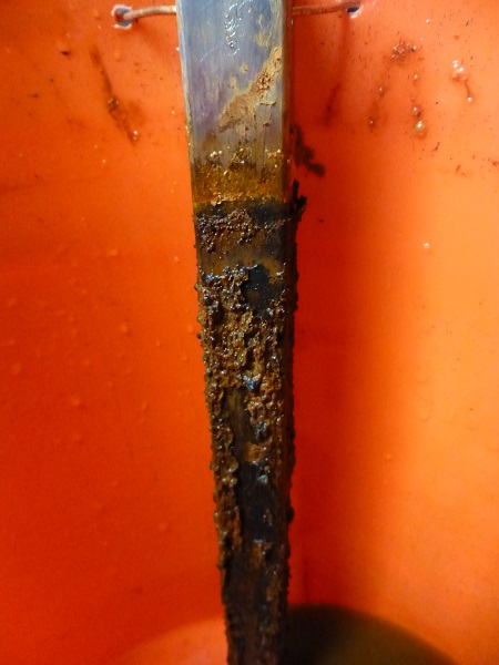

And whenever the amperage would drop into the 2A-4A range, I knew the anodes could use a cleaning.

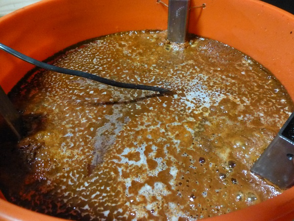

At this point, I would skim the surface of the water to remove the sludge buildup on the surface…After unplugging the battery charger of course. I would then remove the part from the water (rubber gloves are helpful here), transfer almost all of the solution to a second bucket, dump the little bit of heavier sludge**** that had settled on the bottom, clean the anodes, put it all back together, and top off the water. Remember that while the release of hydrogen and oxygen may lower the water level, the no sodium carbonate is released from the solution. So the only need to add sodium carbonate that needs to be added is to account for any solution lost during de-sludging.
As time passed, obviously the amount of rust particulate in the solution increased. However, I also noticed a corresponding increase in the frequency of needing to clean the anodes, and the aggressiveness with which I had to do so to get good amperage when I resumed the process. Early anode cleaning was sufficient with a wire brush, but as the electrolyte became more contaminated I would then hit it with a flap disc on an angle grinder too. Of particular interest was that the spindle didn't appear to be changing anymore, about 12 hours in or so, but I was still getting the floating red sludge. So I decided to totally change out the electrolyte solution, and hit the anodes with an abrasive disc again. Voila! There was nothing but pure electrolysis for the next few hours, with virtually no new rust particulate in the water, rust formation on the anodes, or loss of amperage. My experiment was complete.

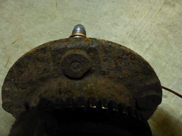

So now on to the results of my electrolytic rust removal ‘science fair’ experiment. You’ll notice that I used some extra solid copper wire to ground the hub rotating assembly to the spindle. This was to ensure a good electrical connection between the two, ensuring the treatment would act on both. Don’t worry about any potential side effects on the longevity of the bearing, as I planned to replace them all along anyways. This just allows me to use what I’ve already got for measurements and mock-ups.
Picking up where the experiment left off last last time, is the spindle immediately after the electrolysis treatment had completed:
Quite a difference! Now that pretty black coating electroplated on it is actually not desirable, and needs to be removed. Also note that some areas, like the rotor/wheel register don’t have it. That’s because this process only acts on the rusted surfaces, and any rust that was in those areas was little more than superficial surface rust. I chose to let the spindle soak in a mild acid solution (Distilled Vinegar) for an hour or so to soften the black coating, This was followed by a good thorough scrubbing with a small wire brush, revealing the bare metal underneath:
