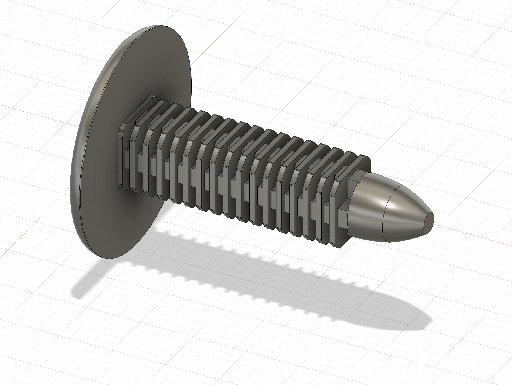

But in the meantime, it's time to solve my broken fastener problem. There are three types: the usual push pin that's used on the side panels, a slightly smaller one that's used to anchor the carpet and a color-matched cap for the screw heads. The push pins are the ones that took the most damage even with the correct tools, they're nearly 40 years old and brittle. You can buy replacements at NAPA - but only in black. I wanted some to match my blue interior.
Well, this is the sort of thing that 3D printers are good at. I sourced some blue ABS, it was way too bright. I found some "Fighter Jet Blue" ABS from Paramount 3D that looked really good, and it turned out to be a perfect match. I spent some time building models and voila!
Those are the original parts off to the side. I found that the "bristles" on the push pin were too stiff on the ABS, so I made a second version with altered dimensions and fewer bristles. I've got a third design I'm going to try with a middle ground number of bristles (that's it in the model above), but in all but one case the second design is working perfectly. Goes in with a bit of a push and holds.
How do they look? The cover on the left is stock, the other is my reproduction.
The push pin looks pretty good too.
Yay for modern tech! What a ridiculously cool tool to have in your garage.
7/12/23 8:41 p.m.
Final version was the bomb. I'm going to put the model up on Thingiverse for other Hondaheads.
Here's what version 2 looks like after use.

" I spent some time building models and voila!" I'm thinking that there are other threads on the forum discussing in depth the intricacies of 3D modeling? What was the degree of difficulty with these or was it an 'ain't nuttin to it' type of exercise? oh yea well done maestro!
7/12/23 10:57 p.m.
Let SkinnyG show you the way.
It's not a terribly difficult model. It could be used as a beginner how-to for Fusion360.
I drew a cross-section of the part and then rotated it (like turning a part on a lathe). That gave me the basic shape, especially at the head and nose. Then I used another cross section on a different plane and extruded it out to form the cross shaped supports and trim the circular bristles into their rounded square shape. That all got mooshed together into a single piece.
The hardest part is coming up with how you're going to construct the model, and different 3D programs have different ways of doing. Correction, that's second hardest - the hardest is getting all the dimensions right when all you have is a piece of a damaged original :)
