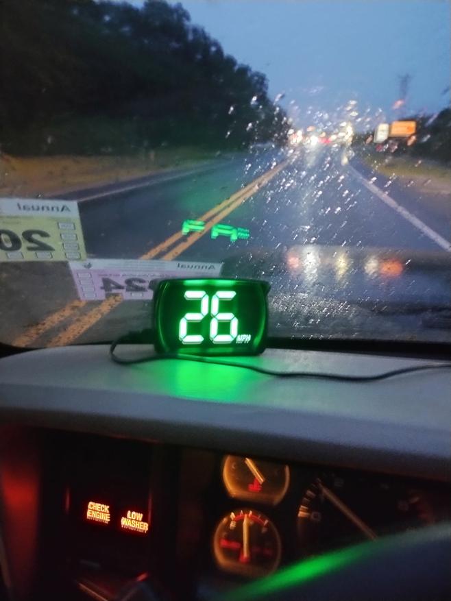

Test run on my GPS Speedo  that just came in the mail. I started putting together my dashboard for my first drive. Want to have oil, water, tach and speed speed all functioning before going out on the street. All the other gauges are JEGs brand but the jungle site GPS Speedo(as recommended by Doc Brown) is about ¼ the price.
