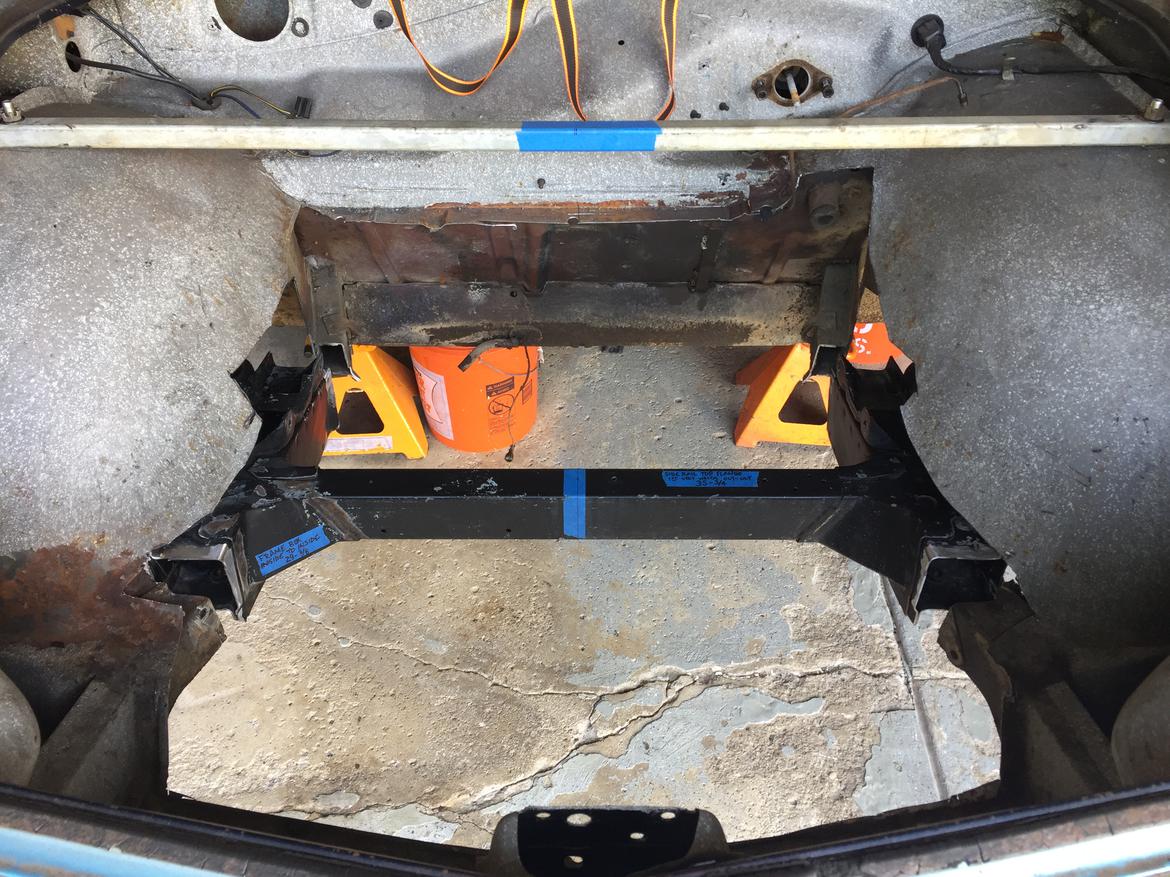

Well, I sure hope my measurements were accurate...
AngryCorvair
AngryCorvair MegaDork
7/5/19 10:16 p.m.
Looks like I got the length and height right on both sides, but I have some clearancing to do before the C4 frame section will find its home.
Its been a long day.  Tomorrow I will test-fit and trim as necessary to get everything where it needs to be, then drop it out to prep everything for welding.

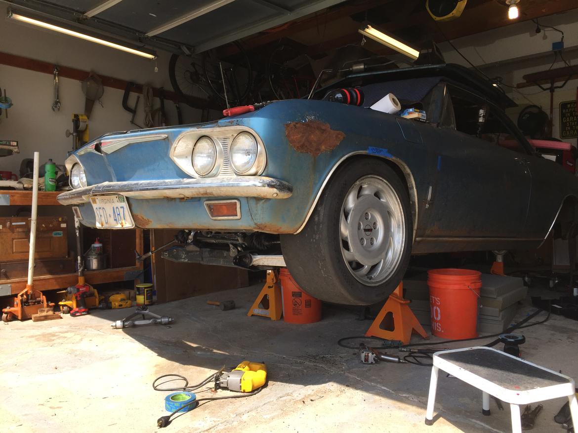

C4 front frame section tacked into Corvair unibody.  Probably measured and trimmed 15 times to sneak up on all the dimensions, but I think it’s where I want it.  Gonna assemble the suspension to make sure the wheels are in the right place, then start making all the pieces to tie it all together.
EDIT:  mad respect to those of you who have developed the skills to do this in a reasonable amount of time.  It’s taking me *a lot* longer than I expected.
Stampie
Stampie PowerDork
7/7/19 11:13 a.m.
In reply to AngryCorvair :
How are you making sure everything is straight?  I'd think you'd want a lot of strings parallel to the car and lots of measuring to keep the subframes aligned to the centerline of the car.
AngryCorvair
7/7/19 2:00 p.m.
In reply to Stampie :
Strings would have been smart.  Reading a book on how to do this stuff would have been smart.  I did neither.
I arrived at this point by taking a lot of diagonals, verticals, using a digital level, various and sundry straight edges, and probably way too much eyeballing.
I’m really counting on the magic purple crack to make up for an eighth here and a sixteenth there.

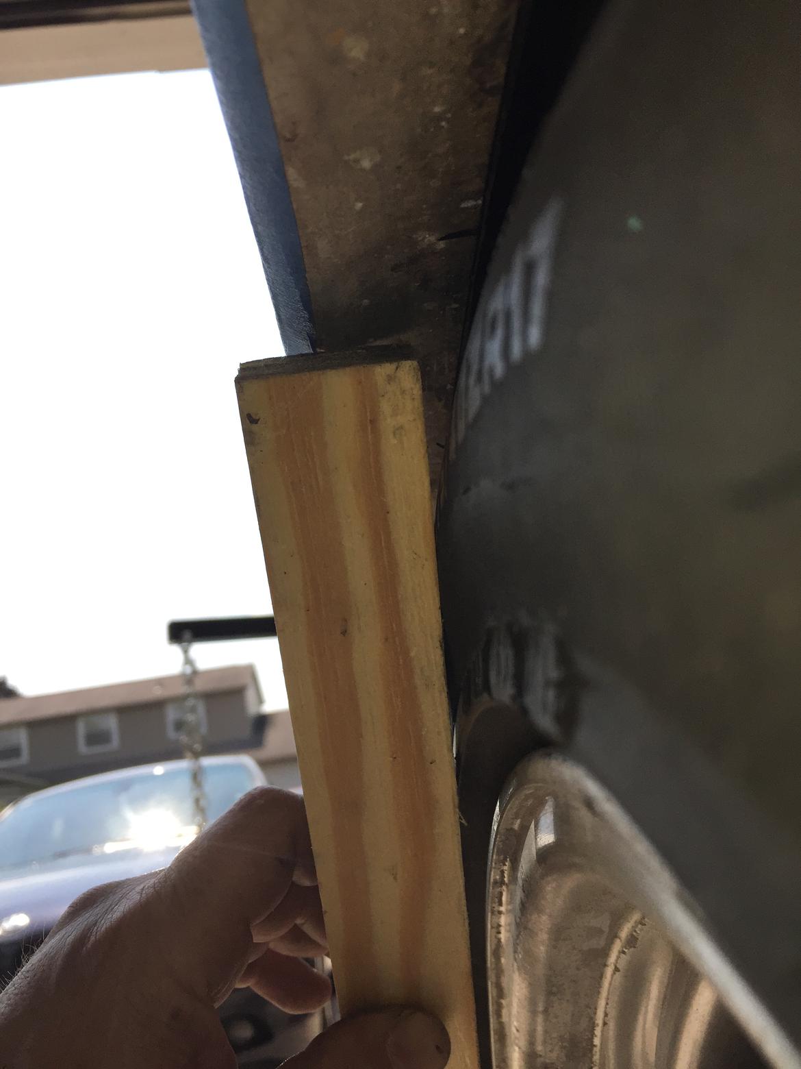

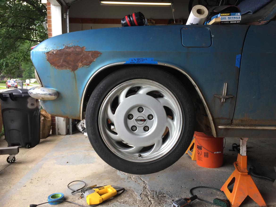

I don’t hate it, but I think I’m going to move it back by 1/2”.  This is ride height.  It tucks about 1/4”, and I’m going to have to narrow / roll the top of the wheel arch.

Id say 3/4 back. And hopefully its just tacked at this point.
How does the column to box angle look?
And add negative camber up front. The more negative, the less tire contact.
And this is a big milestone. When all the basic components are located and tacked in, the real work starts. The millions of brackets, lines, threaded holes, subassemblies, etc to make it from a driving roller to a complete CAR are the fun and brain berkeleying part. Ive spent a year making the miata a car instead of a science project.

You checked the wheel clearance in full-lock each way, right?
Looks pretty cool!
AngryCorvair
7/7/19 9:45 p.m.
In reply to TVR Scott :
It (currently) only goes to lock in one direction, and only when there’s only one tire on the front.  In other words, hard crash of outside tire into front of wheel opening at anything past about 5 degrees off-center.  That will change.
