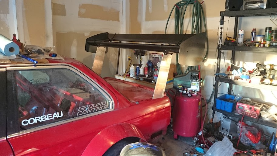

Almost done the wing mount base. Just working on figuring out how big of a diagonal brace I can put over the battery and still leave it enough room to come out
This weekend need to start on the brackets for the uprights, going to do two 1/4" steel plates in double shear, with the 1/2" aluminum uprights going through the fenders

Making progress with the wing mount. One side is ready for the uprights, 1/4" plate in double shear. My compressor took a dump so no plasma cutter for me. Went through 3 cutting discs... I need a freaking band saw.

Wing base finished and installed. Mocked up the upright. Mulling it over now before I make a pair of prototypes out of 3/16 aluminum and then after I'm happy with those, make the final version out of 1/2".

Cut upright prototypes out of 3/16, turned out quite well! A few issues revealed. Will also add a brace to the slots in the fenders for the uprights to bolt to.
