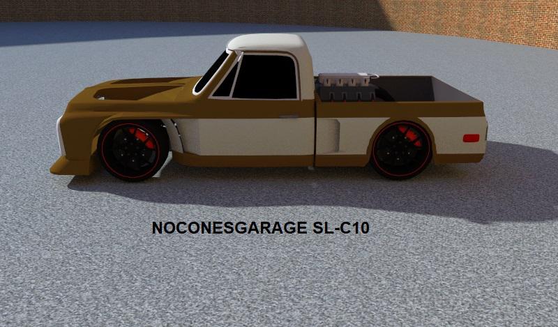

Glad to see so many people excited about this one.  No work this week yet, but this weekend I want to get things shuffled in the garage and get some parts weighed.
In the mean time I've been playing with some concepts for the body.  I'm sure like with the 360 there will be evolution here.  But this is unlikely to be a "sleeper" what with the removal of 3-6" of the bottom of the body, and the MID ENGINE, we we might as well lean into it a little.
The colors here are just random to see what different things look like on the truck.
And with some Hoon worthy livery.

I really like this, the simple, original looking paint scheme with the obvious madness of what's going on underneath!

Any thought of getting it running and driving with the current patina first?
MotorsportsGordon
MotorsportsGordon Dork
2/2/23 10:03 p.m.
Agreed go with the original paint the it looks sharp and less common then the white and light blue
nocones
nocones PowerDork
2/2/23 10:12 p.m.
It's possible it will wind up doing things with the current patina on some of it.  It's going to come down to how much of it gets ground off during modification and if it looks strange or not that way.  The fenders will need a healthy amount of work to make wheel openings that work with the ~10" drop that the wheels have to make.  It's not going to be on bags so the wheels have to have clearance.   The bed will have some zig zag lines in it from sewing it back together as well.   It's really going to be up to Joe on how he wants it to look when it starts to do events.  If he wants it painted it will go somewhere for paint.
