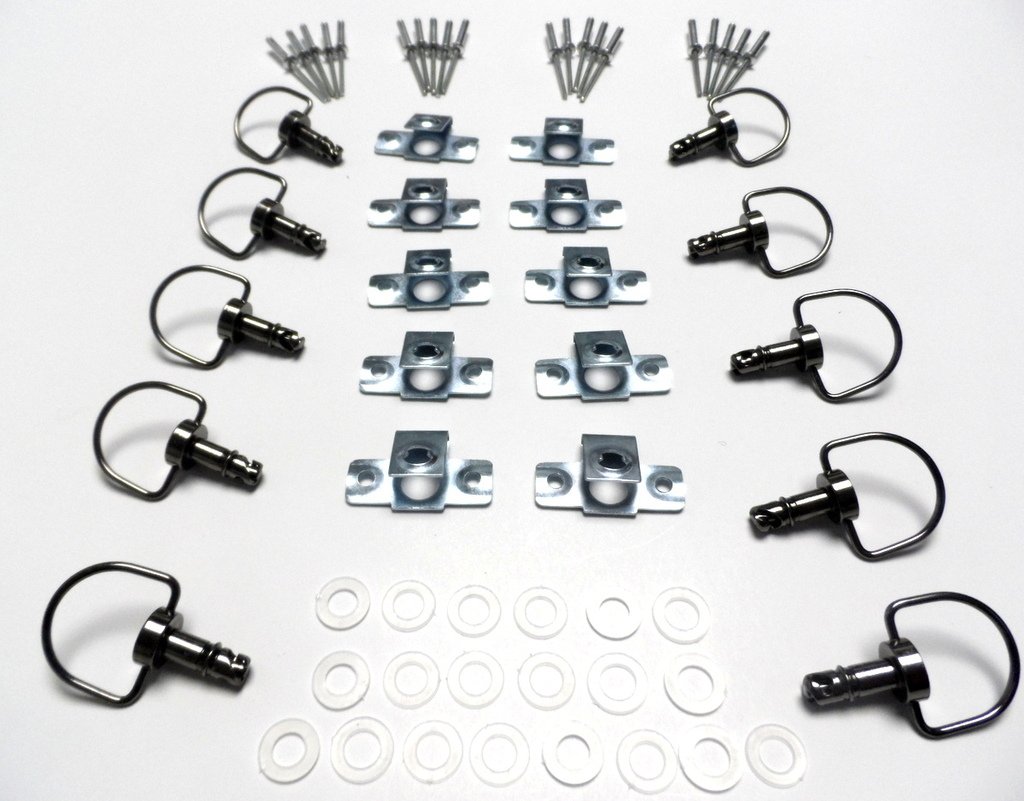

Pulled the tail light panels. Lots of room there. Need to figure out how to put them on a quick release. Ill take ideas there!! Passenger side will get poop tank, drivers will get gas tank for the heater.

I couldn't find a picture of the installed taillight panel- do they line up in a way that would let one side hinge? Then you could put a "slam latch" opposite the hinge and it becomes a door.

Probably do able, they bolt on with six bolts to the two vertical white flanges you see. They are recessed from the back a bit, which may make opening more than 80 degrees difficult.
These may work as well....
