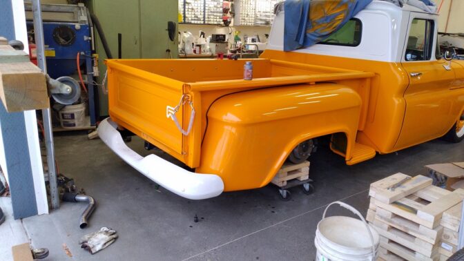

Slow slow progress of late. Bed back on, bumper on, fenders got welting:

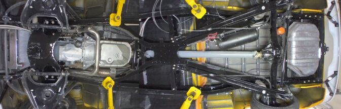

Moved over to the hoist:
I had installed the press-on door seals by Precision, but had to re-adjust the doors so they could at least close and latch, which left a big honking gap.  Yuck.  On the 67-72 Chevy Truck forum, there is talk that 8th Gen Civic door seals fit perfect on a 64-66, and CAN fit a 60-63 with an extra section added.  The Precision door seals look better, but the doors close with the Honda Civic seals.  I'm probably going to be ok with it over time.
Hooked up the shifter.
