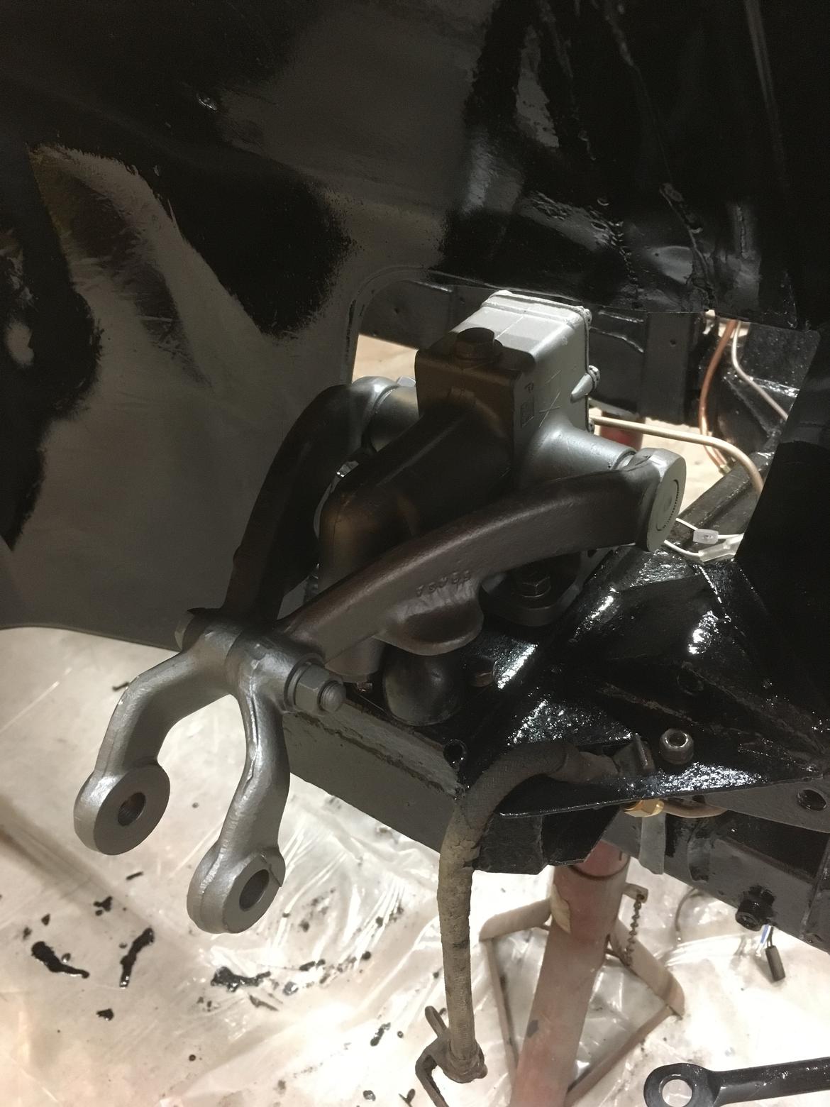

Very little time to dedicate to the Healey this weekend but alas... Kingpins together (jeez I hope I did it right!), lower arms mounted, spring perches loosely mounted, steering column in, idler in, panhard rod in and some other bits and bobs. The replacement iron bush should arrive today meaning there's nothing holding me back from finishing up the suspension. I need to figure out a good way of finding the "center" of the steering column and idler rotation so I can get the arms and steering wheel orientation correct.
