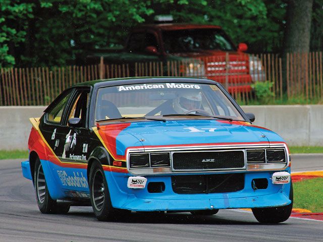

I haven't had a chance to look through the entire post, but I'm hoping you plan to use AMC's Nurburgring livery!!!

I had no idea AMC had a Nurburgring car?!

Yup. Team highball. Won that class that year on bfg radial t/a

Yes sir, and they were very successful! Here's a great article on it.
http://oppositelock.kinja.com/amcs-one-two-finish-at-the-24hours-of-the-nurburgring-719362564

Yeah, the Nuremberg cars were awsome. Theres even a documentary on YouTube about it. Im on the cell phone, or I would link it.

Cool. I found the youtube documentary. Wow. Narrated by a young James Brolin who was one of team drivers. They finished 1st and 2nd in class and 20th overall. Who knew?
