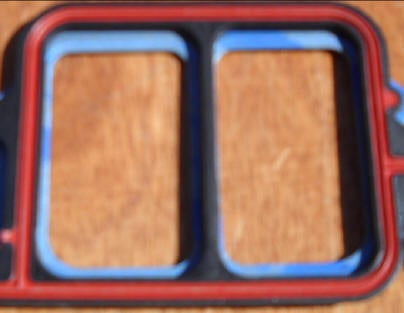

GTXVette wrote: changing to vortec heads require like intake also.look for early 70's corvette trap door oilpan cheap at swap meets. full legnth baffle from moroso also.
Most of the newer aftermarket 350 intakes are designed to use both bolt patterns. Even if not, they can just be modified and bolt on with a shim. I've mixed and matched both ways before.
Crackers
Crackers New Reader
9/16/16 4:54 p.m.
These are the aforementioned shims...
http://www.ebay.com/itm/381236580128

9/17/16 2:33 a.m.
In reply to Crackers:
You sure you aren't thinking of the 87-95 heads? The Vortec ports are tall enough that not many intakes will take that much port work, or so I've read.
Crackers
Crackers New Reader
9/17/16 10:38 a.m.
It's possible I've just been lucky with my intake selection, but that was never an issue for me.
