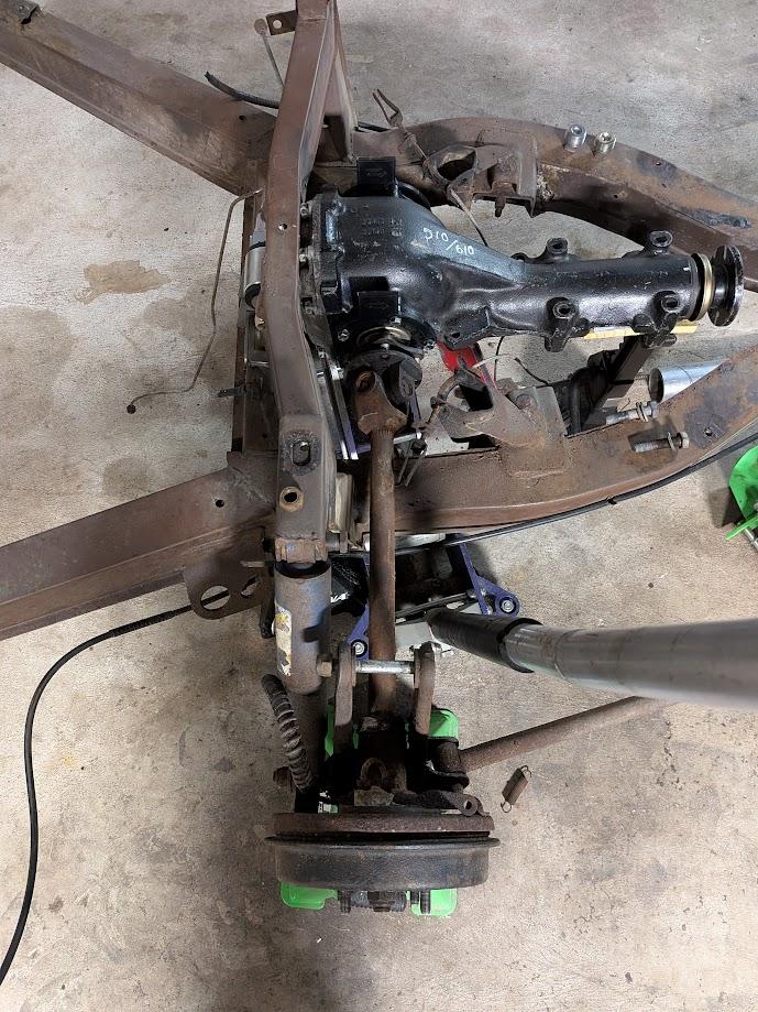

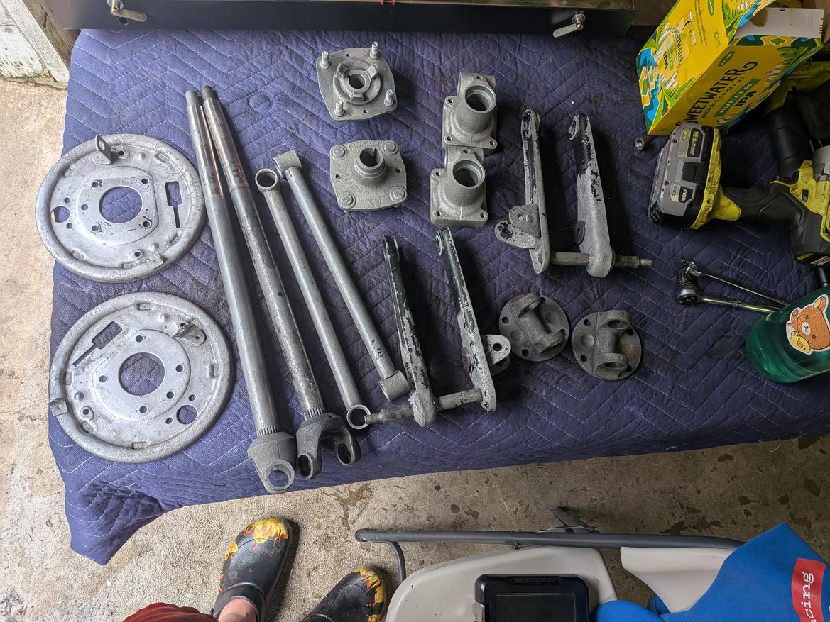

Sketchy garage body off operation completed earlier this year to prepare for diff swap and getting the chassis road worthy again.

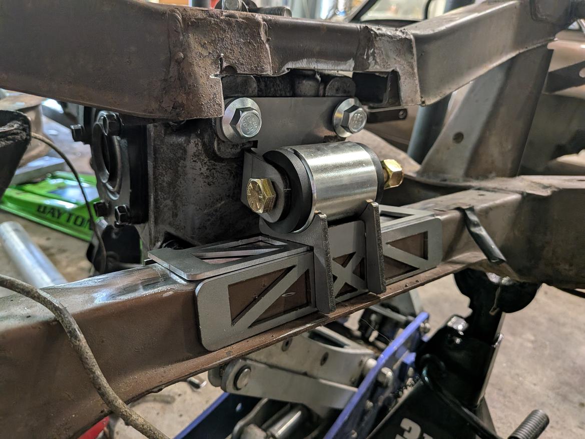

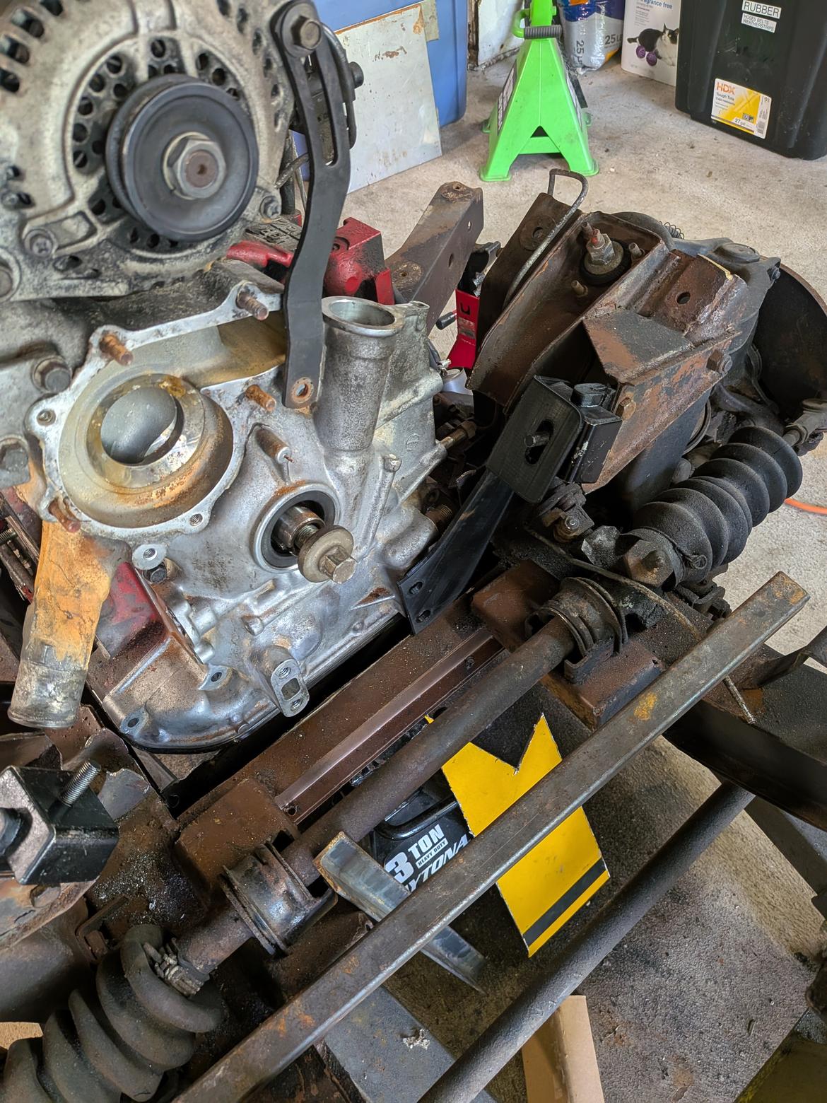

Engine and Differential positions are locked in and have begun 3d printing test fits for brackets that will be online order laser cut.
I chose to clearance the rear strut cross bar to make room for the R160 differential rather than use a custom rear cover and the stock mounts. Mocked up a few brackets with a poly subframe bushing I had around to create a new rear mount. This will put my pinion angle where I need it for the driveshaft angle as well, bigger transmission and long snout diff make for difficult packaging in a tiny frame.

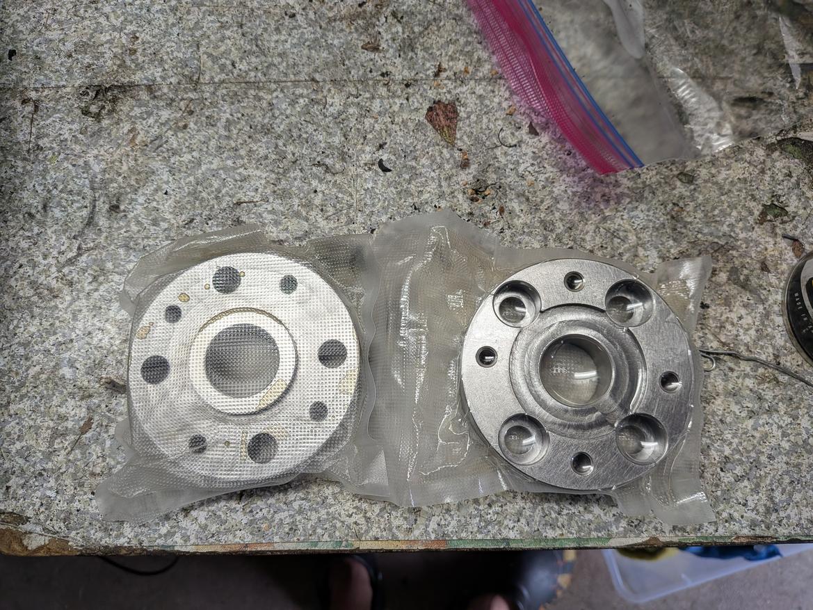

On the engine side, the FC 13b mounts are very wacky and were not suited for the narrow triumph frame. I purchased a 12a front timing cover and lower profile oil pan from eBay wreckers to add some front mount points for the engine. This is a common configuration for 13b swaps into early rx-7, and will allow me to use stock Triumph mounting locations and rubbers off the front strut towers.
