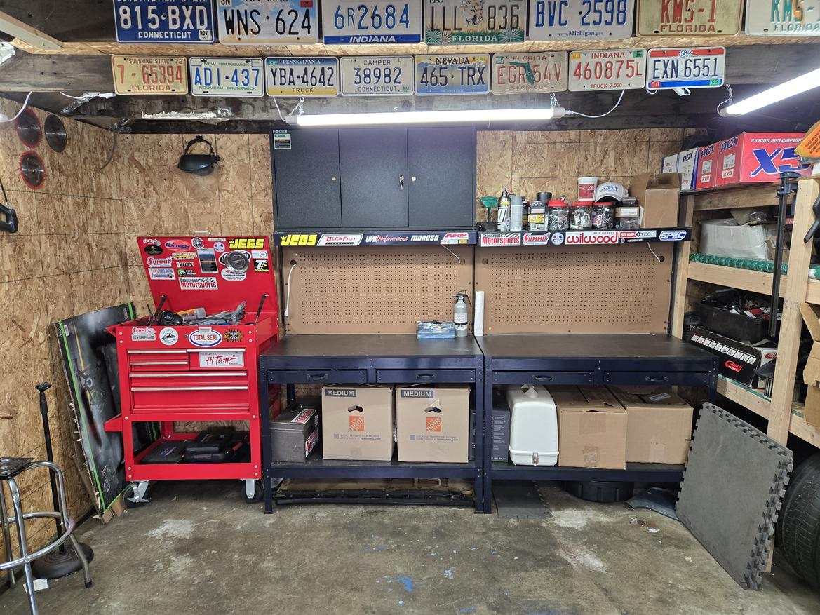

Almost done with the garage project. The middle workbench and hanging wall cabinets got moved to the indoor workshop, and frankly I'm loving that workspace now.
The 15 inch side cabinet arrived and I bolted it on. The drawers filled quickly. I am again, out of space. I had more tools than I thought I did.
Welp... better take a big swing this time. Borrowed a real truck from a coworker.
and picked up another 42 and the side locker. The second workbench went to a buddy and will serve as his reloading bench. I added a set of shelves to replace the overhead storage and a bench vise. it's just about done.
It is soooo nice to have everything in one place.
Just a bit more arranging in the garage and we'll be ready to pull the camaro in.
Soft deadline is the July 4th festival, hard deadline is my birthday in September.
