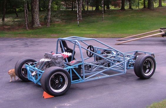

Would you need a reverse gear in the transaxle? It seems it would be easier to run the electric motor in reverse.
7/2/16 12:35 p.m.
This has almost the same fun factor with much less work.

914Driver wrote: This has almost the same fun factor with much less work.
It's not solely about fun vs effort, otherwise I'd just buy an Exocet I do want bodywork even though it's a lot of work. The powertrain(s) will be about the same amount of work overall. There will be more electronics & programming work involved with the EV powertrains but the motor and inverter units are simple and reliable things I'd probably never need to open. It'll pay off in performance and reliability.
Wall-e wrote: Would you need a reverse gear in the transaxle? It seems it would be easier to run the electric motor in reverse.
That's right, no reverse gear needed.
