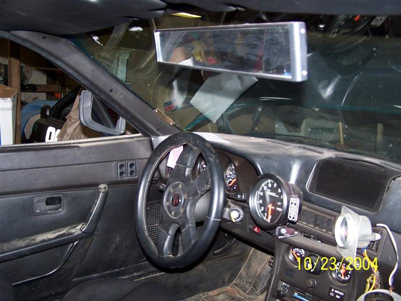

I have a dino wheel for my car. The adaptor that was supplied with it is not properly setup for the plastic piece that trips the turn signals. I got sick of it and put the old wheel back on. I was going to re-drill the adaptor but just never got around to it. I still have it some where in the box's of stuff. A project for another day.
dean1484
dean1484 SuperDork
4/22/11 8:09 a.m.
An old photo with it on my car.
