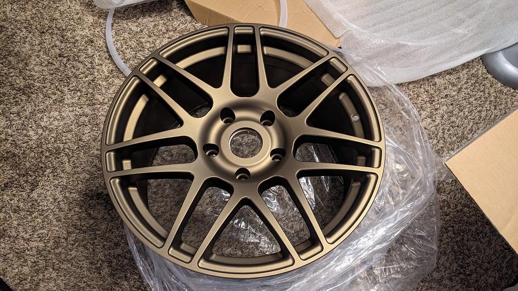

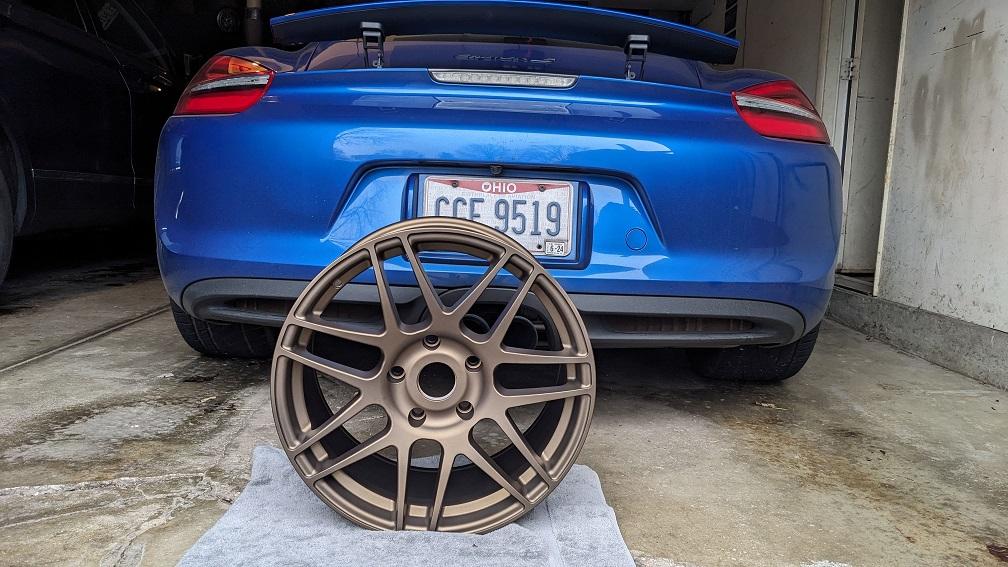

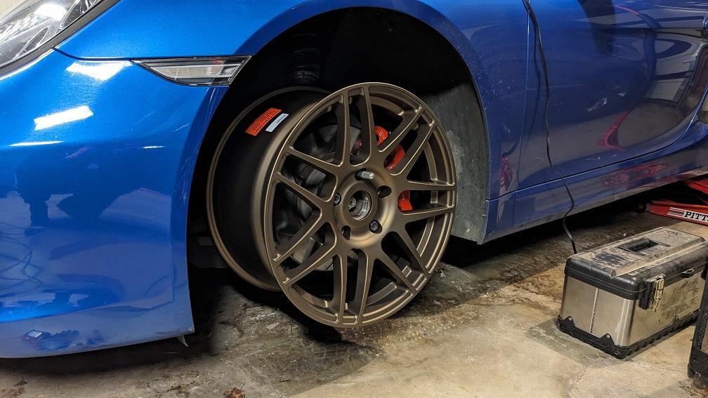

Ended up being busy this week and forgot to post, but some fun stuff has shown up in the last couple of weeks...and now I'm poor for a while.

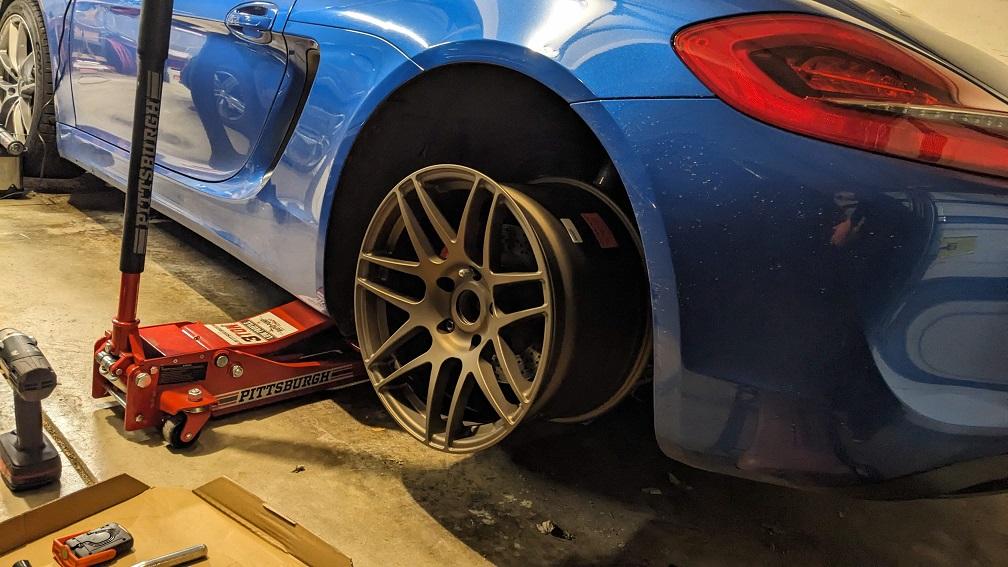

Wheels test installed on the car:
Back when I ordered these wheels I did some fitment checks and a lot of measuring and math with the wheels I had available, but every wheel is slightly different. Considering I'm trying to run a pretty aggressive setup I wanted to maximize the offset and went a bit aggressive, I'd rahter have to run a few mm of spacer than end up with extra inner clearance. So I figured out what offsets I was confident would work and then added 2mm to them. So how did that go? Up front there's no wheel clearance issues, only tire, so that'll have to wait until I get around to mounting the tires. But the rear limit is wheel clearance to the toe link, which I can check now.
Turns out, better than expected. This is with no spacer and it's right where I hoped it would be. It's hard to photograph well but the toe link is tucked within the step of the wheel lip slightly, with 3-4mm clearance axially and just under 3mm radially which hopefully should be plenty.

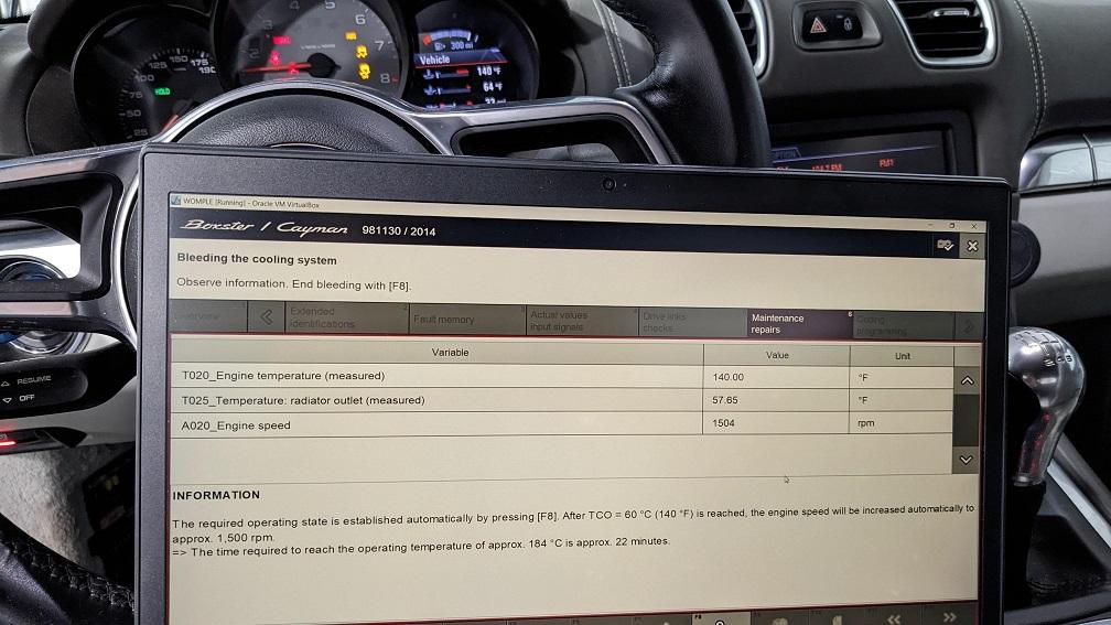

After a long weekend of work, it lives! Of course it's still not quite finished. The cooling system needs to be bled but it at least was able to run long enough to verify that the clutch works and the headers sound amazing.
dps214
dps214 SuperDork
4/4/24 11:13 a.m.
Final step: run a coolant bleed cycle, hope the level is okay afterwards, then drive it home.

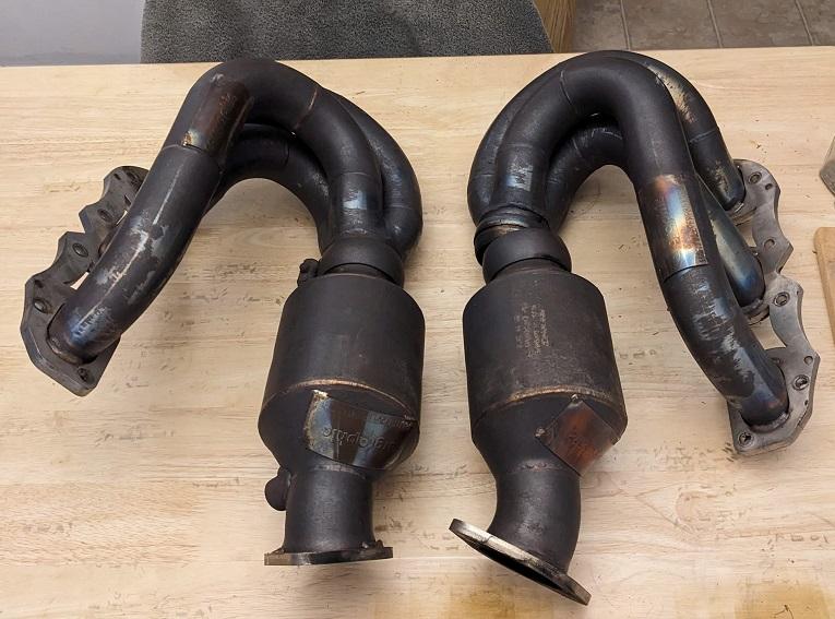

-Cargraphic headers with high flow cats: a huge pain to install but they sound good while not being incredibly loud, the cats work well enough to not make any bad smells or cause a CEL, and the low-mid range torque isn't life changing but is definitely an improvement. Eventually I'll get around to getting a tune which should really wake it up.
