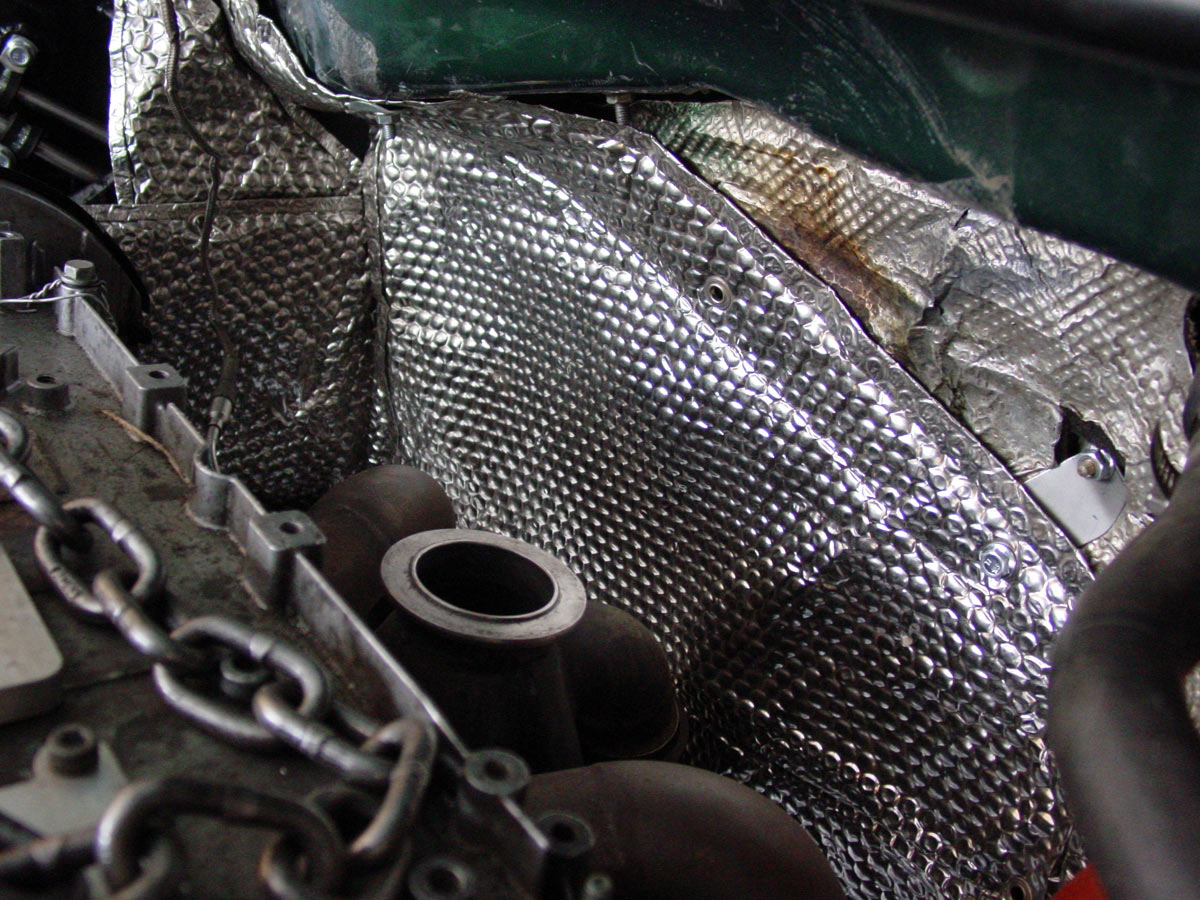

Some good news... kind of.  If the valve was not introduced to the piston, I would not have noticed that the heat from the turbo was melting some plastic bits on the passenger wheel well.  It you look through the little hole on the large melted plastic piece you will see a white tube.  That's the fuel line.
Heat shield is in order!

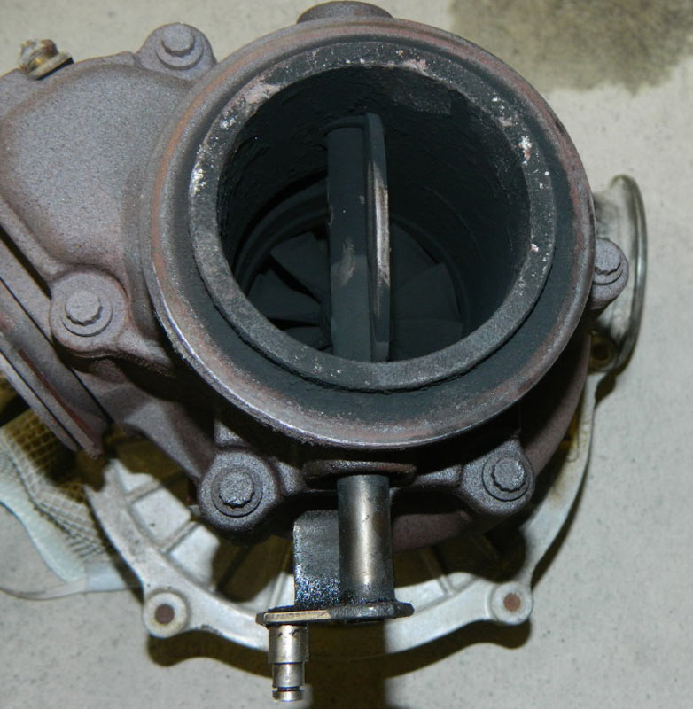

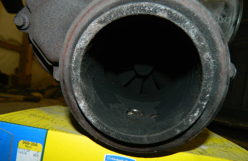

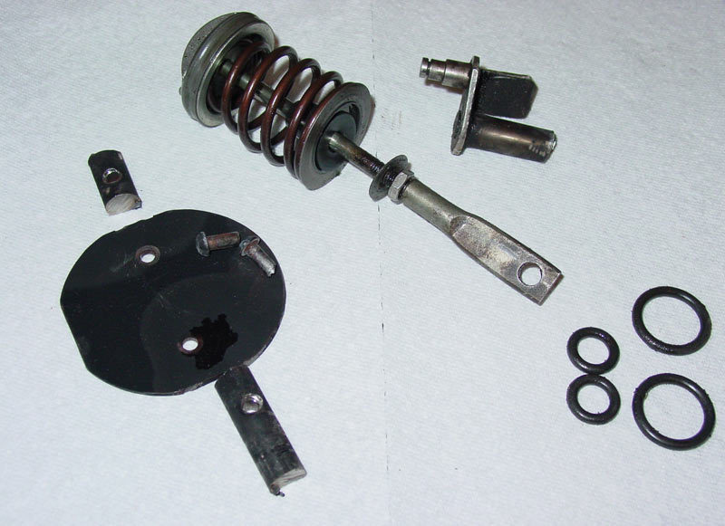

When I got on the throttle, there would be a cloud of oil smoke behind the truck.  To avoid the smoke and oil spray out the back when towing the trailer/car, I would slow down while going up hills to stay out of the high RPMs.  A buddy (Dana) took on the task of addressing the oil leak.

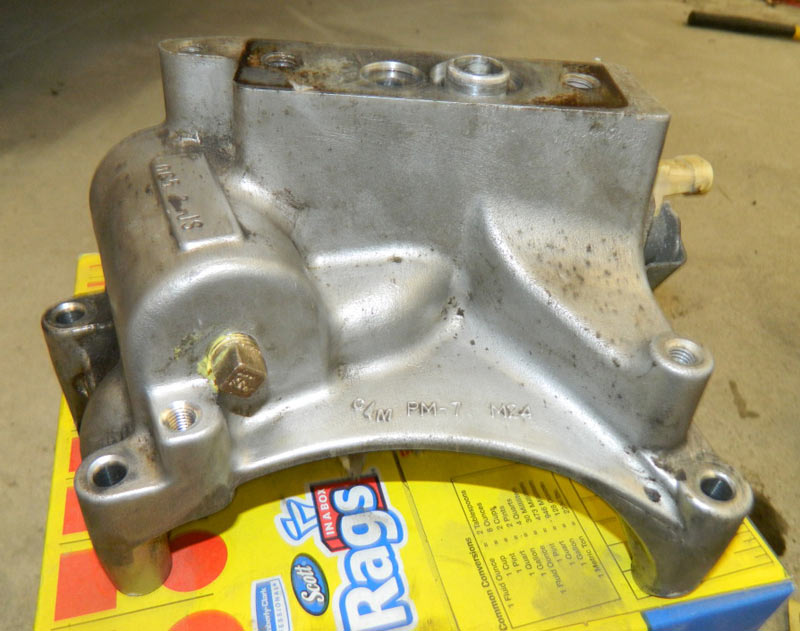

My understanding was the oil was coming from the turbo pedestal so I ordered the four O-rings from http://www.dieselorings.com (funny that they have my exact truck on their home page).  When Dana got into it, he discovered the oil was actually coming from the EBPV actuator on the pedestal that controlled the warm up valve; closes the valve to help the engine warm up quicker. [EBPV - exhaust back pressure valve).
Turbo with the valve.....
Actuator with obvious oil leak around the EBPV....
Removed all the EBPV parts.....
Sealed the pedestal....
No more valve....

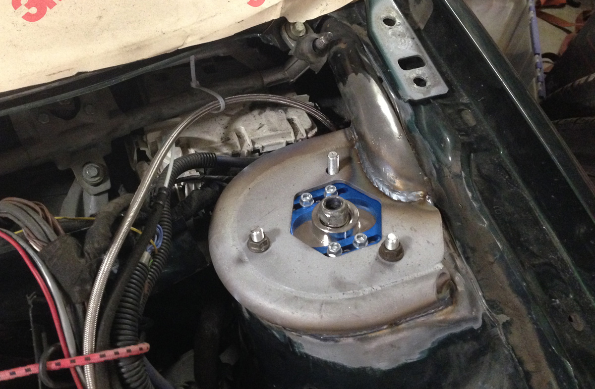

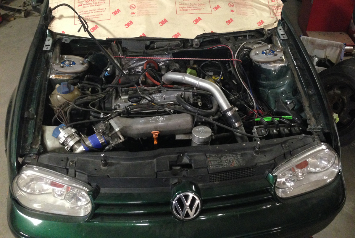

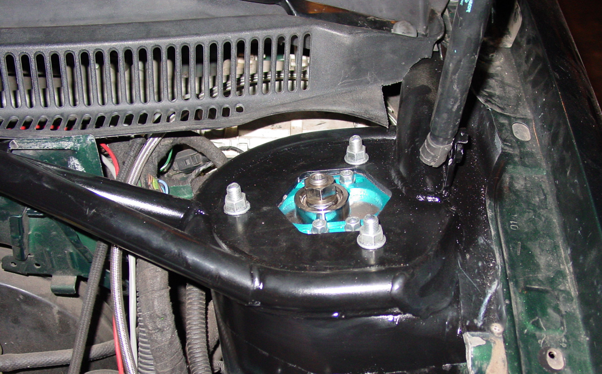

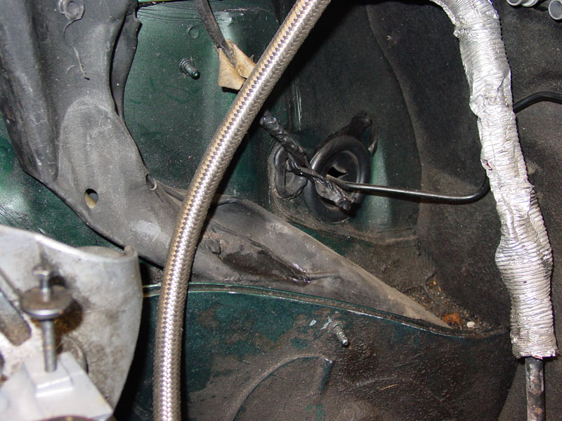

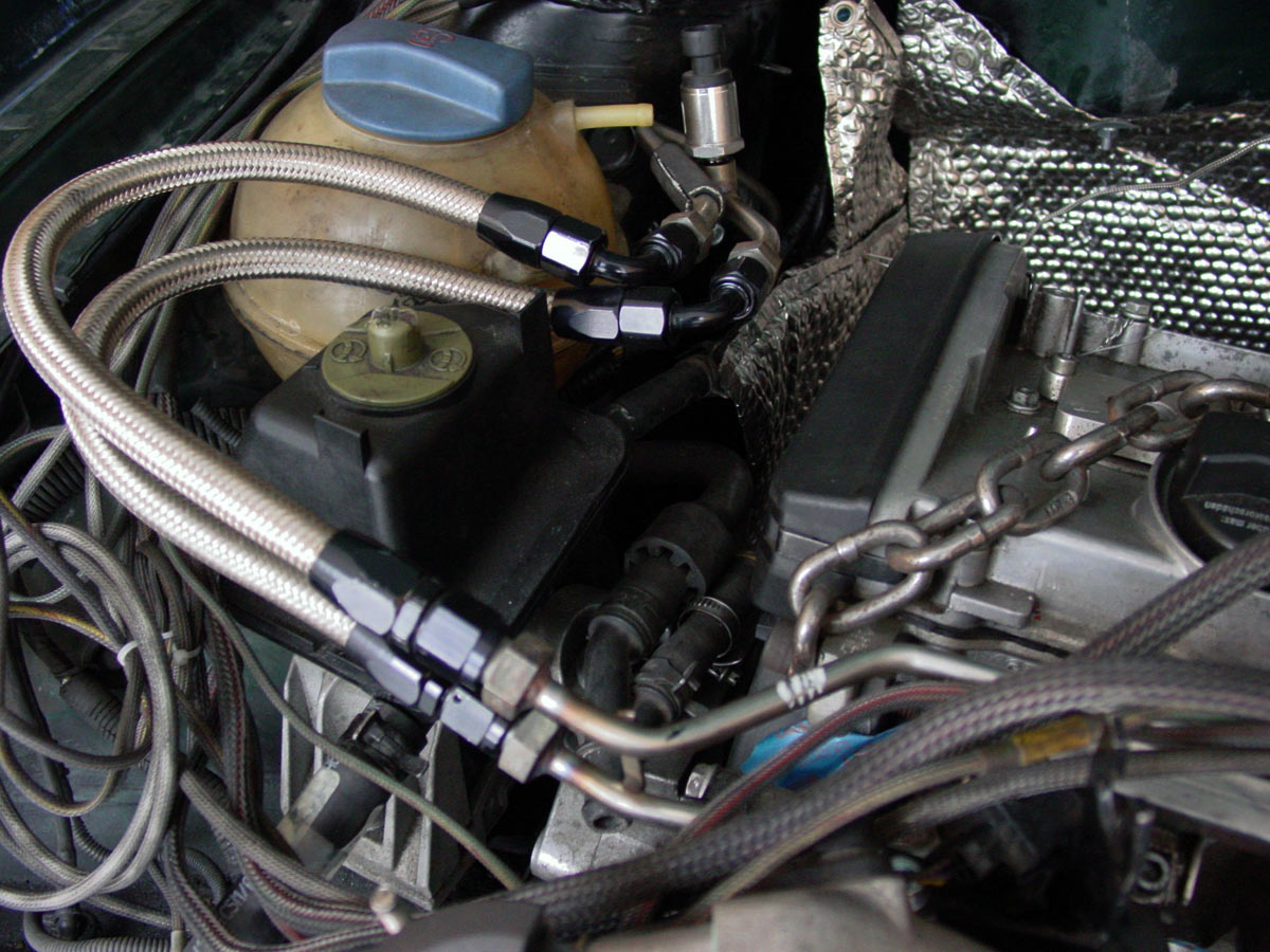

That leaves some thermal protection for the oil lines and the strut tower area... KalesCustom.com has Earl's FireGuard in stock so I will get that for the oil lines.  Still thinking of options for the heat shield on the strut tower.

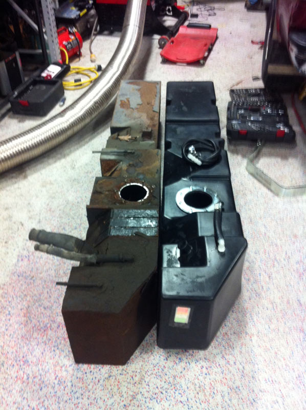

Chris (vtGTI) accepted the task to swap out the fuel tank on the F250... only took some excessive persuasion.
Jason at [b]VEMS.us[/b] (Colchester, VT).... same guy that did the last tune on the Golf and will do it again this spring [i]AND[/i] did the great tune on the Cabriolet.... allowed Chris to use his "shop" (more like a warehouse) to work on my truck. Very helpful as it was snowing all day on Tuesday.
With a little bit of blood (yuck... will spare you that picture!), sweat, and tears... and a lot of oily diesel fuel, rust, and dirt, he was able to get it done by 1:30ish AM (at least that is when I rec'd the pictures from him).  Thanks Chris!

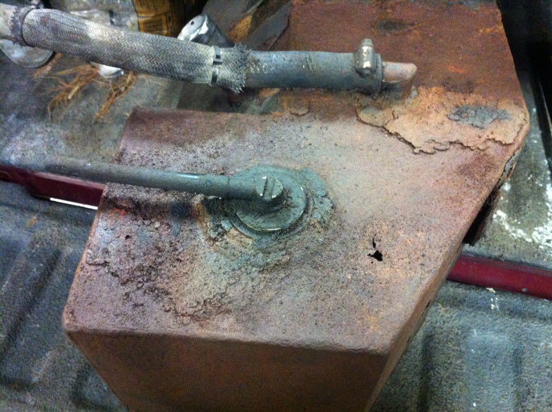

Old 47 gallon metal Transfer Flow fuel tank that I have been talking about replacing since 2005 vs. the new 50 gallon Titan Tank fuel tank made from "military-grade, cross-linked polyethylene".... you know, plastic.
This hole on the top explains why it leaked while parked on a hill or when I fill it about 3/4 of a tank.
So, I did something stupid like try to fill up the tank on my way home.  There was already 10 gallons in the tank so I put another 40 gallons in for $176!!!  Ouch!

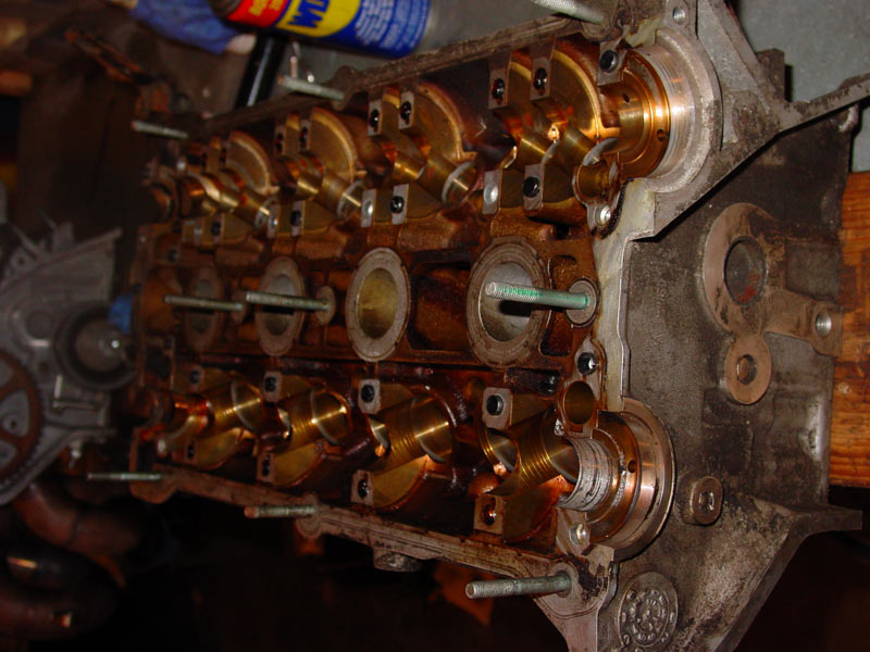

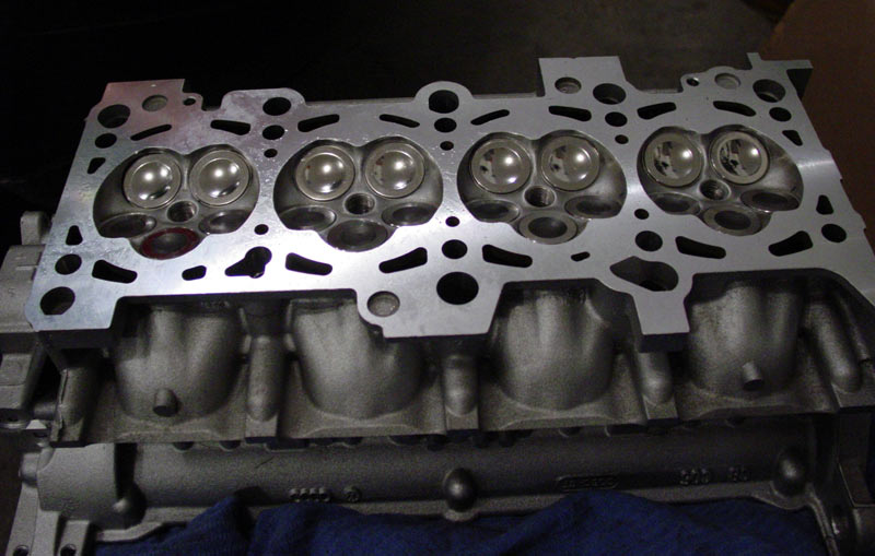

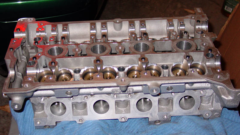

Not much to report... got the head back from RPM today.  Looks great.  I will put the rest of it together this weekend.
I acquired two heads from some fellow racers.  This is the one that I opted not to use this time around as I was worried about the cam journal on the "front" of the engine.

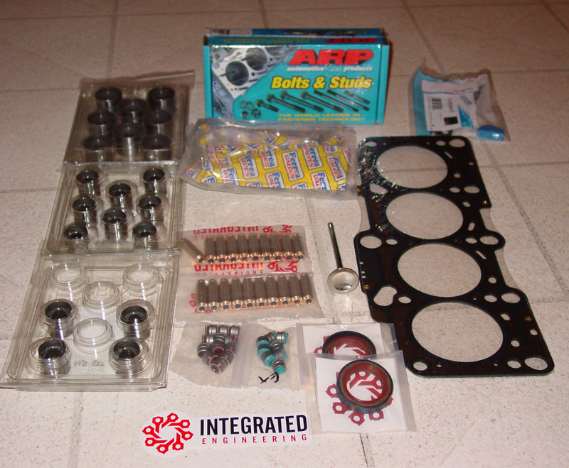

Received the new Wiseco to replace the "modified" one.  RPM machine shop in George, VT balanced the pistons/rods so that everything was equal.
Finally received the new rod bearings from 034Motorsports.... I guess they were on back order.

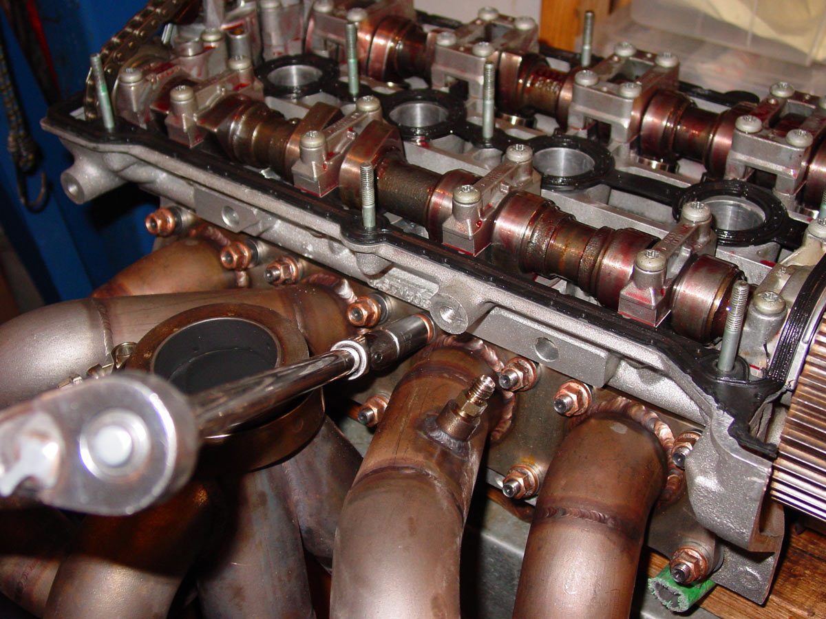

Receive all the exhaust manifold goodies from German Autoparts including a Jackson Racing Racing timing belt.

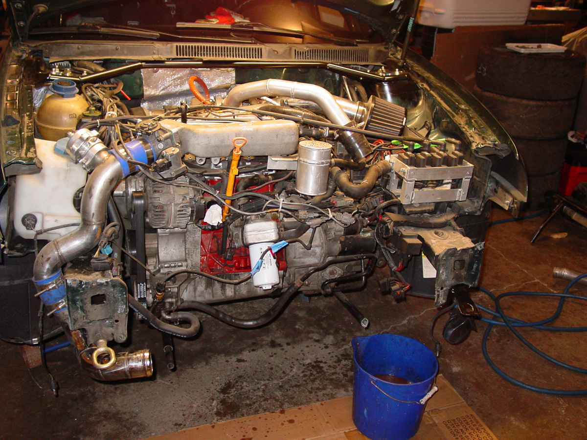

So.... since all the parts are here, I dived into taking all the parts off the old head and putting everything together on the new head.

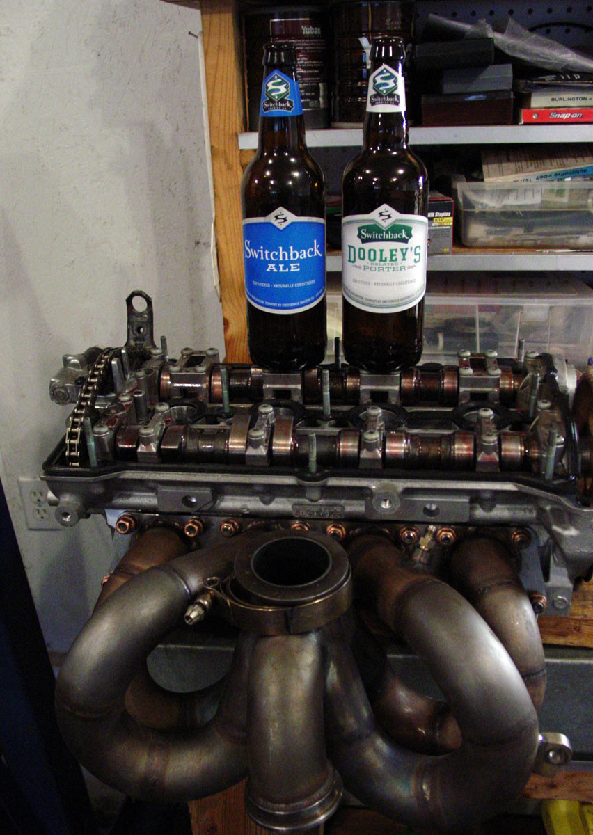

First... for years I have sworn at the ATP exhaust manifold because the nuts were impossible to get at.  Guaranteed to round off the nuts when trying to loosen or tighten.... terrible design.
Well, the KalesCustom.com custom (naturally) exhaust manifold was a dream to remove from the old and install on the new head.  I could get to all the nuts with a straight or flexible drive socket. Just one nut required a box end wrench, but that was just fine as it was an easy swing from the bottom to remove/install.  Happy camper!
All together... celebrated with two flavors of Switchback!

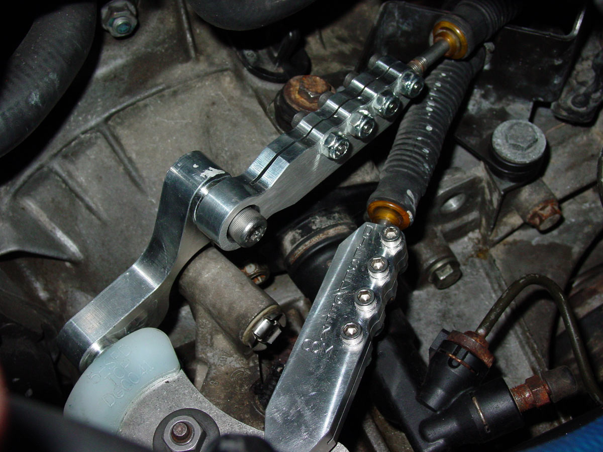

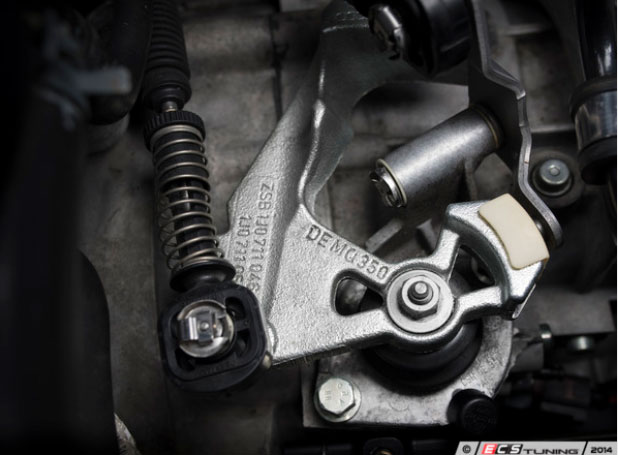

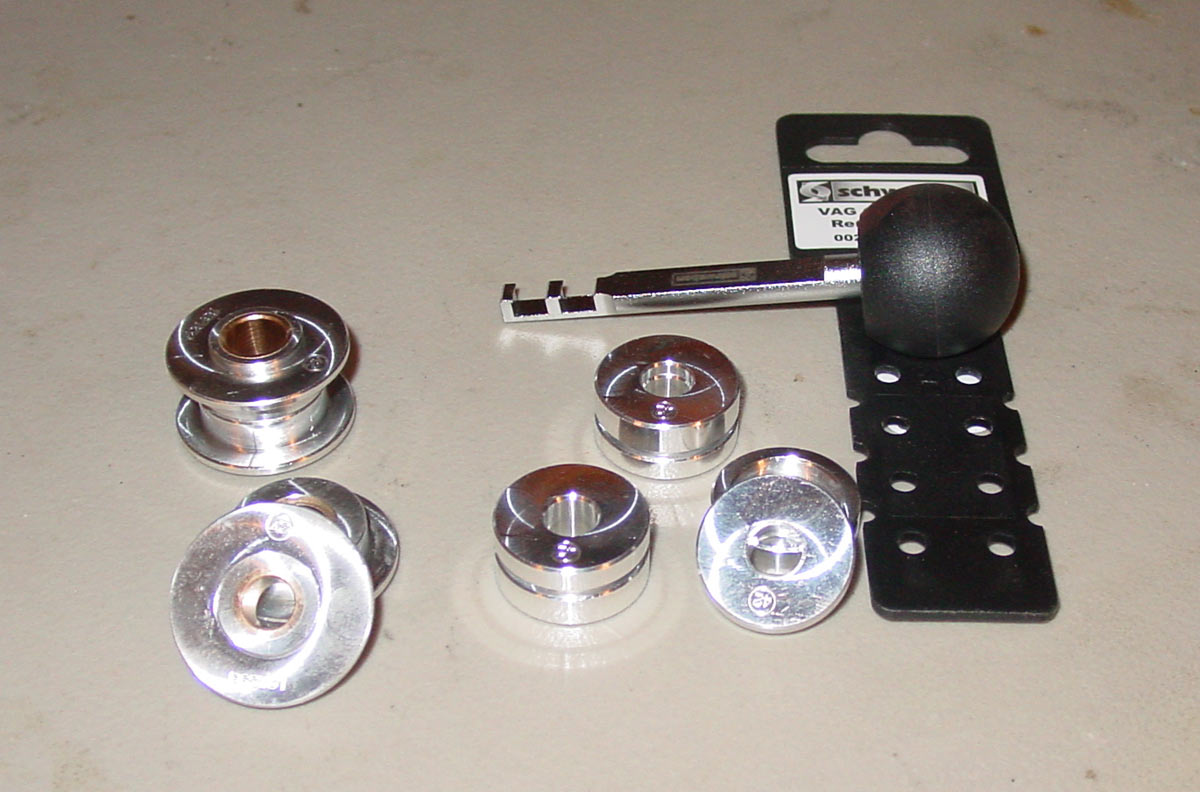

Chris Cheesman had the Cabriolet this week to make some adjustments to make her perform perfectly.  I didn't have any garage space (or time!) to do some of the installation stuff (i.e. short shifter and splash tank/filter) so he did it all.
Cabriolet is now ready for summer.... new Diesel Geek short shifter kit (positive engagement/notchy gear selection), oil change, balance, alignment, splash tank/filter, and replaced VVT oil gasket/half moon.  Thanks Chris!

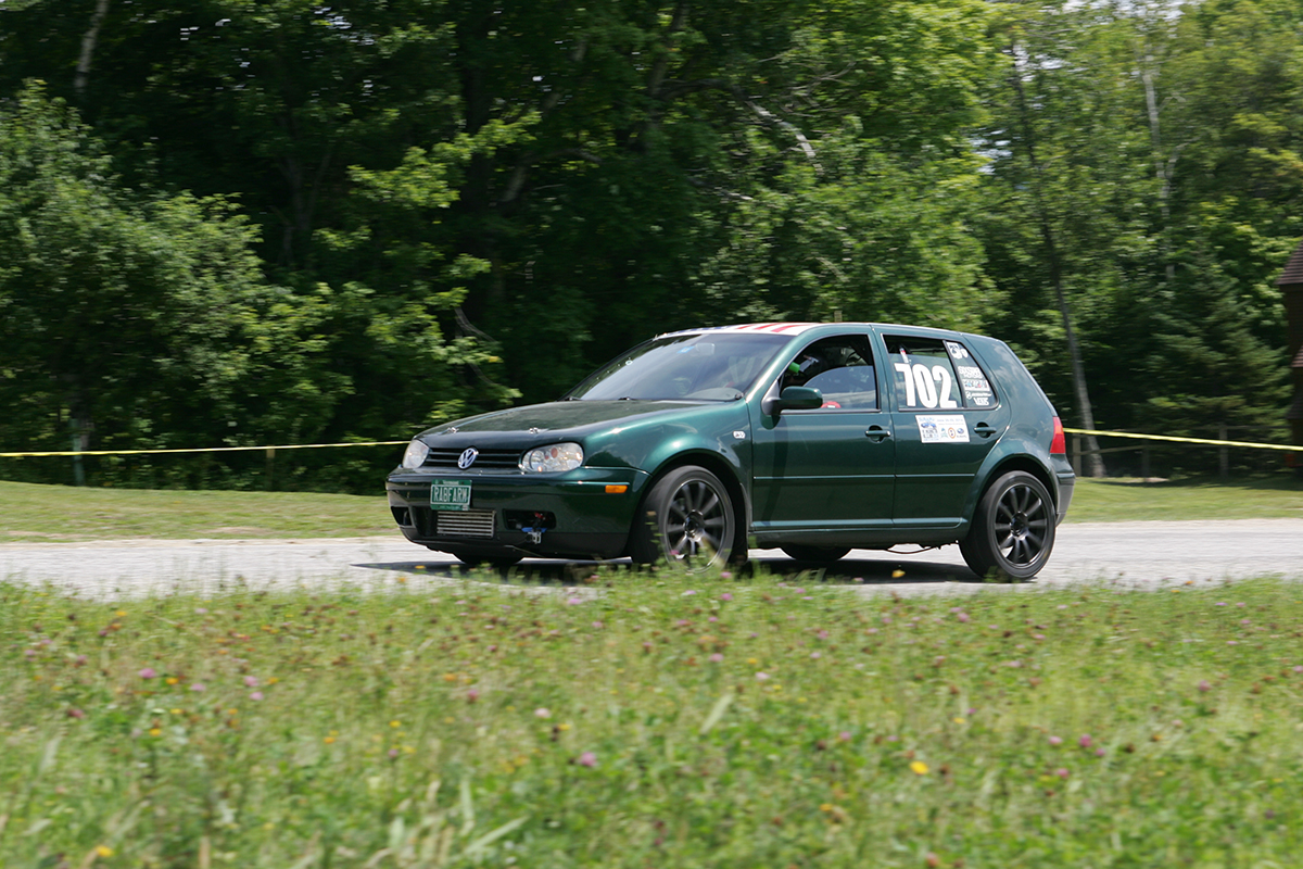

Okemo #1, 2013 hillclimb this weekend.  Had a great time!
Had some issues with brakes on Saturday.... bled all brakes.
Achieved 113mph in the straight (top 3 of all cars at the event.... pleasantly surprised!)

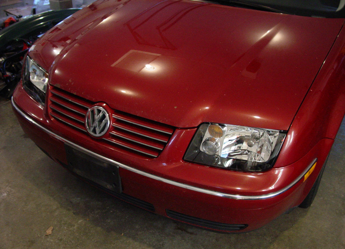

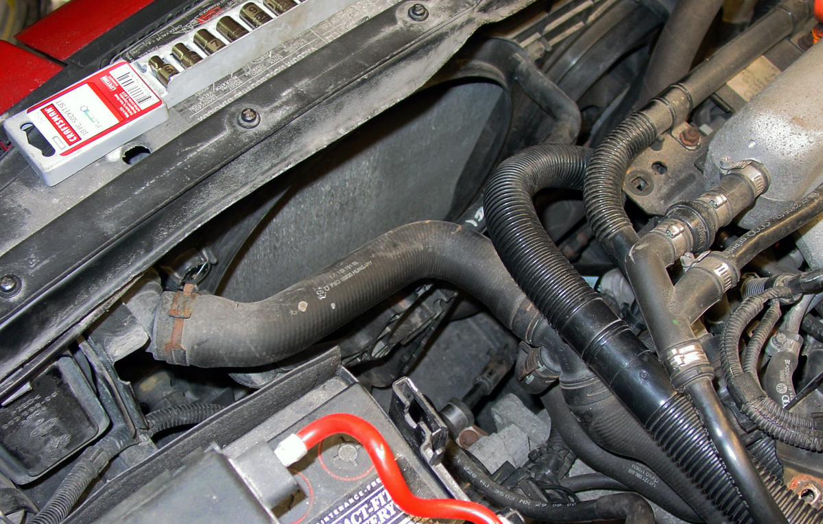

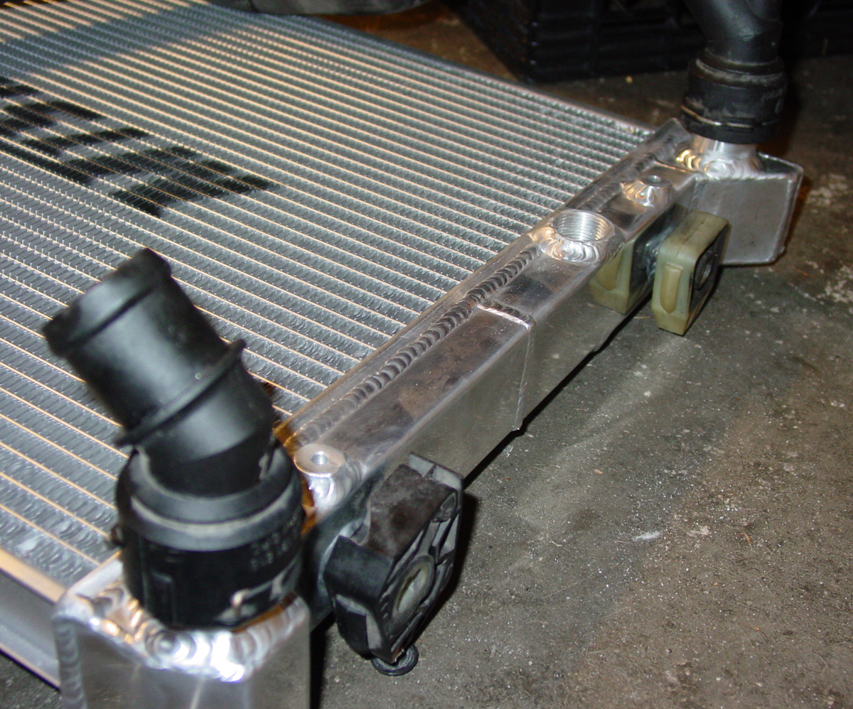

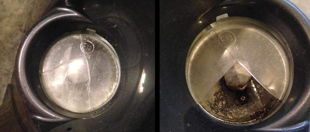

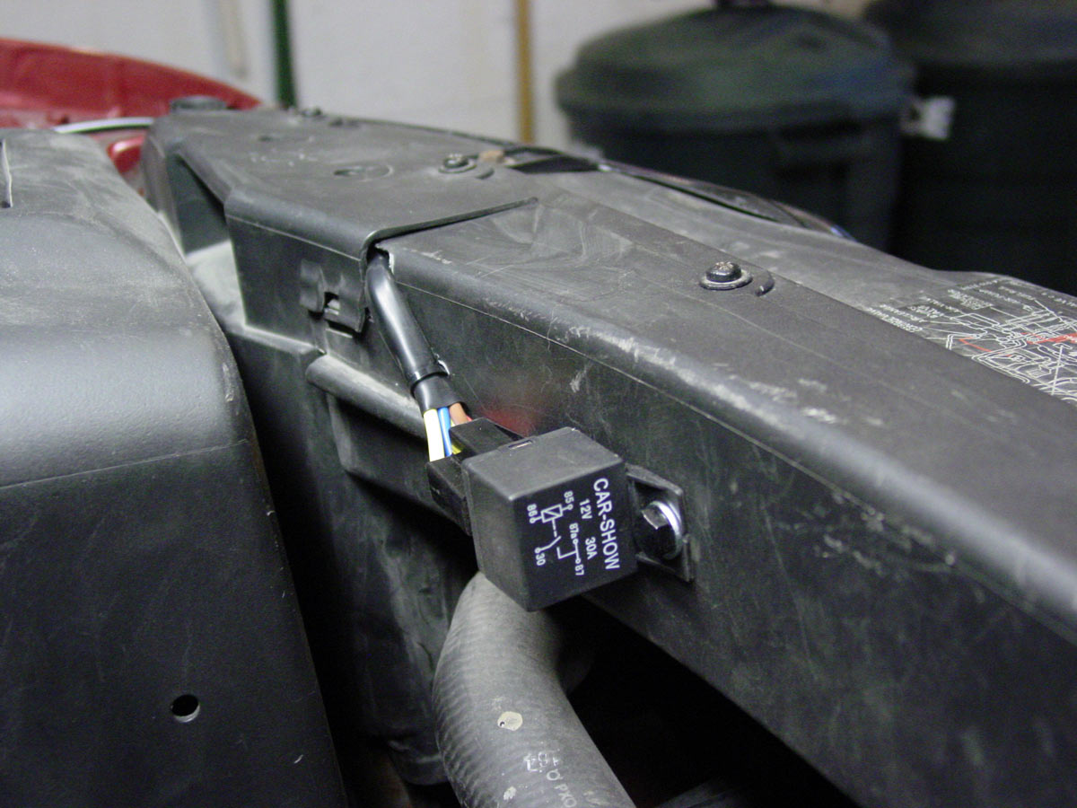

Jetta: The main radiator fan decided to cease operation at the Okemo #1 hillclimb so I added that to the Honeydew list.  Later in the week the downpipe started to make noise.  I correctly determined that it was the flex section of the downpipe (again!).  Third time is a charm.  Rewelded it twice and figured that it was time for a third time.  Nope.  The internals of the flex pipe failed closing up the exhaust to slightly smaller than my thumb.... not a lot of breathing.   So, doing some research to figure out if I want a stock SS exhaust system or get a performance exhaust.  Not a big difference in price.  I don't really plan to modify this car, but just in case..... kinda on the fence but need to figure it out prior to Okemo #2 so that Julie can race it there.
So.... Jetta needs radiator fan (arrived yesterday from German Auto Parts), full turbo back exhaust (rear muffler fell apart at Ascutney #1 and first muffler is getting up there in age), adjust e-brake cables.

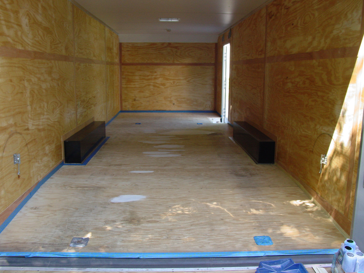

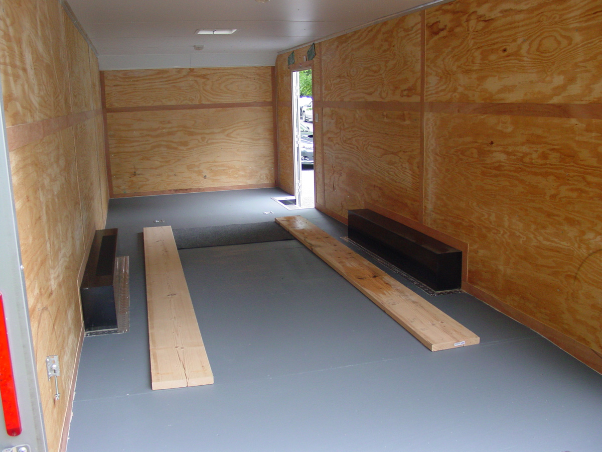

Painted the floor of the trailer.  I used oil based deck stain (dark gray).  My only problem spots (literally) are where there was motor oil on the floor.  I might have to cover that with industrial carpet or the like as the paint isn't going to stick (obviously).  I tried different methods of cleaning it, but it was far from perfect.

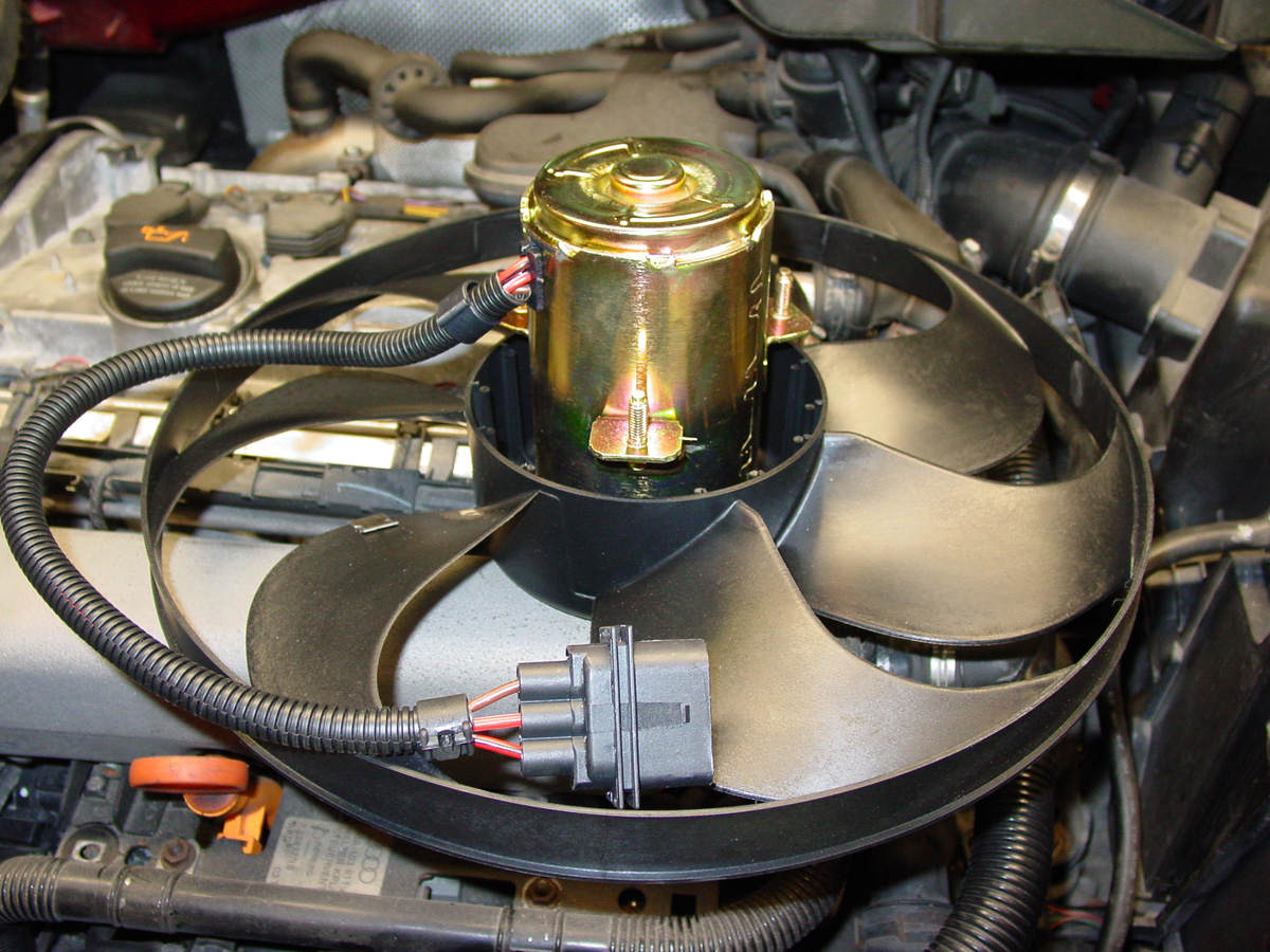

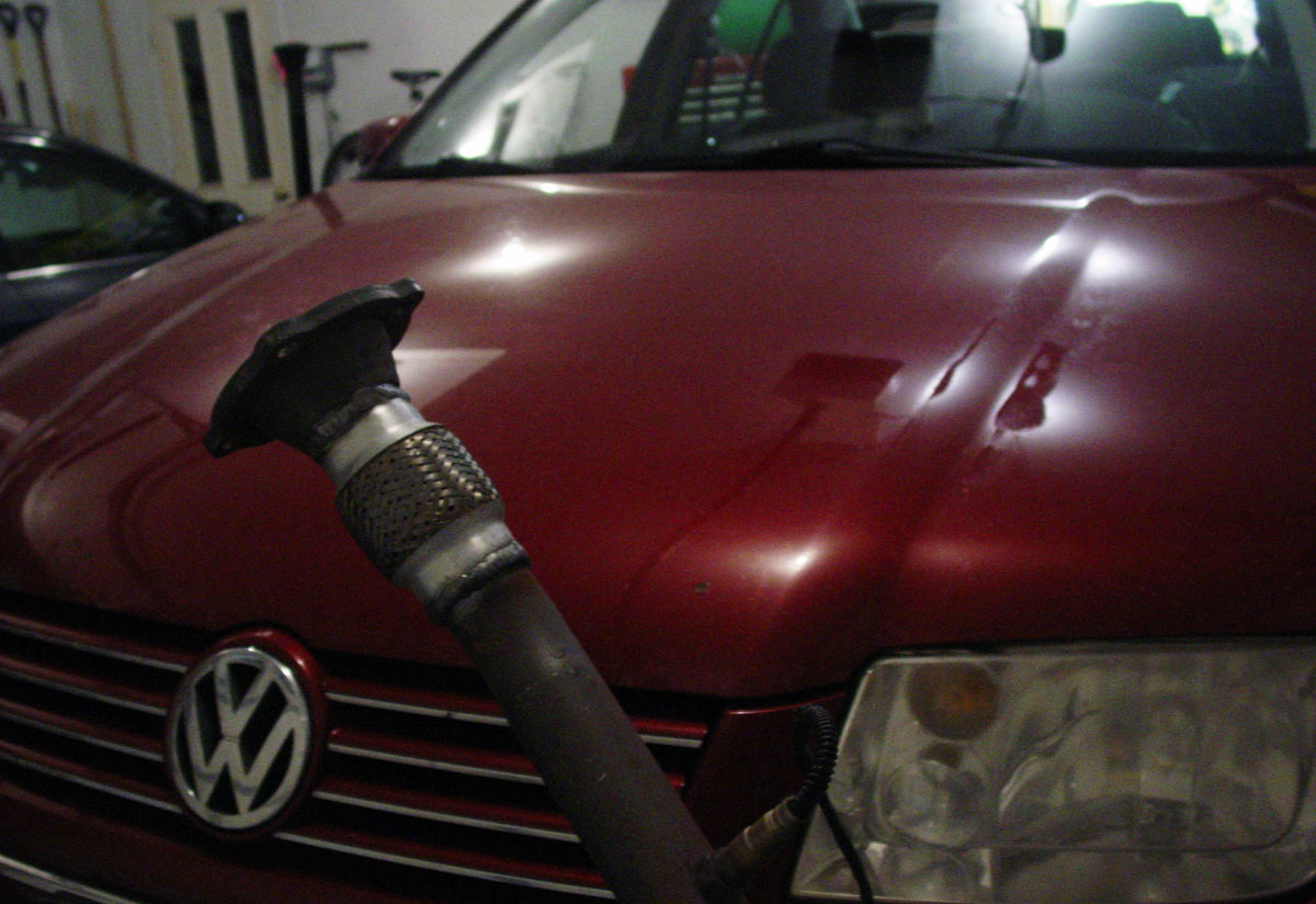

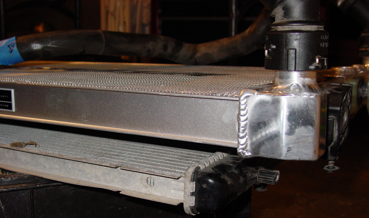

Julie noticed that the temp was running a bit high while sitting at the bottom of the hill waiting for her run at the Okemo #1 (2013) hillclimb.  John Hart (http://www.fastaddiction.com) took a look at the car for her and figured out that the large radiator fan was not turning on (even with the AC switched on).
After the weekend of racing was done and we were back at home, I checked out the fan to determine if it was the motor or the magic switching box that turned it on..... determined it was the motor by applying direct power to the fan.  Ordered fan.
It was actually quite easy to remove and install the fan.  35 minutes start to finish.  I removed the nuts that held the fan to the bracket and then removed only the top two nuts (bolts?) that held the bracket to the fan... left the third leg (lower section of the bracket) untouched.  Slipped the old fan out and slipped in the new one.  Easy!

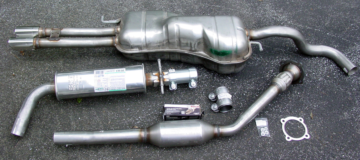

I had ordered a new muffler as one of the stock/original tail pipes rusted where it connected to the muffler and started to fall off.  Shortly after getting the muffler in the mail, the downpipe started to leak on the flex joint that we replaced a while ago.  I took the downpipe off to determine if it was a matter of a quick reweld... nope.  The entire inside of the braided flex (it was been suggested to me since to get the flex joints that do not have the braids on the inside) had let go.  This choked off the exhaust to about the size of my thumb.  Started poking around a bit more and saw that a small hole was starting to form in the front muffler.
Okay.... [(2012-2004)x150,000 miles] / My wife races it = time for a new exhaust.
But..... since the Okemo #2 hillclimb was only 1.5 weeks away, we did not have time to get a performance exhaust to our house in time to allow me to install it prior to the event.  So.... we went with a stock "turbo back" exhaust system.
It was great putting new parts in.  Surprising, the old muffler (stainless steal) came apart quite easily.  A little PB Blaster might have helped.
In with the new!

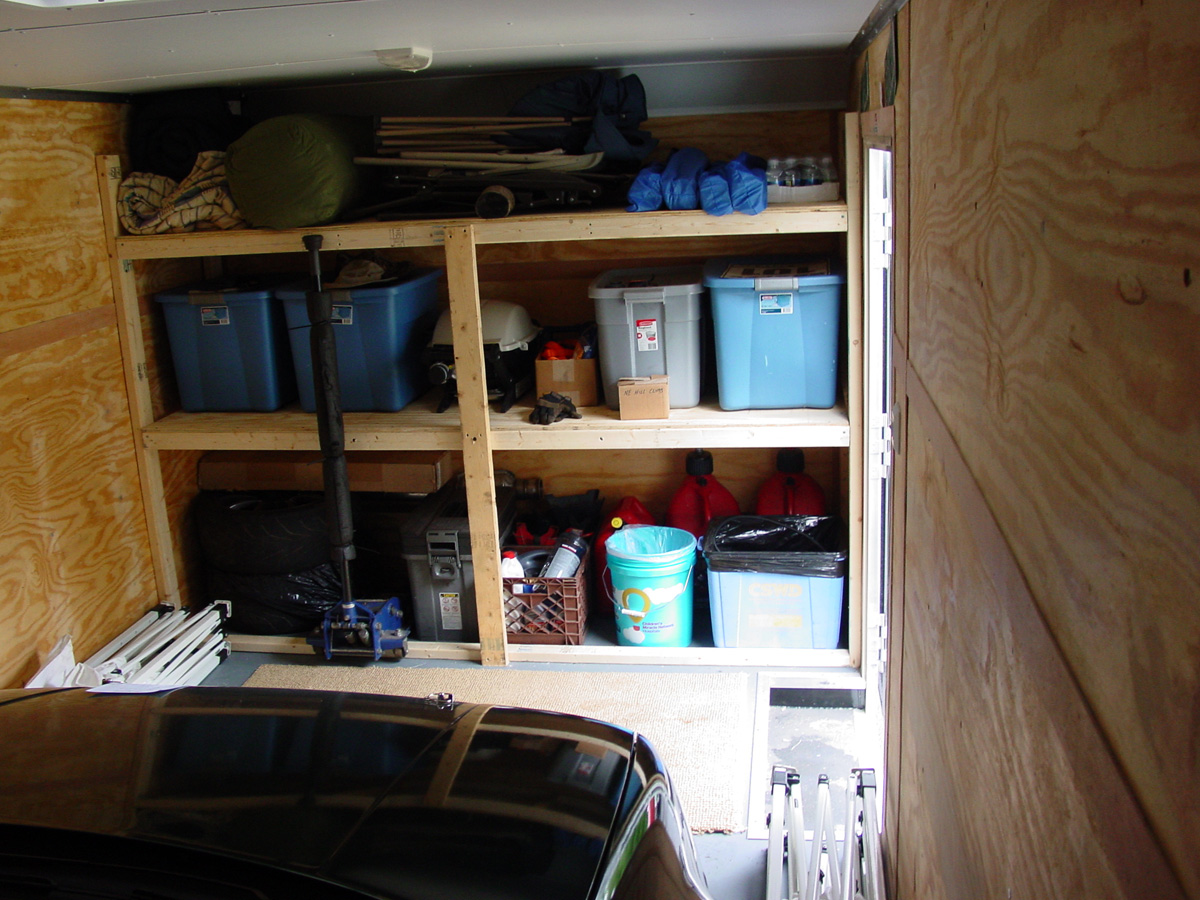

Decided it was time to start personalizing the trailer.  In last month's exciting episode of "As the Trailer Turns", we saw Ken painting the trailer floor while Barbie took a nap.
So.... ended up with some shelves in the trailer this week.

Every time I needed 4th, it took some effort to get my arm back far enough to select the gear.  Such is life.  Last run of the weekend and I didn't get myself setup properly in the car.

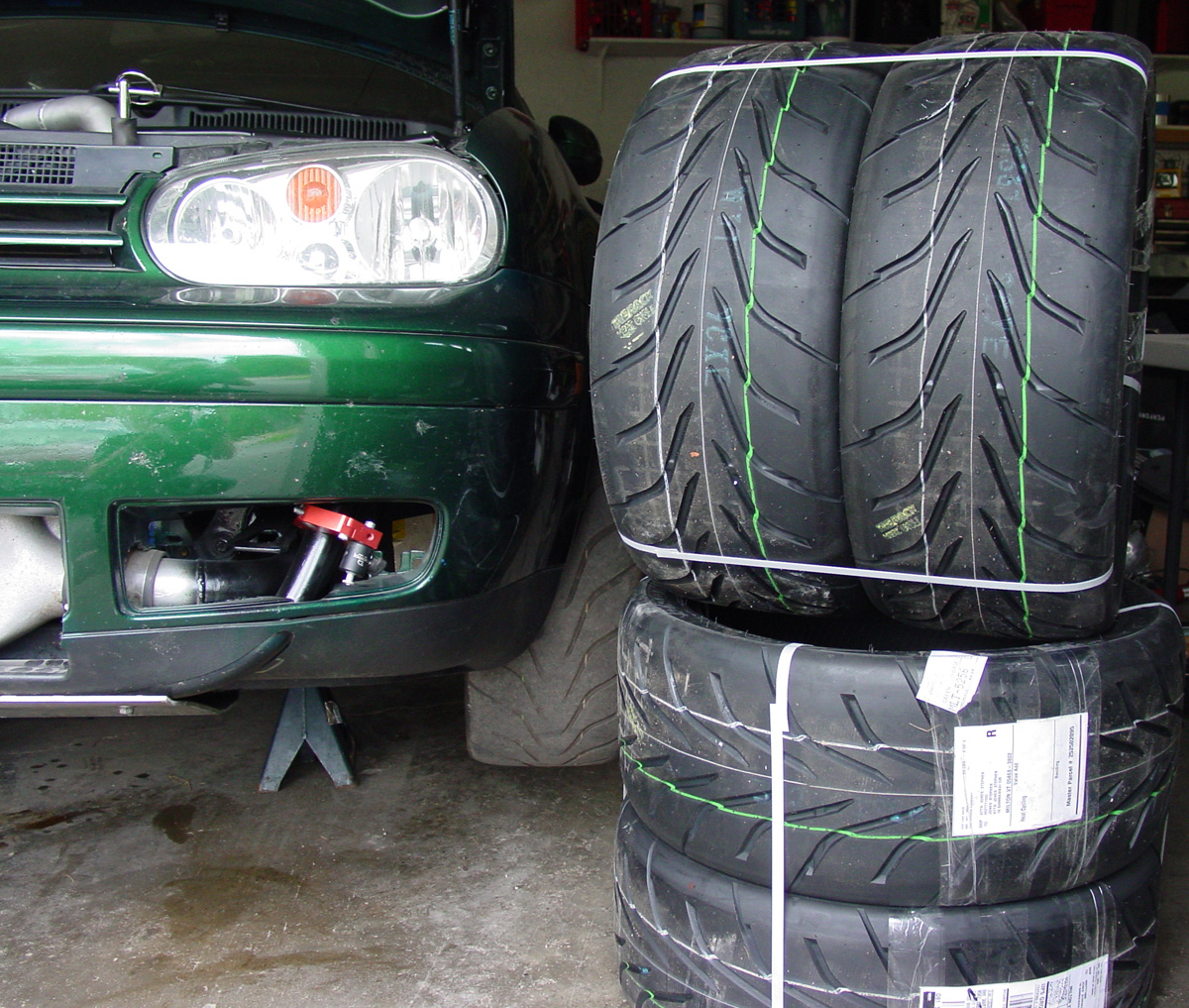

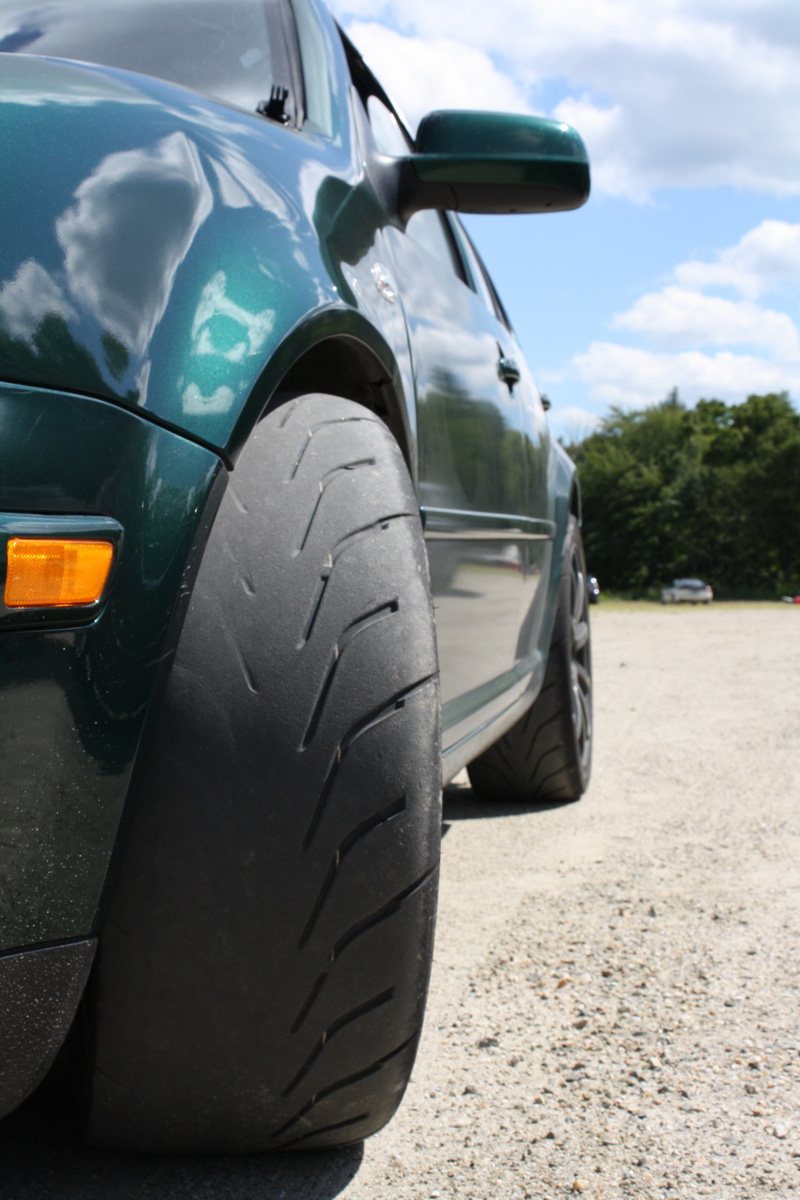

I have order two new tires!

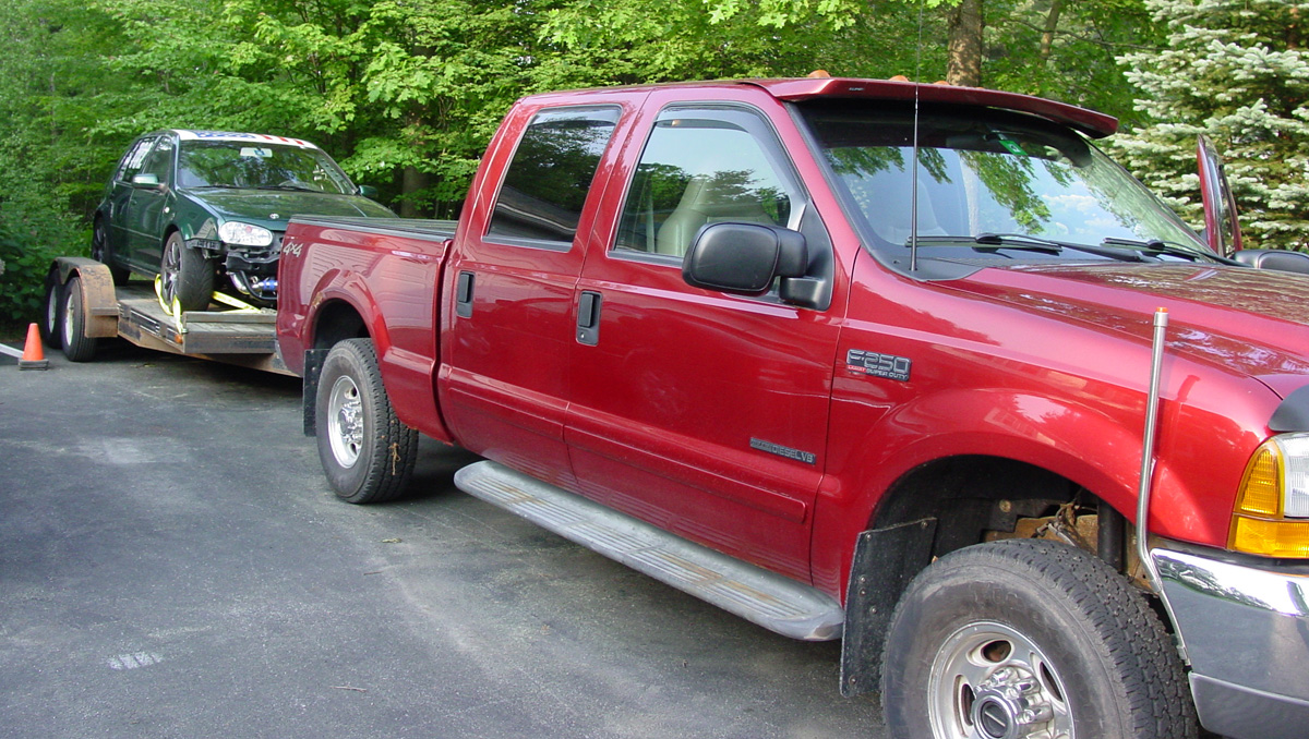

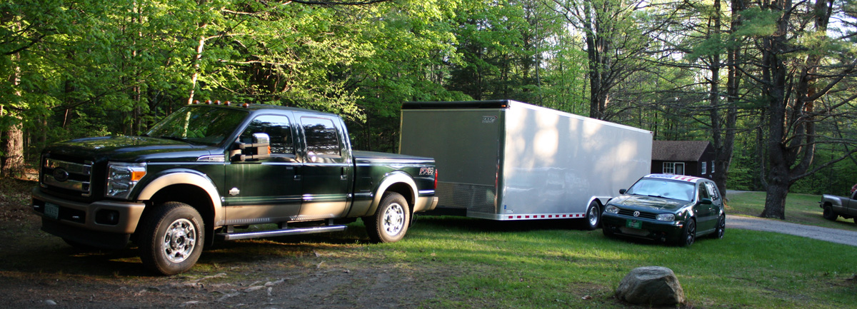

Picked up a new (2012) truck on my way to the Okemo #2 hillclimb.  Kinda funny leaving my house with truck/trailer and a half tank of fuel, stopping at G. Stone Motors in Middlebury, VT to swap trucks (traded in the 2001 F250 7.3PS), and continued on my way to the event.... and getting there with a full tank of fuel.
Loving the new truck.  2012 F250 King Ranch 6.7 diesel with 400HP and 800 ft/lb of torque... wow.  Oh, and 6 lovely gears!  I think I was able to out accelerate my wife in the Jetta with the truck.... with the 24' enclosed trailer attached with the Golf and all our crap inside.  Sweet!

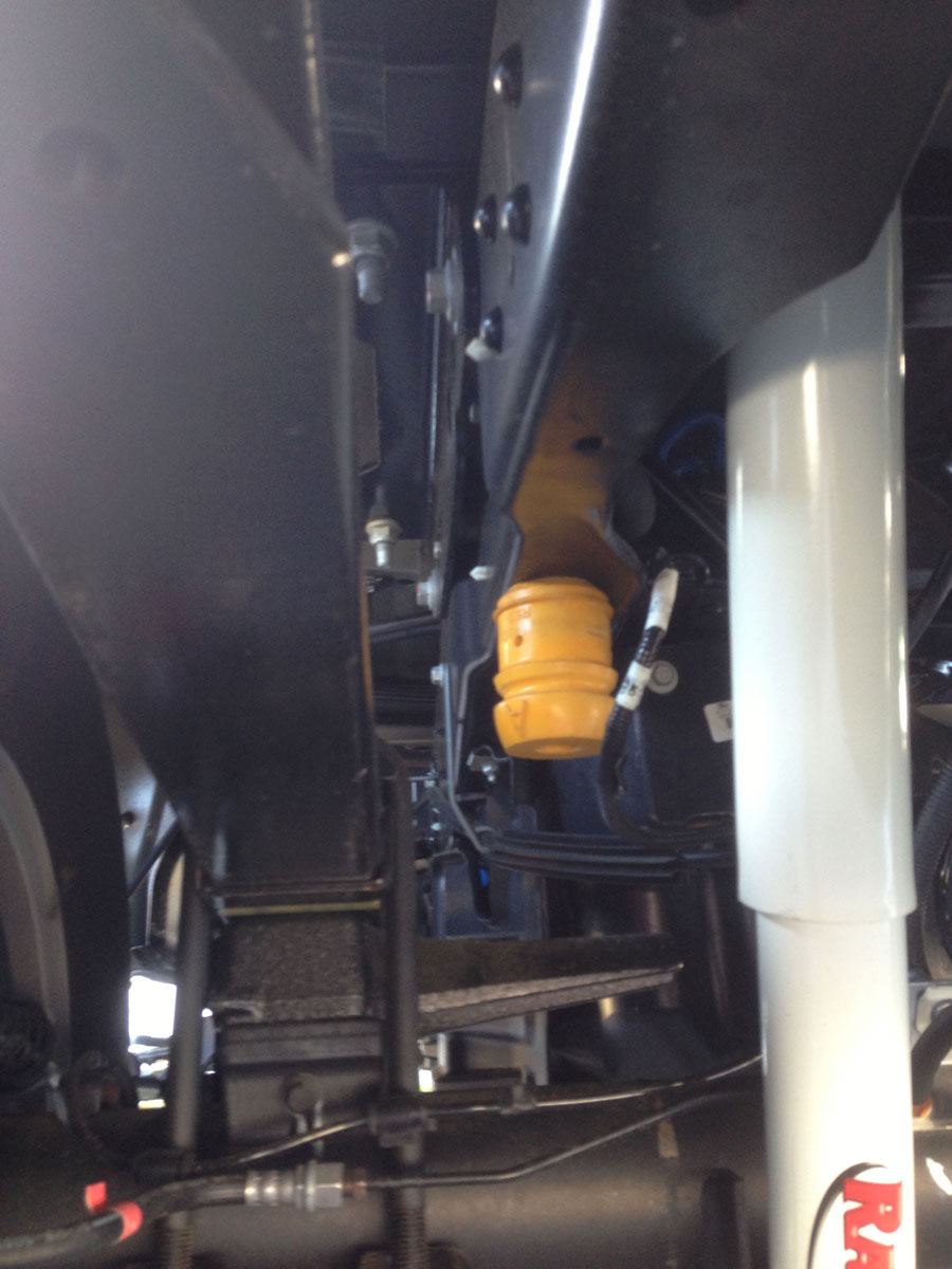

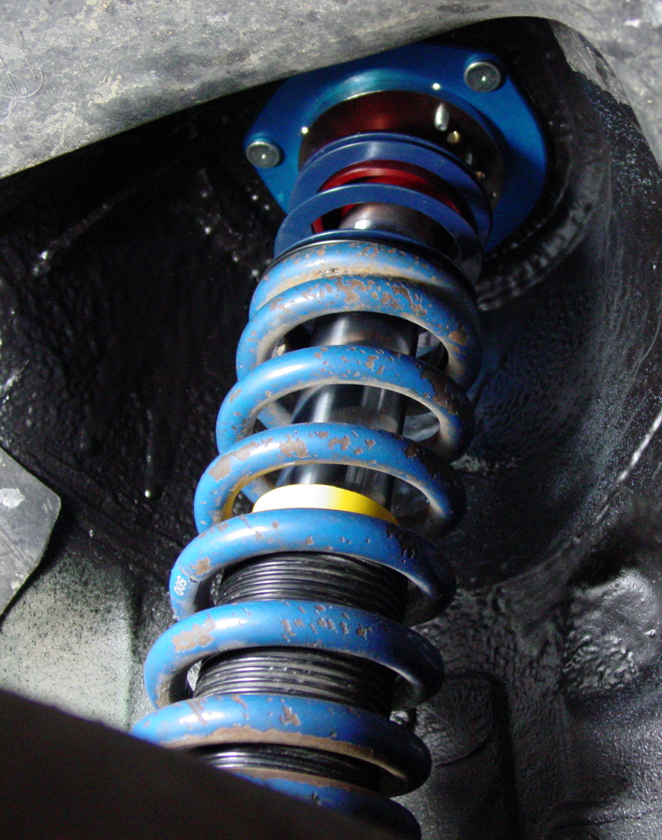

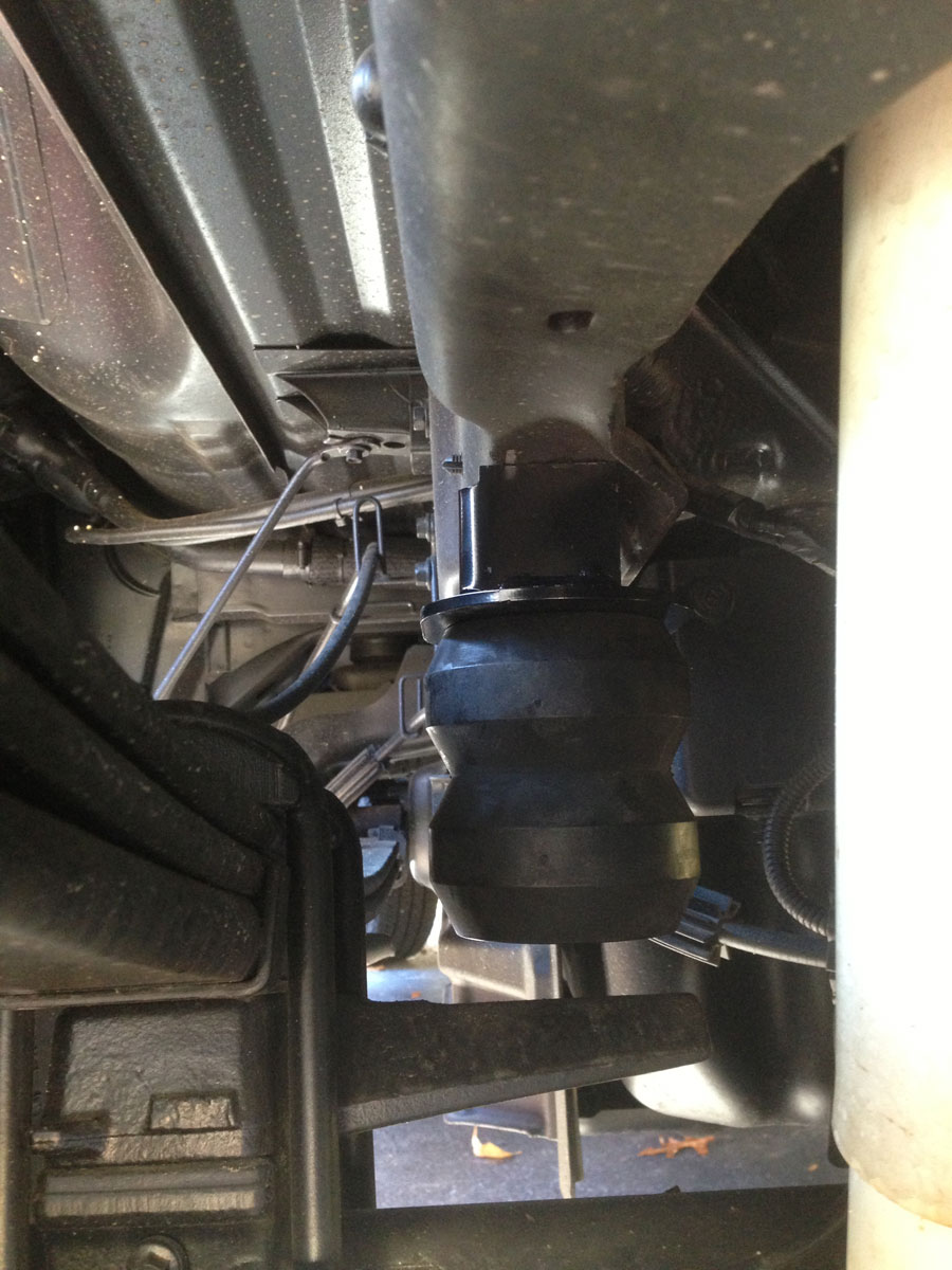

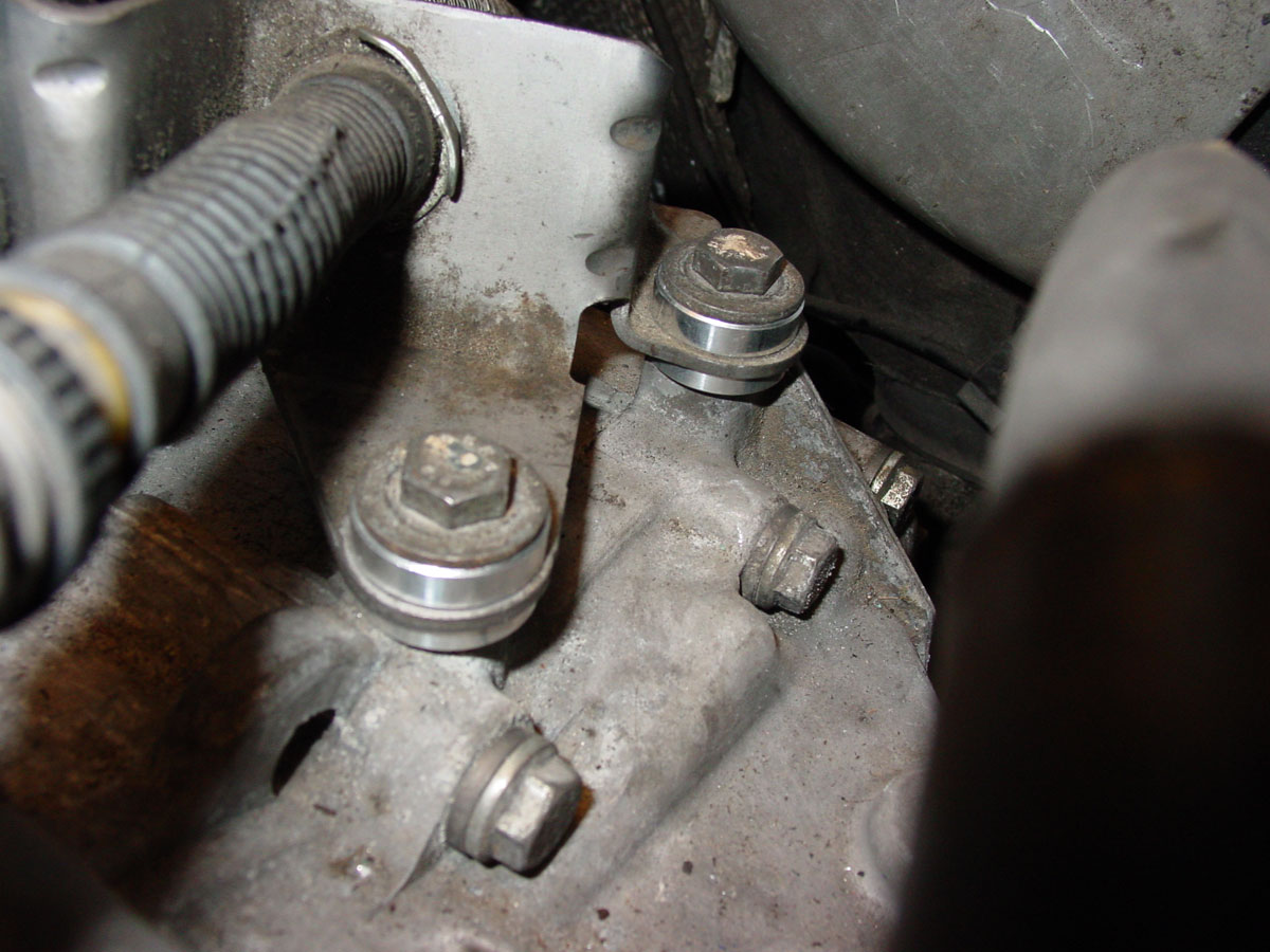

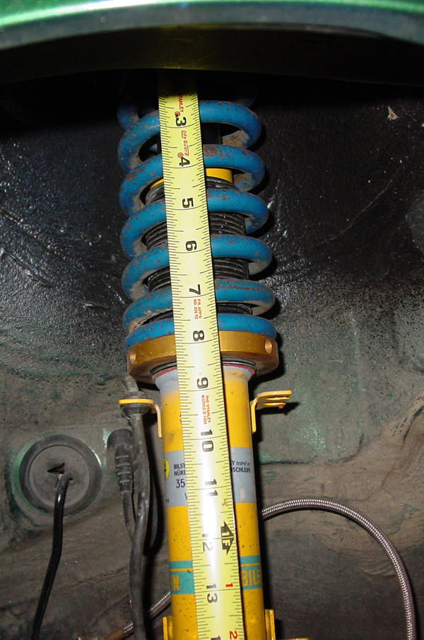

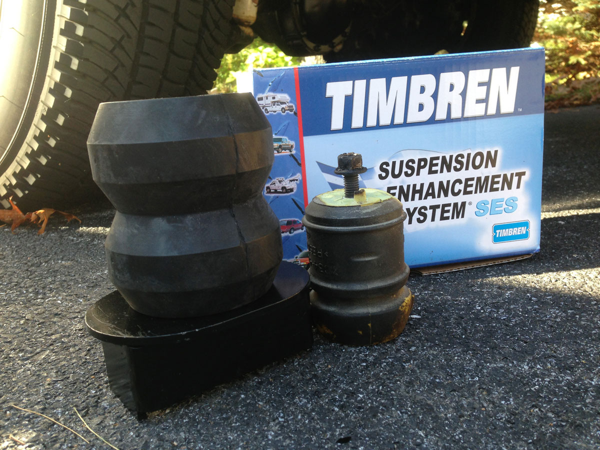

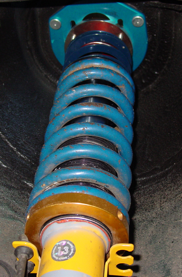

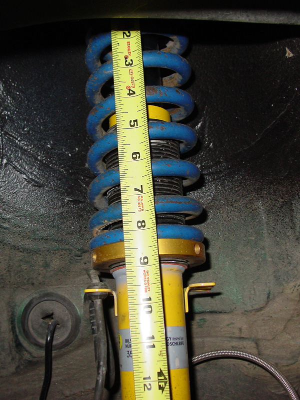

Since the back of the truck (the 2012 F250 is sprung weaker than my 2001 F250) seemed to swat a bit too much (heads lights aimed up a bit), I installed some extended bump stops.
Truck on the ground with stock (yellow) stop.  Notice distance between the bump stop and the bar it... um, stops against.
Much closer. The new bump stop acts a bit like an air cushion.

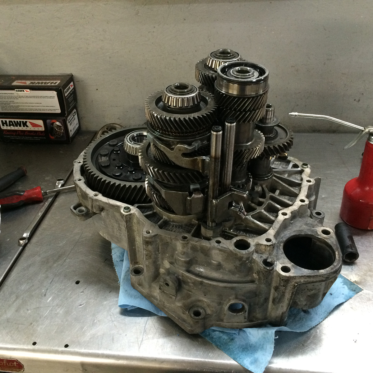

* Have someone check out the transmission.  It seems to be 'not perfect' getting it into third.  I would rather address it when I don't need it (the winter) vs. the week before an event.

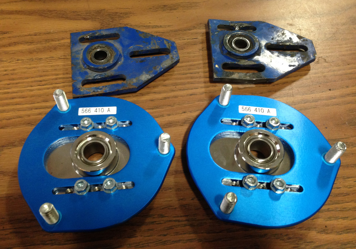

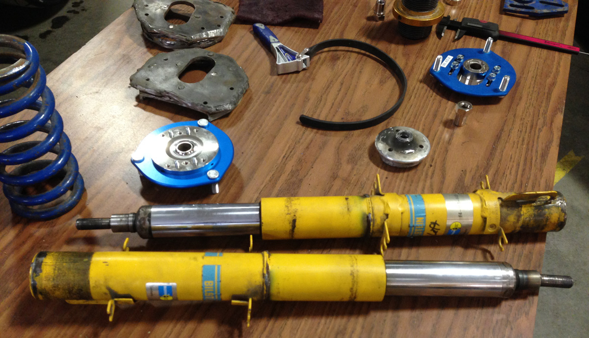

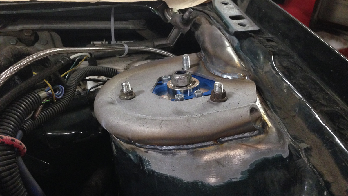

* Camber plates (Remove Shine plates and use Ground Control)
* Order tires for 2014 season
* Check out shocks and struts to make sure they are all good

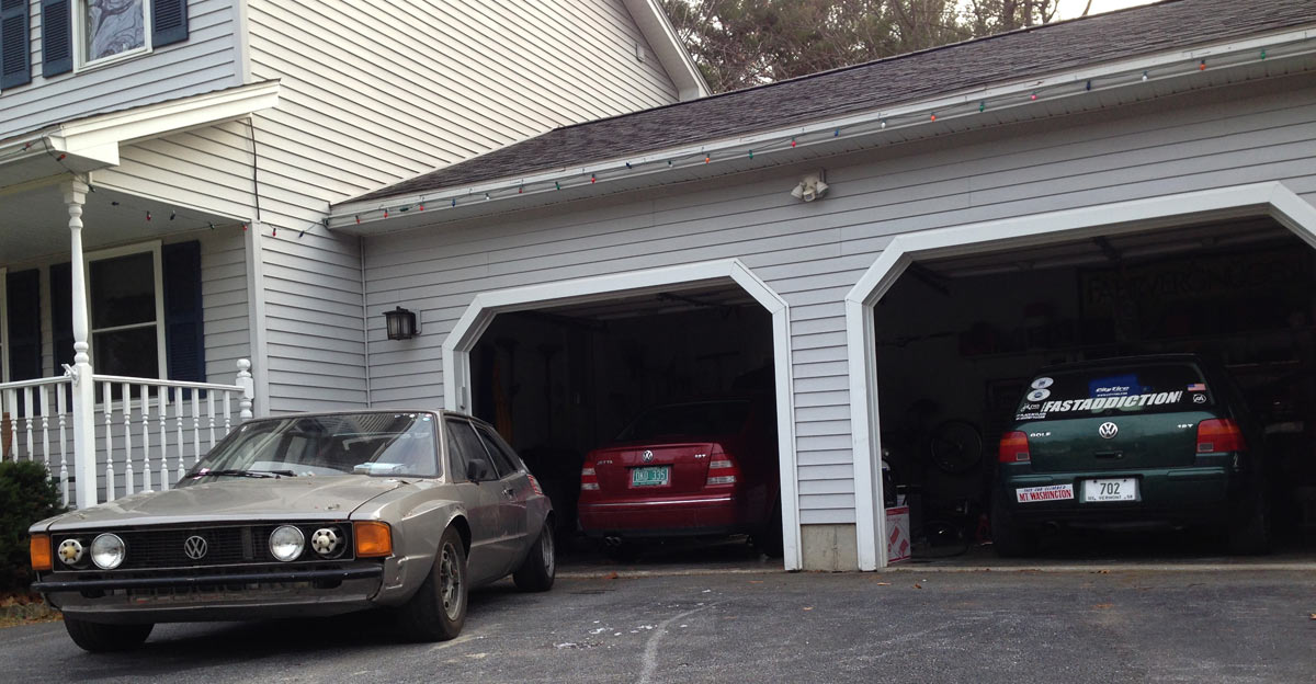

Cabriolet... the donor car (so sad) is parked next to the Scirocco (the recipient).  This will be a big project!
Wife wants me to cage the Jetta so she can race it next year.... I do not want to put a cage in the car that I have to daily drive everyday.  I told her she will just have to drive the Golf next year.

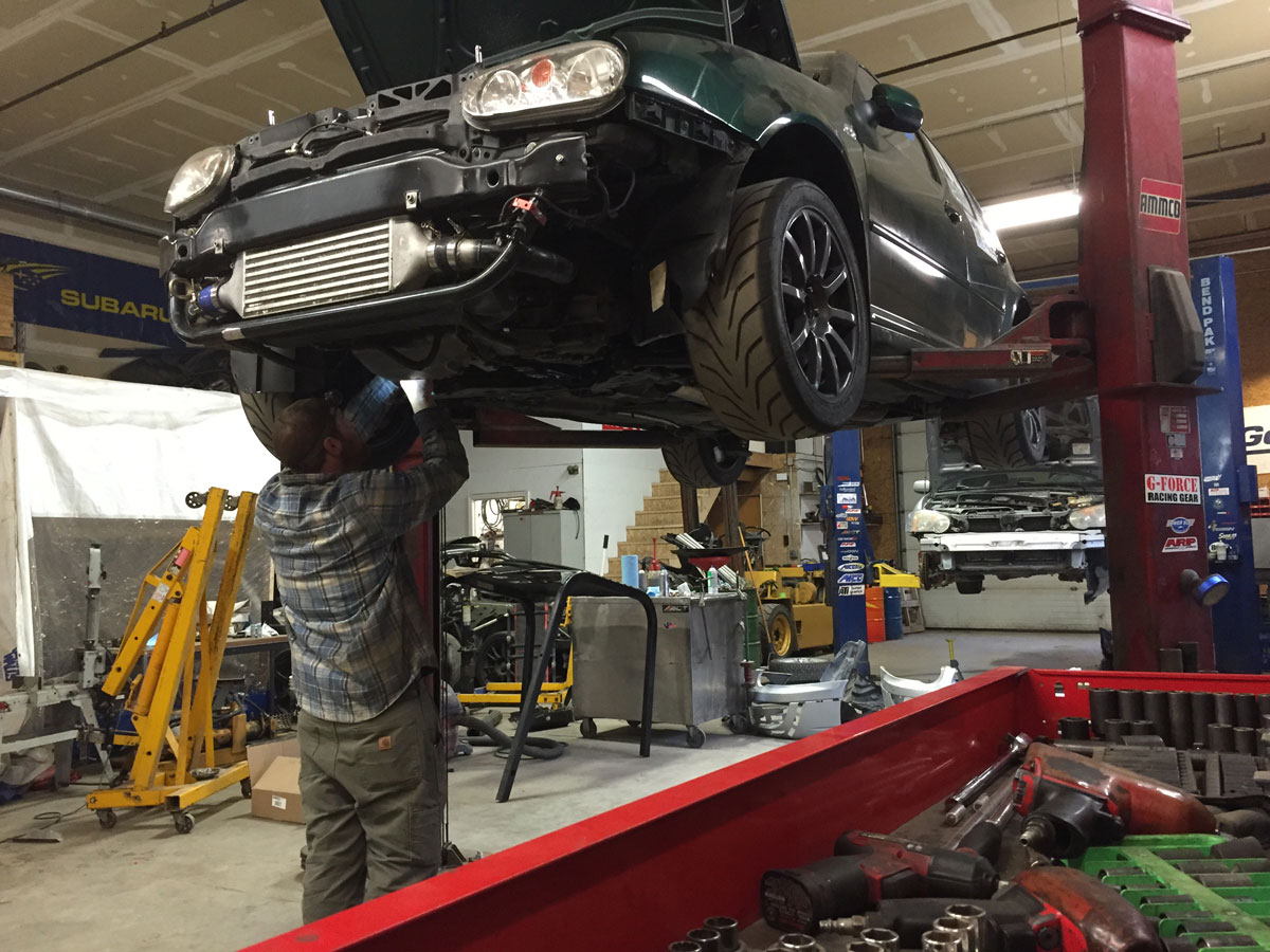

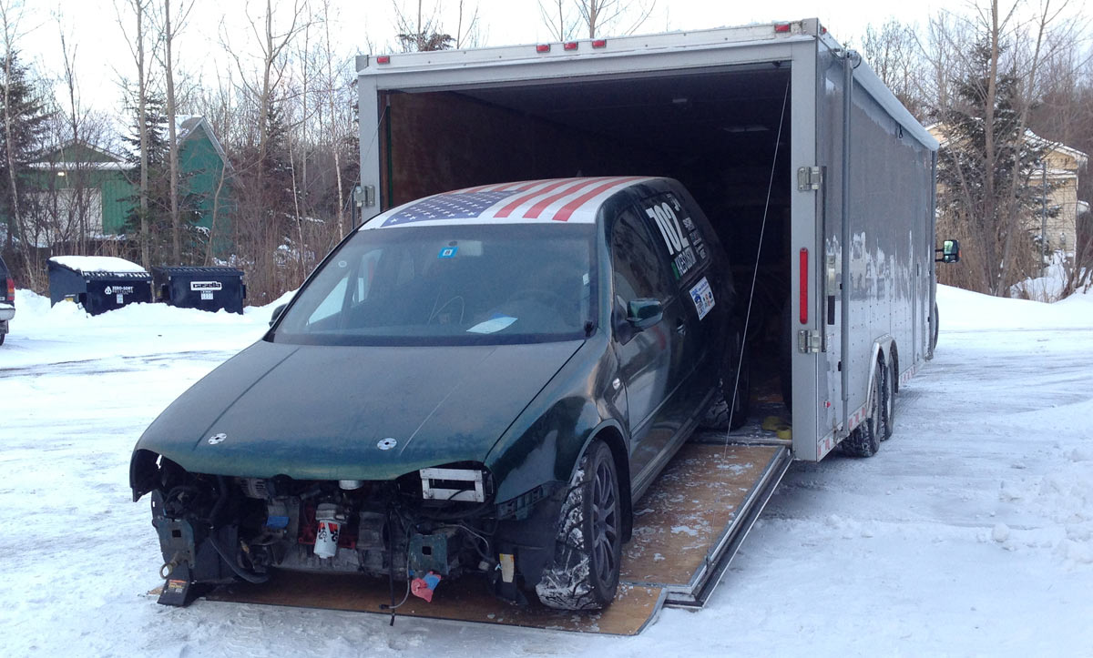

Before I put the car away for the winter, I brought it down to Ralph's Foreign Auto in Colchester, Vermont.  Ralph has been racing for years (earlier in my post I included a picture of his BMW CSL... sweet!). I wanted Ralph to take a look inside the engine to make sure everything looked good... it did!  Check.... put the car away and start planning for the 2014 season.
In February, the Golf ended up at Joey's (http://www.KalesCustom.com located on Prim Road in Colchester, Vermont...they are working on their website right now and moving 300 yards to a new shop).

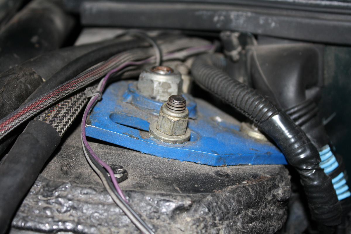

The goal was to replace the aging and bent Shine Racing camber plates, so I picked up a set from Ground Control (universal camber plates).
The bent camber plates...
Cutting off the old plates....
And removing the suspension. Notice that the strut in the foreground is bent at the very top; time to order a new set of Bilstein struts.  Good thing they are really, really, really inexpensive (not!).

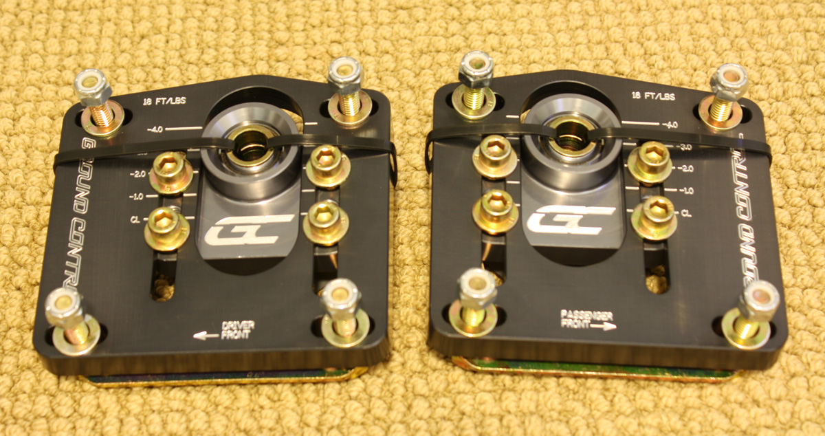

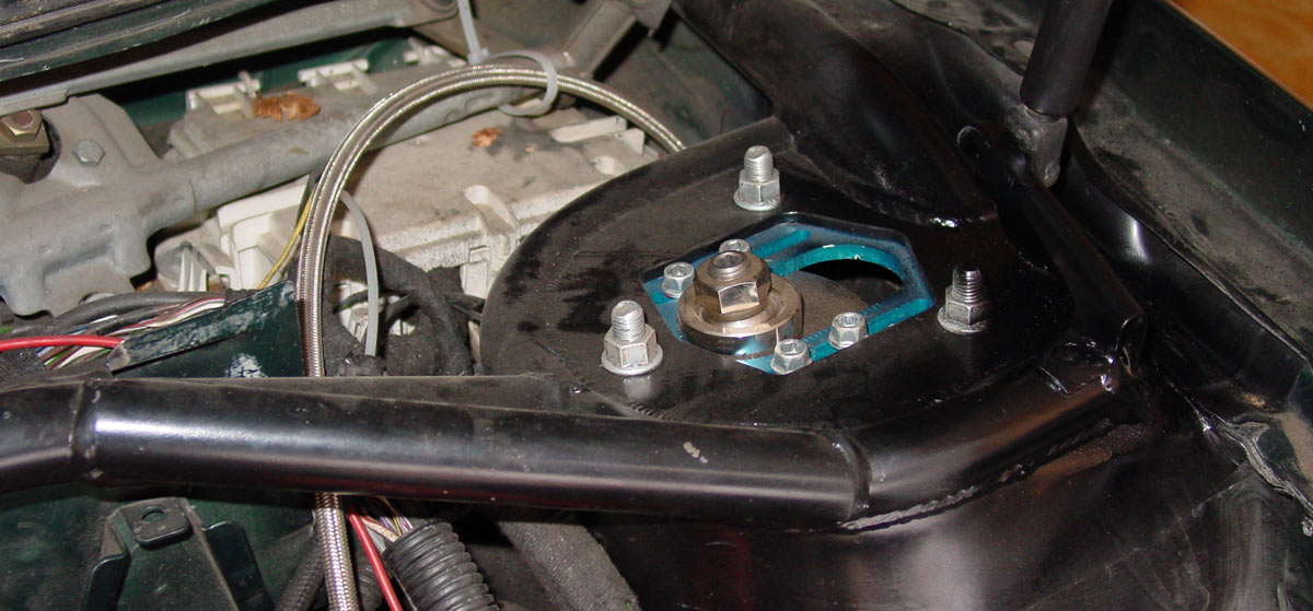

After some discussion with Joey, we decided to go with to go with a set of Cusco camber plates.
Looking at the Shine Racing plates that were bent, it seemed they were not supported like a camber plate that is mounted underneath the strut tower.
The Ground Control camber plates will be used on the Scirocco.
Making the new strut towers....

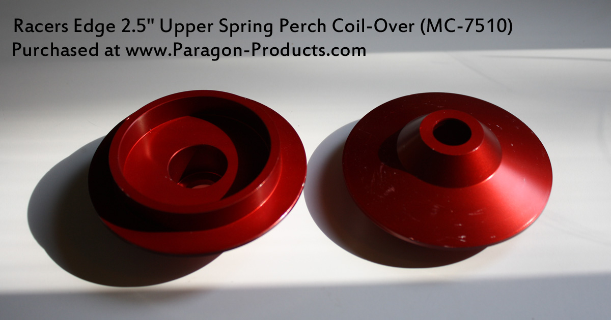

The upper spring perches were a bit banged up because there was nothing to keep the spring within the perch when jacking it up (or if the car happened to take a jump at the hills).  Because the spring would not always seat properly, the perch suffered.

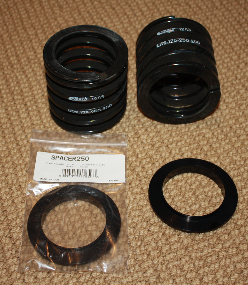

Next, thinking about the suspension setup on my old Rabbit (use of a tender and main spring), I ordered a set of 3" 200# tender springs to bridge the gab between the main spring and the upper perch.

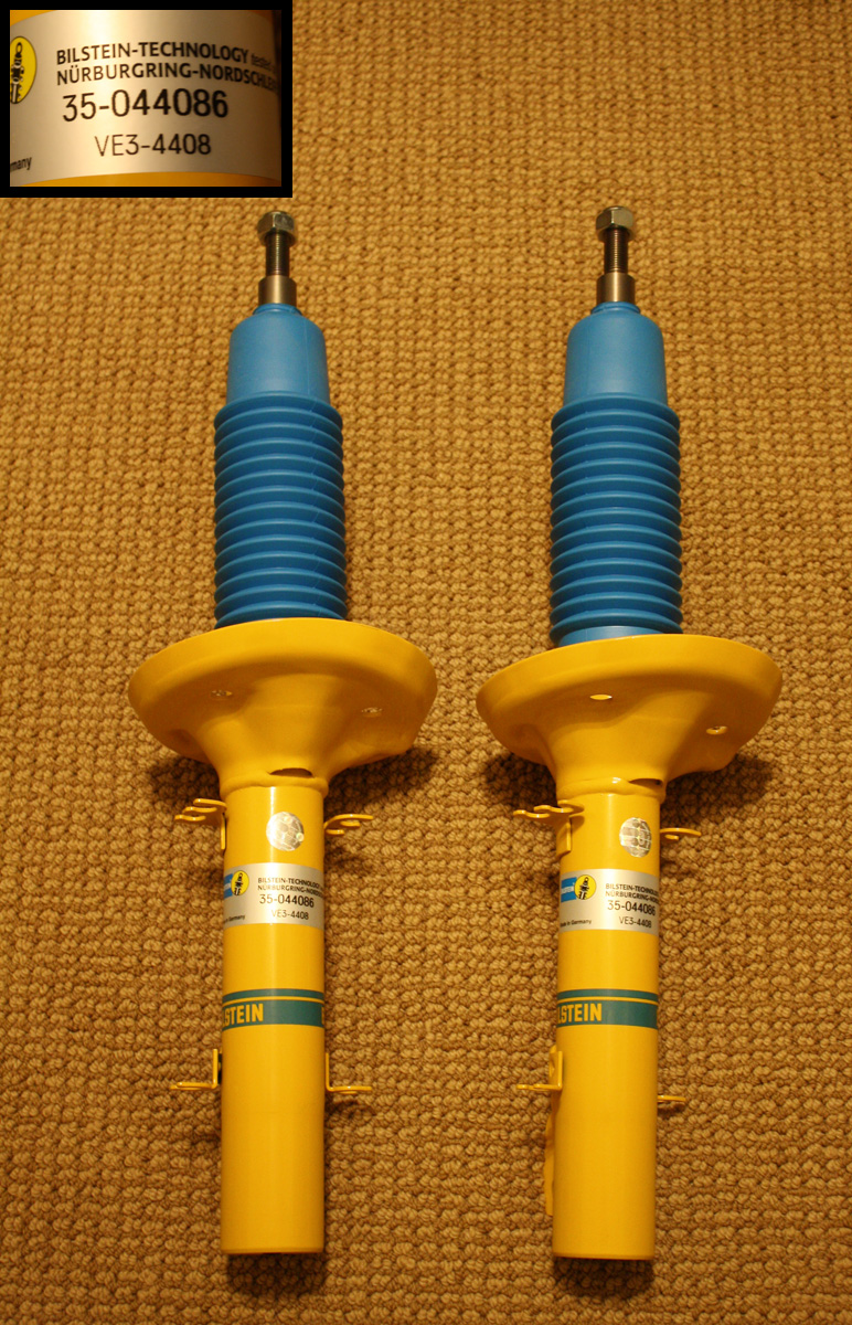

Order a new set of Bilstein struts....
Camber plates are done!
Naturally, plans change as you are trying to build something from scratch.  The 3" tender springs were about an 1" too long.  To get us ready for the first hillclimb of the season (Mt. Ascutney), we used a helper spring instead.  To help suck up the bumps at the hillclimbs, I think I will revist the main spring again and might go with a shorter main to allow for the 200# tender (or some other rate)... some research is needed.

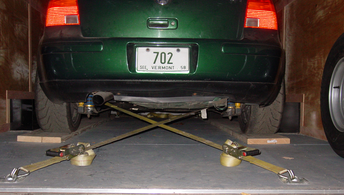

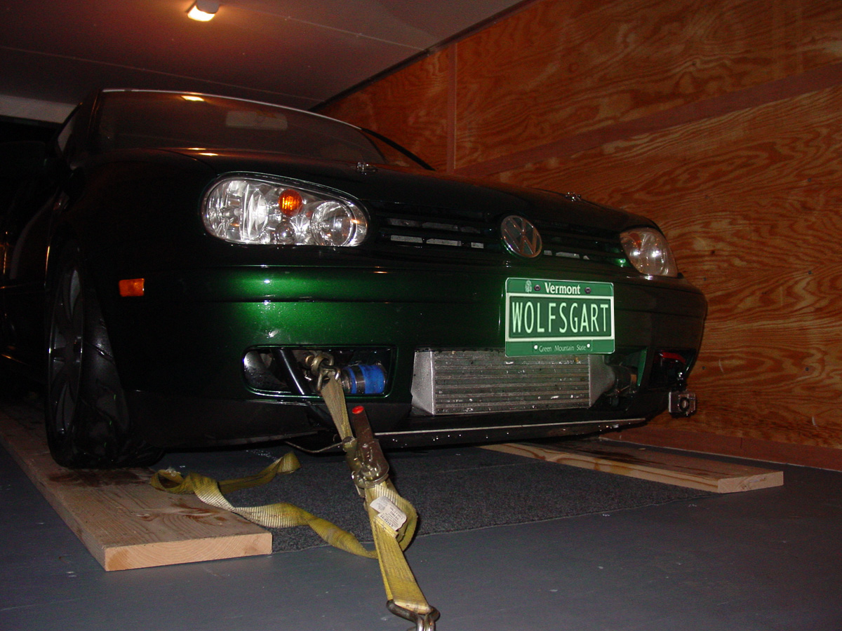

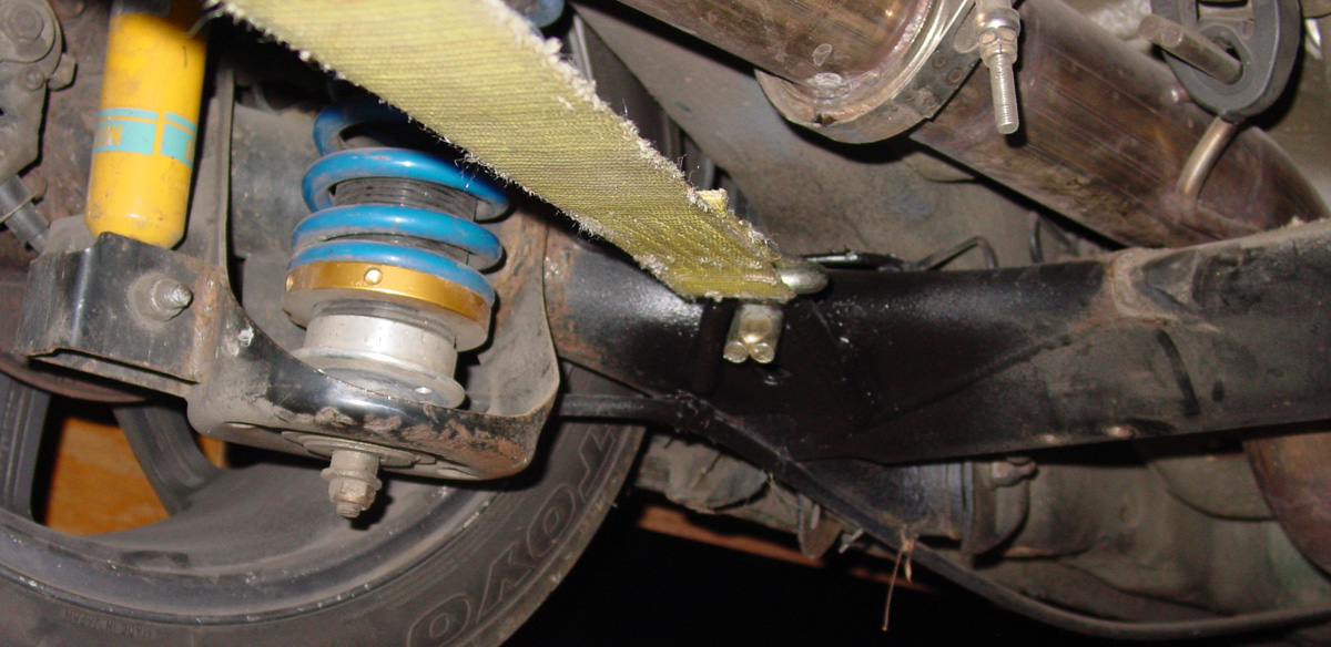

Another think I wanted was a way to tie down the car in the trailer without having to use a wheel.  I was putting the straps through the wheels to hold it down in the trailer.  Enter some new tie down spots on the car....
There is also a new tie down point in the front that mirrors the factory tie tow hook location.... now I have two mounting points on the front (stock tow hook plus new hook)

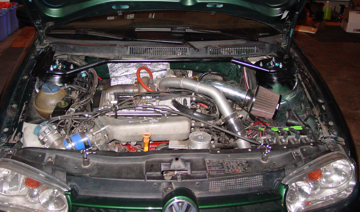

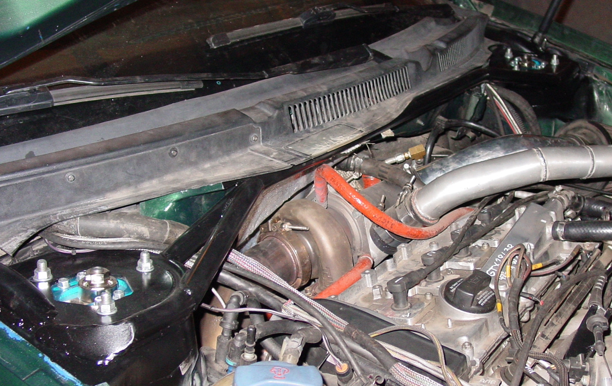

Cooling!!! The car is running hot with the FMIC in front of the radiator and the full belly skid plate.  I have been researching options and talking with other people to see what they did to keep their engine running cooler.
I believe that I will go with a louver on the hood, misting system for the radiator and FMIC... plus a more efficient radiator that is waiting to be installed.

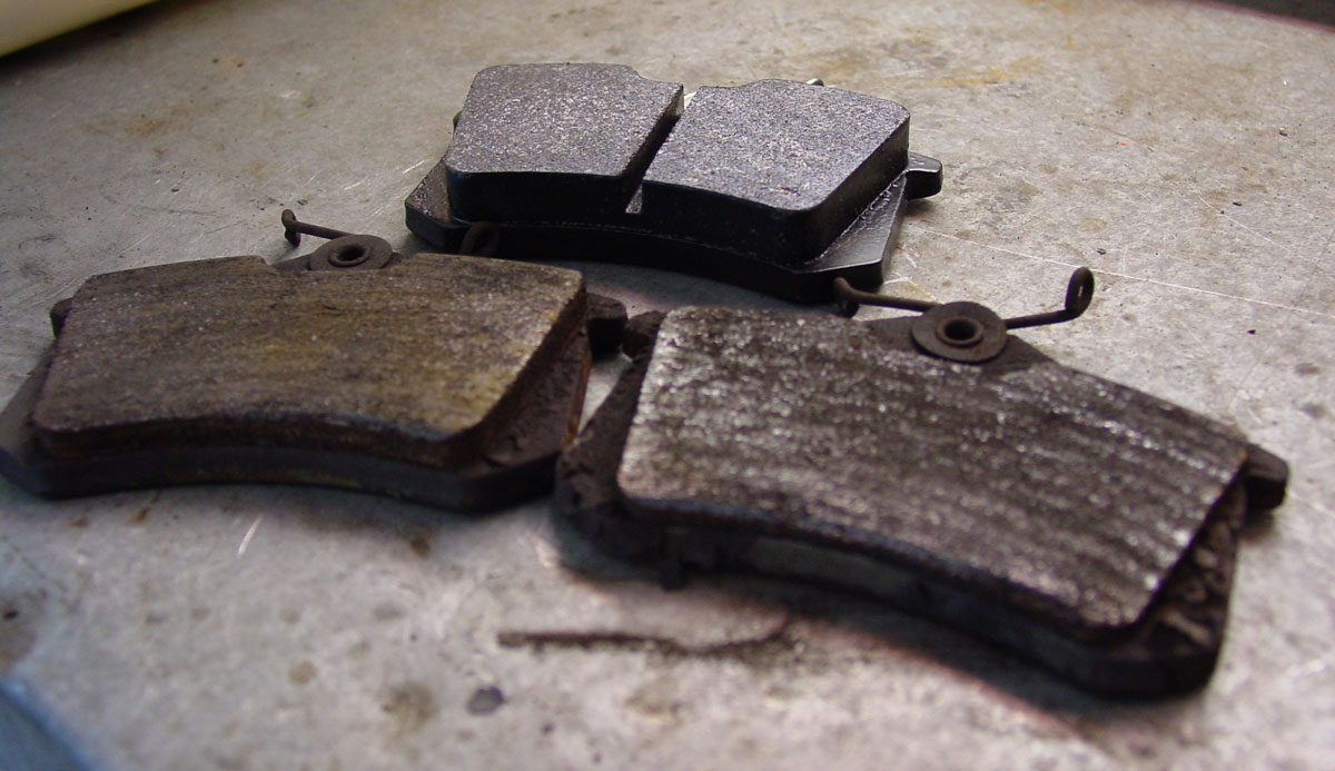

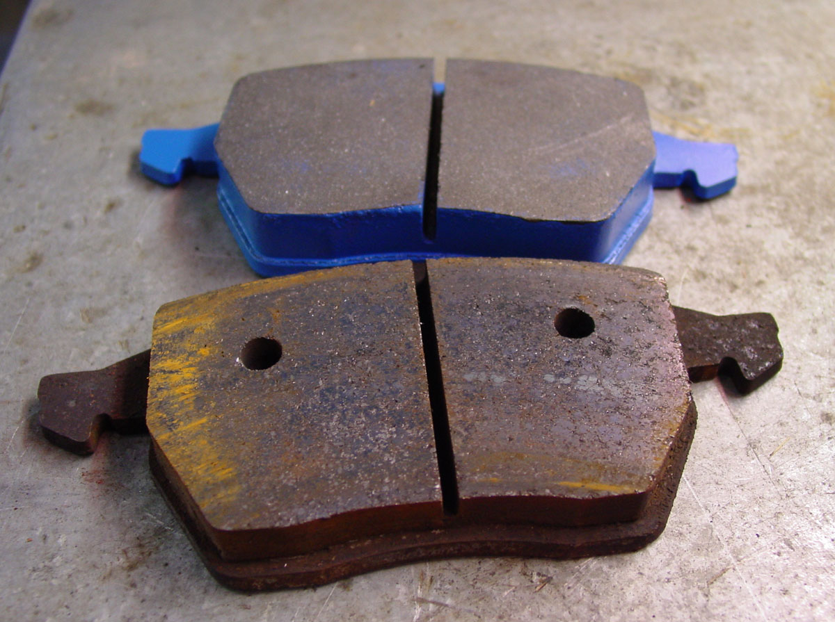

Currently, I have EBC Yellow (if memory serves) brake pads on the car; these are designed for the track because they take some time to heat up, but they work great when hot.  With hillclimbs, you start out at 100% speed (cold tires and cold brakes) with no opportunity to warm things up for best performance.
To help with the brakes, I am going to install some pads that heat up a bit quicker.  Additionally, I am trying a different compound in the rear to balance things out.
Tires.... bald last year and bald for the first hillclimb of this year (I almost wish I put the new tires on at Ascutney).  Enter a set of Toyo R888, 235/40/17, that I tried the heat treated option this time.

My old towing rig (2001 F250 7.3 Powerstroke with open trailer)... loved the truck.
The 7.3 is actually a very desirable engine, but I needed a bit more power and gearing with the enclosed trailer. Honest, I did not try to color match the truck to the car, it was just what was left on the lot when I was looking for a truck.

* Mount the new tires

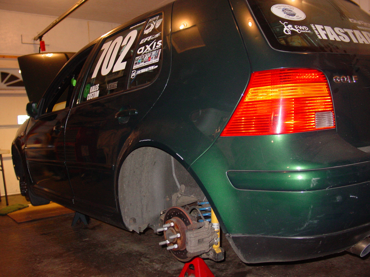

Goal today was to get the car off the ground, remove the tires (prepare for brake install and possible tire change), and remove the front end/radiator.
Mission accomplished.

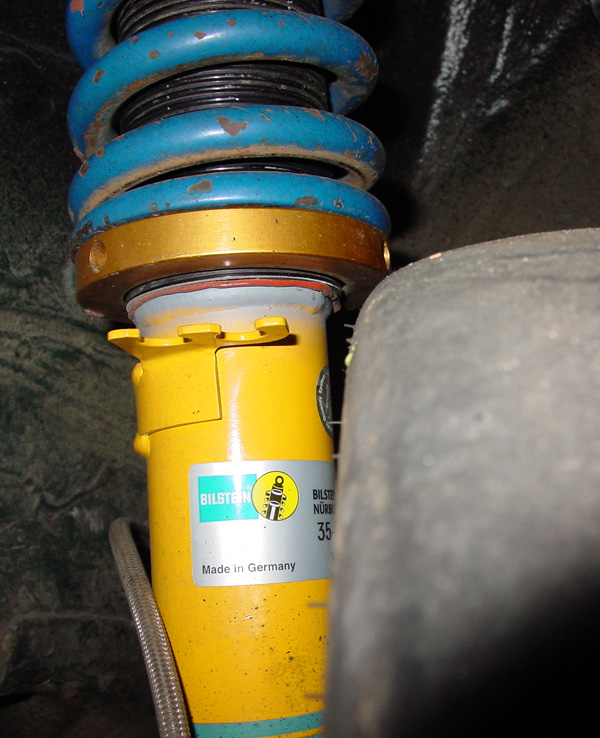

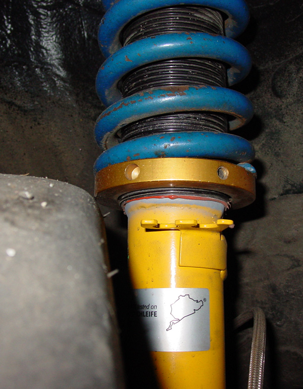

When I was getting the car aligned, Ralph mentioned to me that the tire was really close to the spring. Okay, no problem, I will order some spacers.  4mm spacers on the way... is that enough?  Unsure at the moment.  Brainstorming other ideas.
The wheel is not touching... more of the camera angle than anything.  It is close, though.
Back to the brainstorming session (weather man said it was a weak system that was moving slowly)....

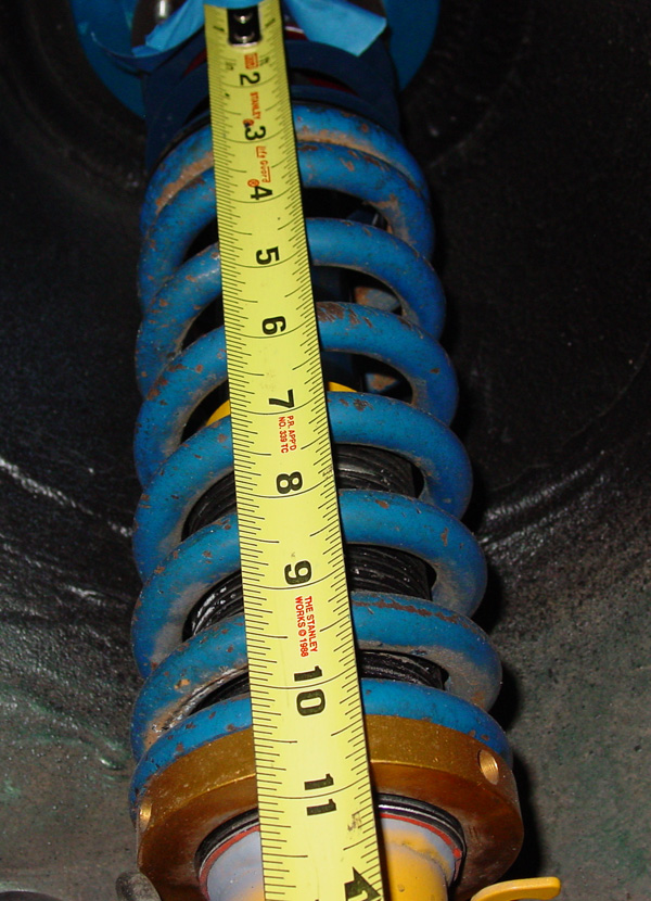

Another shot of the main and helper spring.... I am looking at other spring options where I can use the 3" 200# tender plus a different main spring (shorter and less stiff... it is currently 500#).
Height of the springs (measuring tape is at the top of the helper spring) when at full droop (limited by sway bar).
With helper spring depressed (jack under the control arm)
Approximately what it would look like sitting on the ground.... The jack under the control arm is supporting the entire right side of the car with both the front and rear off the ground and the left side supported by jack stands.
Spring rate and length brainstorming will begin tomorrow.  Oh, the back spring (I forget the rate at the moment) is an 8" spring at full droop.

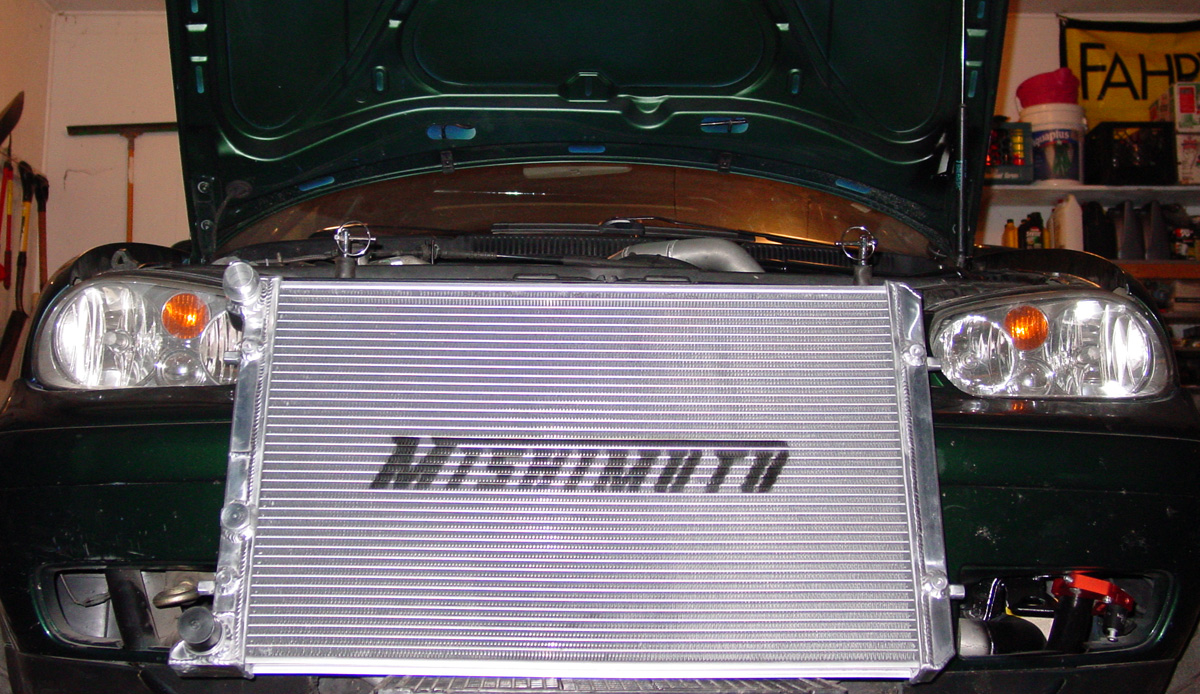

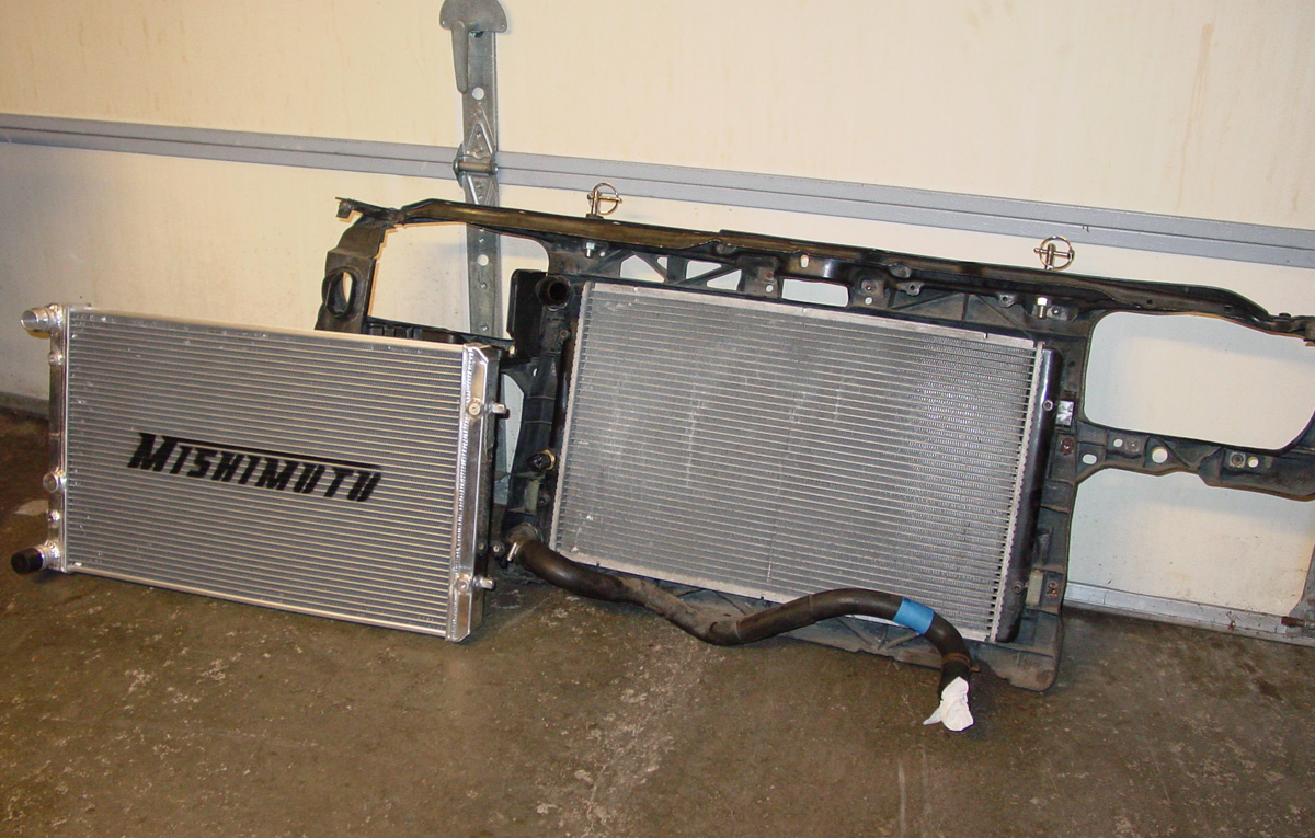

Side by side comparison of stock vs Mishimoto radiator.
I do need to purchase some of the plastic/rubber retainers (holds the radiator in place on the two pegs on each side of the radiator), fan switch (I'm in there, it gets replaced!), upper and lower radiator hoses (again, I'm in there....), etc.
One thing of concern are the hard plastic connectors that mount directly on the radiator... the rubber hoses connect to the hard plastic connectors. They seem to wiggle around a bit on the new radiator; unsure if this will be an issue with making a good seal.
How it sits.... time to order some parts online and then hit VW in the morning.

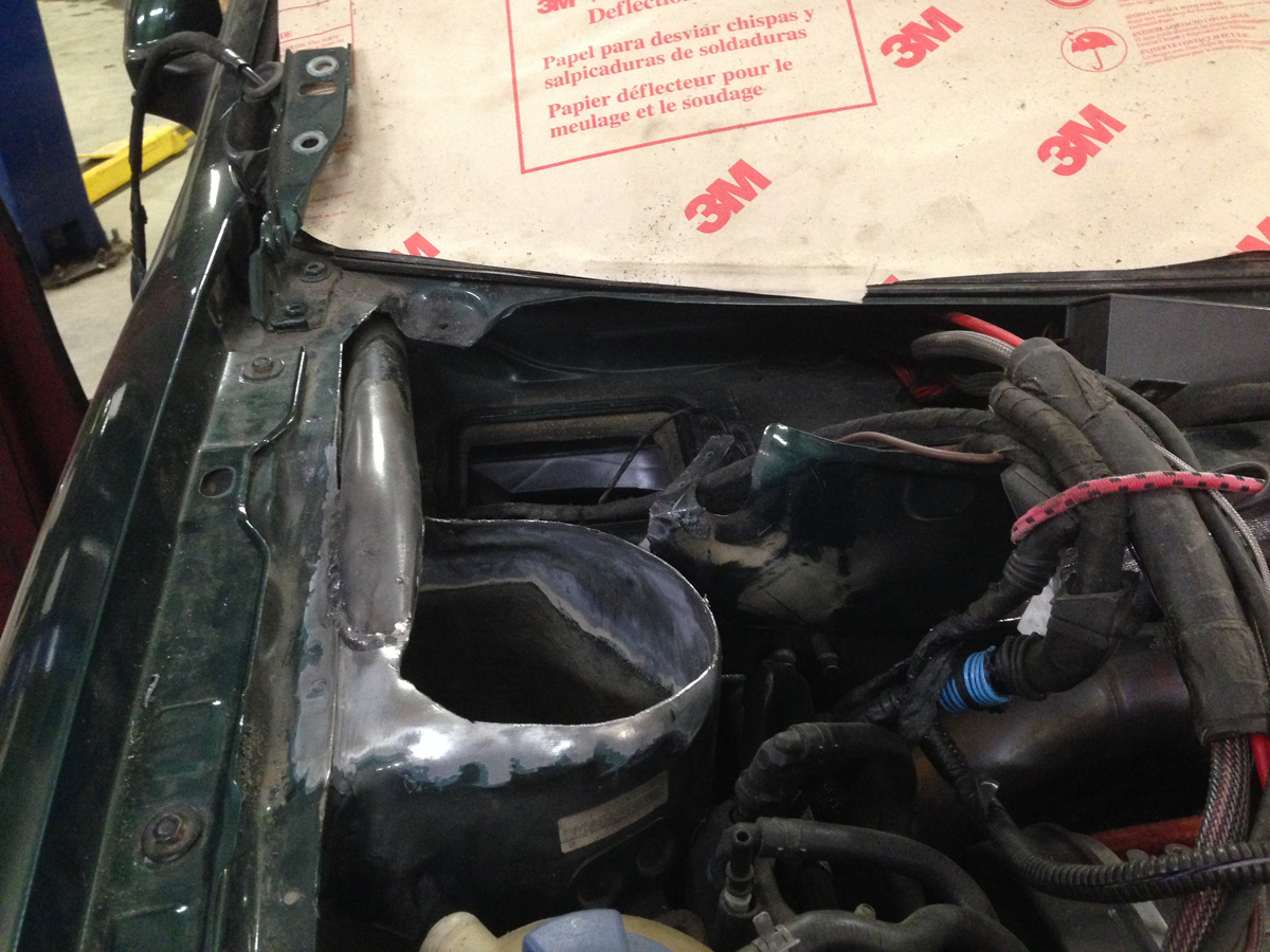

The work continued on the installation of the bigger aluminum radiator.  I read somewhere that some fabrication was needed so I purchased a new Dremel to replace my old one that gave up the ghost a while back.
Cutting a hole in the plastic front piece....
Guess what?  The headlight is supposed to be there!  I had to cut a hole in the back of the headlight to make everything work.  I am unsure if this modification is needed on a perfectly straight car, but I am thinking it was only necessary (especially the headlight cutting) because of the car-meets-tree incident in 2010.
Installed....
Trying to block airflow around the radiator....
The fans worked just fine before.  They were from one 20AE parts car that was harvested for the frontend parts.  I noticed that the nuts that held the fans to the bracket were very rusty so I sprayed them with PB Blaster and tried to remove them.... snap! (I don't have the power!) There were so rusty that they were not salvageable.  The fans did make a little noise when free spinning them. I figured since it was apart, I might as well replace the fans.
In with the new....
There.... all ready for the Mt. Okemo #1 hillclimb….. where things got interesting.
Here is the video of one* of my runs at Okemo. If you have watched my past videos of Okemo... this is essentially the same with ONE exception.  I attached the GoPro to the shifter and used the footage as picture-in-picture.  What is slightly interesting is that the audio is coming from the out of car video clip and that the in-car and out of car used the same camera on two different runs.  Seems I am pretty consistent with my driving as the PIP in-car footage with the shifting matches the audio from the out of car video.
http://www.youtube.com/watch?v=kdLJrRX3mpw
*some video editing was done to make three separate runs look like a single run because I only have one GoPro camera.
So.... the end of my second to last run on Saturday had an interesting result just after the finish line…. the car kept accelerating even though I was not pushing the gas pedal.  The gas pedal moved away from my foot and stuck to the floor.  I stepped on the brake pedal and it was hard as a rock because the car was boosting. (there was no vacuum for the brakes).
Yes, the danger must be growing
For the rowers keep on rowing
And they’re certainly not showing
Any signs that they are slowing!
Thankfully, the finish line is essentially a straightaway, so I was able to get things under control by shutting the car off.
What was strange is that the car did not rev if I had the clutch depressed.  When I put it in gear, the car would accelerate; slowly at first and then ramp up to full throttle.  Press the clutch and it went back to idle.  Huh?
A little prodding around under the hood, we discovered there was a dent in the hood where the throttle body was making contact with it.  We cut off the cruise control connector (I think this is what it is for) and went for another run.
Same result, but not as bad as the first time.
More prodding, thinking, drinking, and head scratching… then alais!
The nut that held the dogbone together decided to take a permanent vacation.  This means that the engine was free to swing in the engine bay. Therefore, thus, and hence, the throttle body was pressing against the hood.  The more it pressed, the more the throttle opened, the more it pressed, the more…. You get the picture.
With the help of a lot of people at the event, in the dark no less, we were able to take a thick nut and make it thin to reassemble the dogbone.  All runs on Sunday were good.  I just needed to change the spark plugs (I can tell when they are going…. Sluggish acceleration)…. I felt lazy before the event and didn’t replace them.  Too bad for me.  (insert sounds of a Waaaaamulance)
Got the car home to prepare for the Mt. Washington hillclimb.  Yeah!  Lots of small things to do to get ready for this event.
First… fix the broken stuff.
The “Okemo fixed dogbone” held together.
New 034 EFI Motorsports dogbone…. Yeah, I know that I have the little metal piece upside down in the picture.
Since the engine was swinging (yeah, baby, yeah!) in the engine bay, it managed to strip the mounting point in the bottom of the transmission.
Easy fix with a Heli-Coil repair kit.  First time using it.  Was straight forward and easy to do.  Sweet!
New 034 EFI dogbone installed…. Pretty.

I was convinced that the ECU did not know the throttle position because it was slow at ramping up the acceleration (I noticed this at Okemo) and would bog down if I floored it really quickly.
I replaced the spark plugs, checked the spark plug wires (made a new wire for #3 because the resistance was a lot different from the other wires, but I think this is because the original batteries in the volt meter that I purchased back in 1998 were finally dying), and checked the mechanical timing.  All was good.
From the 2010 car-meets-tree incident, the mounting points for the TPS on the throttle body was damaged.  I figured this must be the culprit because I can SEE that it was broken. I can replace broken stuff.
Don’t ask how much this was to overnight it to me.  CTTC2014 entry fee is $800…. I wasn’t going to be sidelined for a bad TPS.
Installed.  Pretty.

Turns out the engine swinging (yeah, baby, yeah!) at Okemo damaged one of the TPS wires. Jason repinned the plug.  More on wire breakage in the next exciting episode of Golf-meets-the-top-of-Mount-Washington!

First, the coolant line that went to the turbo became loose.  Joey and James (http://www.KalesCustom.com) just happened to arrive at the bottom of the hill and they jumped in the took care of it.  Nice!

In a nutshell... 3rd gear gave up the ghost at Burke.  My belief is that Mt Washington, which is a long hill where I am using 3rd for most of the course, pretty much broke it, but it didn't actually fail until Burke (surprisingly, when I was in 4th gear).
I get the transmission back tonight (Tuesday) from http://www.SixStarMotorsVT.com (Charlie) and hope to get everything back together and ready to go for the Okemo hillclimb this weekend (Friday).  Fingers crossed.

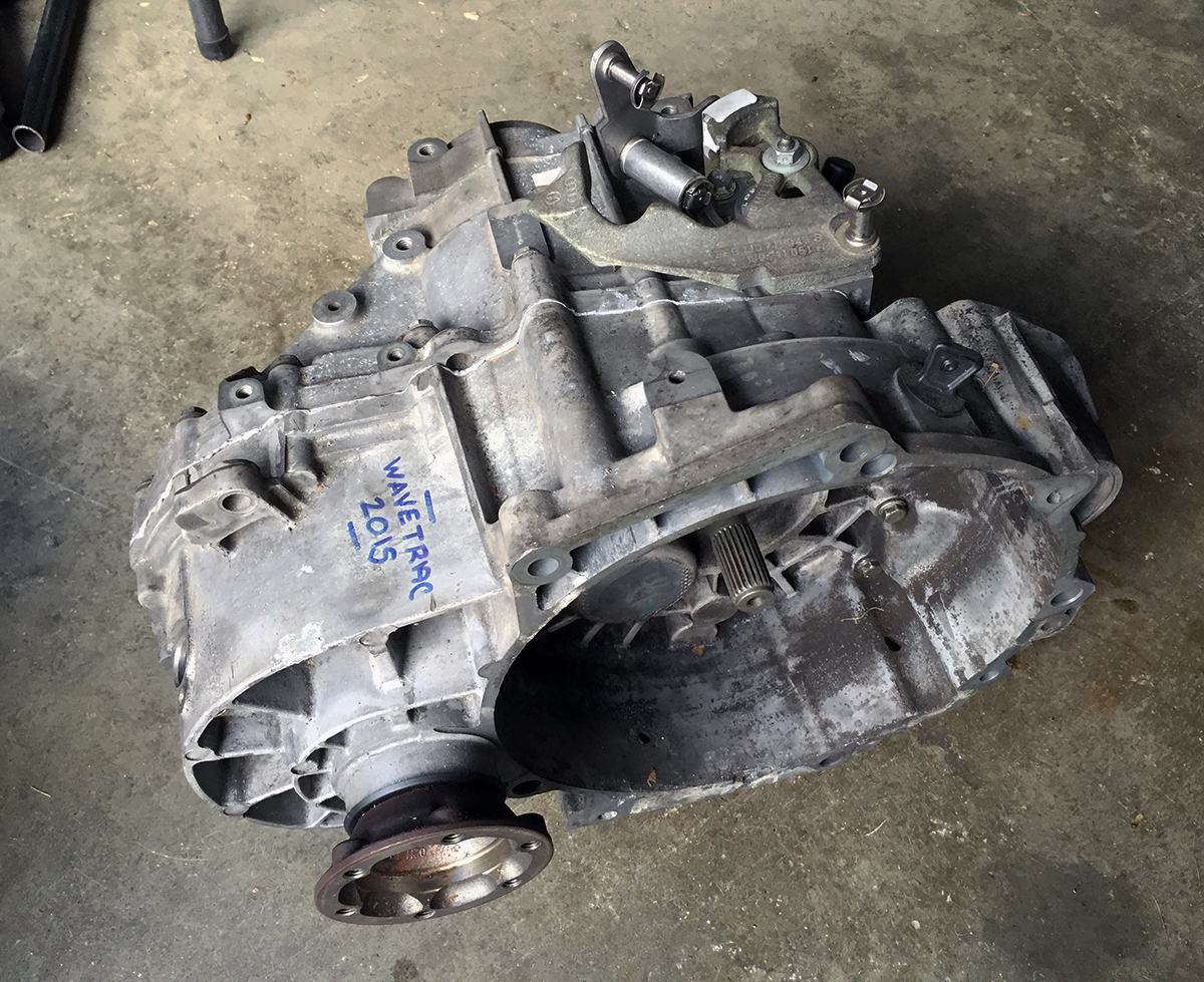

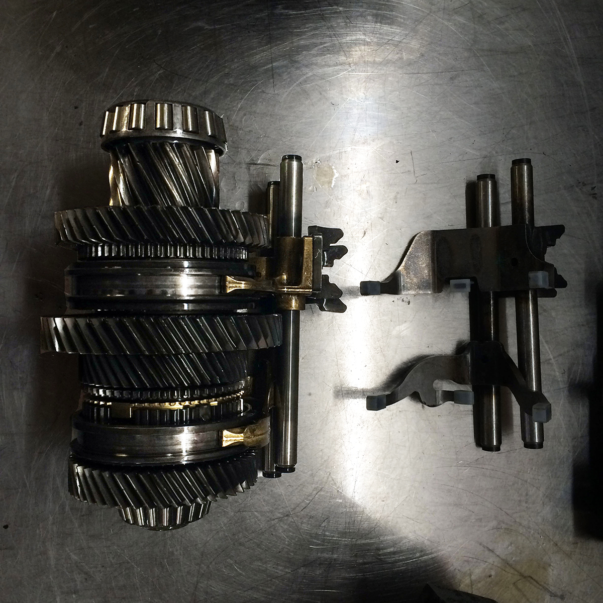

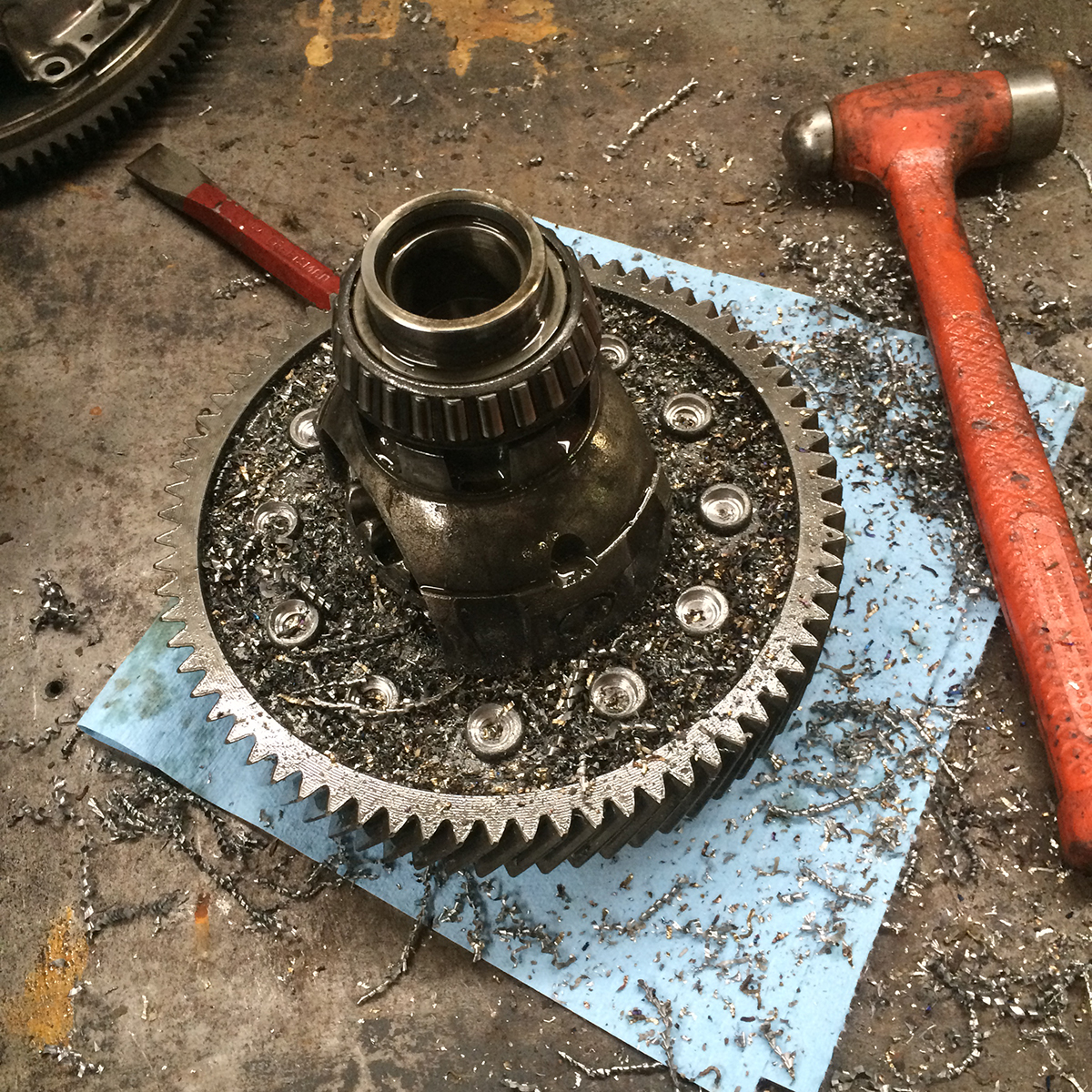

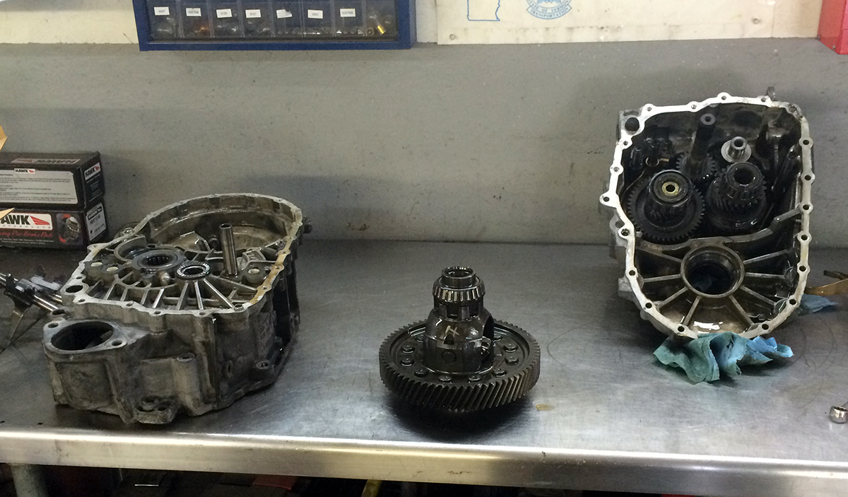

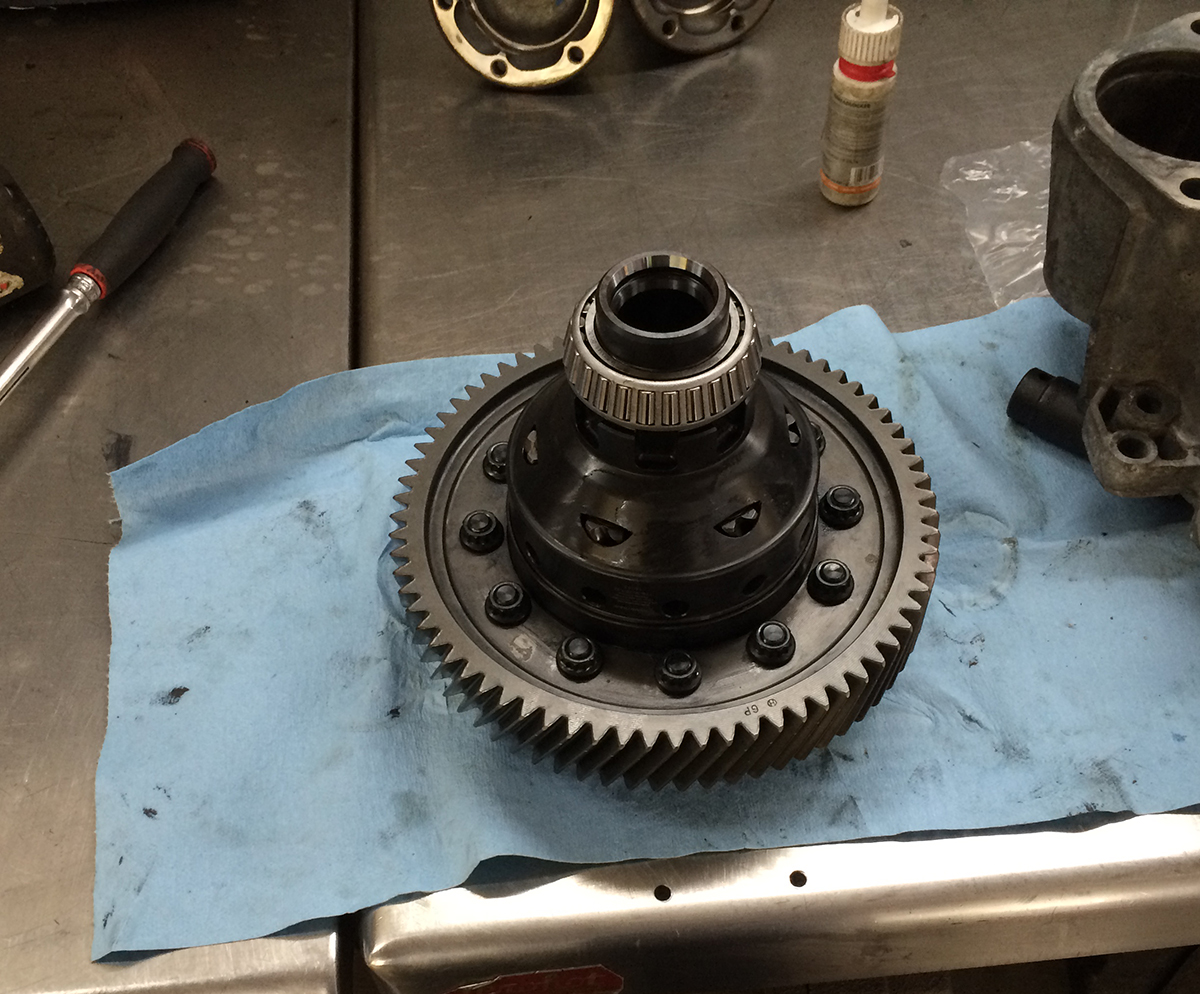

As mentioned, transmission went at Burke so we swapped the complete diff to another transmission that I had laying around (hmmmm, since a 2010 tree incident).  Put the transmission back in the car and I noticed there was a clunking noise when rotating the wheels; decided that there were issues and not to try it out.
Purchased another 6-speed online and brought everything over to (new website address!: [url]http://www.sixstarmotorsvt.com[/url]) Six Star Motors in Colchester, Vermont.  Same building as Libra Racing (John Buffum)/home of Super Chicken.
Charlie identified that some of the teeth on the diff were damaged so he swapped the good diff ring gear from the "new" transmission to the diff and put it all back together.
In case you don't know what a transmission looks like.  ;) This is the "new" transmission.  Same gear ratios that I had before.

Purchase some shifter bushings and shift mounts from [url]http://www.42DraftDesigns.com;[/url] both for the transmission end of things.  Will install in January 2015. Plus, purchased "VAG Connector Removal Tool" for $15 from [url]http://www.ECSTuning.com[/url] to make it easier to take VW plugs apart.... Rabbit Farmer approved!

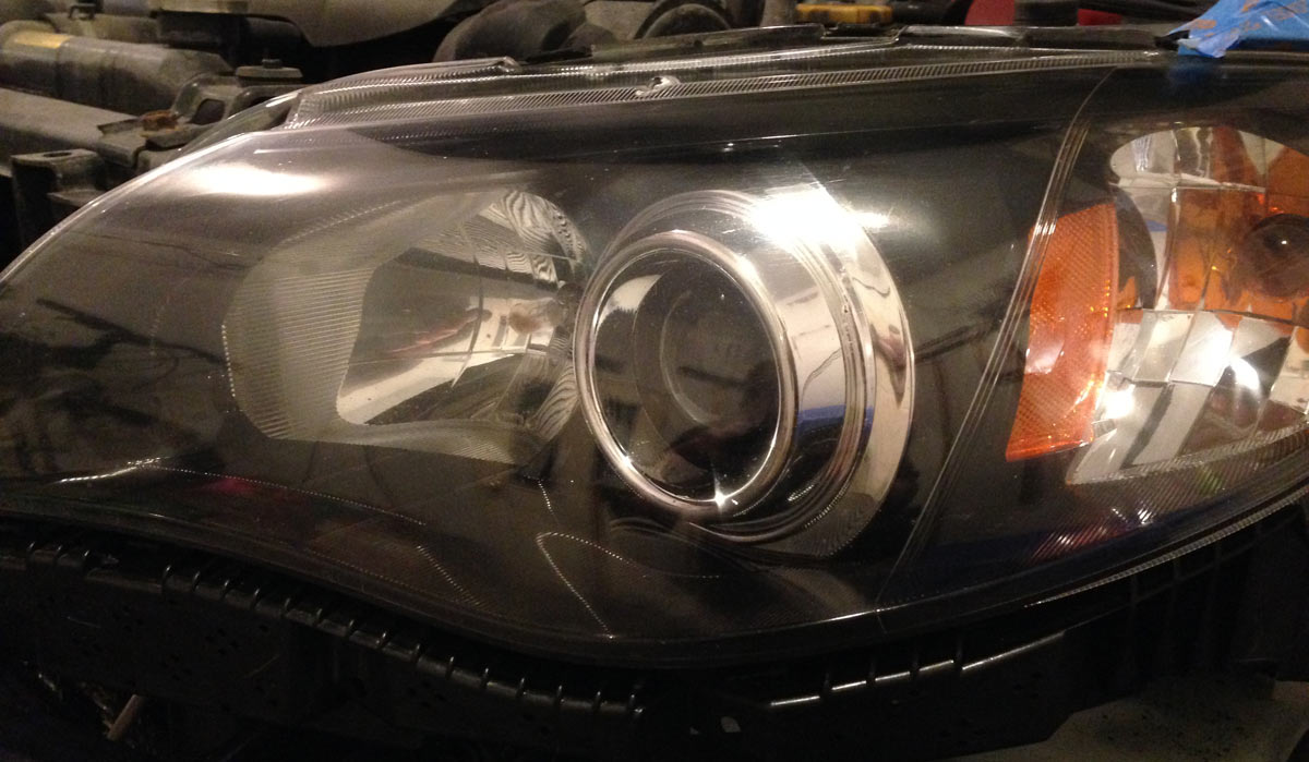

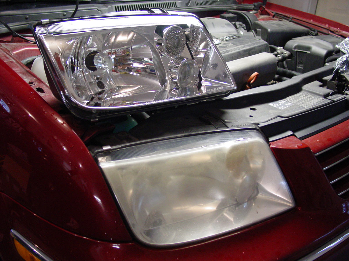

Jetta needed new headlights.  I polished them the year prior (or so); decided it was time to replace them.  Did not want to spend the long dollar at [url]http://www.ECSTuning.com[/url] (almost $300), so I got a set from an ebay vendor.  This picture (with new light over the old) is the ebay special with clear directionals that require amber bulbs.
Now... imagine that they are the absolute worst possible quality available... these are from DT Moto.  They do not make the lights, just sell them.
[url]http://www.ebay.com/itm/131185073888?item=131185073888&viewitem=&sspagename=ADME:L:OC:US:3160&vxp=mtr[/url]
Nothing was right about the lights.
* The bulbs type, per the instructions, did not work... unsure what bulbs would actually work
* The internal plastic hosing where the lights are mounted was not tight, therefore, it moved a lot (would cause a lot of flicking lights)

Purchased nice wiring harness to run the fog lights.... easy to install.
Installed...

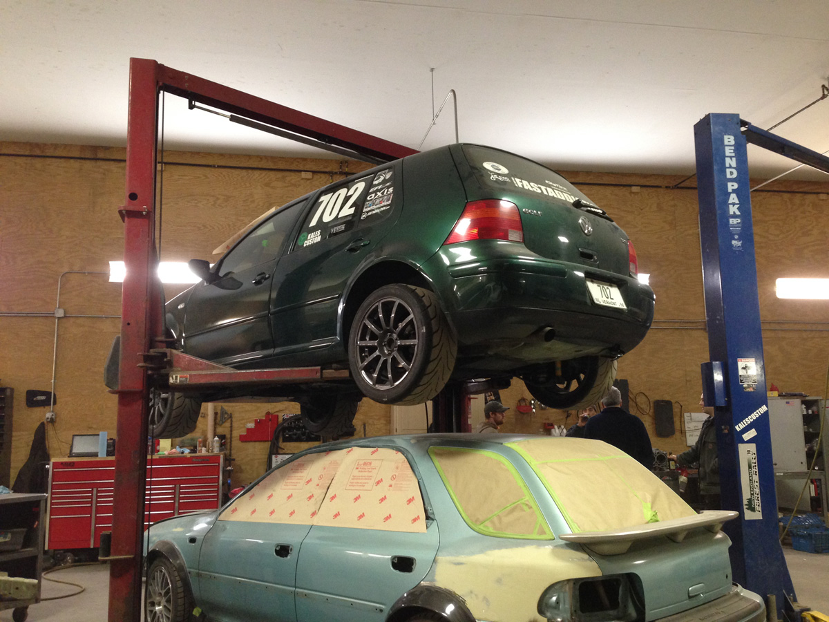

First, Joey at KalesCustom.com addressed the camber plates as we wanted a little more camber adjustment available to us in 2015.
What it looked like in 2014:
And now in 2015:
Did a better job with a heat shield on the firewall; when it all goes back together, I will also add some heat shielding on the upper firewall/rain tray to protect the electronics in the rain tray.
A big part of wanting to improve the heat shield was to protect the fuel lines... a big improvement for 2015 is the removal of the plastic lines and the installation of hard lines.
Straight through to the fuel rail without any rubber lines.
Car heading home from Kales Custom in February 2015

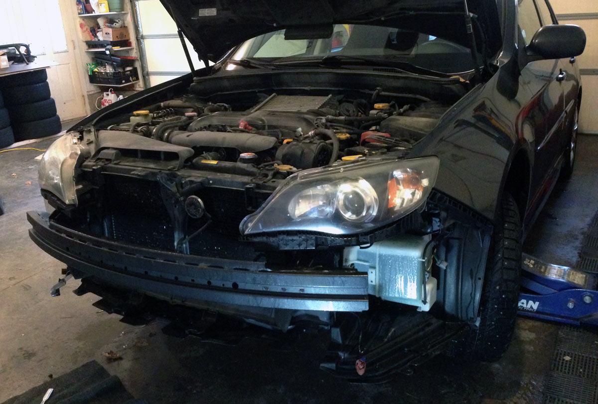

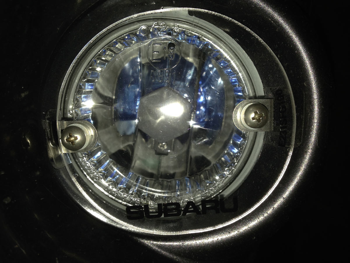

Since I didn't want to work on the Golf, I addressed the headlights and fog lights on the 2009 WRX.
Pre-polishing...
And done! Second time that I have had to do the headlights on the car.  Not difficult, but I liked the idea of using lens protectors for future cars.
Broken fog lights.  It was an option to have lens protectors on the fog lights when we first purchased the car, but we didn't do it since it was expensive as they stated they would have to remove the front bumper (which is actually pretty easy to do on these cars).  So, we didn't do it.
Purchased the new fog lights from http://www.SubaruPartsDepot.com and the lens protectors from http://www.subarugenuineparts.com.
The covers are called "Fog Light Protector Acrylic Shields" and were quite easy to install.  Even easier with the bumper removed as I had to install the new fog lights.

Ordered Bilstein struts/shocks and lowering springs from Race Comp Engineering (http://www.racecompengineering.com). I went with the GTWORX/Bilstein Cup Sport Kit with their Black "Regular Guy" springs.
Stock springs are 216# front / 209# rear while the "Regular Guys" springs are 275# front / 250# rear and provide a 25mm (slightly less than 1") drop. A little stiffer than stock, but still year around comfort.
Seems the springs are back ordered... hopefully the install is quick and easy as the alignment appointment is on May 7.
2001 VW Golf 1.8T
Been procrastinating with finishing the Golf.  I started with the big stuff at the end of last season with a goal to have this 100% done in February +/-.
Short version... new brake pads, bled clutch, installed some parts on the shifter to stiffen things up a bit, ordered new harnesses (they have arrived), etc.
To be 100% ready for the season... alignment, install harnesses, install front bumper, clean it.

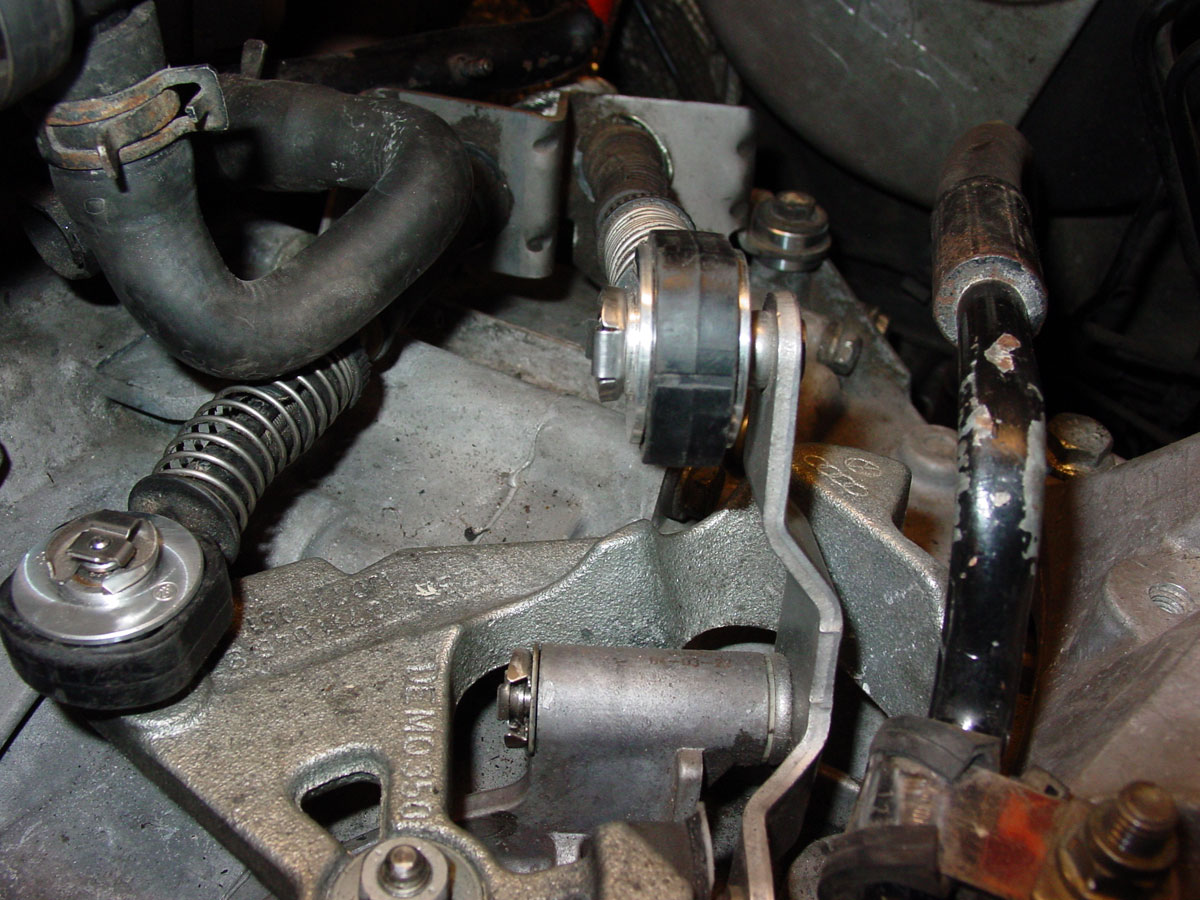

Draft 42 Designs (http://www.42draftdesigns.com) shifter bushings for the cable ends. (See #10 and #17 in the image below)
Draft 42 Designs shifter bushings (See #9 in the image below)

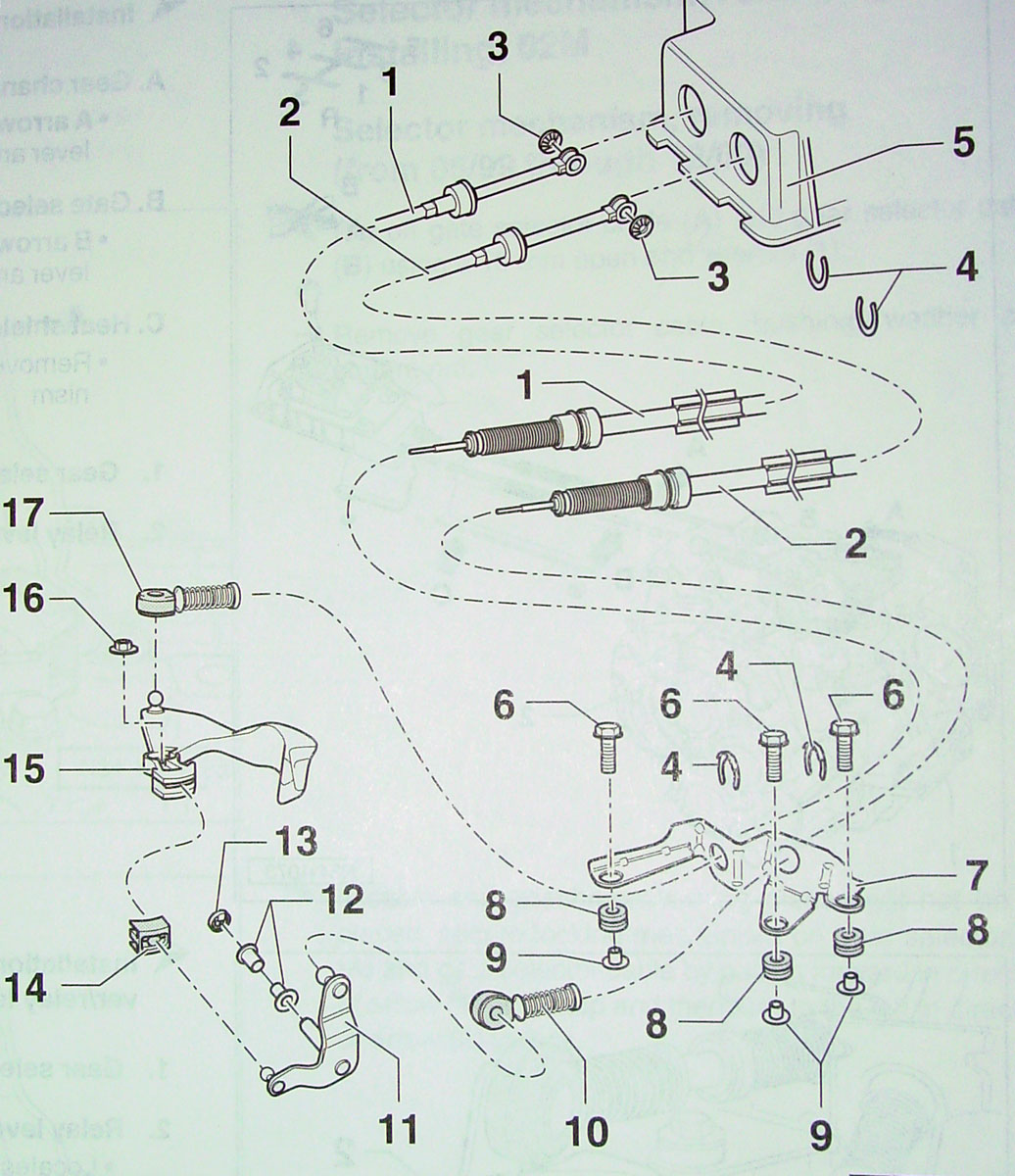

Image from the Bentley manual for reference.
Also, one part that I wanted to replace was #14.  In the manual it is called a "Slide Shoe", but the internet searches state otherwise.... no good results. Shearer VW (f/k/a Lewis VW) was finally able to identify and order the part; they call it a "Friction Slide".
Per http://www.ECSTuning.com, it is called a "Shift Lever Slide"....
http://www.ecstuning.com/Volkswagen-Golf_IV--1.8T/ES4915/

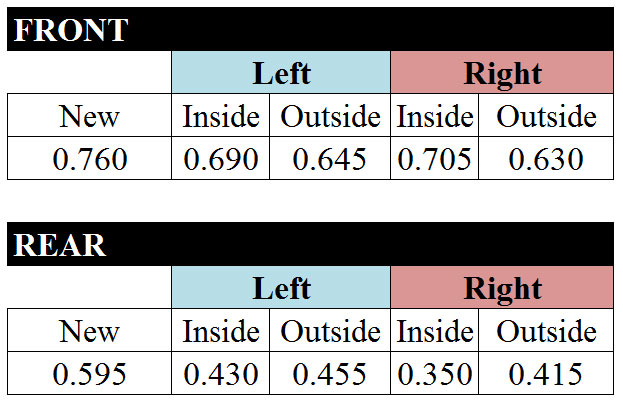

I purchased a new set of brake pads last summer with the intent of installing them.  Didn't happen.
Fronts are Hawk Blue 9012 and rears are Hawk HP Plus (cooler pad); thought is that the rear pads and front pads will come up to operating temperature around the same time as opposed to running hot pads front and rear where the rears will never see the high temps at a hillclimb... at a track they would.
Front pads: Not a lot of wear on the fronts.
Rear pads: Lots of wear! Unsure where there is such a huge difference in wear between the fronts and rears.

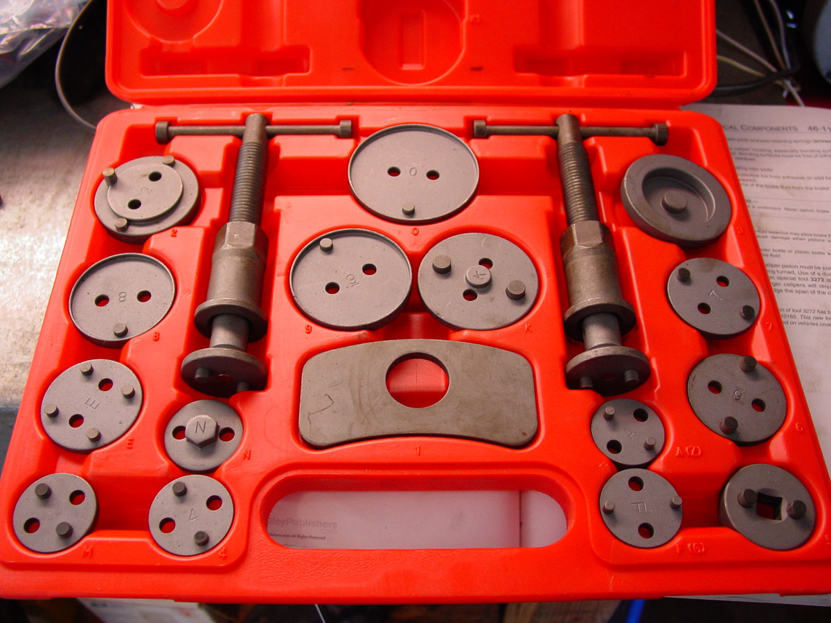

A must have tool for the rear calipers and they require turning/pressure to push in the piston
For those of you that like to see numbers (in inches)

I picked up TWO replacement transmissions; one to rebuild the one currently in the car and one for a back up.
After some research, I ended up going with the WavTrac ([url]http://www.wavetrac.net[/url]) LSD for the reasons outlined below.
Wavetrac: Designed from a clean sheet using state-of-the-art knowledge and engineering to be a better differential than any other. It uses a patented design to improve grip in low traction conditions.
Wavetrac: Gives you quicker acceleration and faster cornering by driving both drive wheels instead of just one. And, it offers improved no-load performance when compared to other helical gear differentials on the market.
Charlie at (SixStarMotors.... he now works at Vermont Sports Car!) in Colchester, VT took on the task of building the replacement 02M 6-speed using the WavTrac LSD, new bearings, new shift forks, etc.
The "Steel 1st-2nd, 3rd-4th Gear Shift Fork Transmission Upgrade" are from USP Motorsports (http://www.uspmotorsports.com).
Link to the specific product: http://www.uspmotorsports.com/Drivetrain/Manual-Transmision/Steel-1st-2nd-3rd-4th-Gear-Shift-Fork-6spd-Transmission-Upgrade-02M-02Q.html

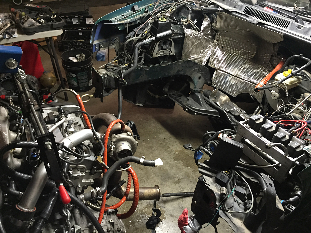

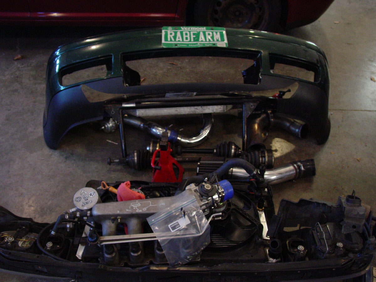

Something different I tried this time was to remove the entire front end as one piece (bumper, FMIC, radiator) instead of removing the FMIC separately.  Unsure why I did it the long way before....
I also removed the engine with the turbo and downpipe attached.  In the past, I did not think that I would be able to accomplish this because the v-band clamp is on the other side of the sub-frame. It was actually quite easy removal and install... and I did not need to mess around with disconnecting and reconnecting the external wastegate (which is a pain as you need three hands to do it).
Removing the ring gear from the donor stock differential
WavTrac LSD with ring rear installed, new bolts, and new bearings... pretty.
New shift forks.... I have never had a problem with them, but figured I would replace them this time since it was apart.
Maiden voyage was at the Okemo #2 hillclimb (I drove the Daewoo... yawn... at Burke and was in Italy for Okemo #1).
Saturday I was impressed with the WavTrac LSD especially on the first long sweeper. Could be a combination of the brand new heat-cycled R888 tires and the WavTrac LSD.  Or.... it could be that the turbo halves were loose again so I wasn't creating any boost.  I would have to go with the latter.  Working on ideas prior to the next event to help keep the turbo together.
