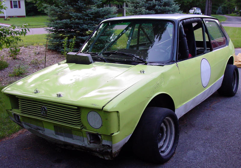

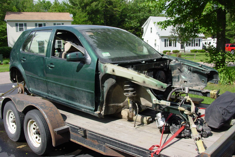

Here is where the car started:
Photos from Day #1 when I was trying to decide if I wanted to purchase this project car....

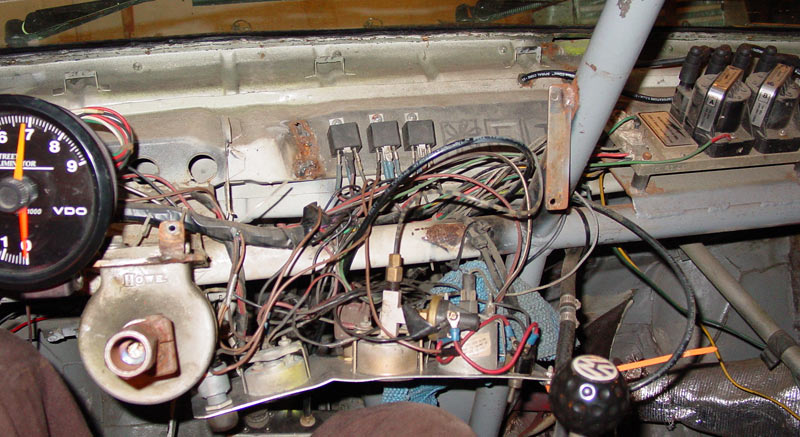

(2) Wiring: Just have to weld a tab in for the fuse box and then plug everything together that is on/around the steering wheel.  Everything else is hooked up.

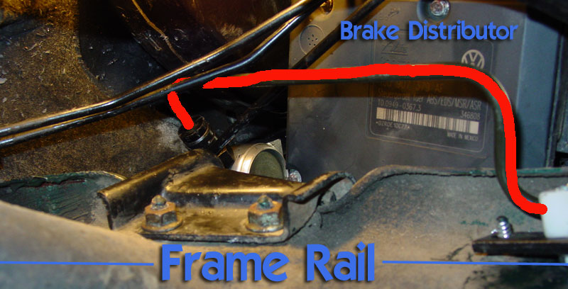

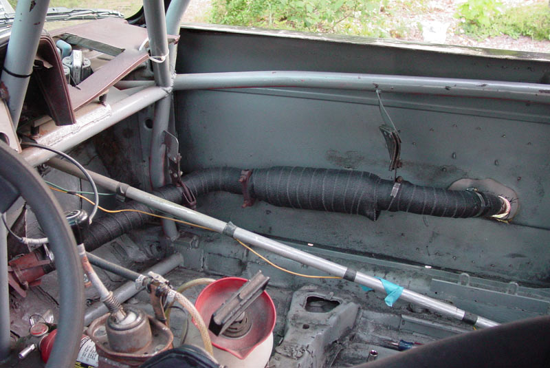

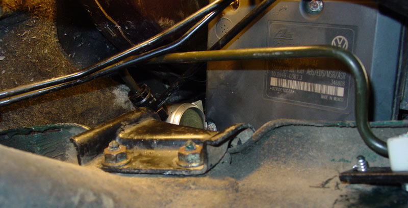

(1) Spoke with Pete down at VW to attempt to order little plastic tube that goes into the vacuum in the front right fender well... not really sure what it does, but it sucks air when the car is running so it must be really important.  Anyway, Pete said that the little tube I need does not come separately and that I would have to purchase the entire tube for $50.   :shock:
Here is the vacuum blue-ball thingy with the broken (half of broken tube is still in the flexible tubing) black connecting tube.
At lunch I decided to figure out what alternatives I had and came up with a brake line (the flared ends were a perfect fit)
Did a little cutting and sanding...
And done!
I did put tape between on the brake line so it could not slide inside of the blue-ball thingy (the lines are secure and shouldn't move around, but I still didn't want to take chances).

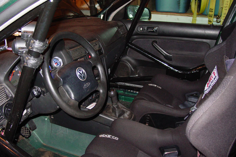

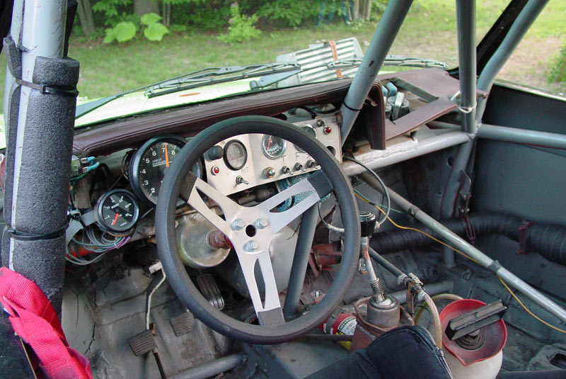

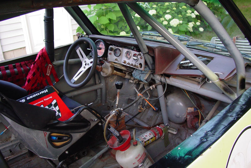

(3) Finished the dash with the exception of the trim at the driver's feet and steering wheel.  Waiting on those until my brother Andy welds on a tab for the fuse box that is normally located at the end of the dash.
I cut off the back of the center section to make it easier to change/inspect the e-brake lines in the future.  I don't want to have to remove interior trim.
(4) Trimmed the door panel (just one thus far) to fit around the cage.  Not perfect (need to slam door) so I will have to tweak a little more.  I might use alum. sheet at a later date, but this is what I have for now.

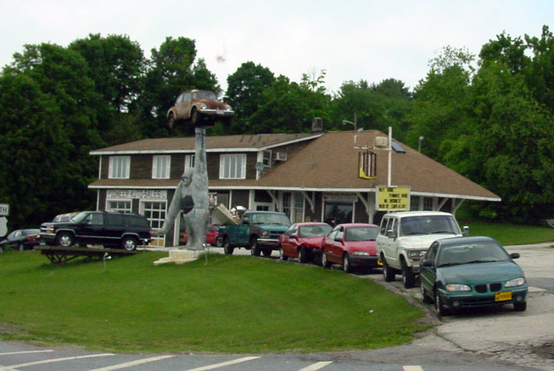

Anyway, headed to Rathe's to cut off the roof of a MKIII Jetta.  Thanks to Chris (vtGTI) for the loan of the cordless sawsall.
Short and quick.

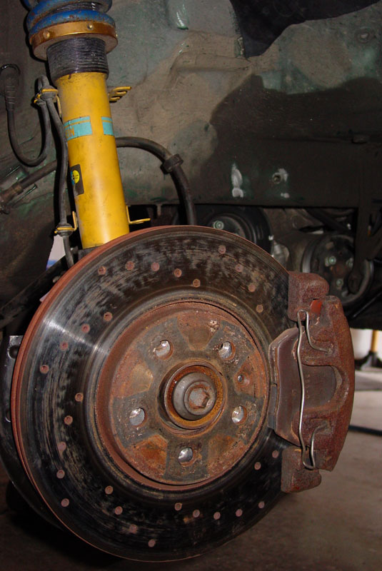

Present arrive from Fast Addiction!
Rears before...
Rears after...
Fronts before...
Front after...

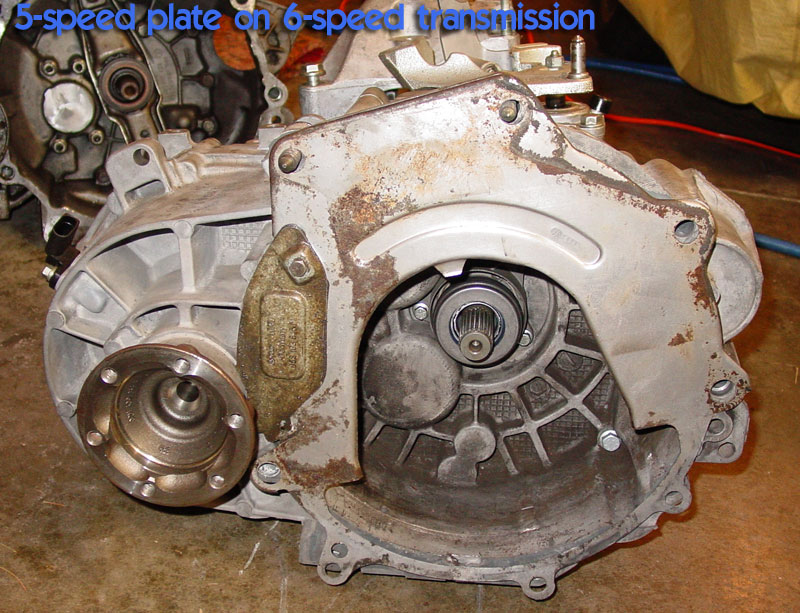

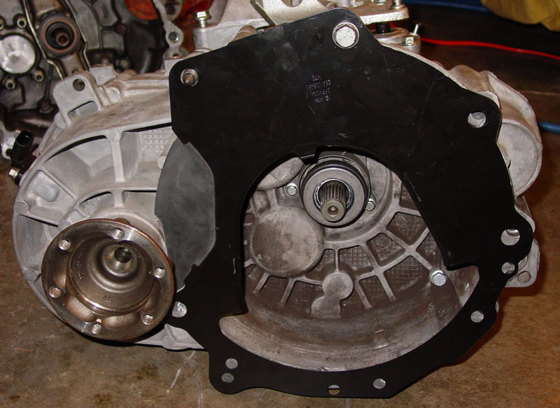

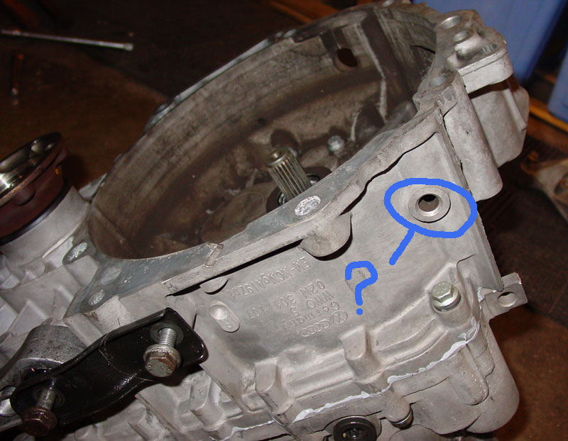

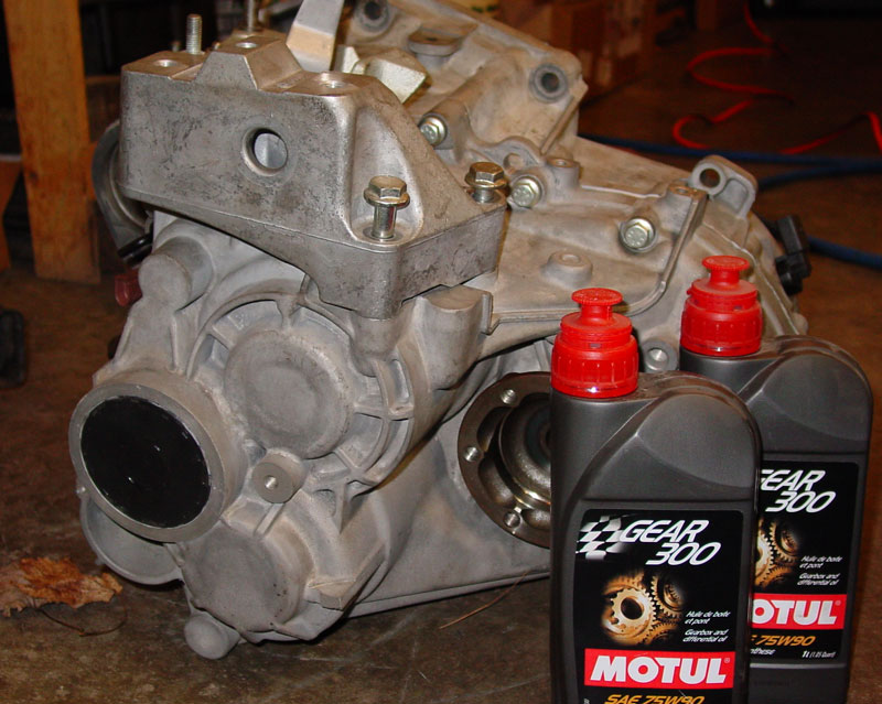

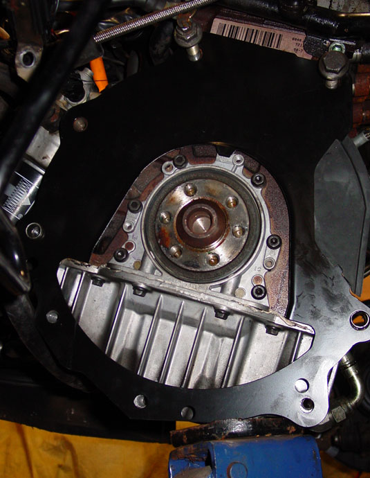

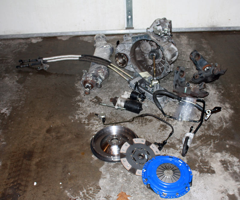

Tranny is out. What a pain. The actual removal of the transmission was easy. Big bolts on the axles, easy motor mounts, lots of big bolts all around the tranny (instead of those 10mm head bolts from the Rabbit that hold the sheet metal cover to the transmission to keep water out... and that little piece in the back/behind the passenger side tranny flange), easy to remove parts underneath, and it just slides out soooo nice. The pain was the hours we had to spend on the top of the engine trying to figure out how to remove all the crap.
Transmission goes to Fast Addiction tonight (11pm) to start its journey towards enlightenment (e.g. LSD).
The issue I did have with the removal is the bolt that holds the back of the dog bone to the subframe snapped off (I just barely started to turn it with very little force). The bolt looked more like chalk instead of metal. And, in my efforts to remove the dog bone (the bolt broke off leaving a stud still in the hole) it looks like I broke the back of the dog bone. So, I will need to get a new one. Doh!

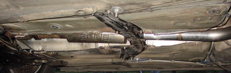

This week: front bumper off, exhaust off, DP off, exhaust mani off, clutch/flywheel off, SMIC off, power window control in. That should do it. Then start ordering parts.
Still looking for a hood and front bumper. I believe I have a lead in NH for the front bumper, but local would be better.
No pictures... figured you know what it looks like to remove a transmission. I have to say that I do not like the Bentley for the MKIV. Funny part of the removal, there was one like that stated (in a nut shell) to go to the electrical section for removal instructions for the starter. Okay, looked at the section on how to remove the starter... zipped to the step near the end since all the previous steps were completed until I realized the ONLY step that I needed to follow in the starter removal process was to remove the lower bolt on the starter. Um, they could have told me that in the transmission removal section.
John at FastAddiction.com has the transmission and is installing the Peloquin LSD.  Want a go fast modification?  This is a great thing to get!

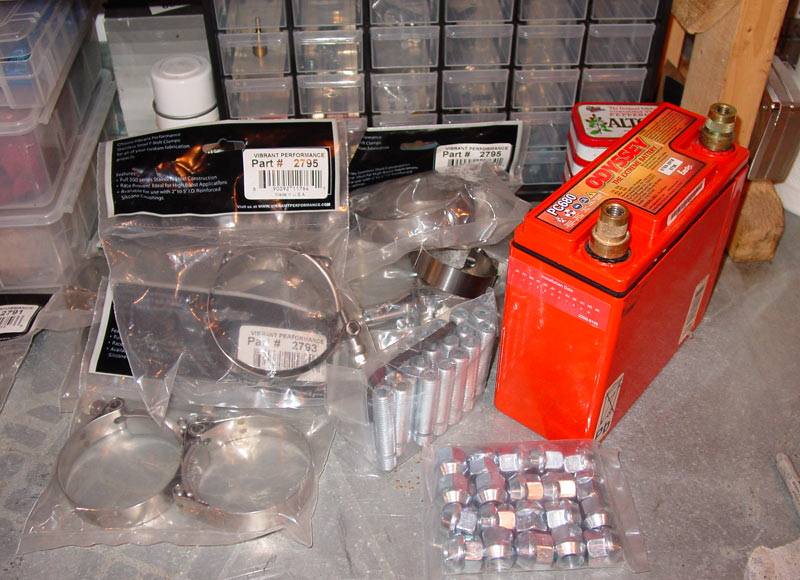

I recent purchased a MINT front bumper from a fellow Vortexer (I had to drive to the intersection of 89 and 93 to pick it up... and then on my way home stop by at FA to get some parts).
Here are the 'some parts'

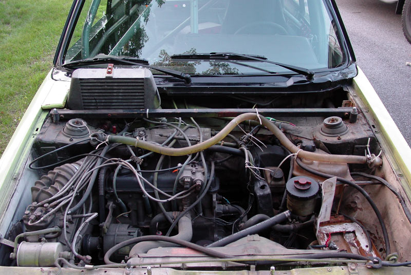

Progress continues..... Car still isn't faster, but I now have all the body parts I need and the transmission is back in.  I wanted to drive it around a little tonight to make sure everything was good (plus I'm supposed to put 450 miles on the clutch before any hard launches... I don't drive that much in a year with that car... LOL).  But, since I didn't completely bolt the DP to the turbo it was loud as hell.  Don't worry, it is just hooked up for moving the car around (get on the trailer, etc.) and the ol' foot won't punch the throttle creating a lot more boost that it can handle.
Anyway.... a little progress.

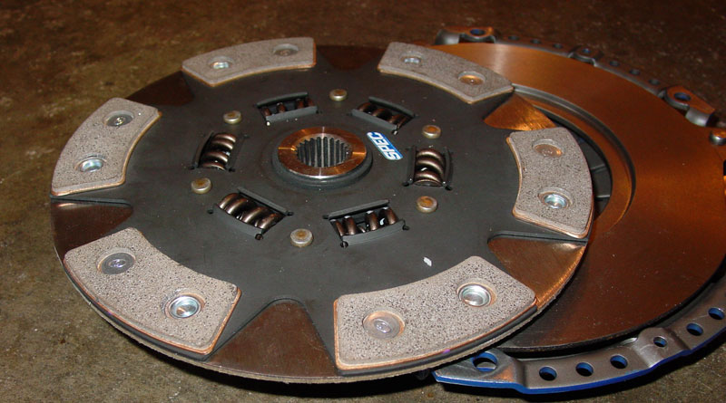

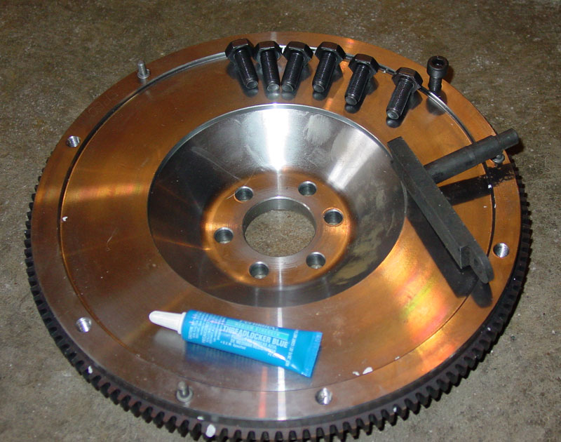

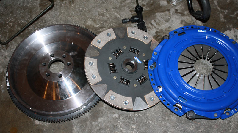

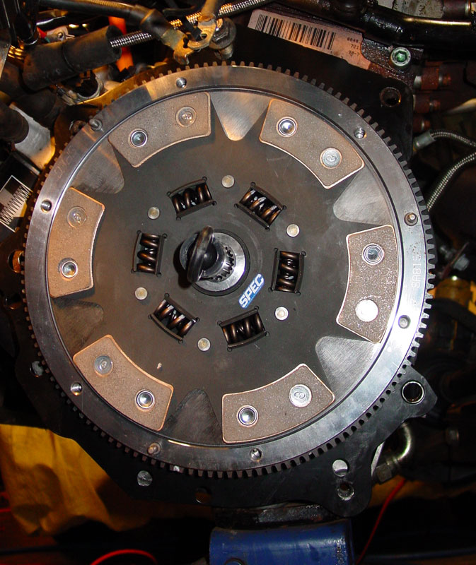

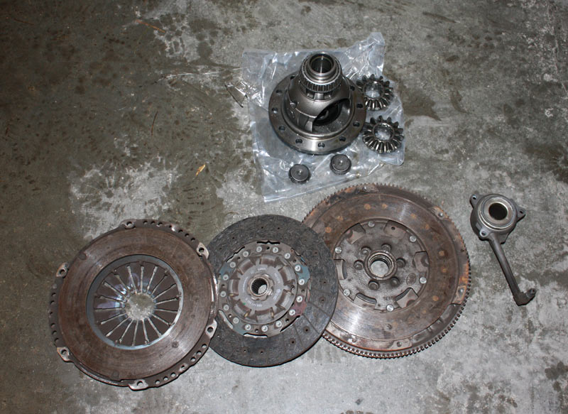

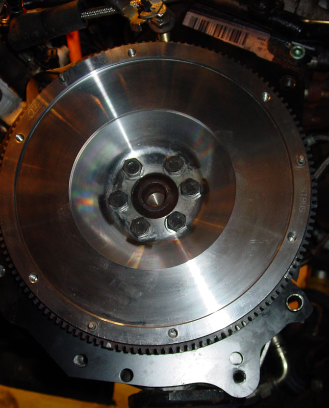

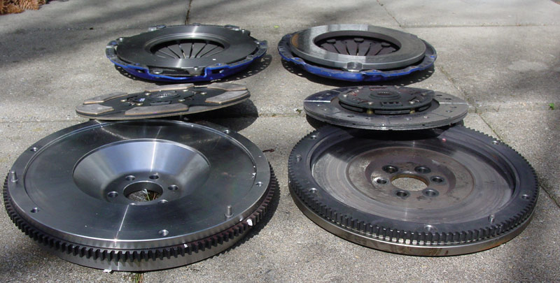

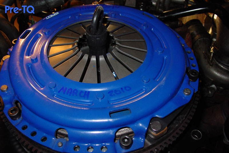

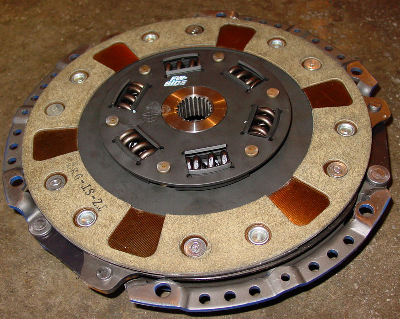

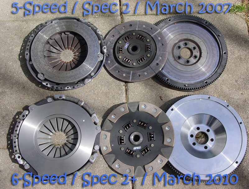

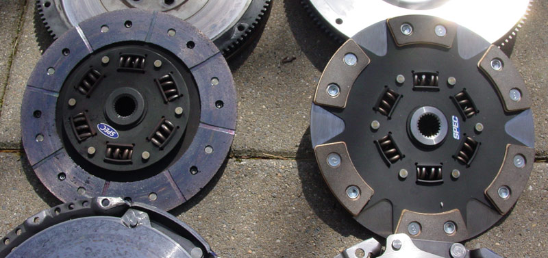

Thanks to John at FastAddiction.com, I now have my new flywheel, clutch, and pressure plate (I installed this on Saturday) and the transmission back with a nice toy installed inside.  I also purchased a set of Driveshaft axles (good for 400 HP).  The MK4 axles are soooo much easier than an MK1.
Clutch installed..... (bolts not tightened yet)

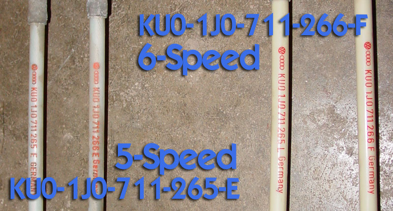

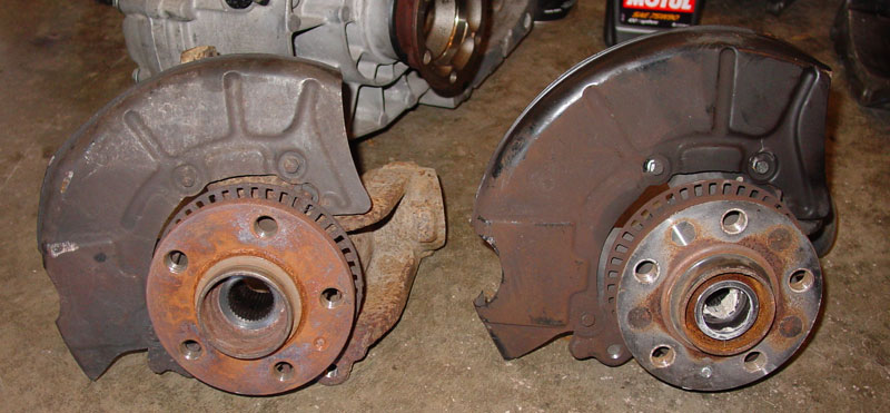

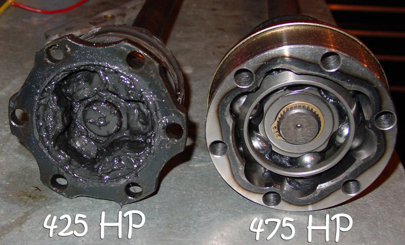

The stock axle vs. the driveshaft axles.

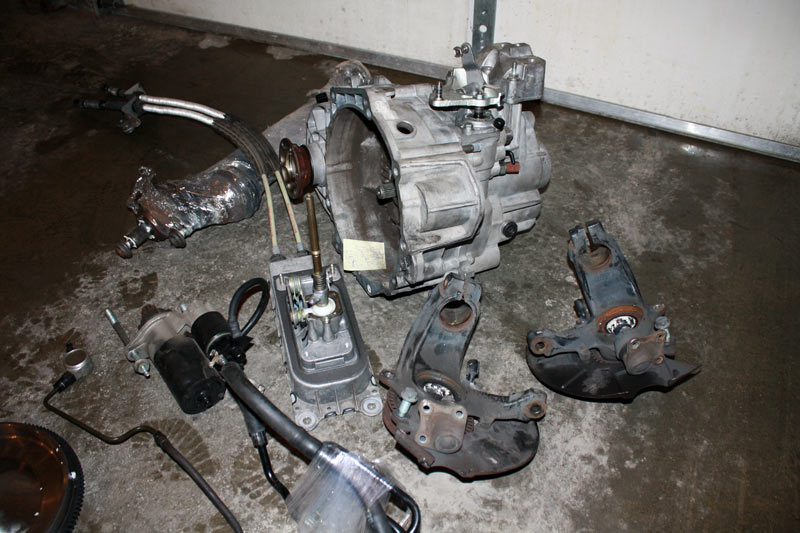

Some progress... all the big parts have been removed from the car so it is now time to put it all back together.  The oil feed line to the turbo was the biggest PITA as it was impossible to get to.

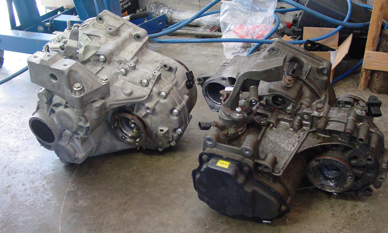

Anyway, some stock vs. go-fast parts side by side.
The pile of 1.8T parts I took out yesterday.... my green Rabbit suspension makes for a nice frame.
I think it is very impressive the HUGE difference between the stock exhaust manifold and the ATP setup.  Stock is tiny.

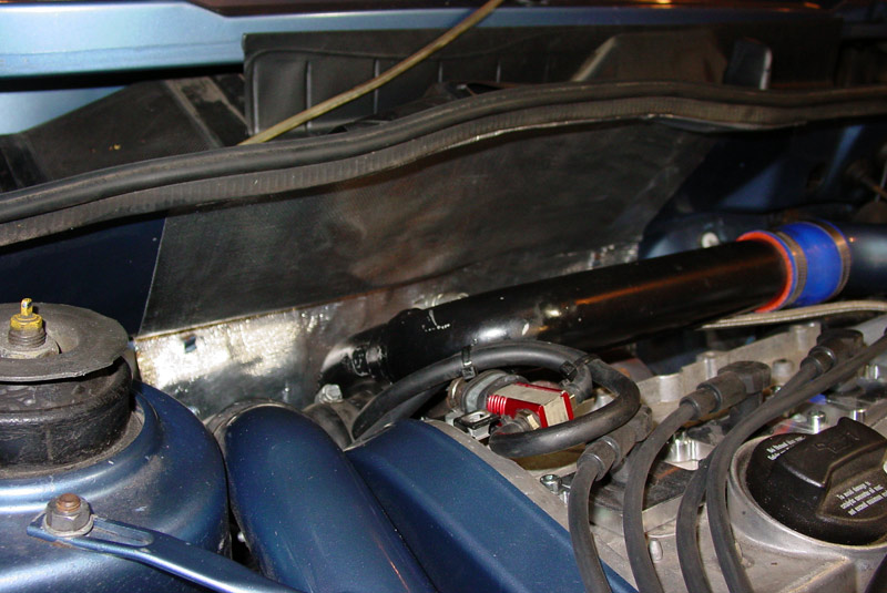

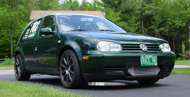

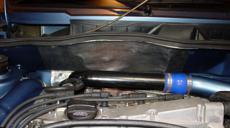

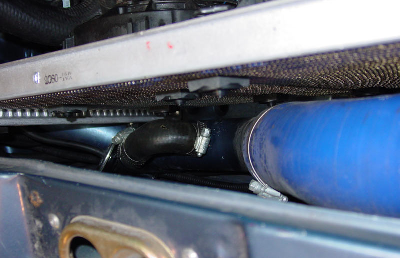

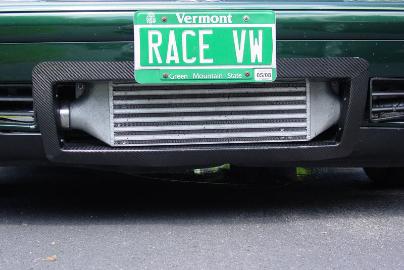

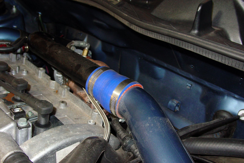

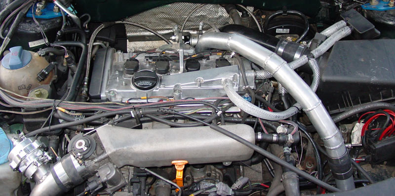

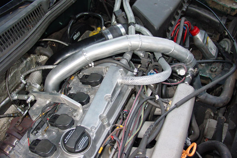

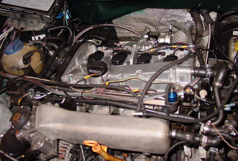

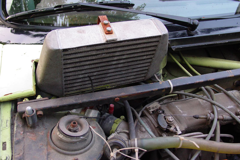

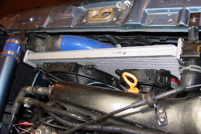

The FMIC has been installed and most of the plumbing is done.  I did not connect the tubing to the intake yet as I need to change the throttle body from DBW to DBC.  I have not installed the front bumper cover yet (will require some shaving).  The installation was a bit of a pain.... I had to cut the lip of the bumper bar so that IC would sit flush against the bottom of the bumper.  Per ATP's instructions, I had to cut the lower radiator support, but after I finished and reviewed the work, I have no idea why I had to cut it.  The IC doesn't hang anywhere near the radiator support.  Looking again at ATP's instructions, it looks like the IC in the directions is different than what I actually had to install.  There was some wasted time.  I cut part of the battery box base (I do not have the battery box anymore since it was a causality of the rollover) to make room for the pipes.  I also had a little problem clearing the headlight (throttle body side), so I cheated by removing the back cover of the headlight for clearance.
IC mounted to the bumper/rebar:
I had to drill a hole all the way through the second layer just so I could see.  Then I worked an open-end wrench with the nut duct taped to it over to the correct position.  The photo is at a sharp angle so you can see the nut.
Mount on the car with the tubing.  I had to put the tow hitch at an angle (I want to leave it mounted on the car)

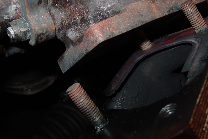

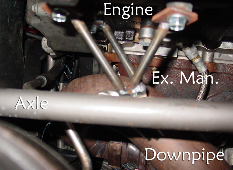

The removal of the old turbo was very difficult with the oil/coolant lines and miscellaneous bolts/nuts.  Installation of the new oil/coolant lines looks like it will be much easier since I can see all the connections because the turbo doesn't hang below the exhaust manifold.
Installation of the ATP manifold was a royal PITA since it was impossible to see the nuts and even move impossible to (a) get an open-ended wrench on the nuts and (b) to be able to swing the wrench to tighten the nut.  Well, I don't think Sears will take back my 12mm combo wrench after I shaved it down to make it thinner both in depth of the wrench and the thickness of the round part.  I also bent the wrench to allow for the swing.  It actually worked quite well.  I wish I had thought of it before (as does my friend Nick) since Nick tighten (mostly) the hard to get nuts with the open-end wrench over the course of an hour.  I just had to tighten them with the modified wrench.
Hard to see/work with nuts:
The fabrication:
I hung the turbo last night.  Good thing I didn't start tighten the top nuts because one of the bottom nuts required the turbo to be at the end of the stud to be able to fit the nut between the turbo housing and the top of the stud.  I was able to tighten all but one of the nuts since I needed a 12mm combo wrench.  Hmmmm, somehow my 12mm got bent and didn't work here.
Turbo partially installed:
The nut that had to be installed first (lightened area) and the nut next to it (left side of image) that I couldn't tighten without a straight 12mm wrench):
The turbo from the bottom:
Hopefully tonight I will be able to install the oil and coolant lines and complete the intercooler pipes.  That leaves Wednesday night to install the FPR, injectors, and BOV.  If there is time, I get the exhaust completed.

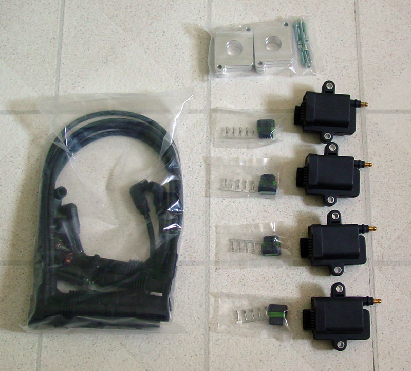

The engine management should be in the mail to me today.  Hopefully I will be able to get that on by Monday (busy this weekend drinking that 1/2 barrel of Switchback).

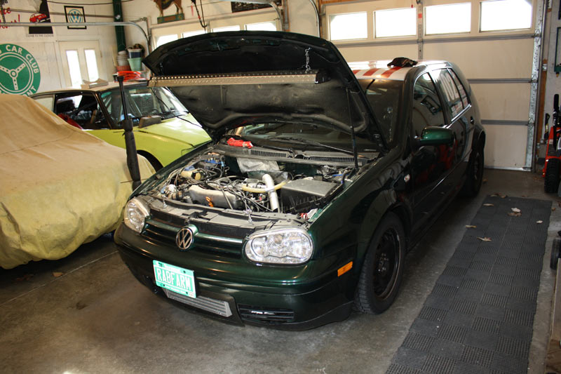

The saga continues.

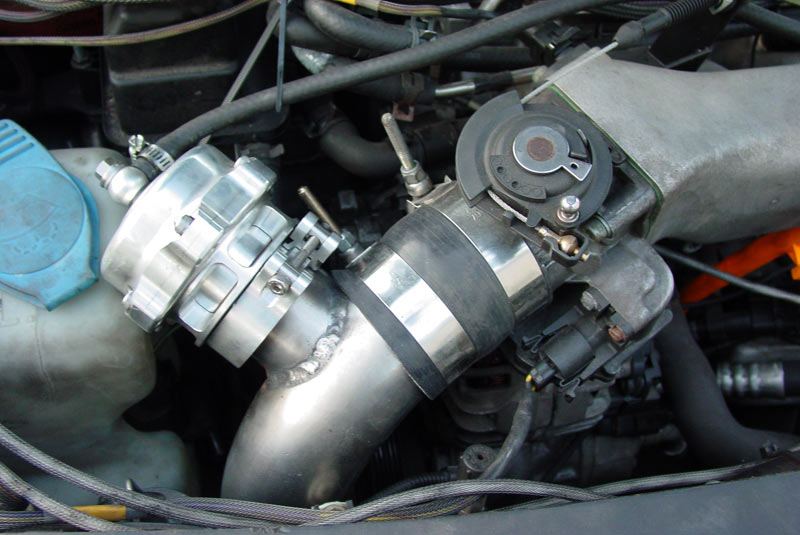

Big BOV... no idea where/how to install it.
The hairdryer installed...

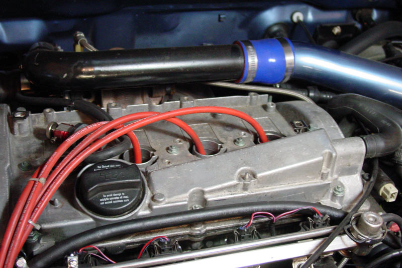

Engine... not all hoses connected yet.

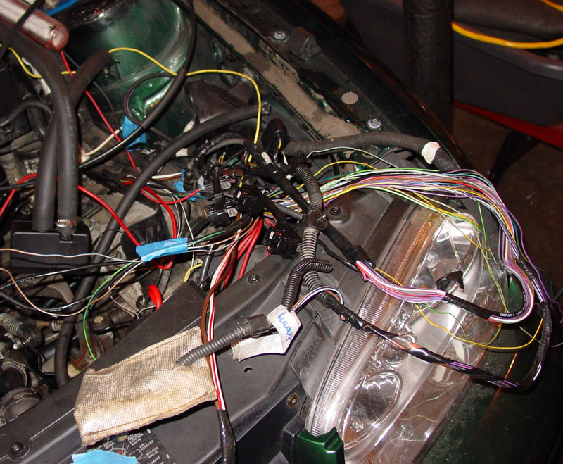

Now I'm above my head....
How the car has been sitting for 5 weeks....
Package arrived today with some wires in it...

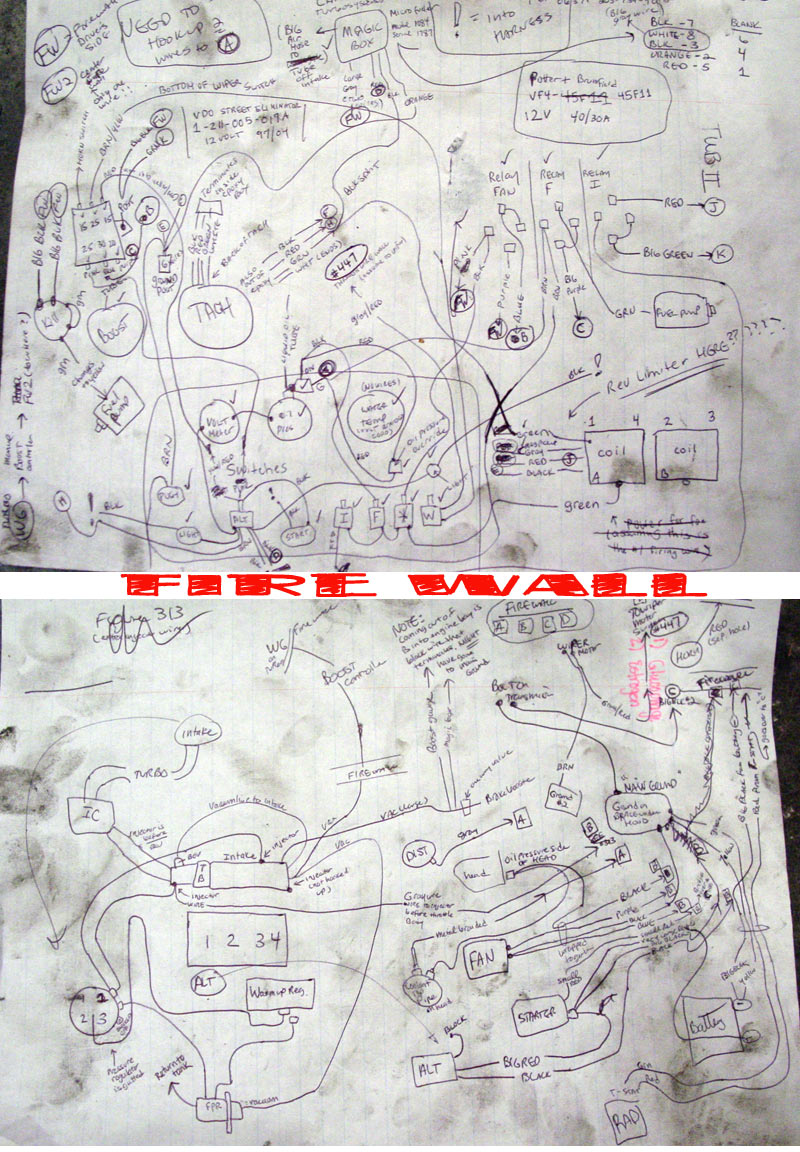

Starting to sort out/layout the harness.  I plugged in what I could figure out so that I could determine the flow of the harness, and therefore, how/where to mount everything.  A bit of a brick wall here so I have some deep thinking to do.

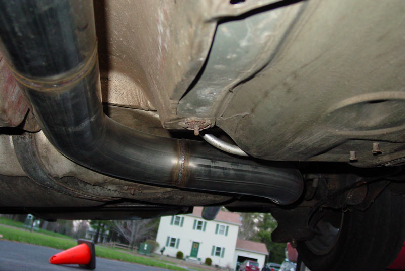

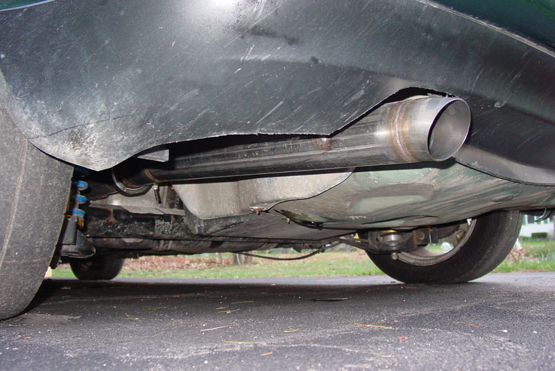

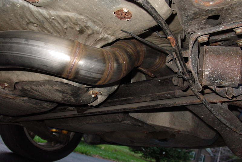

Letting the turbo breath with full 3"" exhaust.  Chris Achilles is doing the side exit for me.
Split race muffler... the muffler is 5"" round and only 6"" long.
Bigger is better... :)

Cyrus, Chris Marotti, and Chris Achilles came over later with the Achilles custom exhaust.

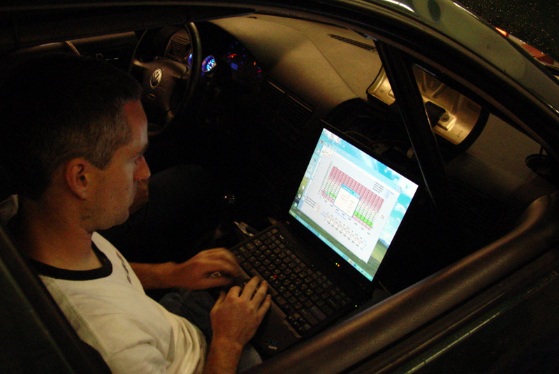

We still need to mount the ECU inside the car (it is in the rain tray at the moment), but this means I need to remove the wires on the left side of the car (driver's side for me) and relocate them along the right side of the car.

Brady at Quintin's (dyno shop) e-mailed me today to tell me how to use the program to view the results.  I didn't realize that that graph x and y titles were clickable menus.  I'm unsure which program I ended up with (both displayed), but it is a very conservative number (18 psi) to where we are going (28 psi +/-).
Fun for now and the engine should hold together just fine.

New engine with everything bolted on, Spec clutch, flywheel, transmission installed, etc.
How many 20-valves can you spot in 4 seconds?  ...go!
I removed the DP and both axles and was able to (quite easily) bring the completely assembled engine up through the bottom.  I had thought the turbo being bolted to the engine would prove to be too big for the engine bay opening.  Good news!

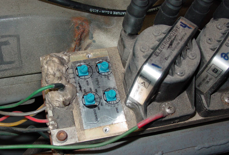

Every wonder why VW's have some electrical issues?  This is what the wire looks like that went to the secondary air pump and power steering pump.  The power steering pump wires were also broken off.  Of course, the damage could have occurred when I removed the engine, but honestly I have no idea how that could have happened.
I don't think that I need ANY of this.  I already removed the secondary air pump from in front of the oil pan.  Since I wasn't sure what I needed/didn't need and didn't have time to experiment, all the parts went back in.

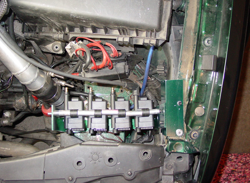

Location of 034 ECU and relay board.  I took the time to remove all 034 EFI wires that ran along the driver's side (left side of car for those of you with the steering wheel on the incorrect side) and ran everything on the passenger side of the car.  I took the ECU out of the rain tray, cut a hole through the fire wall with an air nibbler (love that tool!) and put the ECU where the passenger airbag was.  In the future, I'll have to get it mounted better, but it will get me by for this season.  No pictures of the changes yet, as I need some sleep.

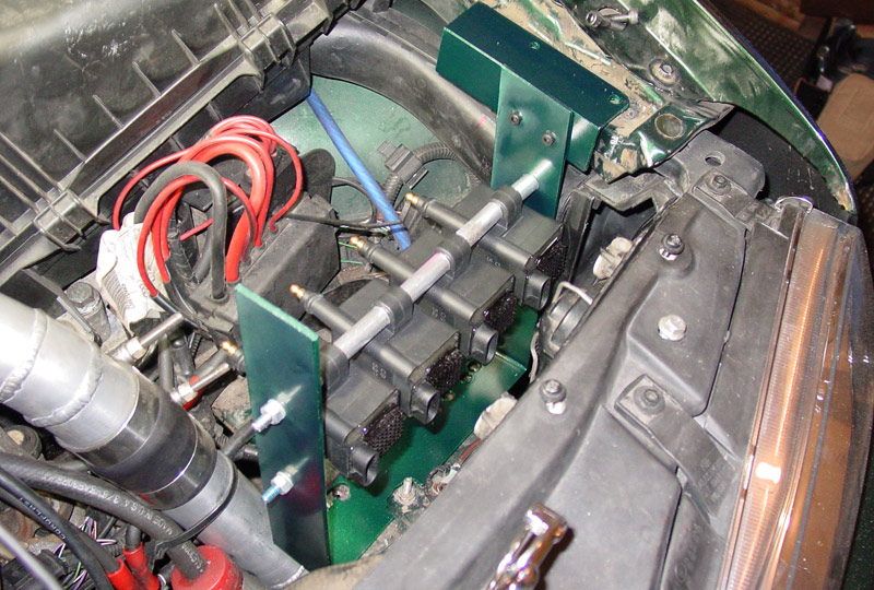

Perhaps getting rid of the coilpacks and going wired

Picture of disassembling "new" engine... and taking stock wiring harness out of the car so just the 034EFI will be there plus the 6 or so stock wires needed for sensors, etc.  I will be working very fast on this in the next couple of weeks as I have a track event on July 14, 2008 that the Golf would be better than the Rabbit (5 hours of driving at the event).

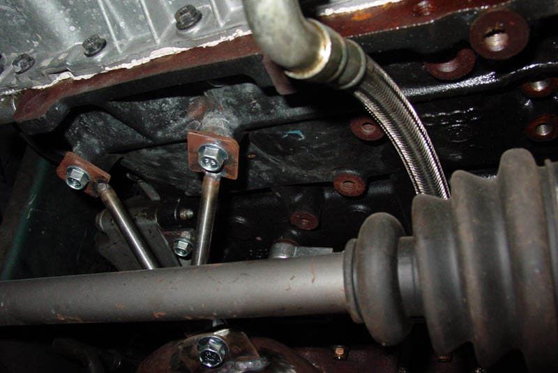

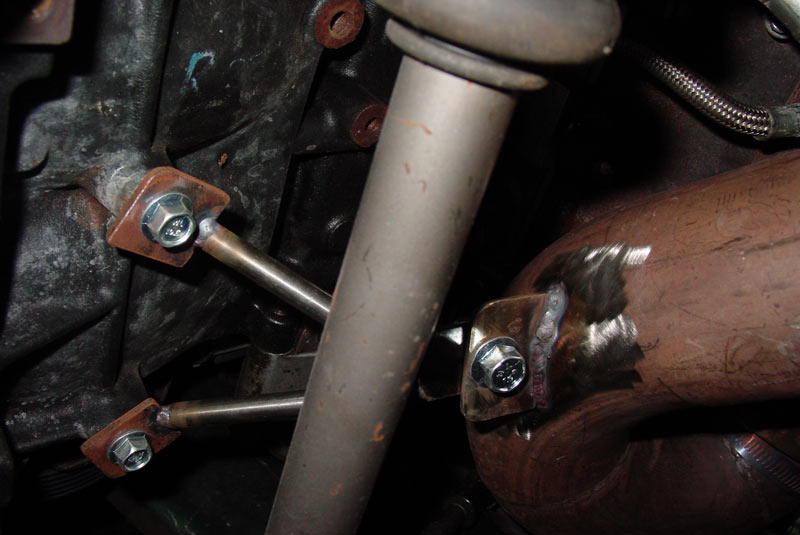

Those hard to get to nuts on the exhaust manifold.

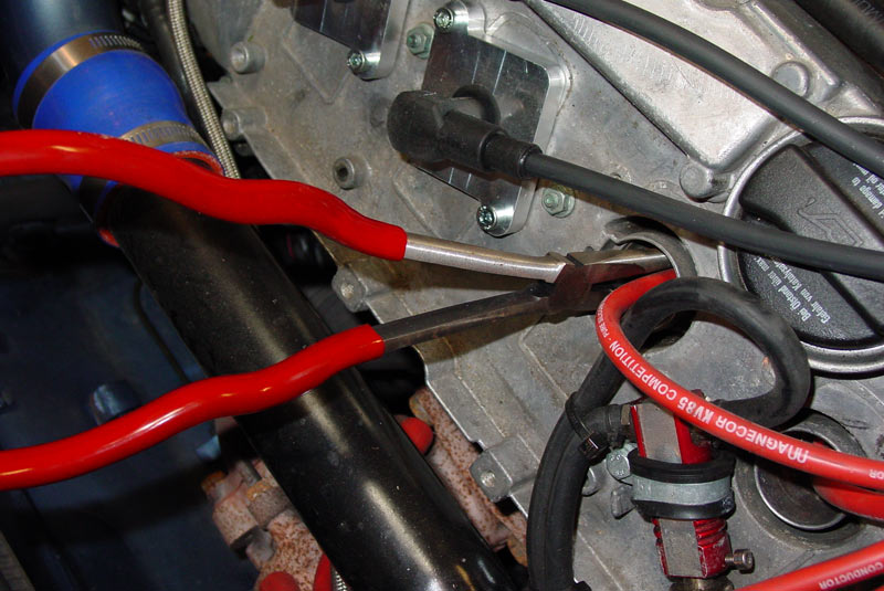

I bought a 10mm flex wrench years ago to be able to get those nuts in between the oil pan and transmission on my Rabbit.  Well, it is the same tool that is needed for the Golf, but thankfully, only two bolts need this tool on the Golf.
Close up of the end....
In between oil pan and transmission....
Close up of the bolt....
5mm x 50mm bolt with head cut off + standard thread connector + 5mm x 50mm bolt cut to 10mm + (nut+washer+washer)  + brad (nail) = "tool" to compress the timing belt tensioner.
I had a hard time getting my hands into the tight spot so Julie gave it a go....

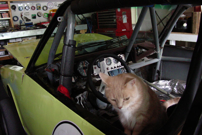

Woke up early this morning to take care of a couple of small items before heading off to work and to take some pictures.  Text can only be so exciting.  :|

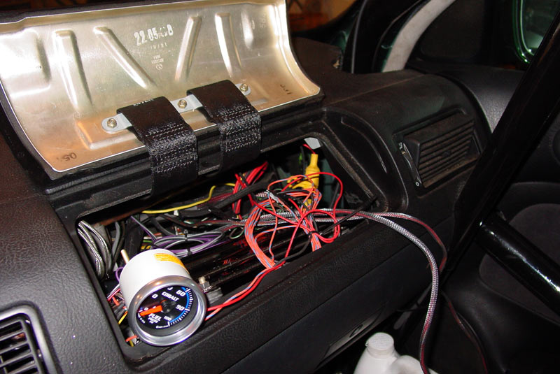

The two primary gauges in front of me are for EGT and the Air Fuel mixture (wideband).  The A/F has a narrowband output that Joe will hook up to the ECU for another input so the ECU knows what is going on.

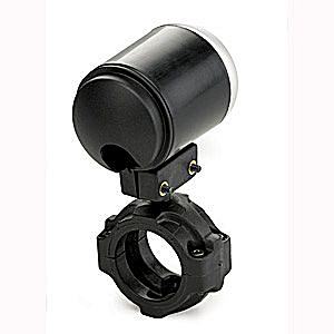

The next set of gauges that will be to my left (mounted on the roll cage with a mount that I found at Jegs) will be boost (naturally) and fuel pressure.  I figure these are all my gauges that need immediate attention as they change quickly.  Picture of the ECU where the airbag was located.  Nice place that I can button up.
The mount that I ordered (two of them) for the "A 1/2 pillar" (I have a roll cage bar that is located behind the A-pillar that goes to the floor and to the very top of the A-pillar as a straight shot to meet FIA specs).

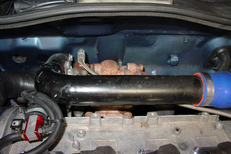

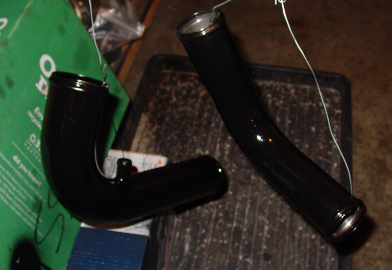

Tubes are dry and ready for installation tonight.  They came out okay.

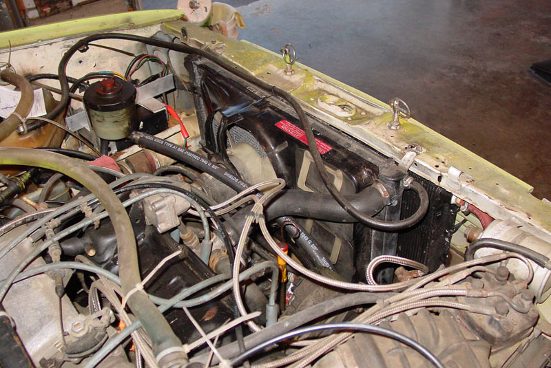

Cleaner engine bay with all the 034EFI wires running down the center.  The engine is a lot cleaner once all that emissions crap is removed.  Once I am happy with the location of the wiring, I might run it through a common wire loom to clean that up.
The wires that we need to remove (there will only be about 10 stock ECU wires under the hood... the rest have to go).  The stock wires that I will retain are for inputs into the stock gauge cluster for tach, temp, etc.
The toys that Joe (Axis) dropped off.  A plethora of t-bolt clamps (where were you all my life!!!), new studs, and the battery that I am borrowing to see how to mount it in the Rabbit which I would also use for the Golf.  If I can make it work, I will pick one of these up from Joe (or bite the bullet and just get two).

Wonder why MK4s have electrical issues?  I have been finding a lot of problem wires in the harness as we unwrap and remove it.

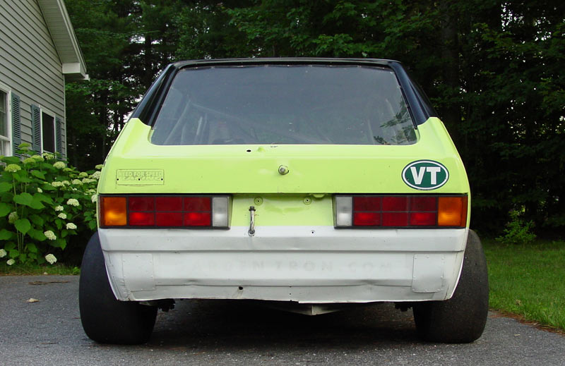

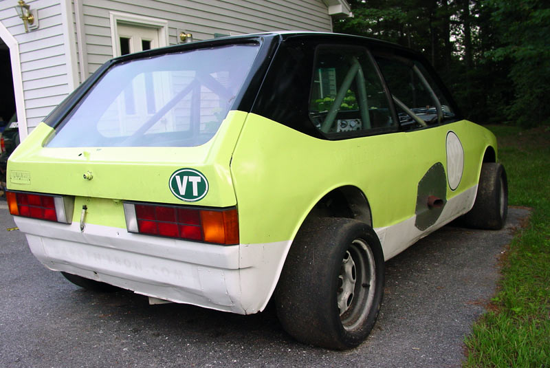

And the turbo Rabbit.  I plan on making it look a little more pretty, but in the nutshell, it is a fast and go-kart like handling car.

If you like Rabbits... here is the Rabbit I just sold (same builder as the turbo Rabbit above): http://forums.vwvortex.com/zerothread?id=3739880
I sold the linked Rabbit to purchase the turbo Rabbit (can't own them all).

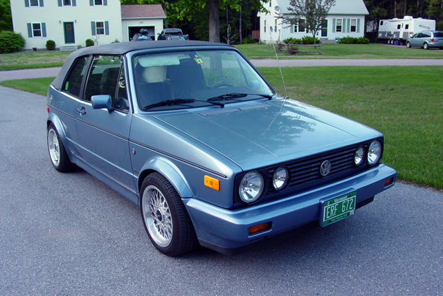

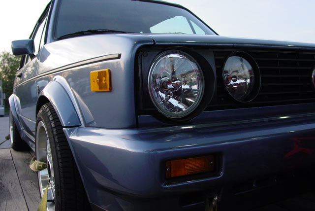

And below, my wife's 89 Cabriolet 1.8t (original paint) that I need to change the clutch from mechanical to hydro and change the wiring harness from MegaSquirt to stock wiring with chipped ECU (friend will help with the wiring).  I want it to drive like her 04 Jetta 1.8t (easy to drive).  Right now the Cabriolet is 177 wheel HP and 190 wheel TQ.  She goes like stink. You can see her 04 Jetta in there too. (100% stock except for Bilstein sport shocks/struts as the stock equipment completely failed within 3 years).  I have had the Golf 1.8t and the Jetta 1.8t at the local tracks (i.e. Watkins Glen).  Both are fun.

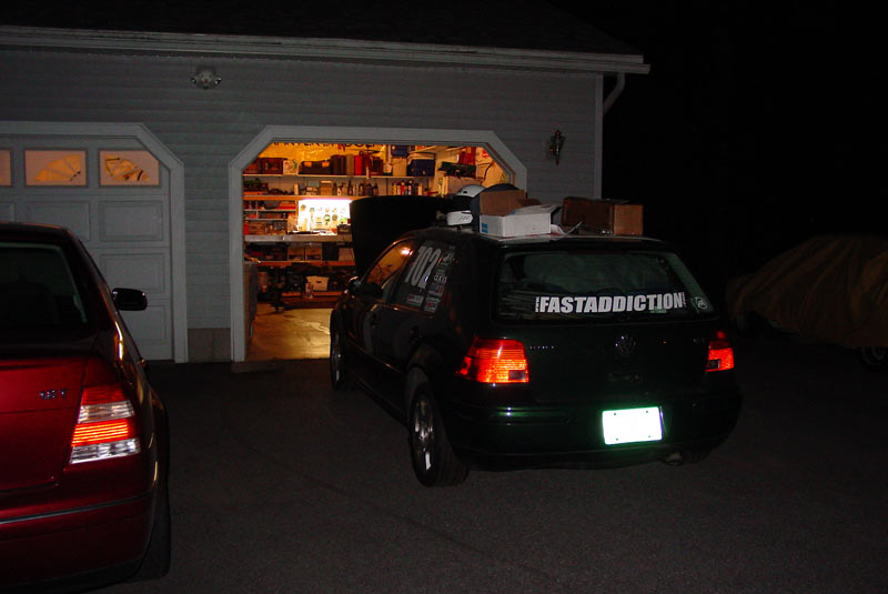

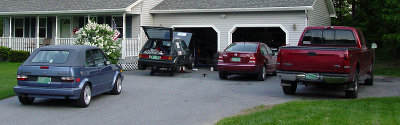

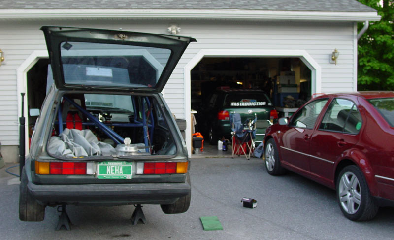

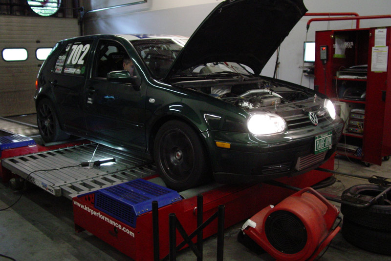

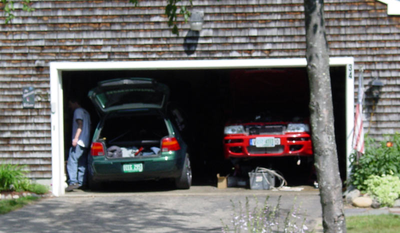

I'm having my driveway sealed so we had to work on the car outside for the last two nights.  It was hot, humid, a buggy as the sun went down.  The car is all together and running okay on a tune that was downloaded from 034 (for the 1.8t, but for unknown turbo, etc.... just enough so it runs).  I still have to properly mount some of the gauges (fuel pressure and boost) with the new mounts, but didn't have time before the dyno.

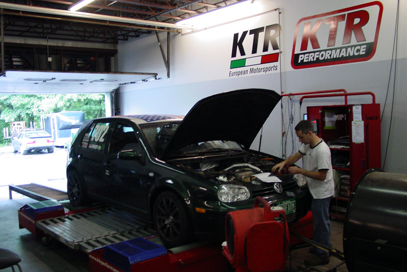

Dropped off the car at Quinitin's last night at 12:15AM for a dyno appointment on Wednesday....

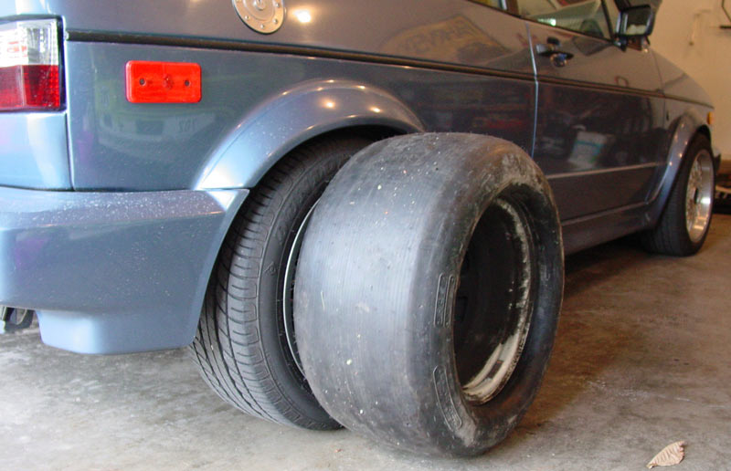

Trying different rim color on the Golf. I have two sets of RA1's mounted on Flix wheels (they are a bit heavy, but in my price range at the time); one set is silver and other gun metal.

Car is all tuned and is running great at 23 PSI.  I did manage to break off a stud that mounts the turbo to the exhaust manifold so I am looking for a new manifold (I hate the ATP so this is a good time to change it).  I also need to look into better bracing for the turbo.

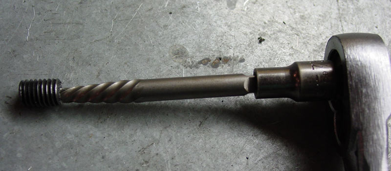

Time to inspect the exhaust manifold to determine if I can remove the stud from the ATP manifold without removing it from the engine or replacing it with a SPA manifold if I had to remove the ATP setup.  There was no way in heck I would reinstall the ATP manifold if I had to remove it.
I had to remove the coolant line to remove the turbo (it is hanging from the Shine Racing anti-roll bar that I removed at NHIS last week when it was raining to reduce oversteer).  Clean break of the stud.

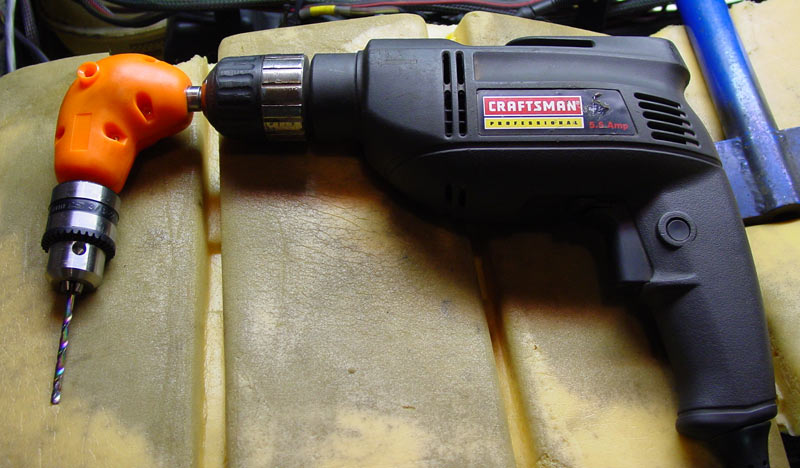

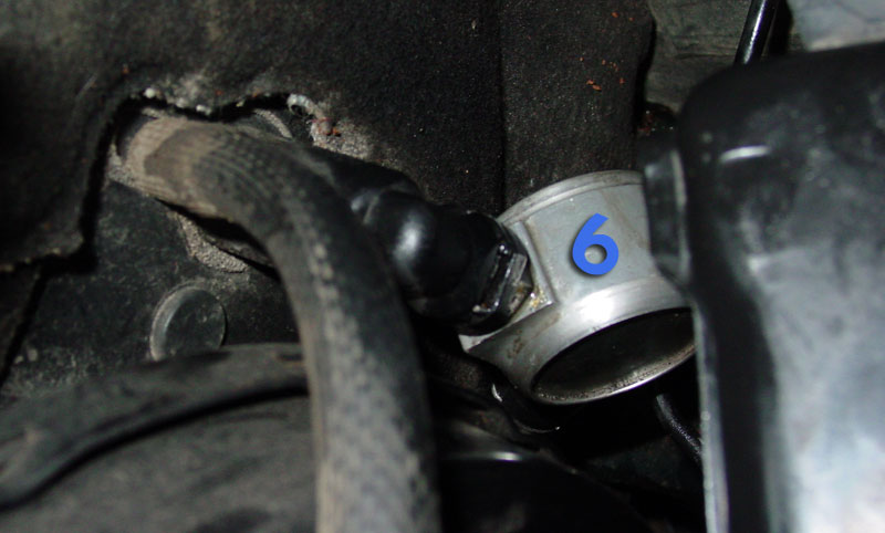

I borrowed a 90-degree angle head from my father so that I could get into the tight space between the engine and firewall.
Drilled a hole in the center of the stud.  I used a flute bolt extractor.
Hmmmm, this looks like good news.
I was able to remove the broken stud from the exhaust manifold, therefore, thus and hence, I will not be changing from the ATP to SPA exhaust manifolds at this time.

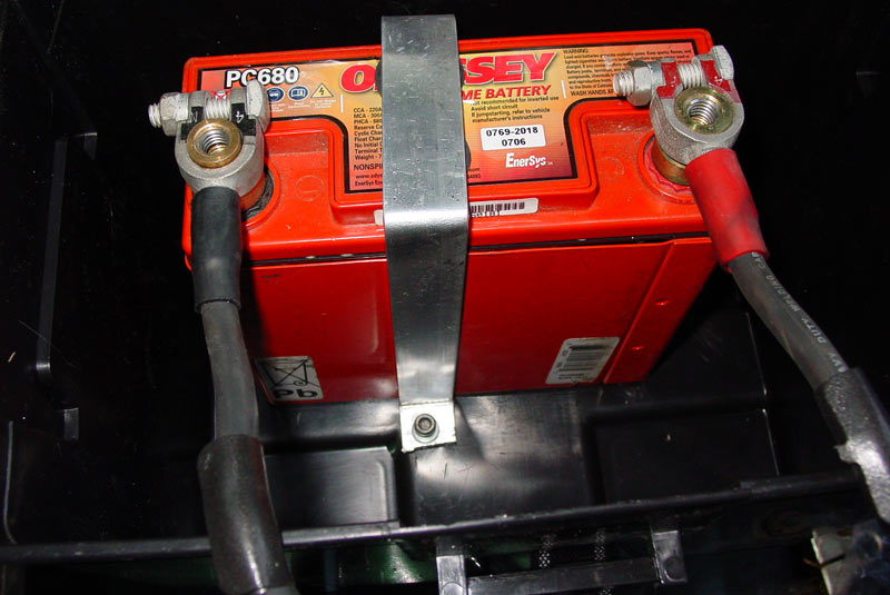

Last night I installed everything using 4G wire.  It seems that I should have used a thicker wire, so over the winter I will either add another 4G wire to the setup or use one larger wire for the whole setup.
My goal was to have the switch on the inside of the car so that it didn't rust should it rain. I came up with the idea of where it is mounted and it seems to work great.  I can roll down the window just enough to have access to the switch while my race number is still full visible.  Best of both worlds.

I managed to "break" and axle during a practice run on Saturday.  The axle is a DriveShaftShop 425 HP axle so it wasn't power that did it in.  I recently ordered a set of 475 HP axles from them and noticed a HUGE difference in the design... looks like a set of old Rabbit inner CVs, but a heck of a lot larger.  Anyway, the 425 HP driver's side axle "broke" because a C clip that prevents the shaft from sliding towards the transmission, and therefore the tripod was allowed to slide inward to disengage itself from the cage... um, run on sentence... the C clip came off so the tripod wasn't contained.  Easy fix... replace the clip and get a new inner boot.

For those of you hooked on phonics challenged, I present some images for your enjoyment (with limited text interruptions).
The bumper was removed from in front of the IC to allow better airflow.  I picked up a  trim piece to go around the IC from Chris Havas at http://www.MetalMarks.com (place for rally folks to get carbon fiber parts; located in Vermont, but can ship).  I will install this soon when time allows.

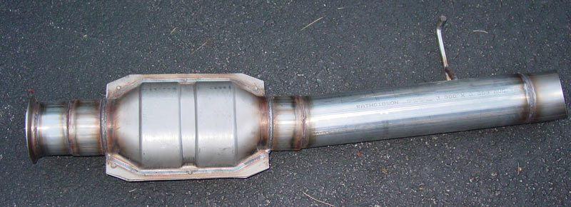

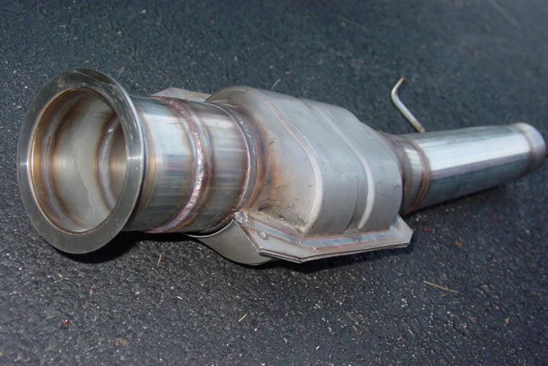

Okay, we have some options at the end of the exhaust.   That is a V-Band clamp on there that allows for the straight pipe (there already is a muffler in the middle of the car) or a cat.
Joey wired the battery in the rear of the car (or his buddy James who seems to be an electrical guru of sorts... and works on Subbies).  I installed the battery box and made the bracket.  It actually works pretty well.
So, someone else made it onto the rear window of the car.  I reserve this place for people/companies that make racing this car possible through their expertise, help, and skills.  (with the exception of the SCDA1.com and vwvortex.com stickers... I'm sure they will get bumped soon)  Added... KalesCustom.com (the .com didn't fit).  Thanks Joey!

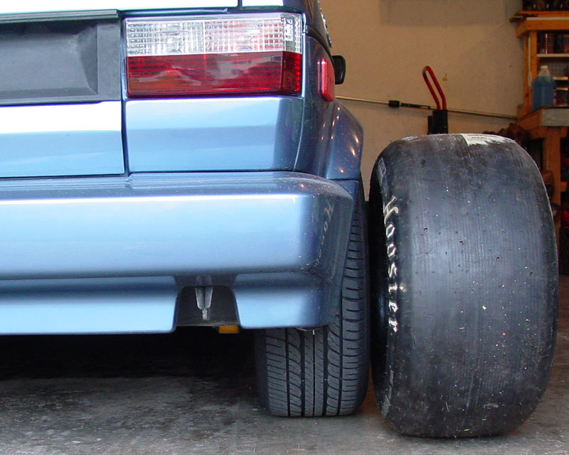

Big new 22.5 tires... they look HUGE compared to the worn 20".  There goes my mechanical advantage for acceleration, but at least I will be able to get a lot more speed in the straights (I was limited by gearing at Okemo as I was top speed in 5th within the first 1/3 of the long straight).
Looks huge!!!!
They are actually shorter than the tires on Julie's Cabriolet.
... though a little bit wider.

Back to the Golf... I haven't dyno tuned it yet as I have been waiting on some other toys to help with the reliability of the car.  I had two issues last summer... the intercooler piping would pop apart with 23 psi (corrected, thanks to http://www.KalesCustom.com) and the on-plug coilpacks would fail due to the heat.  Enter the following:
(a) High Output DIS Coil with Built-in Driver
(b) 16v Spark Plug Wires for DIS Coils - Black
(c) 1.8t Plug Wire Adapter (covers the sparkplug well to keep dirt out)
Now I will have individual coils that will be mounted inside the engine bay, but far from the turbo (heat), standard plug wires, and covers to keep the dirt out.  This means that I will not have coils failing all the time while on the track.

Installed trim piece around intercooler opening to clean up the edge.  I messed it up a little so I will have to install over the winter when I have more time (it isn't quite flush around the entire opening).

Shell is gone and parts are in storage for the winter project period.

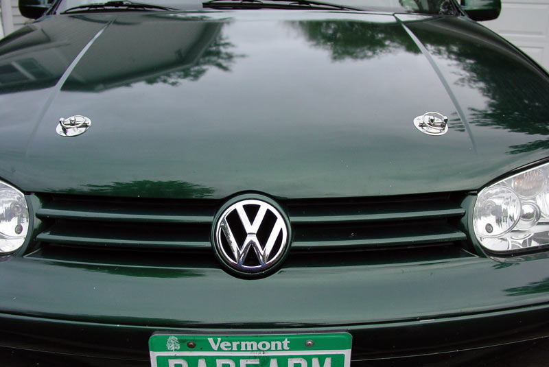

Ralph's Foreign Auto installed new suspension bushings and James installed the hood pins (I figured I would walk the drill across the hood if I tried it.... plus I didn't realize that under the plastic was metal so I was thinking there would be a mounting issue on the body of the car... guess not).

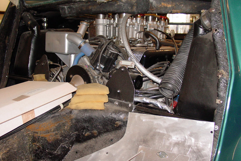

Well, it was time to finally get the 1989 Cabriolet back on the road.  About 6 weeks ago (or so) I was driving it home when steam started to come out from under the hood.  I didn't have time to work on it so it stayed under cover in the driveway until about a week ago.  I was finally able to determine that the radiator was leaking.   Inspection of the radiator showed that the location/orientation of the diverter valve was against the front of the radiator; a new radiator was ordered.  I then had to source out new zip mounting hardware to reinstall the fans on the new radiator... enter Jegs (again!!).  Working on the car I heard a noise coming from in back of the car.  I looked around and found nothing.  Must have been outside and my tired mind/body was playing tricks on me.
[b]Intermission[/b]: Somehow Julie (I'll blame her since I have never used it) broke the lighted rocker switch that makes up the switch to turn on the reverse lights.  I tried to locate a switch of the same size without any luck.  When I was looking for the zip mounting hardware for the fans, I started with the make of the fans (good thinking, Sparky).  Guess what... that lighted fan switch actually came with the electric fans that are on the car.  I found an exact match and ordered it from Jegs.  Hmmm, there's that noise again in the back of the car.  Nothing in the trunk.  Nothing underneath it.  It seemed to stopped whenever I walked to the back of the car.  Strange.
[b]Back to the program already in progress[/b]: Fan installed and diverter location changed.
Source of noise identified.

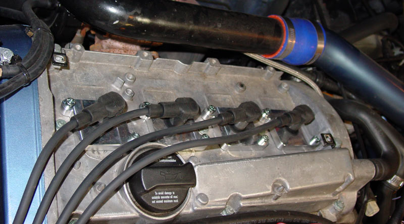

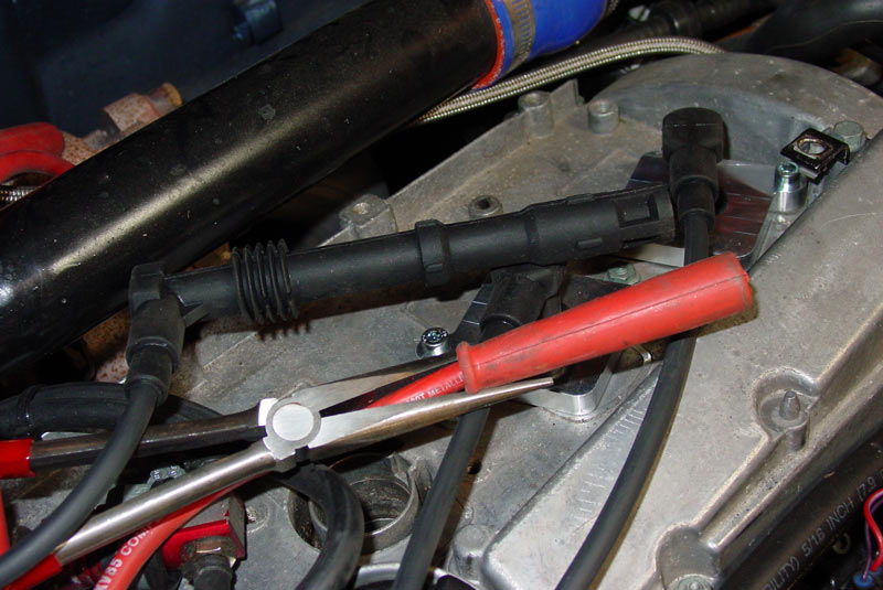

While I was under the hood, I decided to identify the sparkplug wires that I hated.  The boots were standard cut (e.g. not made for deep well sparkplug access wells).  I ended up taking the wire set and covers that were intended for the 1.8T Golf and used them on the Cabriolet.
After installing the first two and thinking that they looked strange, I figured out that they should have been oriented parallel with the valve cover.  (no kidding, huh?)  I also identified a wire that went to the coil that was too short; sometimes when the engine rocks it would die.  The wire (big ol' red power wire going to the coil) was extended.
I still have a number of items to address on the Cabriolet to make it an easier and more fun car to drive.... looks like a late summer project at this time as work and the racing schedule is keeping me busy.

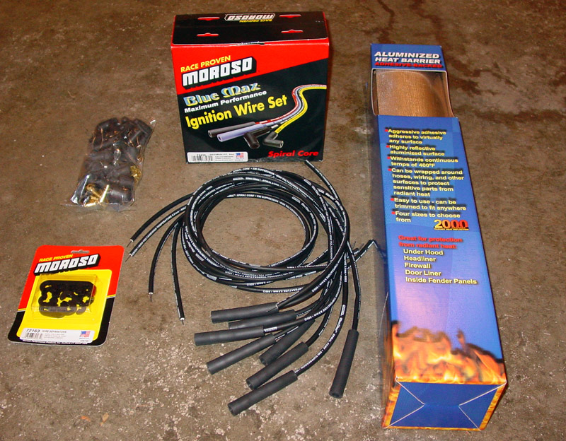

I ordered another set of spark plug wires (must be an Audi wire set as they come as a set of five) and spark plug well covers for the Golf... got them through Joe at http://www.Axismotorsport.com
Another present arrived in the mail....
Spark plug wire set for the turbo Rabbit (need to custom make the wires as the coils are mounted on the dash with four holes going through the firewall... one hole per wire... the size of the wire [with grommet]) and heat barrier with adhesive backing.
The heat barrier is for the Cabriolet to keep the heat from getting into the driver's compartment.
This would be a lot easier to do if the engine wasn't in the bay.  I had to measure out each firewall mounted clip location to map out where I had to cut the slots.  The bottom portion (bottom of rain train and down 10") took about an hour to complete.  The rain tray portion took about 10 minutes.  Very functional.
Sunday... jumping into doing the wires on the turbo Rabbit.  If that doesn't fix the problem, I might need a new tach (it has a built in rev limiter).  I also need to add some heat barrier protection to the Golf above the turbo and install the coils.

Turbo Rabbit is now back to 100%... it was old spark plug wires that did it in.  I replaced them with the kit from Jegs.  I also wrapped the wires (heat protection) where it is above the turbo.
Heat barrier installed on Golf.

It’s dyno time…..the saga begins
Let's start by throwing some numbers out there.... 245, 270, 272 and 300.
Friday was a trip down to http://www.ktrmotorsports.com in Ayer, Massachusetts for a dyno tune by Marc Swanson of EFI Express (a4kquattro on Motorgeek.com / phone 603.413.6833); Marc tuned the car using the dyno at KTR.  I got to KTR a little late because of a roll over on I-89 due to hydroplaning and driving around Ayer, MA trying to find KTR as they do not have a sign of any sort at the end of the "Truck Entrance" road that they are located.
First thing we did was get the next standalone coils hooked up and setup in the ECU.  Next was the baseline dyno to figure out where I was all this time.  At a dyno in my area, they determined that I had 272wHP (245, 270, [b]272[/b], 300) at 18psi.  Marc street tuned the car last summer to 23 psi of boost so I must have more than 300.... wouldn't you think?  First run was 245wHP ([b]245[/b], 270, 272, 300), but there was something wrong.
Actually two things wrong.
Next few runs left Marc a bit confused as the HP was not increasing with advances in timing (I'm running full race fuel; 109 octane unleaded).  Jim (KTR) noticed that the dyno only had readings up to 5000 RPM while we were bringing the car up to redline at 6700 RPM.  The car was spinning on the rollers.  Fixed.  Twice.
Next run didn't quite seem right either and that was when Marc noticed (per the computer hooked up to the ECU) that I was only running at 80% throttle.  It seems the cable was stretched a bit so I have been driving the car for quite some time at 80% (or so) throttle.  Man, all those hillclimbs that I wanted "just a little bit more" in the straights.... and it could have been there.  Darn!
Baseline wHP
Okay, we have a stuff together now and finally get the baseline power (remember, this is at 23 psi, so it has to be a lot more than the 272wHP/18psi power).... how about 270wHP?  Yep, different dyno yields different results.  Since last summer, the street tune gave me 270wHP.  Of course, I wasn't using all of that thanks to a stretched throttle cable.
More Power!
Time to get a little more power out of it, but more importantly, power where I need it for the hillclimbs (more low-end grunt).  Marc and Jim spent the next hour making adjustments to get the power where it should be.
Marc tuning from the co-pilot seat while Jim controlled the dyno from the driver's seat... while I stood around not knowing what to do with myself, but noticing an empty box of Harpoon and a running refrigerator in the corner.
So what did we end up with?  299.4, but let's round that up to 300 since it is OVER 299, a bit shy of 300, and I feel like rounding a .4 up this time. (245, 270, 272, [b]300[/b])  But, let's talk about that number.  It is not the limit of the turbo, engine, injectors, fueling, etc.  It is actually the limitation of the 034EFI MAP sensor inside the ECU; it is limited to 2.5 bar.  So, to get another 50wHP (per Marc), I would just need to send the box back to 034EFI to get the sensor upgraded.  I might as well get the 034EFI "hiccup" fixed while I'm at it (the engine is running just fine and stops for a second like I hit the rev limiter).  So, there is more that can be obtained, but I have to ask myself if it is worth it as 350wHP would be great on the track with FWD, but it might just communicate to wheel spin at the hillclimbs.

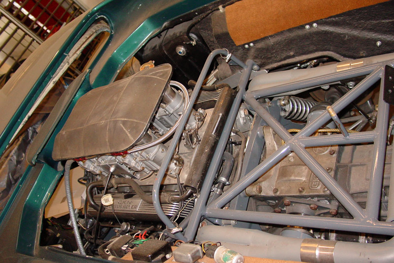

The search for reason for the poorly running turbo Rabbit (aka Tub II) continues.
I started by mapping out the engine wiring harness.  Three hours later I have everything under the dash mapped except those wires that continue through the firewall to laa-laa land.  Wednesday night I will continue to locate the end of those wires.  The reason for the mapping is that I'm trying to identify all the grounds to ensure they are connected properly.
I learned a couple of things.
First, there are three outlets on the fuel distributor... one is terminated.  The other two go to injectors... one mounted before the throttle body and one after.  The one before the throttle body has a electronic controller and a wire that goes somewhere.... 'somewhere' should be identified on Wednesday night.

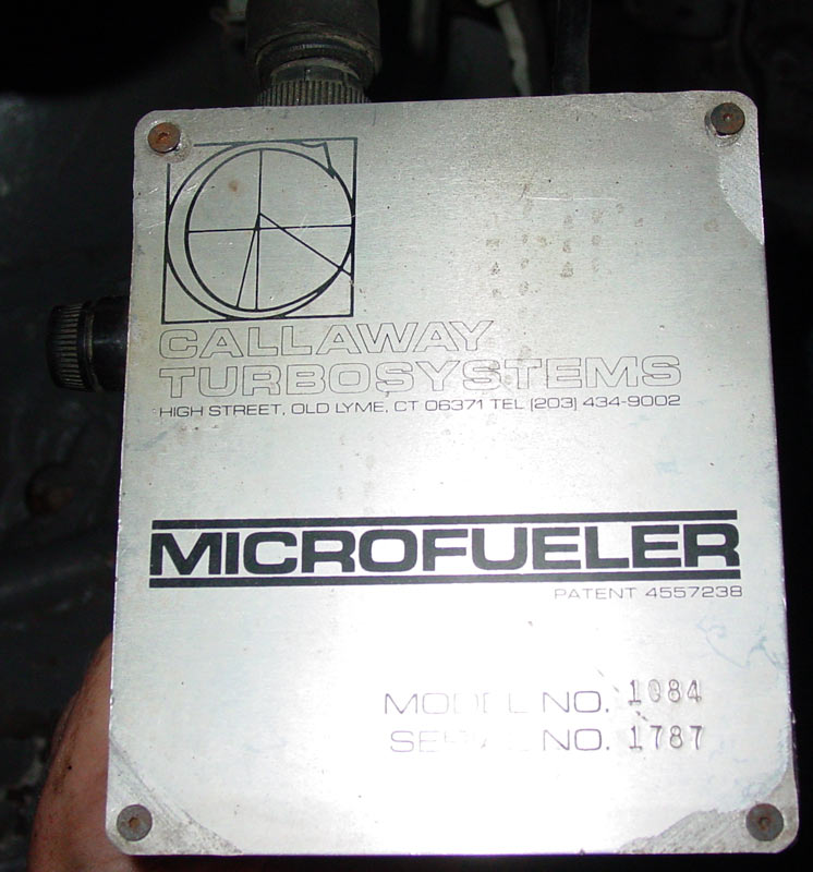

Second... the 'brain' is Callaway Turbo Systems, Inc. model number 1084 / serial number 1787.  This will hence forth be the 'Magic Box'.  There is a vacuum tube connected to the Magic Box that goes to a tube off of the intake manifold (I assume this is a MAP sensor).
So, let's talk about how the car isn't running properly.  If I give it gas the engine doesn't rev up as fast as it should (sluggish) and the tachometer doesn't seem to quite mirror what the engine is actually doing.  This might just be my perception.  I looked at all the wires associated with the tach, the fuse box (all 6 fuses), and the direct ignition coils.  Here is what I have.

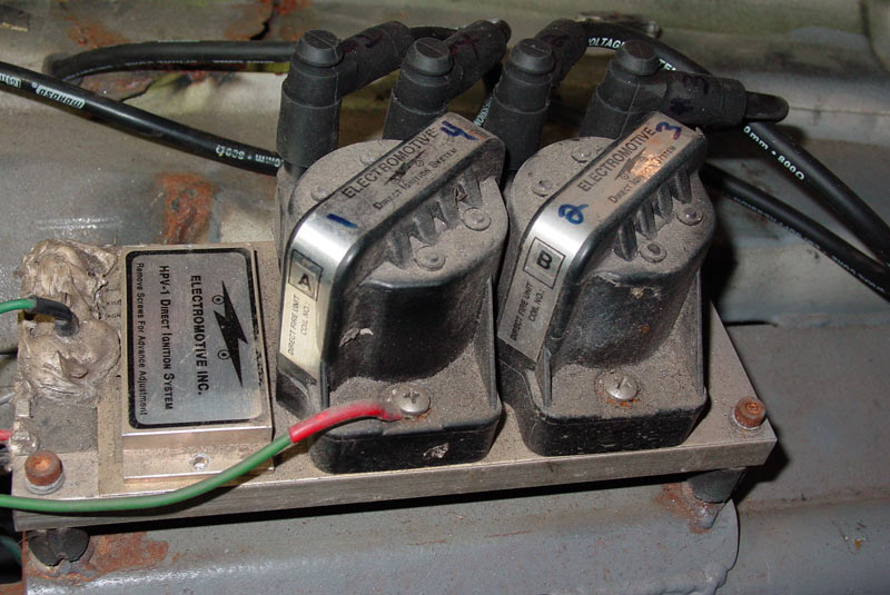

[b]COILS[/b]: There are two coils mounted to a plate.  Coming into the plate is Green (to Green tach), Gray (magnetic pickup on distributor), Red (Ignition relay [unsure of post number at the moment]), and Black (ground).  Another Green wire connects to a screw on Coil A (goes to 1 and 4 cylinders) that goes to the bottom post of the fan toggle switch on the dash.  The toggle switch is off when down; on the bottom of this toggle switch is another wire that goes to the bottom of the Fuel toggle switch then the Ignition toggle switch and then to the Ignition relay.
The ignition relay goes to Ignition toggle switch, coils, other two posts go to post on the fuse box (unsure if + or -).
[b]TACH[/b]: The tach has a Black, Red, Green and White wire coming out of one part of the back of the tach that then go into this epoxy section on the back of the tach.  From this epoxy section, the White comes out and ends, the Black goes to ground, Red to bottom post of the Alt toggle switch, and Green splits with one going to the Magic box (pin number 7) and one to coils.
[b]The switches....[/b]
Alt (alternator)... car will run with this off, but with no power.
Fuel turns on the fuel pump
Fan turns on the fan (duh!)
From the [b]Magic Box[/b], we have a gray wrapped wire that goes to someone in the engine bay (Wednesday night), Red (bottom post of Alt toggle switch), Black (Green wire on Tach) and Orange (ground).
There is a lot more going on, of course, with all the toggle switches, gauges, etc.  I actually found two questionable wires (one that goes from Alt switch to ground and one to the oil pressure override switch).  I'm unsure if the bottom of the Alt toggle switch to the ground would cause the issue that I am experiencing, but you never know.  It was actually the ONLY wire that I could find that was not properly soldered and shrink wrapped... it had duct tape.  It is actually a very nice wiring job under the dash.
So, the saga continues on Wednesday.  I want to map everything out for the grounds (as I mentioned) plus when I swapped this all over to another shell, I want to know how to connect all the Legos.
Oh, one the Magic Box is a little cover that has "Advance Adjustments".... unsure what all of the knobs do, but they don't seem to have the rev limiter setting on there (could be wrong, I'll look at my pictures later).  If it doesn't... where is it?  Another mystery to solve.
The tach is a VDO Street Eliminator # 1-211-005-019A (97/04).  I'll do some research soon to see what I am dealing with.  How do I test a tachometer to ensure that it is working properly?
One last note (wow, long boring text post... gimme some pictures!!!).... regarding the tach Green wire that goes to the coils and to the Magic Box... on the coil, the green wire goes into what looks like a pile of white silicone.  The wire is bench, but I'm unsure if it is broken or faulty in anyway.  What is the white silicone stuff and can I remove it to check the green wire connection (and what do I replace the white silicone goop with when done)?
Yawn... enough for tonight.

Tonight I finished mapping out the wires, vacuum lines, fuel lines, and air under the hood..... pretty much got everything to the firewall on both sides (under the hood and inside the car) now I just need to connect it all together.
Pictures of some of the parts to give you a clearer idea of what I am looking at...
Microfueler
The dash (switch panel flipped forward to access the harness)
Coils
Close up of adjustments at end of coils
What the...?????

Picked up 6-speed from Fast Addiction; everything looks great.
6-speed (now with LSD)
6-speed axles, hubs, starter, shift box/cables, power steering line, and hydraulic clutch line.
Add in the Spec 2+ clutch and lightened flywheel (interesting design)....
...means that the stock clutch, flywheel, and differiential for the 6-speed are for sale.
(I also have a stock 5-speed diff and 5th gear for sale)

5-speed transmission, flywheel, pressure plate, clutch, and axles have been removed.  Next stop for everything (minus the axles) is the Cabriolet.  (the plan anyway).
5-speed (Spec2) vs. 6-speed (Spec2+)
Big difference in the hardware between the Spec2 and Spec2+
5-speed and 6-speed side by side.  The 5-speed is a bit dirty thanks to a CV joint blowing apart at Philo.

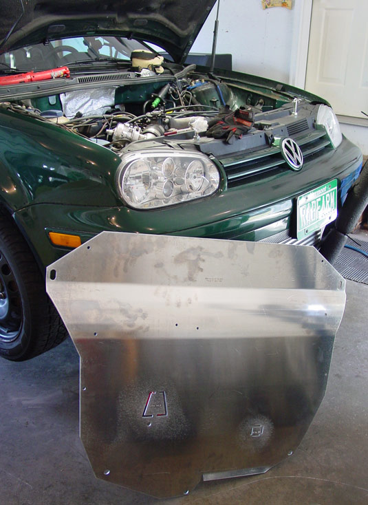

Dieselgeek Panzer Skid Plate will be protecting my investment.

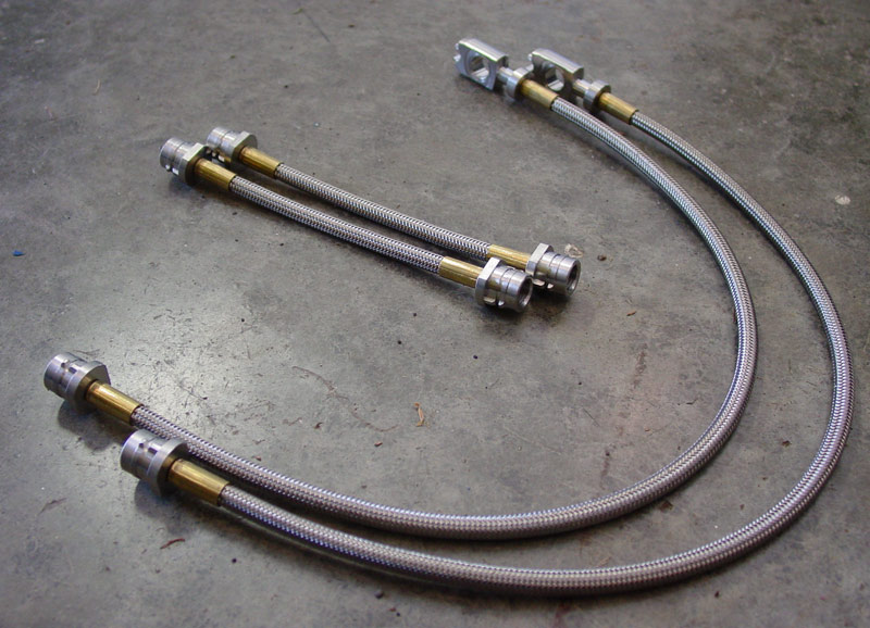

Stainless steel brake lines for front and year.

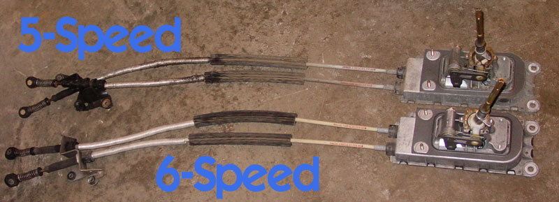

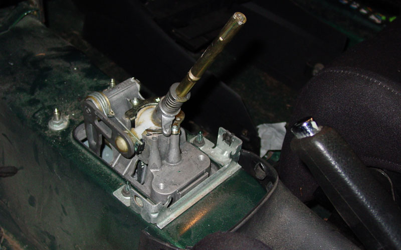

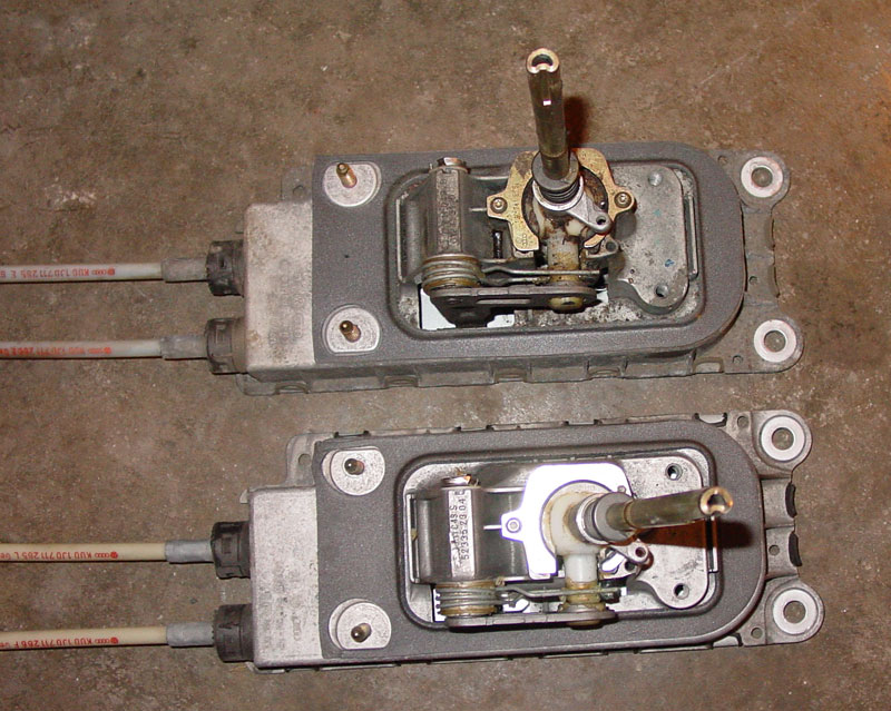

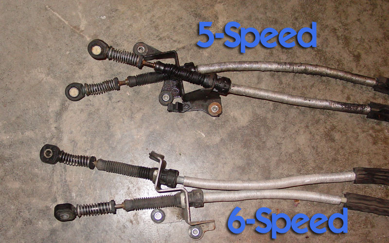

I removed the 5-speed shift box/cables; this required me to disconnect the exhaust and unbolt it from the floor so that I could hang it low enough to remove two aluminum heat shields.
Note the differences between the 5 and 6 speed cables and connections; I'm unsure if the actual box is different.
Side by side comparison of the 5-speed vs. 6-speed axles.  The 5-speed axles are from the DriveShaft Shop (475HP version) so they look very different from stock.  The stock 5-speed axles are hollow like the 6-speed while the 475HP axles are solid.  The big difference between the 5 and 6 speed axles are the method it attaches to the hub (nut vs. bolt) and the length.

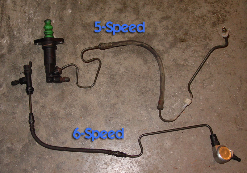

The hydraulic clutch lines are very different.... I really like the design of the 6-speed as it doesn't have the large push rod setup on the transmission side.
And the frustration of the night was installing the 6-speed hydraulic line to the pedal assembly.  I removed the bracket under the brake fluid distributor so that I could get more room between that unit and the firewall to unhook the 5-speed line and install the 6-speed.  What a @#$%@$# pain!!!  I was finally able to get the 6-speed line connected (lost a lot of fluid so bleeding is in my future), but I am not sure where the line should run.  Does anyone have a picture of the clutch line navigating around the brakes lines properly?
View from the bottom....

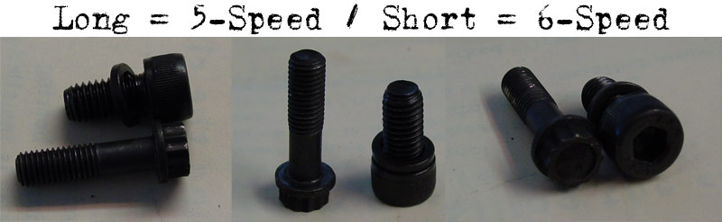

Almost all together....  it would have been 100% together if I had known the shield that goes between the engine and transmission was different between the 5 and 6 speed.
I figured out the best way to run the clutch line (I assume this the factory route... made the most sense while on my back under the car), did the power steering line (real easy!), installed the shift box, put the exhaust shields and exhaust back in place, and finally installed the 6-speed hubs and axles.
The clutch hydraulic line....
Same image with notes to give you a frame of reference.  This is looking up from the ground to the underside.  Frame rail is the driver's side of the car.

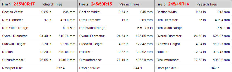

I'm still doing research on what tires/rims I should use this year..... I currently have older Toyo RA1 in 235-40-17.  Looking for a wider and sticker tire, yet no taller than the current tires (short is even better).  Looking at Hoosier R6 245-50-15 or A6 245-45-16.

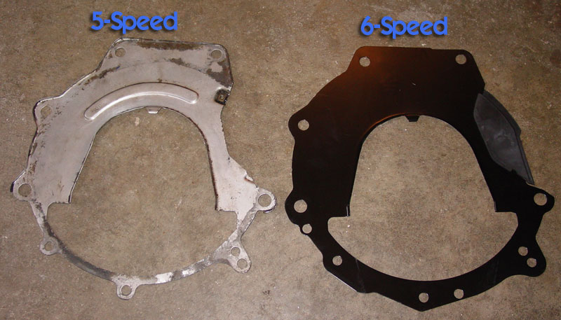

5-speed engine/transmission cover vs. 6-speed.  The black area on the right side is a piece of rubber.  It seems to have replaced the metal cover that is normally there on the 5-speeds.
5-speed cover on the 6-speed transmission
6-speed cover on the 6-speed transmission
Filling her up with 2.3 liters of Motul 300.  I need to get the special VW tool to tighten the filler cap.

A very different (and not flat) flywheel....
Shot of the clutch... notice that the thicker side of the clutch is actually the flywheel side; my experience is that is is normally on the pressure plate side.
The pressure plate (note the fingers) before I tightened everything.
...and afterwards.
Technical question.... what is the story with this hole in the bottom of the transmission?  It is supposed to be plugged?  Is it an inspection hole?
