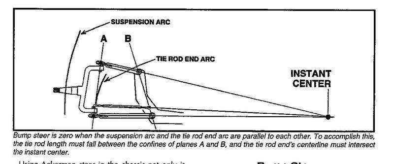

My concern about any of the rack & pinion conversions I've seen is how they will work with the front suspension so as not to induce bump-steer and inconsistent Ackerman. While I haven't modeled anything, the geometry just doesn't look right to me when you bolt a rack to the front on the OE sub-frame.  I have a Miata power steering rack that I bought for this specific reason and you are welcome to have it if you want to try. I had planned to relocate the battery to the rear of the car anyway and planned to install the electric P/S pump from a MINI under the car near the battery (with solid steel hydraulic lines from the pump forward) to power the rack.

Near as I can figure (stolen shamelessly from tuna55 truck build thread):
One trick I have up my sleeve involves converting the front-steer setup on the suspension to rear-steer.
The second trick involves putting the engine someplace else.
I like the 122/ 1800 front suspension- it's compact, it encases the springs and the dampers, and it tidily unbolts from the car.  It's also easy to set camber, caster, and toe with.

Front steer generally provides better geometry than rear steer.  To put it another way, NASCAR didn't go front steer until a decade or two ago.

Interesting, I always thought it was the other way around.  Something about the steering being in compression vs tension.  Also, I think most modern cars are rear steer...though that may be more for packaging than anything.  Will have to investigate.
EDIT: Some fairly good discussion on this over at the H.A.M.B.  Looks like front steer might be better, as you mentioned. Hmm.  May have to rethink my packaging and rack options.
