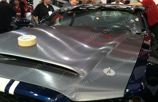

Someone else online suggested stainless steel car wrap just to get it going so I can shake it down. Its pretty cheap to buy.
3M Scotchprint Brushed Metal Vinyl Wrap - Brushed Aluminum ...
