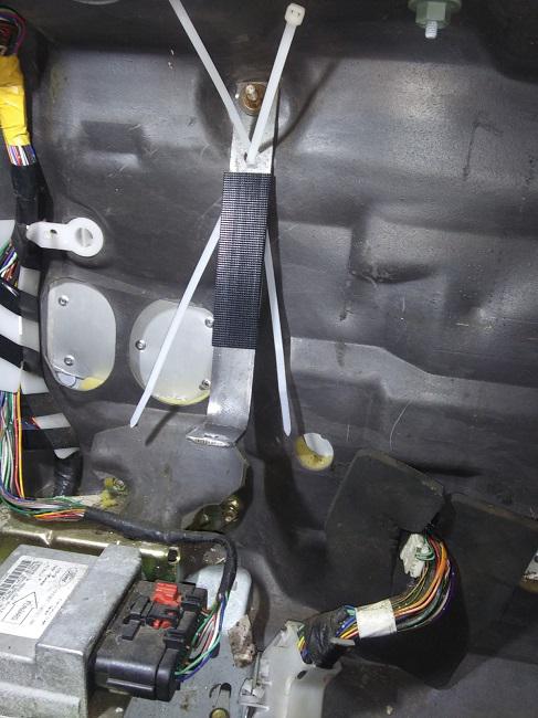

Using an old metal clipboard I cut a few patches to cover holes in the firewall.
I made a mount out of some metal strap for the ecu. I had it secured with Velcro to the floor. That didn't seem like the best solution.

 I cleaned up all the wiring into neat bundles, but a part of the harness I unclipped is the headlight switch, I think.
I got all the safety foam back in. I rearranged it as I don't have a passenger seat (yet) for maximum driver protection.
