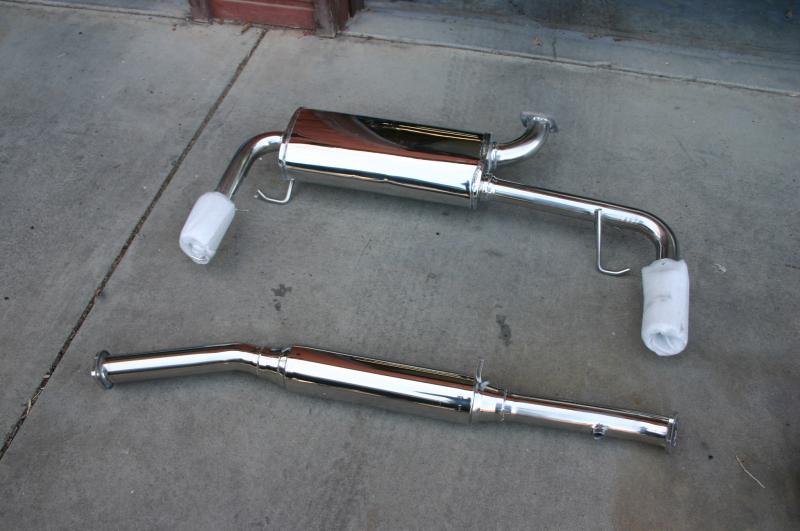

Eric had a NOS Flyin' Miata dual exhaust system stashed away, so he shipped it out to me. These are no longer available. It worked well with his cut bumper.

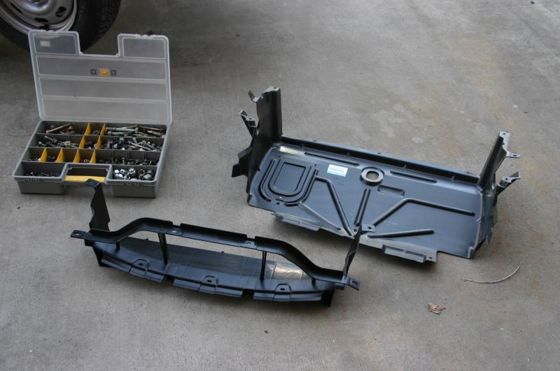

All the plastic under the front of the car got replaced because, well, it gets gross.

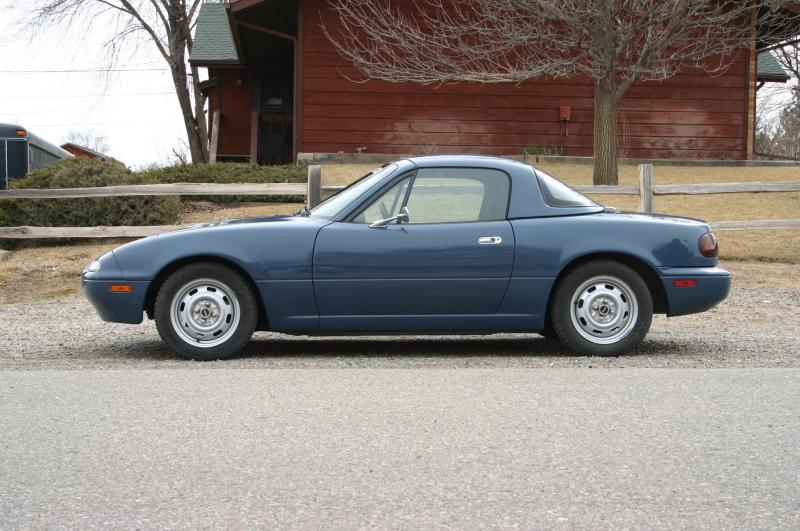

Here's the final result. The wheels have a satin finish on the recessed regions and are polished on the face, but the overcast light hides this. The final result is not to everyone's taste, but Eric loves it.
You can see the cut rear bumper in this shot.
The extra offset of the wheels effectively softened the V-Maxx suspension, which gave the car a really nice fluid ride on bad roads. We did find a bit of rubbing when running two-up on my "Targa Simulation Road", but a bit of rolling took care of that. Yes, the car is on jack stands.
