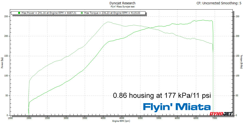

Okay, so this is embarrassing. The engineer who exported those dyno graphs did not completely understand the relationship between SAE correction, altitude and boost. I could write a whole dissertation on this, but usually we use uncorrected numbers and absolute manifold pressures to give numbers that should be appropriate regardless of altitude. Alternately, we use corrected numbers but relative boost level. This is important because we live at about 5000' elevation so there's about a 3 psi difference between our ambient pressure and sea level.
In this case, he used corrected numbers and absolute manifold pressure and I didn't catch it. That means the numbers were inflated by about 18%. I apologize and I shall be passing along my dissatisfaction shortly. Here's the accurate chart.

So the other numbers seemed almost too good to be true, because they were. That's ok. Your rush to be transparent and issue a correction is one of the reasons FM is held in such high esteem. This is simply an honest result. I know it's not a 1:1 relationship, but the simplest math can still provide a reasonable gut check on the feasibility of the numbers.
If an NC2 dynos at ~140whp and 11psi means .75 atm:
140whp * 1.75atm = 245whp
Beating that by 35whp (another 25%) unfortunately seems pretty unrealistic.
