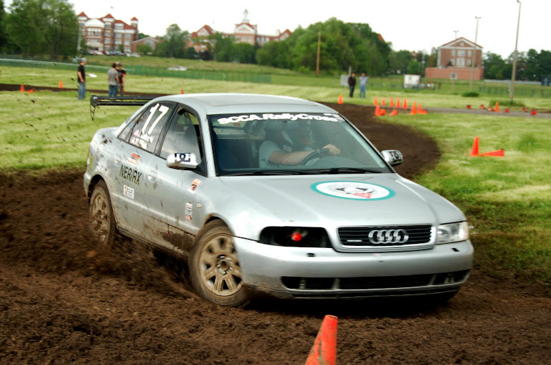

I think it's do-able and would like to see it.
"The Terminator" is a rallycross trailer queen from New England Region that was supposedly built cheap (salvage title iirc?) and puts the hurt on plenty of Scoobies.
"01 Audi A4 aka the Terminator. Car is gutted with two sparco seats, weight 2800 lbs. Bilstein hd's with s4 springs, stiffens ride and raise ride ht 3/4". k04 turbo, bigger injectors, larger intake plumbing with cone filter. Boost is turned down to 19 lbs. No cat 2 1/2' exhaust with one muffler. 15" Audi aluminum wheels with a large assortment of rubber mounted. A large wing on the trunk for bling."
I think the standard challenge recipe could be applied successfully: GUT / BOOST / TIRES with a some Quattro thrown in to spice it up
EDIT: found this quote: "And as far as cost my codriver and I built our Audi for 6k, and it is competitive everywhere it goes." I'm guessing a good portion of that is from an initial purchase price > $1k, sparco seats, and at least $1k in rally tires.

westsidetalon wrote: I wonder what kind of minumum weight is possible? I was thinking 2600-2800lbs.
The rallycross A4 above is 2400-2500lb, if I recall right.
He also did something I'd always thought of doing: moved the control arms out to the A6 mounting points. Tons of camber that way. Just have to watch that you don't pull the axles apart.
