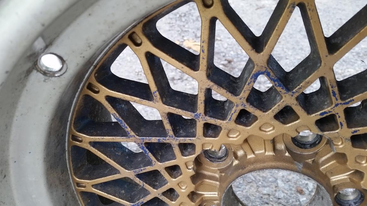

This isn't a great picture of the wheels, but they turned out amazing without disassembly. (one piece GTA Firebird castings) I used the wire wheel/sand/rouge on these lips and then repainted the centers. This was probably 3-4 years ago and they still shine just like this with a hit of wadding polish.
I just dug through some old photos... These were June of 2015.
As I bought them:

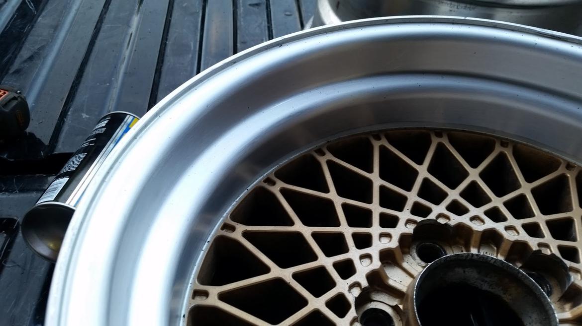

This looks like maybe after wire wheel and sanding:

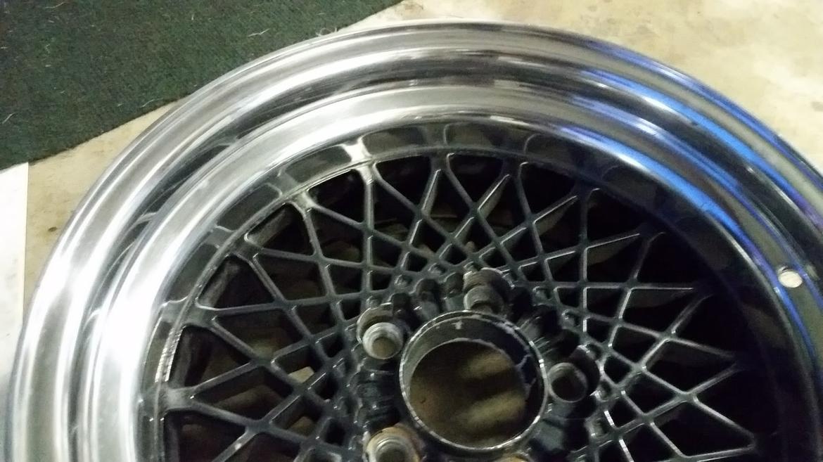

After polishing:

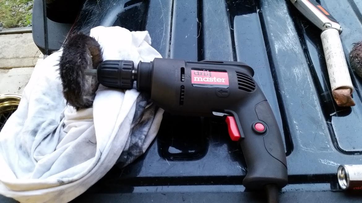

Some of the tools I used:
