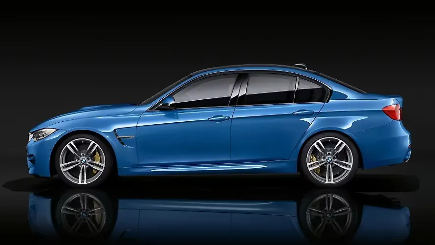

Here's another thing to consider. Autocrossing has one very specific element that other forms of racing do not: cones. You can't knock them over, so, do front and rear overhangs play a part as well?
The M3 does well, and look at the distance from front wheel to front bumper... not much.

As to your comparison of the M3 with the Mark 5 for Autocross, perhaps there are additional factors than overhang wink
