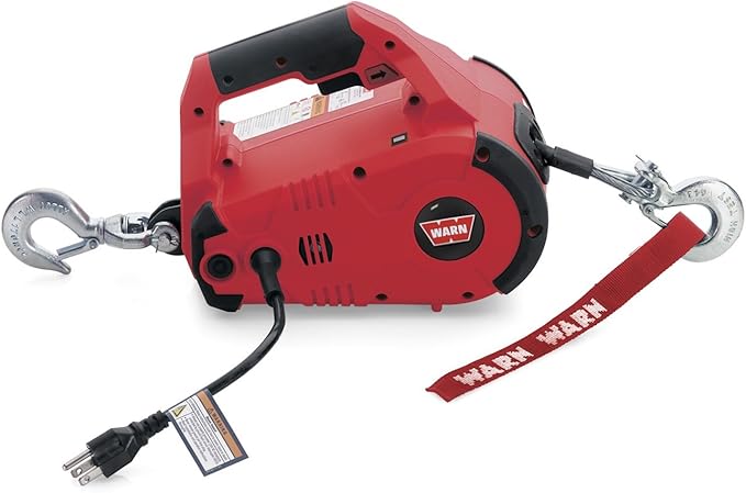

WARN 885000 PullzAll Corded 120V AC Portable Electric Winch with Steel Cable: 1/2 Ton (1,000 Lb) Pulling Capacity , Red
$231.99 on Amazon

I learned from Stampie, a hammer store ATV winch, bolted to a slab of scrap oak wood. Not as elegant as the Warn winch above, but cheaper, I can power it with a $20 garden tractor battery, and I won't be looking for a place to plug it in to household current.

My take on the Stampie winch (that's what I'm calling it from now on).
Cheaper than the Warn, and rated for 2500 lbs vs 1000.

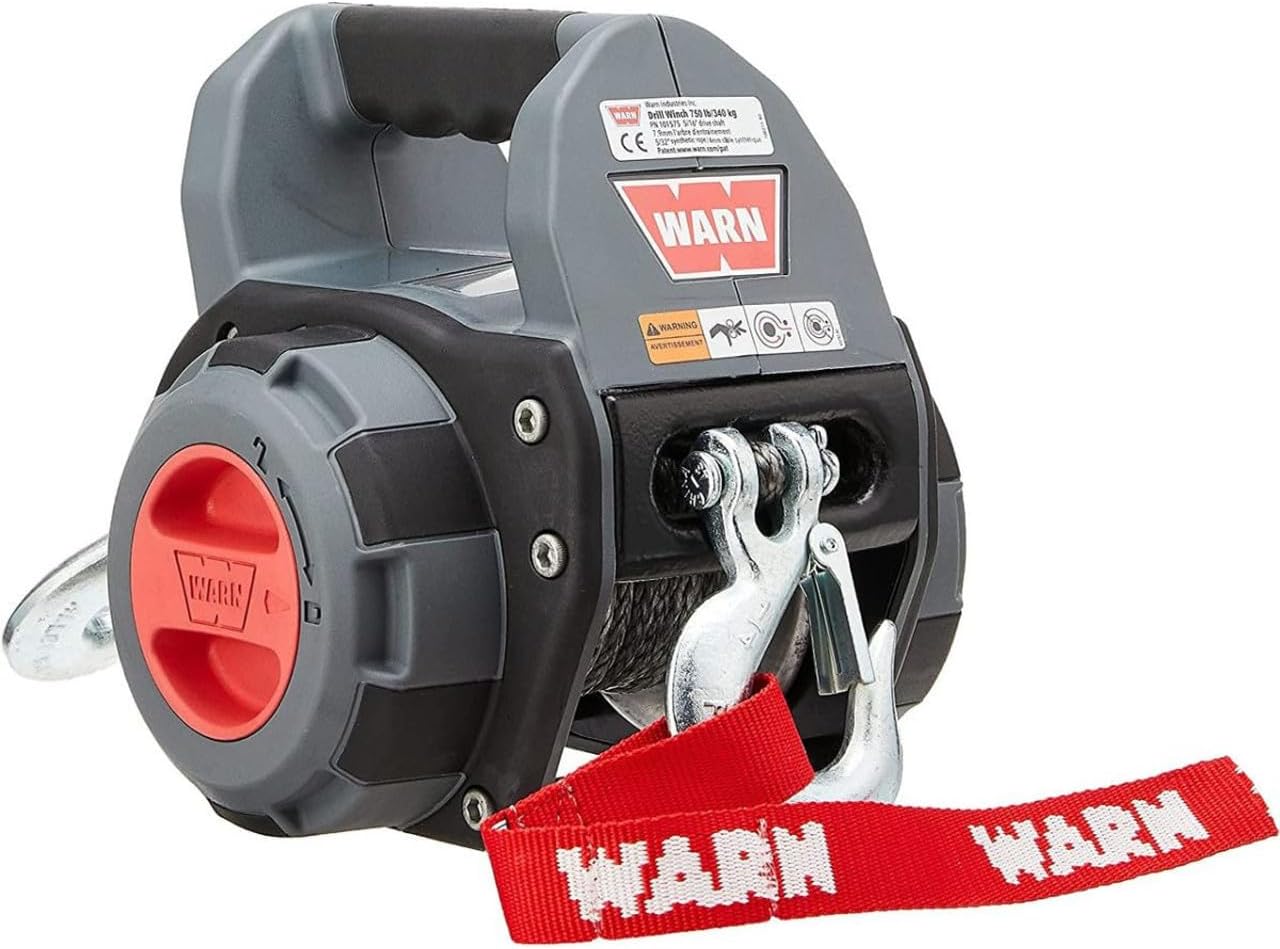

They make a version of that Warn Pullz All that's powered by a cordless drill input that was intriguing.

I use a drill winch. 1000 pounds of pull. No special batteries or wires needed. Just a drill.
There are cheap Chinese versions out there for around $100. The Warn is about $270.
