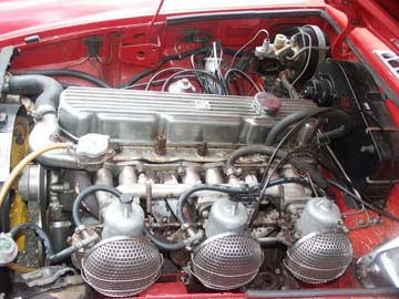

A better was to have gone would be a scratch built triple SU manifold (3 HS4 carbs would give much better fuel distribution than the existing twins).  Here is such a set up that I created for my MGC. That and some other very modest mods added 40 bhp and took top end up to an honest 130 mph.
Didn't have the great looks of one of my other engine bays, though:
