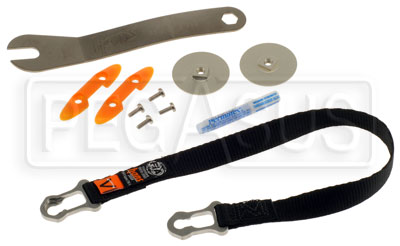

When drilling for HANS mounts, seems like there must be some sort of backing plate that goes on the inside of the shell. For a glued-in foam material, is it easy to just slide the backing plates in?

I'll try to find the HANS wrench and take a photo. It's made of flat steel, probably about as thick as a quarter. You just kind of force it in there.

Here's a link with a photo of the wrench. This should give you an idea.
http://www.pegasusautoracing.com/bigpicture.asp?RecID=6383
The washers have a thin nut welded to it that the anchors screw into. I placed the nut into the hex end of the wrench and used the wrench to push it up into place. It's not super easy, but it ain't rocket science either.
