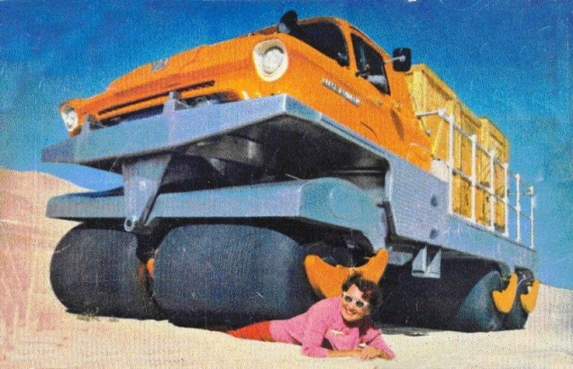

pinchvalve
pinchvalve SuperDork
7/7/11 9:16 a.m.
This:
or this:
ultraclyde
ultraclyde Reader
7/7/11 9:55 a.m.
Hmmm...thinking those last two don't meet the MPG requirement but certainly get points for originality.
