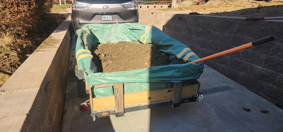

I bought the 4x8 folding HF trailer many years ago, mostly to haul my old ATV around. I still use it regularly, and having a small utility trailer has allowed me to avoid owning a pickup truck. (which I have no issue with, I just don't have the $ or space).  I have used it to haul 4x8 sheets of wood or drywall, move furniture and appliances, transport railroad ties, and with a bagster inside, haul mulch and dirt. It is such a handy thing to have.
The biggest change I made was replacing the hubs. The Chinese hubs it comes with are crap, and they have an odd bearing diameter. That means NOTHING off the shelf fits, you have to import bearings from China, and they failed every 38 miles. I bought replacement hubs that were better quality and used standard bearings (back in the day there was a site called redtrailers.com that sold everything from trailers to parts) and have not had an issue since.
Since this photo, the frame was repainted with POR15, and the rear lights have been ripped off and replaced a few times. I consider them wear items.
