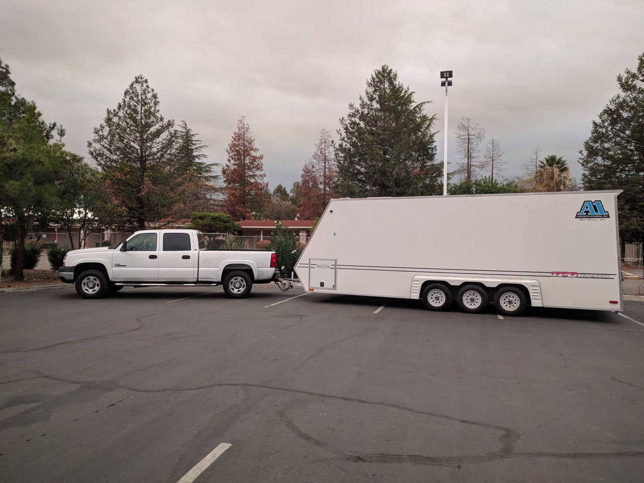

codrus
codrus UltraDork
1/16/19 1:58 a.m.
AIUI, the 2007 was a split year.  The "Silverado 2500HD Classic" was the GMT800 and got the LBZ, the "Silverado 2500HD" was the GMT900 and got the LMM.
I have an '07 classic and while many "enter your vehicle make/model/year" sites will distinguish between the classic and other, some don't.  It's often safer to search for parts for a 2006 instead.
