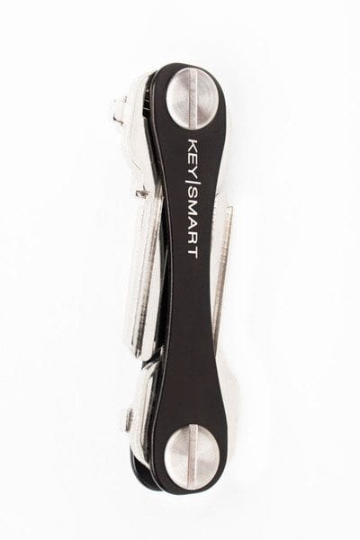

My car has a big clunky keyfob, as all modern cars do.  I don't use the buttons on it.  It doesn't make sense to.  The car knows when I am close and I can unlock it just by hitting the door handle.  Same with starting the car - no need to put it in the ignition.  How can I get a small RFID chip programmed so I don't have to carry around this stupid giant keyfob?
What I have:
What I want:
Knurled.
Knurled. MegaDork
