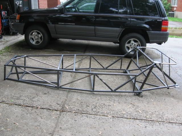

I've built or been involved in the building of four Locosts. The frame is the easiest part of the project. None of our frames ended up being more than an 1/8" out of square.
The bonus of building the whole thing is people's faces when you tell them it started as a pile of tubes on your garage floor.

Really? Guess I need to learn to weld.
What would you say is the most difficult part of building a Locost? Mocking up the suspension mounts/arms?
The main thing that bugs about many kit cars is the use of a solid axle our back instead of IRS. I'm guessing since Keiths book is based on a Miata it uses an independent rear. I know I need to just go buy it.
I guess the next most intimidating part is the bodywork!

The most difficult part is not getting bogged down in designing the perfect suspension Outside of that, wiring is the most tedious unless you're using one of those engines with a toilet tank full of fuel and a little whirry thing full of sparks.
If you want a preview of my book, hit up http://www.cheapsportscar.net. It's the story of the build. And yes, my car has IRS. A popular way to do an easy IRS is to simply bolt the entire Miata rear subframe into your car. I've got some diagrams on my site that show how it attaches.
Bodywork isn't that bad because there just isn't all that much of it. Get your hands on a nose cone, fenders and possibly a scuttle and everything else is just made from flat sheets.

I build locost frames and have made maybe 8 so far.
Make sure you go to the forums at locostusa, that's where all the info is.
Many people there will say the frame is the easiest part. I won't disagree, but there is something to be said for having something tangible and locost-shaped sitting on the garage floor.

Building a Locost is one of the best ways to learn to weld.
First, buy yourself some square tubing and build a solid, square table to work on.
As you begin to work on the chassis, just tack weld all the joints. By the time you're done with all the tack welds, you'll have a good feel for the welder. Then go back and finish the welds.

Yes, and it has sections for people who want to start with a prebuilt frame and for people who want to build one from scratch. If you are building a frame, look at the McSorely+442 frame plans. They are VERY detailed, and I don't think you can go wrong with them.
I decided to build from scratch, but to design my own frame instead of using plans. (I sort of have an excuse, since I want my car too look more like a 1930's street rod than in a lotus seven, but it was still not wise. I spend a lot of time sitting and looking at it, saying, "Now what?") I think you're much better off having plans to work from.
+1,000,000 for the suggestion to tack everything together before finish welding it. That keeps the angles correct for each part and makes sure everything stays properly aligned while you weld.
